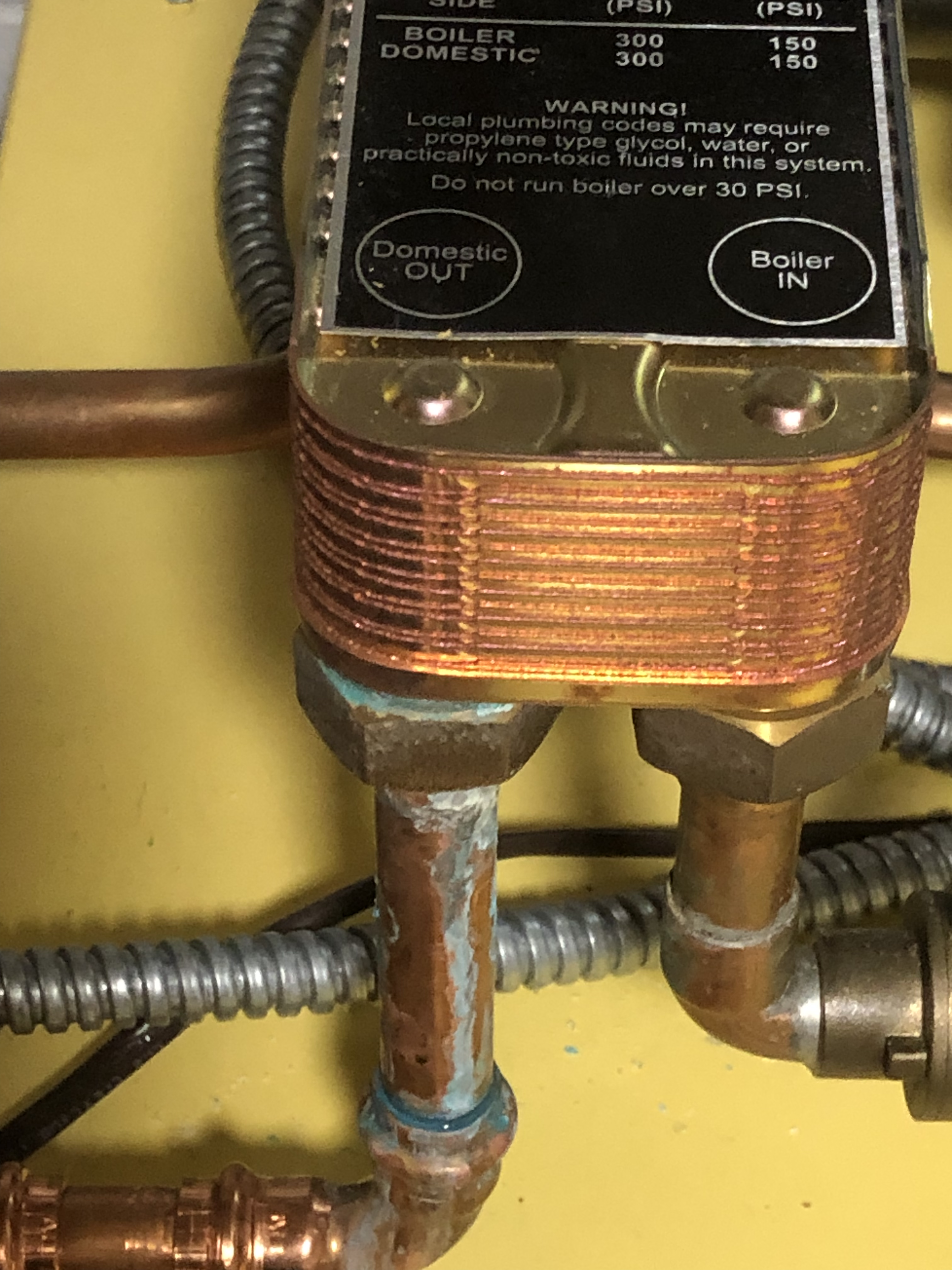

I have an Energy Kinetics EKF1 oil boiler, installed about 18 months ago. I've noticed blue-green corrosion/staining building up on the copper pipe stubs below the plate heat exchanger (both the "Domestic Out" and "Boiler In" connections), suggesting a slow leak somewhere in that area.

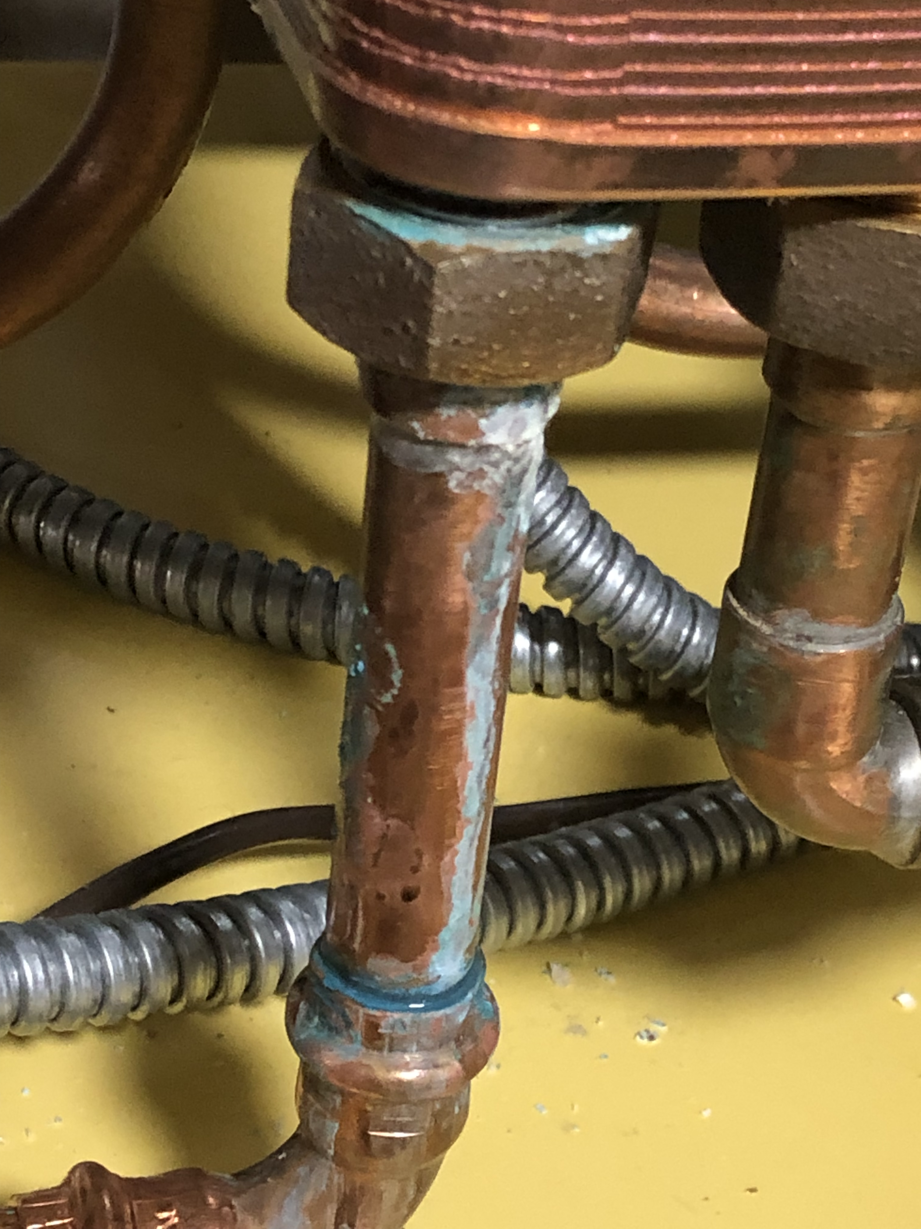

I ran a flashlight/paper towel test with the boiler firing and a hot water tap open to get flow through the exchanger, wrapped paper towels around the union nuts and the 90° elbow, and let it run for ~15 min. Results were inconclusive — there's some dampness but I can't tell if it's coming from the union joints, the elbow fitting, or the plate exchanger itself weeping from the side.
A couple photos attached showing the staining pattern.

    I'd say the HX is fine and that the unions are leaking. Isolate and drain as best as you can. Undo the unions and apply some pipe dope to the male and female faces of the ground joint and tighten. Refill and purge.
    Maybe inspect the ground joint before you apply the pipe dope to see where it was leaking. Look for any imperfections that could prevent a proper seal.

    Aside from the thread seal, be sure the piping is squared up with the plate exchanger at a true 90 degrees. Those unions need to be e good and tight.

    Unions are the most likely leak source. call the installer.

    And while you are at it — make sure that the unions are as close to perfectly aligned both laterally and angularly as possible. Unions will NOT compensate for misalignment.

    Looks like antifreeze puddled up on the press elbow. If there is antifreeze in the system, make sure its safe for your boiler.

    clean it up and see where it starts getting wet first. probably the union because those copper unions suck

    The unions were fine but the plate exchanger had developed some small leaks. It was replaced under warranty.
    Also Energy Kinetics recommends a special compound for their unions manufactured by them, not a typical pipe dope like Blue Monster.
