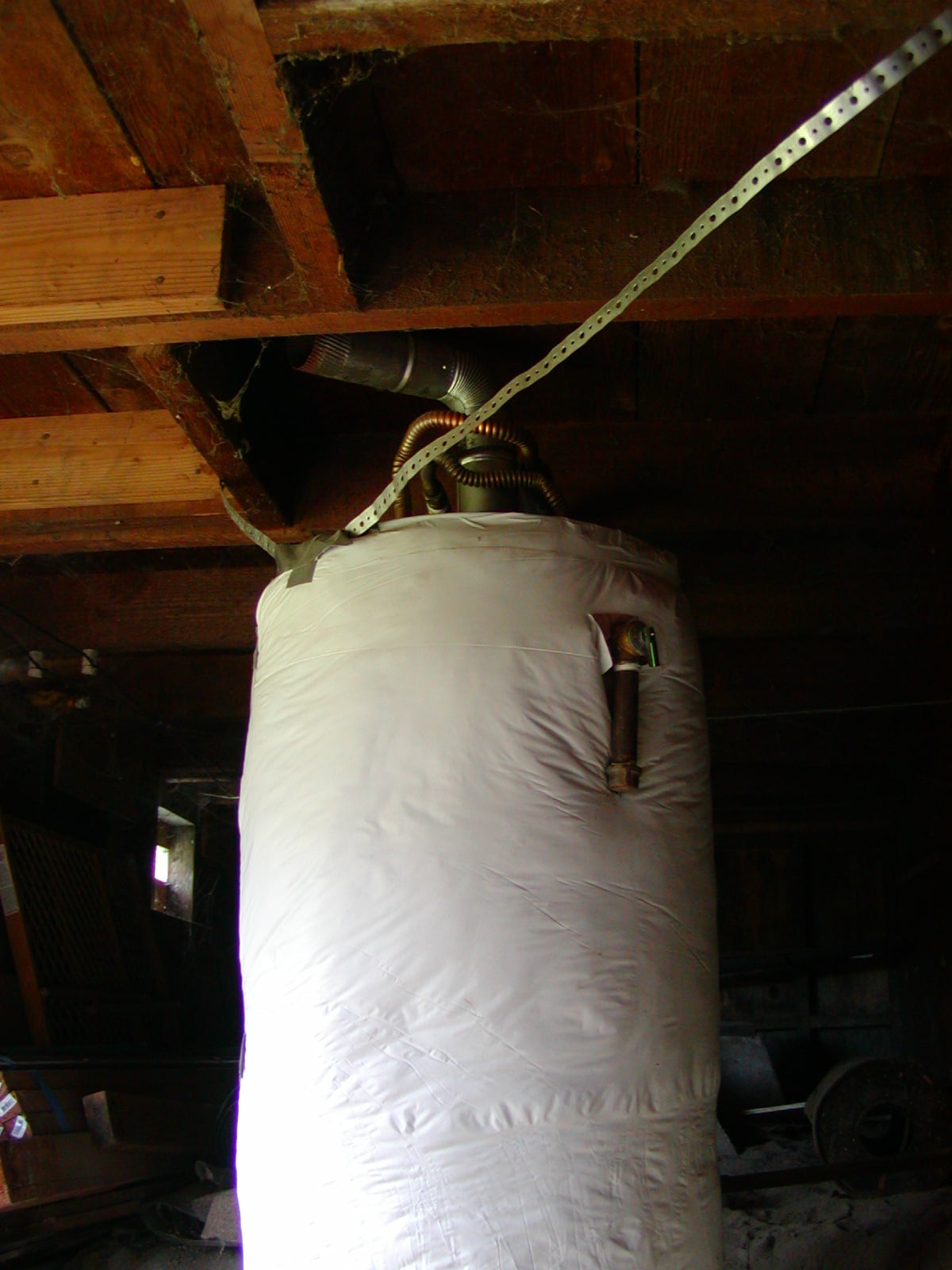

    I have come across at least two of these none vented WH.
    One even had the plugged T&P relief valve which yours seems to have.
    Those insulation wraps are often installed, free of charge, by some governmental agency. They could train their installers to look for some basic safety issues and report them to the agency. Probably free repairs to the HO.

    @Larry Weingarten That is a scary pic Where did the flu go? Right next to the wood?

  • Larry Weingarten
    Larry Weingarten Posts: 4,210
    Hi @RayWohlfarth , I found a way to run the vent properly. Also, gotta say that plumbers tape earthquake strap was a lie. Those never hold in a real earthquake. That owner was not thrilled with the work I needed to do, but I couldn't just let him "think about it" for years.

    Hi @Alan (California Radiant) Forbes "So, what do you do with a customer that may not seem interested in
    correcting very dangerous code violations. Call your lawyer to free you of liability? Do the work for free? Call the installing contractor and tell him to fix his mistakes?"
    This is one of those "it depends" places. I always note dangerous conditions on the invoice. If the installer before me caused the problem, I tell the owner to contact the installer. If it's as bad as the photo shows, I tell the owner it's so unsafe, that I'm not leaving until it's safer. I can use the utility excuse too. That is, if the utility saw it, they would shut it down… even if it's your heat in winter. I've seen them do it.
    And to @RayWohlfarth 's question, yes, the flue ended inches from the floor joist. It needed work right away!

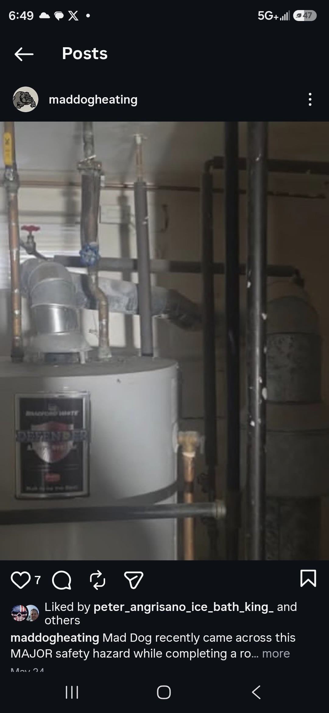

  • Mad Dog_2
    Mad Dog_2 Posts: 8,755
    We always point out Life-Safety issues and shoddy work that could lead to premature failure. All too often, We come across Commercial and institutional boilers that had recent inspections that missed several, glaring safety issues.
    We make certain the person accompanying us from the facility acknowledges and understands the safety issue and strongly encourage them to verify independently with another profession if we get "that look." We also video and document the issue so the liability is not on us as the last in.
    Just recently we discovered a residential Water Heater with the flue pipe horribly pitched the wrong way. When the Homeowners blew it off after carefully explaining the terrible risk to them for 10 minutes - to no avail - we reported it to the local building department inspector and the gas utility via email. Mad Dog
