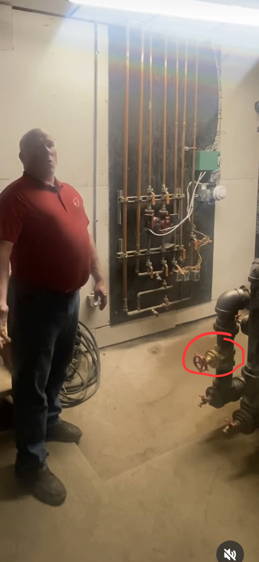

    All steam boilers we install get a Gate Valve just before the last elbow in to the Hartford Loop Tee to make blowing out that low leg of the return piping easy. This valve also isolates the boiler from the system returns and is a grear help when doing pressure testing and full blown downs. Mad Dog

    @Mad Dog_2 Thank you for your comment and the picture. I am curious, why do you prefer a gate over a ball valve? Thanks again.

    Ryan: In a pinch, when a Gate valve is not available, we will use a ball valve. However, I have seen the innards of the ball valve, especially the Teflon seals, and they do not hold up to the 212 degree condensate and become deformed causing the valve not to hold in a few seasons. Also, Full port Ball valves are not always available. Gate Valves are the way to go. Mad Dog
