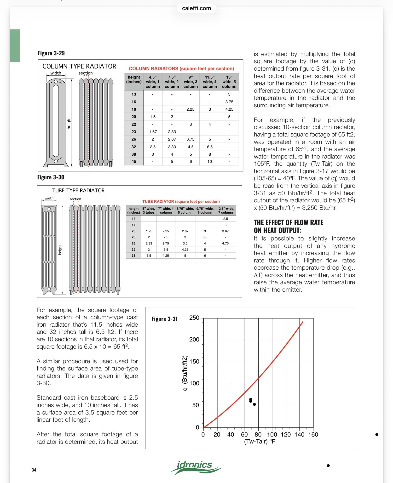

    hot_rod Posts: 28,699
    Here is a generic radiator derate., and the math needed to correct the output.
    If you can
    determine your exact radiator sq ft, use that number.
    The graph takes into account the water temperature Tw and the ambient air temperature Tair at the radiator, see the example, adjust to your actual numbers.
    With Amos con that Tw will adjust up and down based on outdoor temperature Think of it as a cruise control on your boiler.
