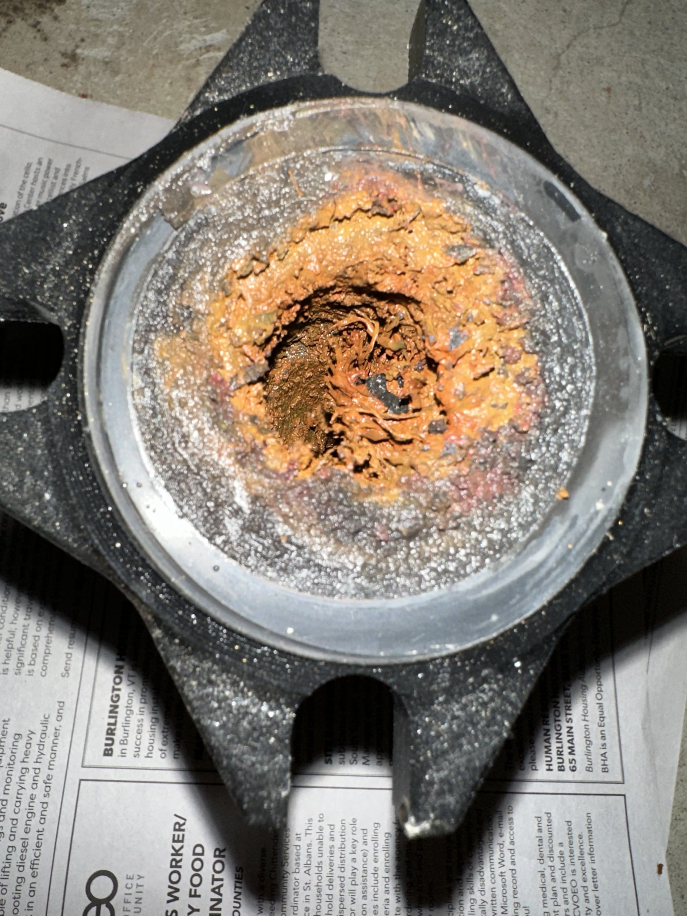

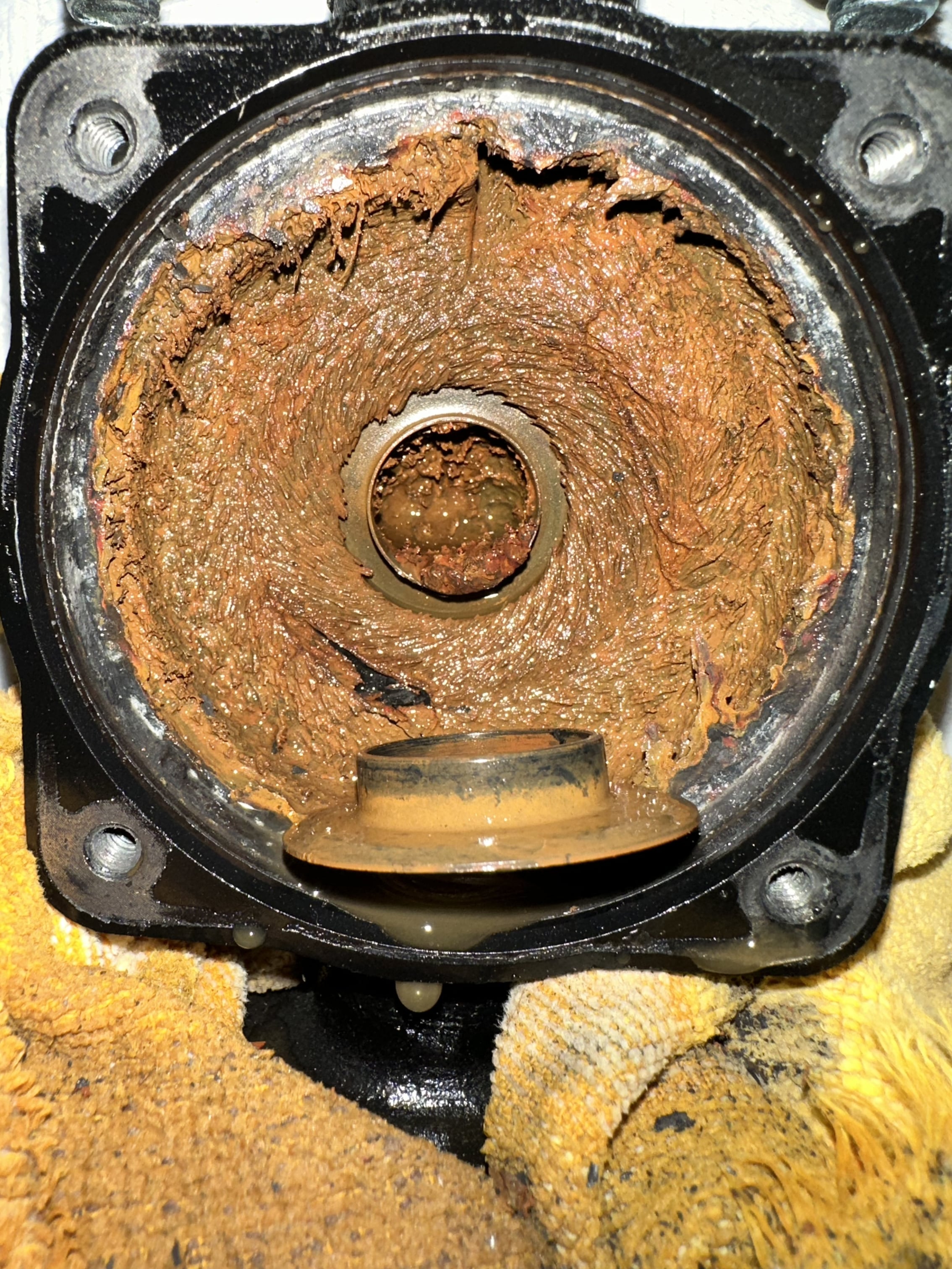

I installed a Rinnai I-series boiler a few years ago, probably 6 or so. He has had a couple minor issues, like a few circs, and an internal pipe going bad in the boiler. He has been using his fuel company to get the work done. Recently he reached back out to me, and here are a couple pics of the circs internally. What the heck causes this? He may also have onyx tubing in the slab??

  • That's from oxygen intrusion, either from the Onix tubing or somewhere else.
    Onix has an aluminum oxygen barrier, but from what I've heard, oxygen still gets through.
    either oxygen ingress through tubing that isn't oxygen barrier or that has an oxygen barrier that has somehow failed or it is leaking somewhere and getting a lot of makeup water that brings oxygen with it.
    hot_rod Posts: 28,699
    rust! Caused by sir (oxygen) getting into the system
    Is it an open system, combination dhw and heat?
    Connected to a fill valve?
    Well that's a right mess. As has been said, mostly oxygen corrosion. Which is all very fine, but i think you may have a horrible time getting it cleaned up, if you can do it all. Hate to say it, but it may be cheaper to replace it.
    The earlier rubber pre Onix, Entran tubes could do that to a system in a years time! The higher the operating temperature the more O2 they suck.
    Those sludge, rust deposits are probably everywhere in the system. There are some cleaers specifically for rust deposits, it may take a few treatments and power flushings.
    if it is the tubing you can either set it up as a system with no ferrous components, probably using a heat exchanger or you can add inhibitor to it and keep adding inhibitor. as the oxygen scavenger in the inhibitor is consumed you have to add more inhibitor s if you want to keep the system from consuming itself you need to periodically add more inhibitor.
    make sure it isn't just leaking first.

    I had that sneaking suspicion. A heat exchanger and a thorough cleaning and oxygen scavenger is my suggestion. We will see what they say!

    Cleaners (chemical and mechanical), inhibitors, isolation (plate heat exchanger) and stainless components (circulators and expansion tank) is the direction I would go. Cast iron circs and and such can be on the boiler side of the heat exchanger.
    Also check any of the tubing you could find for pliability, if rigid, be very careful and consideration of back-up heat may be needed.
    Seen it many times over the years with tubing systems where someone saved a few cents per foot and used non-barrier tubing.
    This could also be an indication of a major leak in the system without any visible leaks around, pressurize the system and turn off the prv.

    A circulator in that condition is beyond any chemical cleaner. Probably any ferrous component in the system will look like that.

    Good quality PEX with an EVAL or EVOH oxygen barrier that meets DIN 4726 (German standard) should be oxygen tight for the life of the PEX, estimated at 50+ years in most situations.

    It may also be the wrong circulator. The head should be brass or stainless steel.
