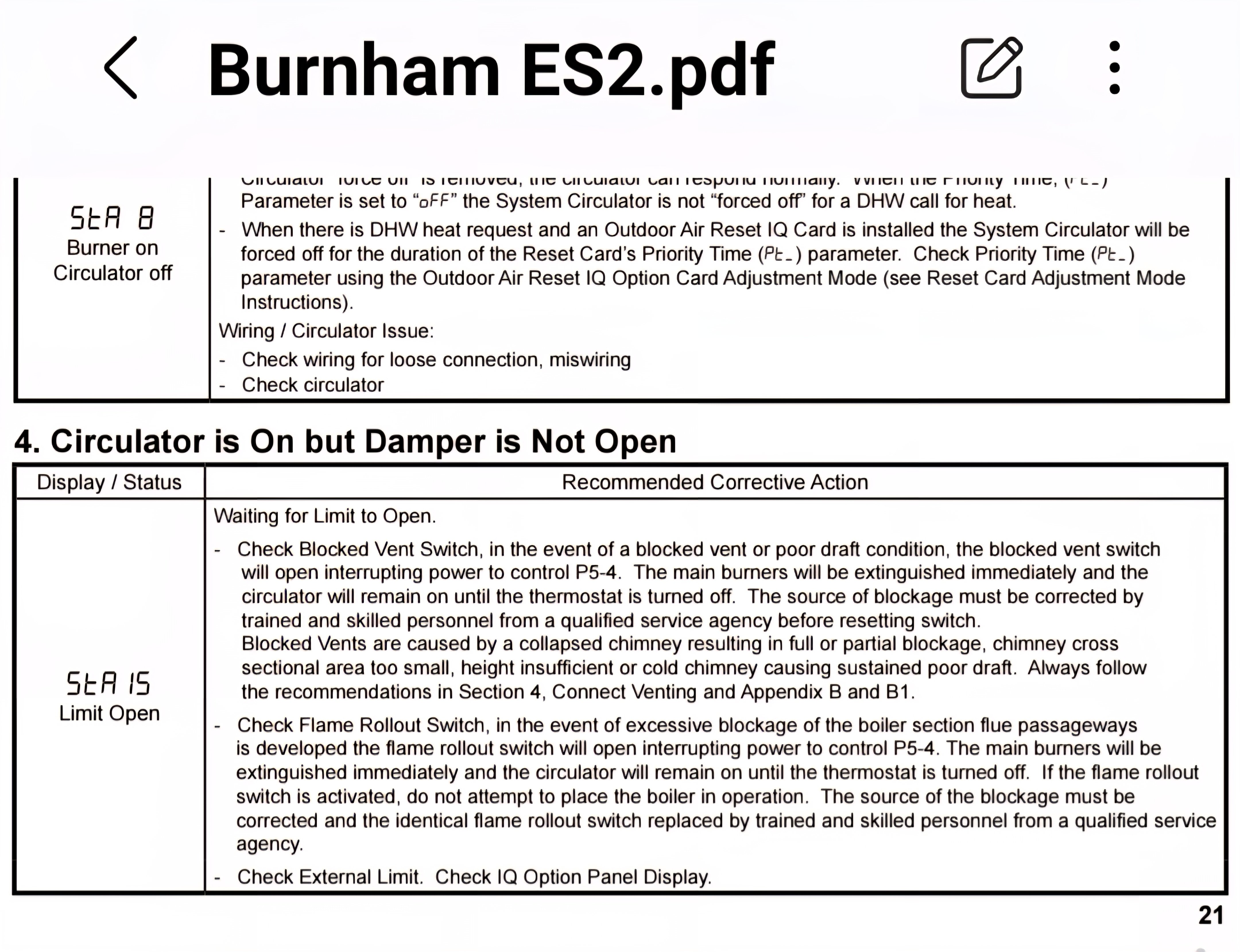

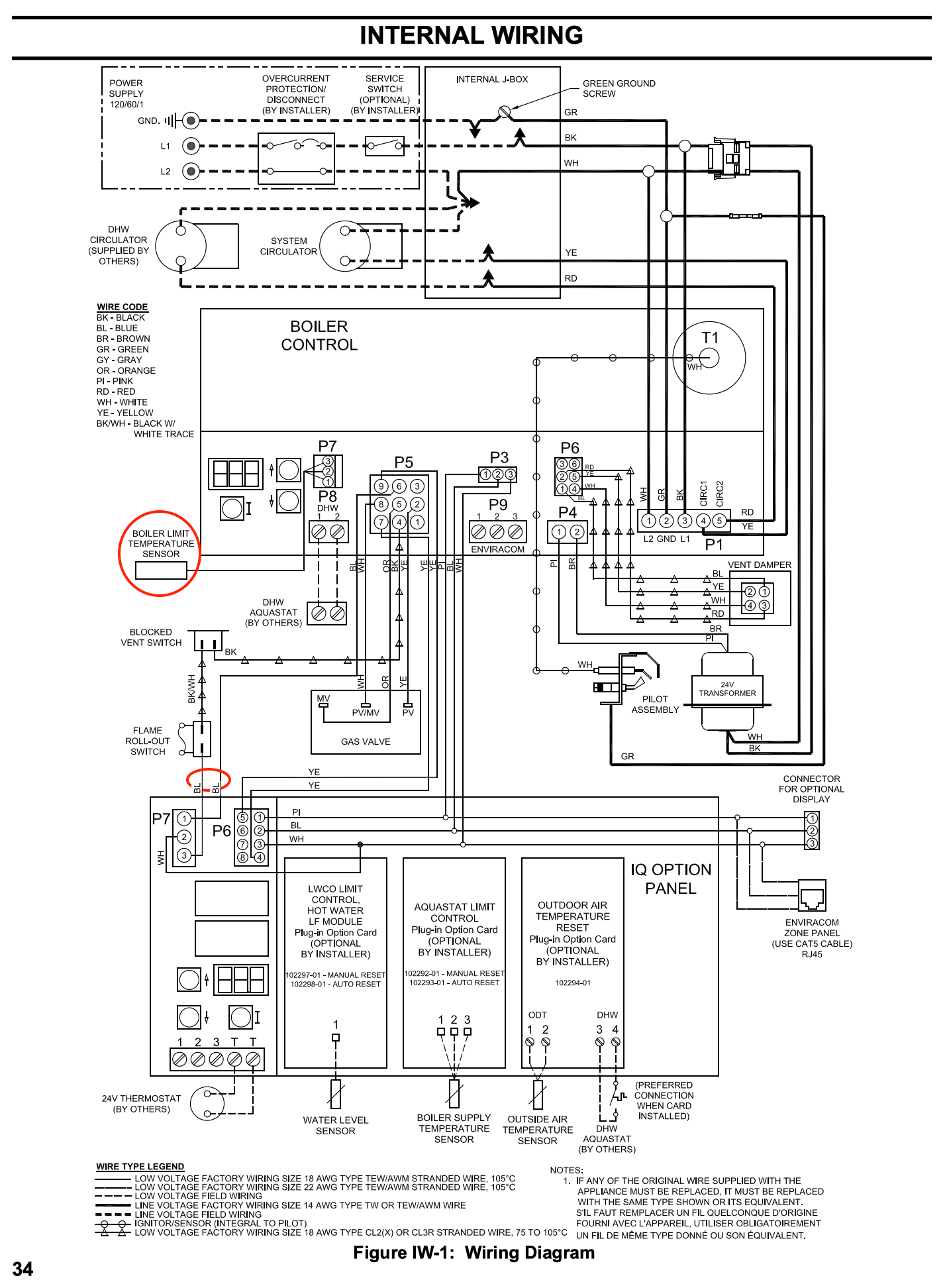

I have a Burnham ES2 boiler with an IQ panel but I have no options installed.
I just had a problem where the boiler wouldn't fire - Status 15 and Error 5 on the IQ panel.
I have a service contract with my gas utility so someone came and fixed the issue by cutting the two blue wires and connecting them together. He said this bypasses the limit that was causing the error. He said this fix is provided by Burnham and since I have no IQ options installed, I don't actually need the IQ panel at all.
In fact, he said that boiler came two ways - with and without the IQ panel. Mine happens to have it installed from the factory though it's not being used.
He said this fix will permanently prevent that Err 5 from happening again, which he said is quite common but he didn't replace the board.
Here's my question. Could the IQ panel fail again in the future with some other error? And is the IQ Panel really not needed?
If my boiler doesn't really need that panel, is it possible to eliminate it if it should fail again in some other way in the future?
I asked the service guy and he didn't know but he said he'd imagine you could put other wires together to just cut out the panel entirely but he didn't know which pairs to connect.
So I want to know for the future should this panel fail again with some other error.
Can the panel be bypassed entirely and how would it be done? Which wires need to jumped to make that happen?
I know that some people will say to just replace the board if it fails, but I'm thinking that if it's not needed and not being used, it's better to just eliminate a point-of-failure from the mix.
Thoughts?

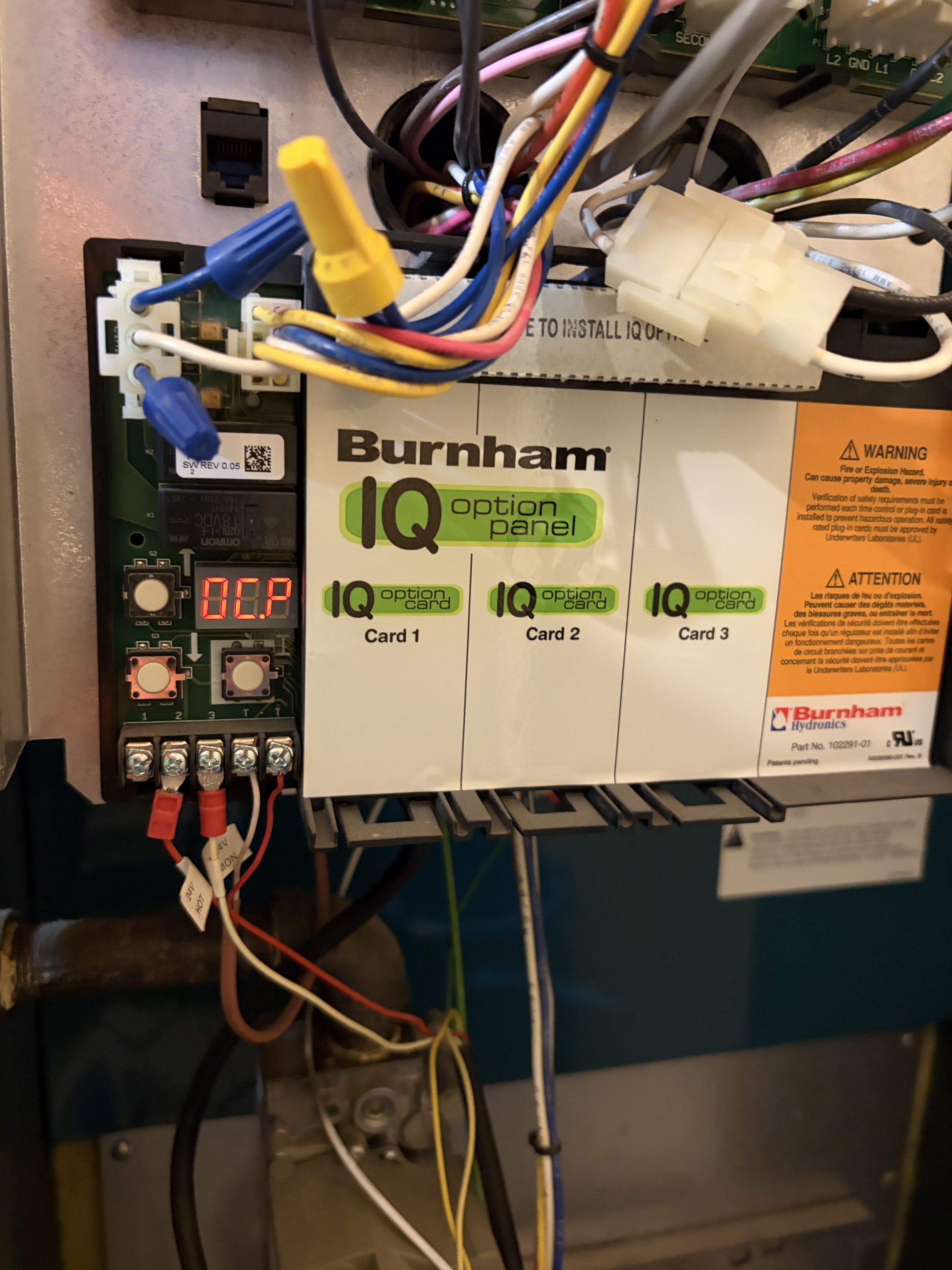

    Can you post a pic of the blue wires and where they go?
    Screenshot_20260526_193801_My Files.jpg Screenshot_20260526_193932_My Files.jpg
    I'm not too familiar with those boilers, but how was there an error 5 if there are no cards?

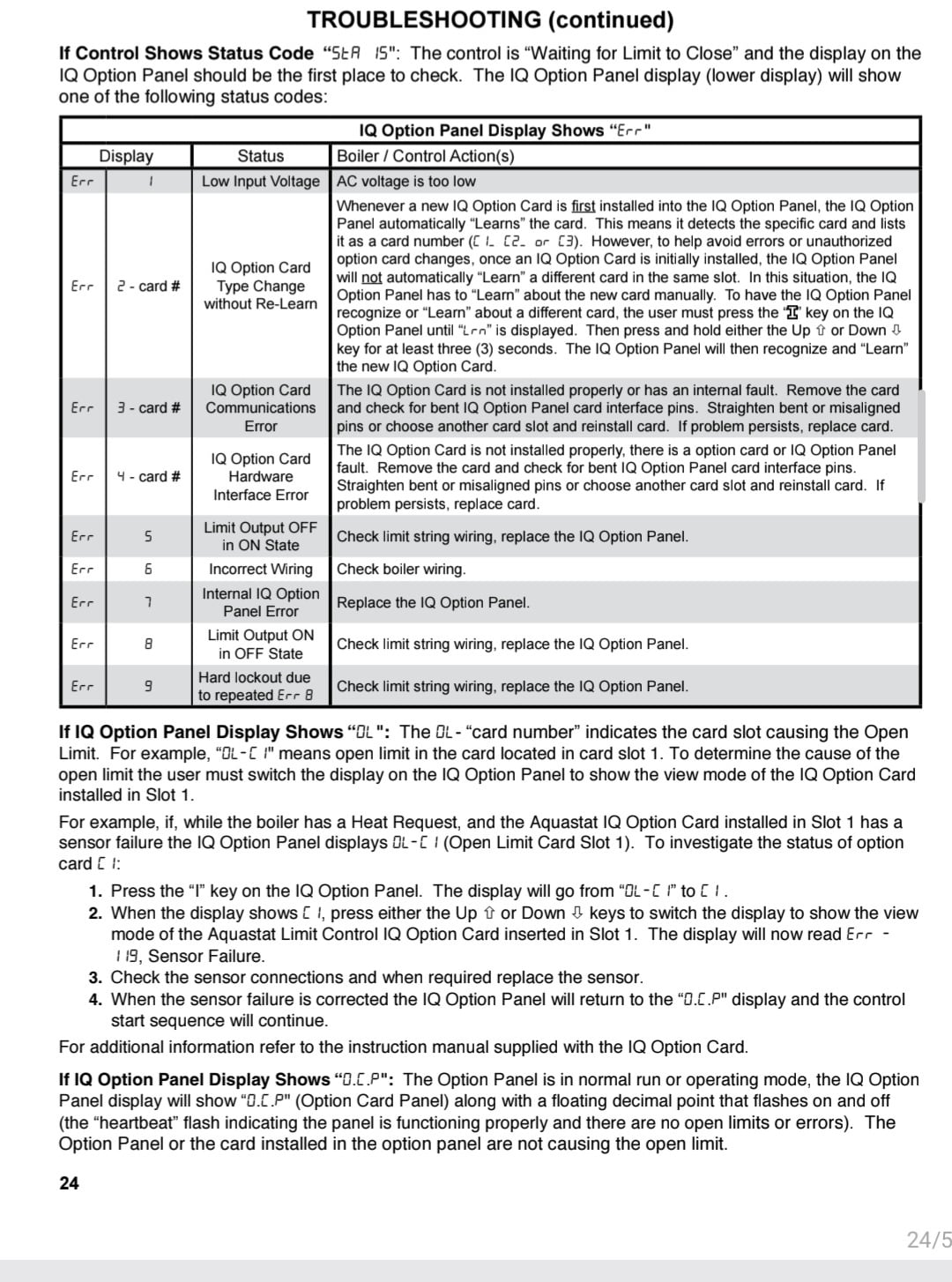

    Error 5 is not associated with any specific card, @HVACNUT .
    I installed a Crown Boiler with that same system and chose to use both the LWCO card and the ODR card. After spending nearly two weeks trying to get that setup to operate reliably, it was nothing but trouble.
    In the end, I disconnected the entire IQ system and bypassed all of the IQ panel limits so the boiler was essentially wired as if the IQ system had never been installed in the first place. It took me about two hours to rewire everything.
    I ultimately had to give the customer a discount for all the additional trouble because there was no outdoor reset functionality afterward, even though the customer had paid extra for that feature.
    Not a fan.

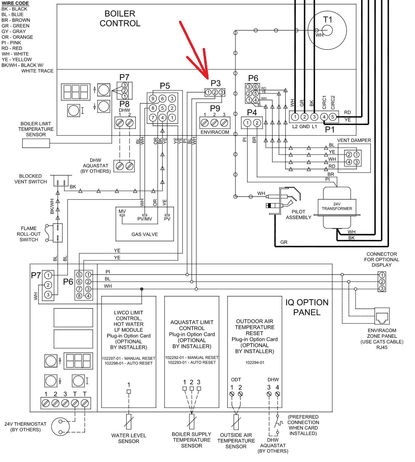

    As I recall from my one unplesant experience with this control, I believe there is a limit circuit that includes the flame rollout switch and blocked vent switch that is in series woth the blue wires that come from the IQ panel. if the aux limit, LWCO or the ODR feature requires the burner to stop those blue wires interrupt the limit circuit. If there are no cards in the IQ panel, then the blue wires are not needed to open that circuit since there is nothing to open. The fact that the IQ panel can still malfunction and open those blue wires in the circuit is probably part of the problem with the whole idea. I don't believe there is any new euipment since that time that offer this IQ system
    As you can see the Boiler Control still has a high limit sensor incorporated in the system, so that "jumping" or "shorting" (I believe shorting is the incorrect term however others use that term for this procedure) the IQ panel's blue wires do not affect the unit's safe operation. (See Red ovals)

    This boiler has been in service for over 13 years. I have the IQ Panel installed but there are no options installed. The service tech said since I have no options installed, the IQ system isn't needed in my case. I have a separate low water cutoff that's not part of the IQ system.
    So that got me thinking that if it's not needed and is just another (expensive) point-of-failure, then why not just eliminate it entirely if it fails again. Hence my original post. Is it really not needed in my case and what's involved in eliminating it?

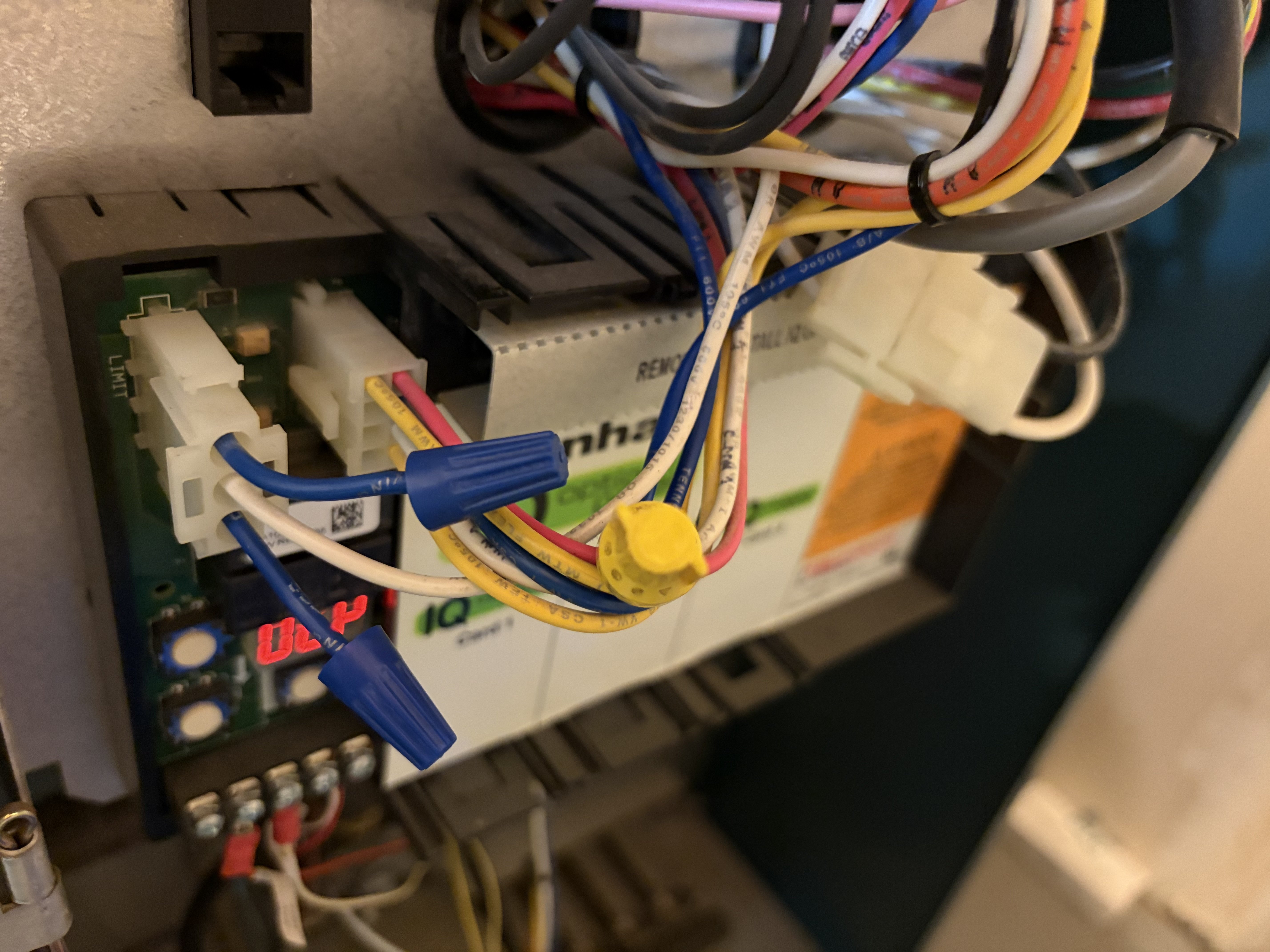

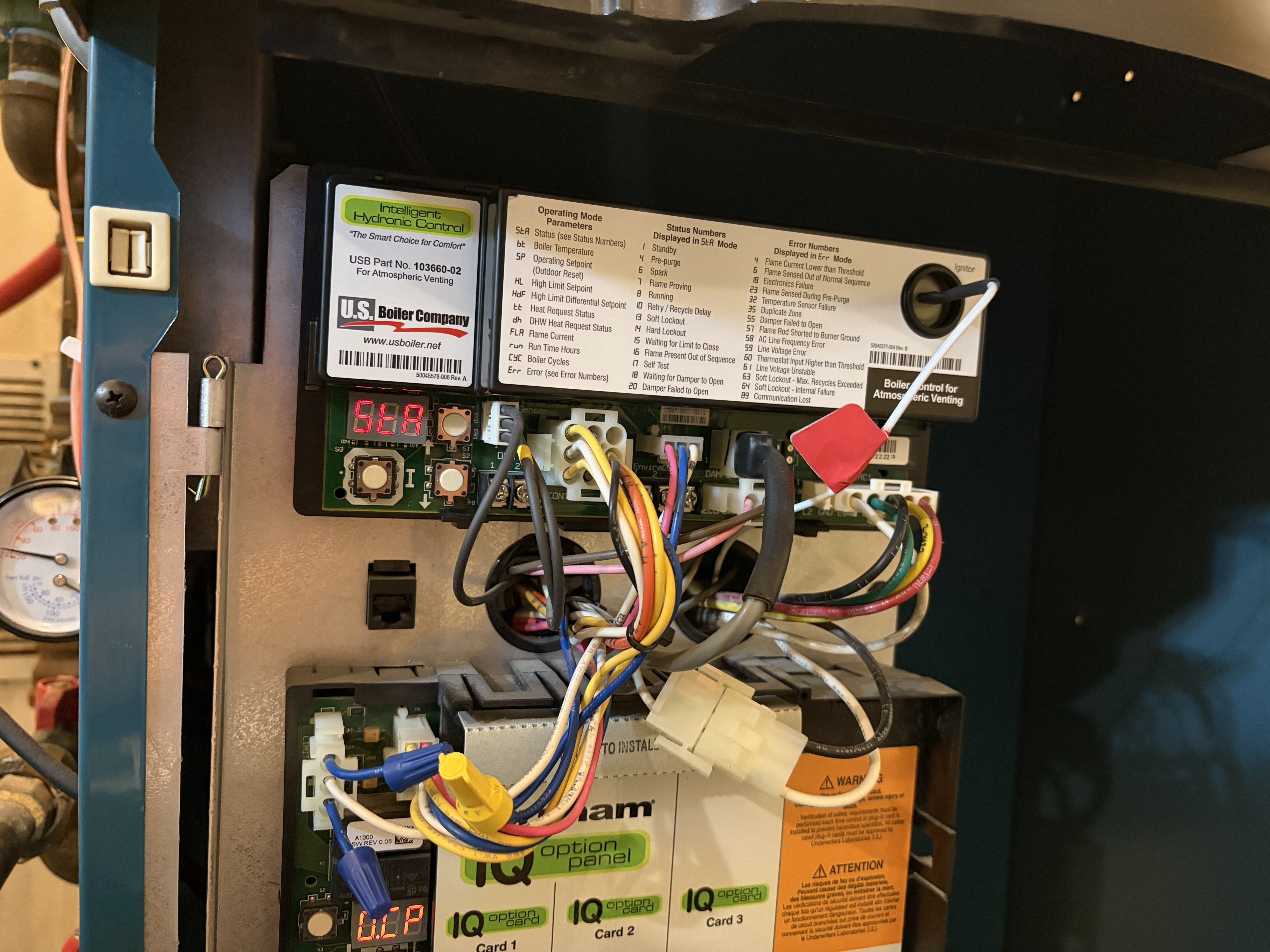

    Here are the pictures requested by @HVACNUT
    HVACNUT
    HVACNUT Posts: 7,784

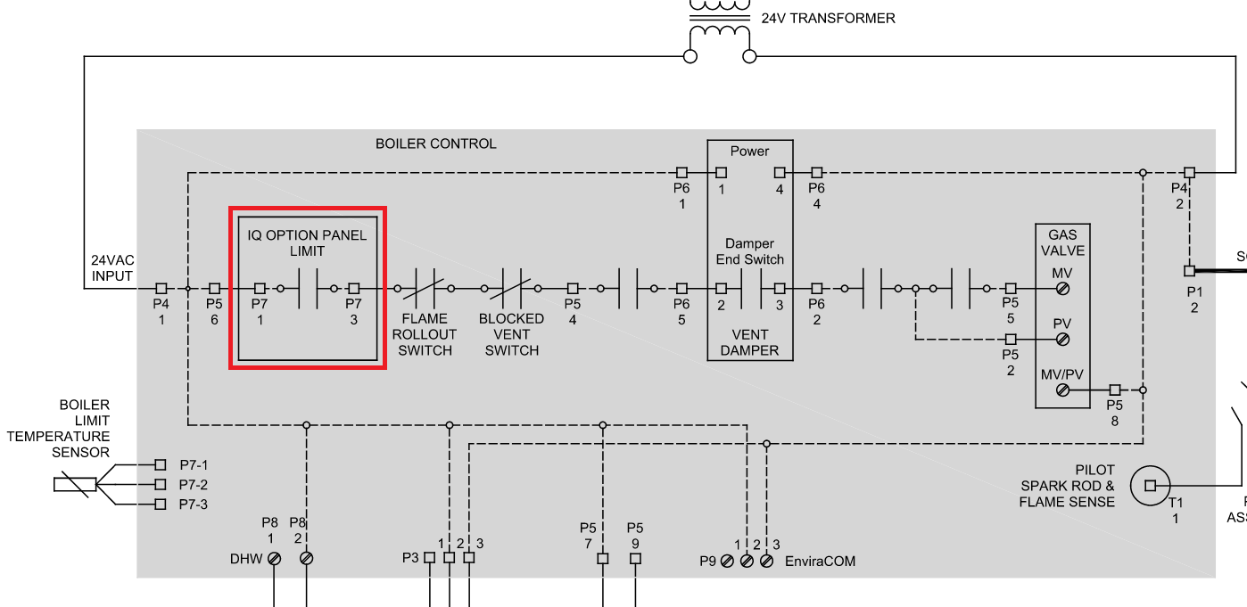

    It looks ok. Its just weird that after 13 years it needed to be done. If there's no option limit card, it must be internally jumped. But now its not?
    As long as everything works the way it should, the circuit with the blue wires is complete. 24 volts goes from the transformer into P4/1, out of P5/6, and that starts the blue wires safety circuit that continues through the vent damper end switch, then to the gas valve. All safe. Just strange.

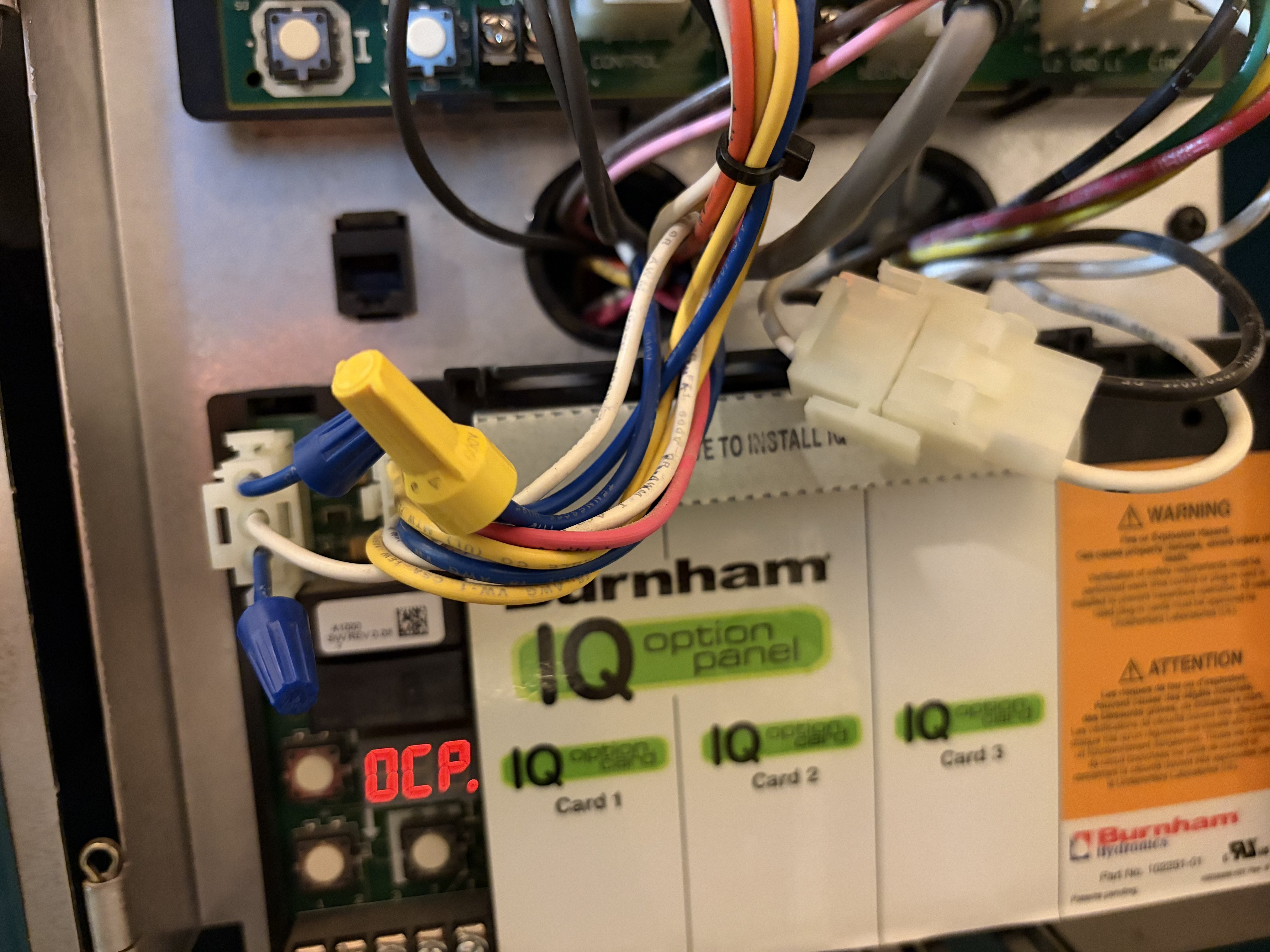

    Well, the boiler wouldn't fire up because of Err 5, so instead of replacing the board, he just jumped those wires and now it's working fine (as much as I can tell). I have notes that a board was replaced 3 years ago but I'm not sure if it was the IQ Panel or the main control board above it. My notes say IQ but I think it may have actually been the main board. Not sure.
    Two things though:
    1. I hear a faint beeping from the IQ Panel. Can that be reset and should I care? It's showing no errors and the boiler is in a room where that beeping can barely be heard. But does the beeping signal that there's still a problem I should care about?
    2. Could the IQ Panel still fail and shut down the boiler? Or did jumping the blue wires take care of that never being a problem in the future?
    is it beeping or is it more like a squealing sound? if one of the power supplies on it failed it could make a sound like that.
    it looks like you could probably just unplug everything from the iq board and it would work without it as long as the blue wires are jumped. would have been nicer to do it at the molex connector instead of cutting wires.

    Looking a little more closely, it looks like the thermostat comes in to the iq control and the only connection back to the boiler control board is a serial bus and the safety contacts so it looks like it has to be there because it looks like the heat call is being generated on the serial bus.
    i think the 2 yellows are 24vac to power the iq board.

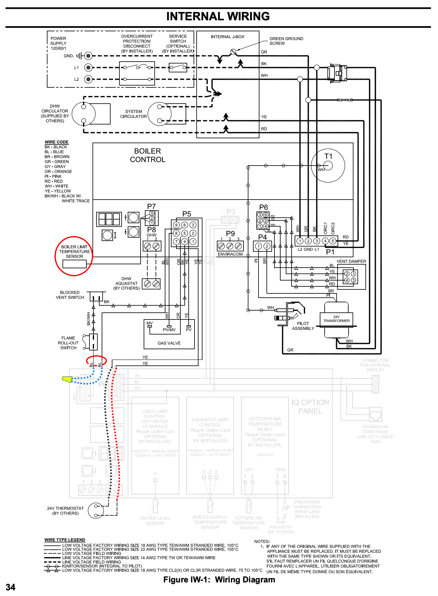

    So back to my original question.
    Is there a way to put wires together to eliminate the board?
    From what I was told, not all ES2 models have IQ so there must be a way for it to all work without it.
    I'm planning for the next no-heat / no-hot-water emergency and just want to know beforehand what the options are. As I said before, if IQ isn't really needed in my case, I'd rather eliminate it than replace it.

    you'd have to find an installation manual for one of those boilers and reverse engineer it. there are 3 possibilities that I see:
    1. The non IQ version uses a different boiler control board with thermostat terminals..
    2. Some of the unused pins on that molex connector for the IQ bard are RW/TT/XX and C for the thermostat.
    3. There is a small serial board that has the thermostat terminals and a UART for the serial bus that plugs in to the connector for the IQ board.

    OK. I found this - https://s3-us-west-2.amazonaws.com/catsy.782/ES2+IO+Manual.pdf
    I have a question. Please keep in mind I am neither a plumber nor an electrical engineer but I think I'm taking a stab at understanding this.
    Looking at page 40 in the IO manual, it looks like the wires coming into the IQ board on terminals 2 and 3 (the 2 wires on the left) can be moved to the EnviraCOM terminals on the main control board. Following the wiring diagram, I think this is where they connect to internally.
    Then the two 24V thermostat wires on the right (both labeled as T) would be spliced into the wires going into positions 9 and 7 (top and bottom left) of the P5 connector.
    Am I understanding this correctly? Would doing that remove the IQ board from the mix without breaking anything?

    It appear to me by looking at the manuals the IQ Option Board is not the option. The options are the daughter boards that plug into the IQ Option Board, not the IQ Option Board itself. I see no other normal alternative T-T screw connections, or a simpler (standard) board that has T-T connections. The T-T path just passes through the IQ Option Board, and may be monitored and / or parallel controlled by an option, if populated.
    It appears the IQ Option Board has a relay that allows any populated options to shut the boiler down. The relay (the Red box below), or the solder joints in the path to the relay may be failing. If the relay is wired in a fail safe manor, and the power supply on the IQ Option Board is failing (the noise you hear) the relay may drop out disabling the boiler. Causing a failure after 13 years of service.
    I would resist the urge to further hack up the wiring, the more wiring mess there is the more reluctant service techs may be to work on the system.

    It appears the IQ Option Board gets its power (24 VAC) from the Boiler Control board via the EnviraCOM network wiring. I believe the power conversion electronics to run the logic and maybe the relay coil power on the IQ Option Board is on the IQ Option Board (Example; 24 VAC to 5 VDC).
    Since the error below (Err 89) does exist, I believe the Boiler Control board if the system had those optional cards present expects to see their presence once learned. Since your system has no optional daughter boards the question is, if there is an error with the IQ Option Board will the boiler still work or does it cause a Lockout. I can't find that info. in the manual.
    I believe your assessment of the removal and replacement of the IQ Option Board is probably correct.
    it appears it causes a lockout by opening blue-blue since both their tech and @EdTheHeaterMan bypassed its control of the boiler by shorting blue to blue.
    i'm just not 100% sure i trust the conceptual dotted lines to be actual direct wired connections.

    To eliminate the entire system would require finding a location for the thermostat wires on the intelligent boiler control, because the boiler thermostat connection is located on the IQ panel. That is why it took me about 2 hours to remove the IQ panel. I needed to determine where all the unused wires needed to go, including the thermostat wires.
    It is doable — I just cannot remember the exact details because it was so long ago. I believe the yellow wires connected to the 9-pin P5 connector, terminals 9 and 7, might have been the thermostat wires, but it has been long enough that I cannot be certain.
    That will probably require some trial-and-error testing to determine whether the yellow wires are 24 VAC power from the transformer or the actual thermostat wires. A meter may help you determine that. Try connecting the yellow wires together with a fuse. If the fuse blows, then it is 24 VAC power for the IQ panel. If the system starts, then it is the thermostat circuit.
    After that is determined, you can proceed with removing the IQ panel because all the remaining wires will be EnviraCOM system wiring that you are not using.
