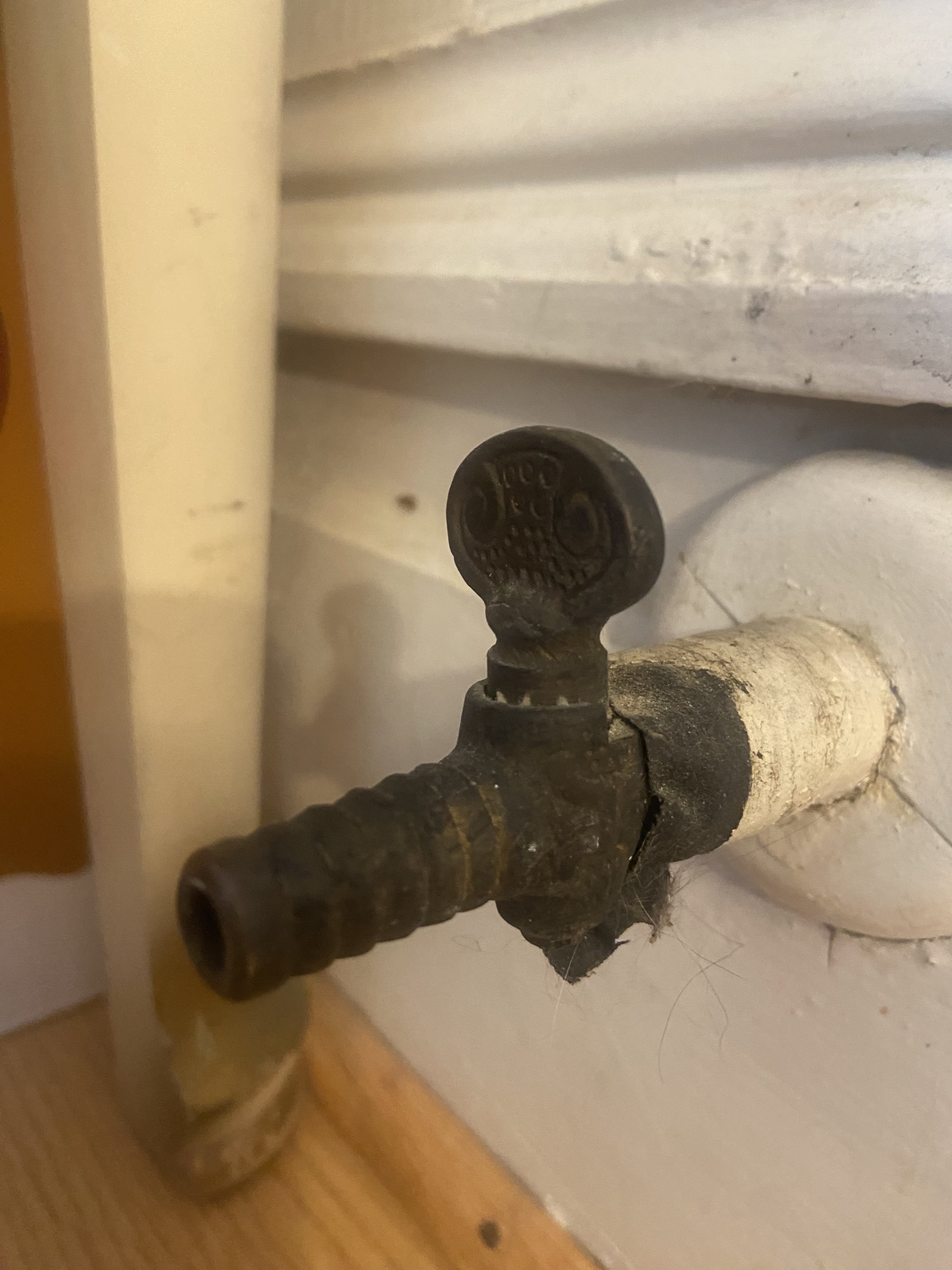

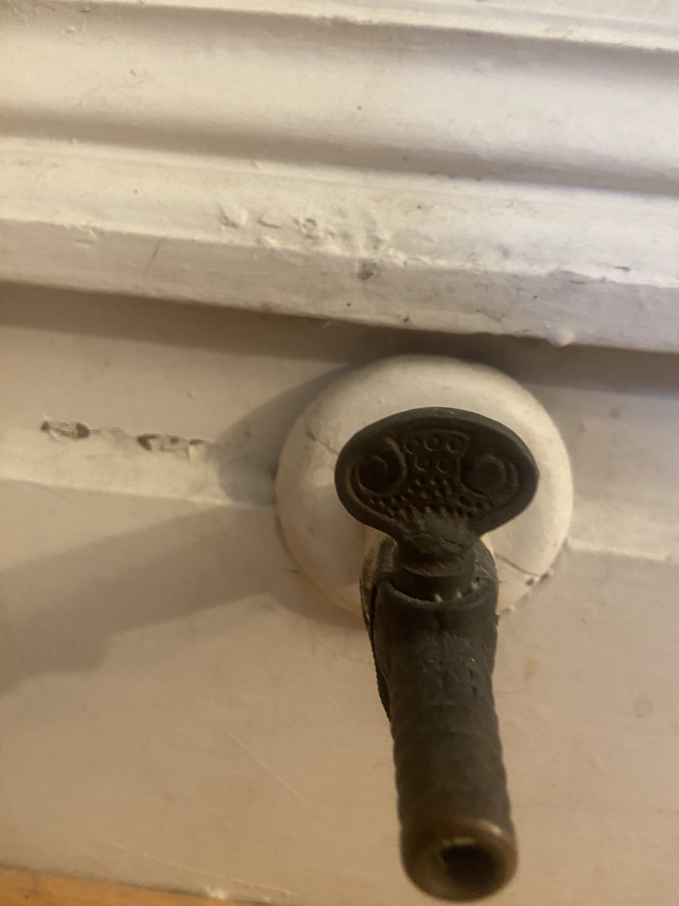

Can someone identify what this fitting was used for and how old it may be?

    looks like a gas cock, probably for a portable space heater or gas lamp. is there other evidence of gas lighting? probably from the late 19th century to the 1920's.
    pecmsg Posts: 7,654
    old gas cock

    Gas Pet Cock. Mad Dog

    Very old homes and buildings in old cities used natural for lighting the rooms. Be careful, sometimes they are still live and connected. Mad Dog

    Thanks for the answers everybody. I’ll be sure to check if they’re still connected to a live gas line.
    mattmia2 Posts: 18,437
    i mean they usually used town gas/manufactured gas which was carbon monoxide. natural gas would have been far safer. they usually got connected to the natural gas system when it came to town in the 40's and 50's.

    the op asked what connected to the barb in a private message. some people will know more than me here so i'll post the answer publicly:
    just a hose that would shove over the fitting, probably just rubber tubing but that is a little beyond my historical knowledge. gas is under very low pressure, gas piping is more like ductwork than piping, the tension of the rubber is enough to keep it from leaking. it is like a chemistry laboratory. there are engineered connectors for labs with reinforced hoses and rubber bushings that connect to the barb now but in the early 90's when i was in high school those were just becoming a thing so i don't know if there was a heavier duty connector for them in the early 20th century or if it was always rubber tubing.

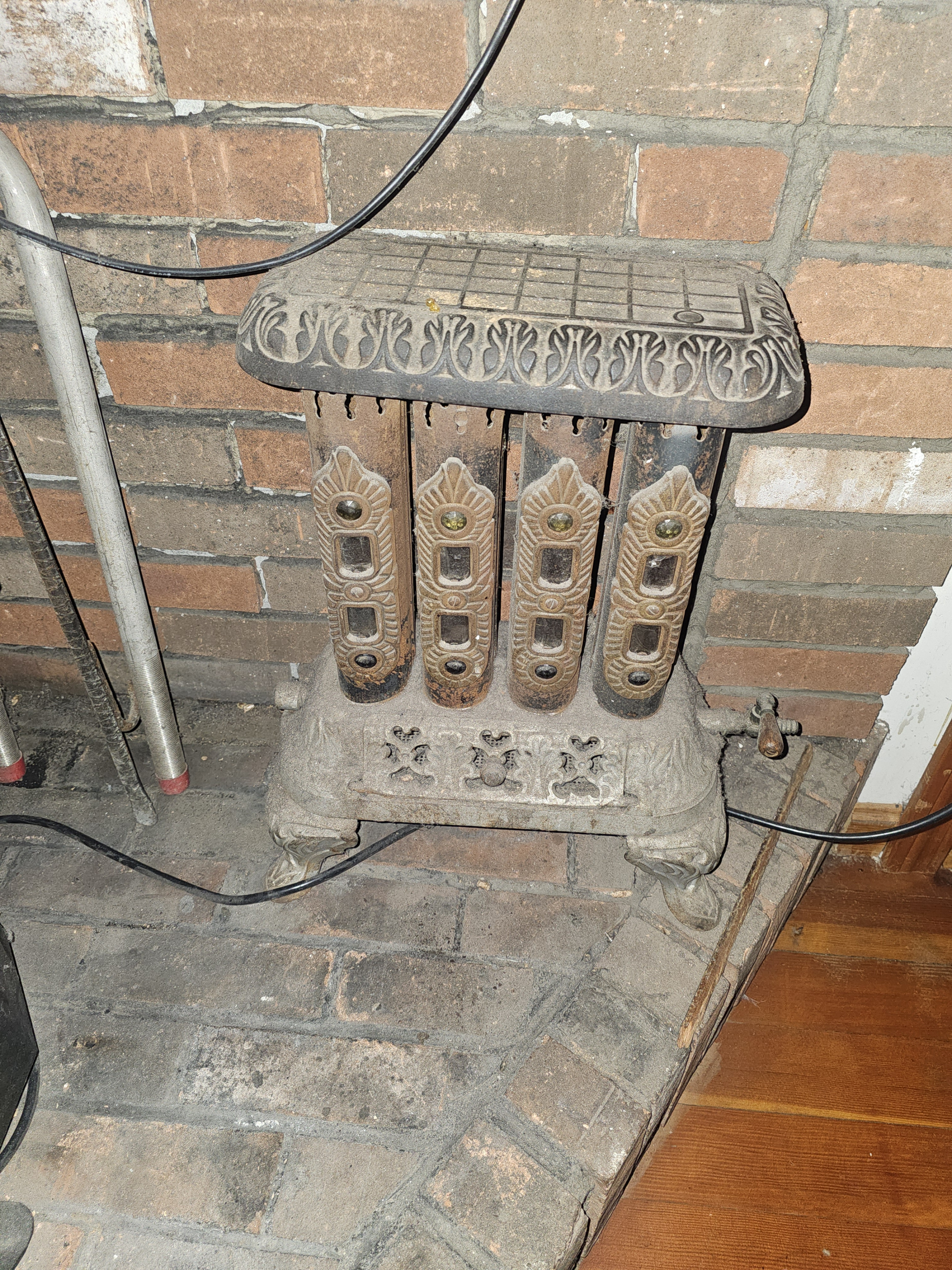

    Our 1850 farmhouse in MI had lighting fixtures with gas-cocks like that, that ran on acetylene gas made from a gas generator that used calcium carbide and water.
    Steamhead Posts: 19,022
    Might have also been for a gas heater.

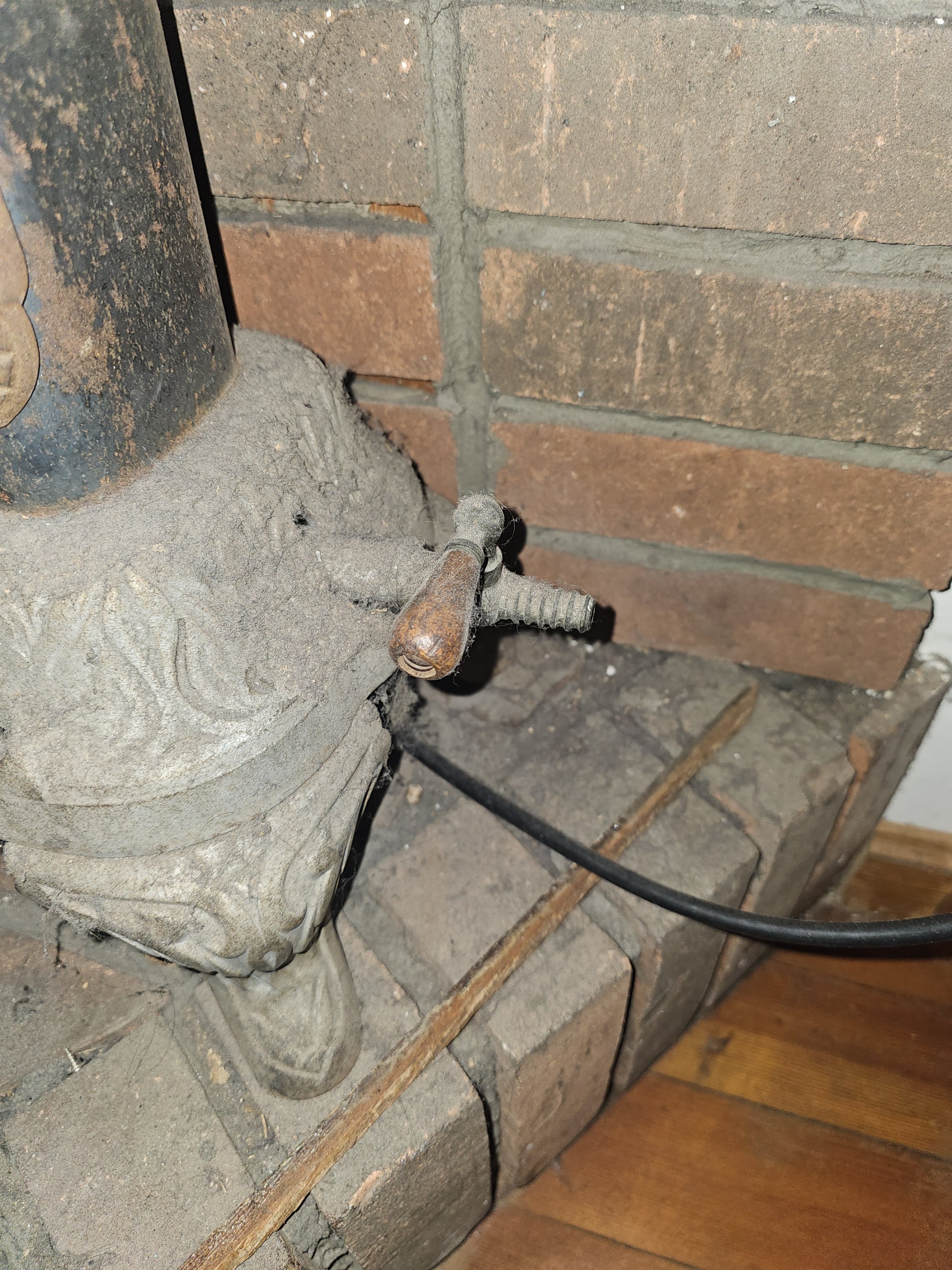

  • Considering the gas valve was installed so low to the floor it was probably installed for something like this.

    I'd love to test that for CO 😨
