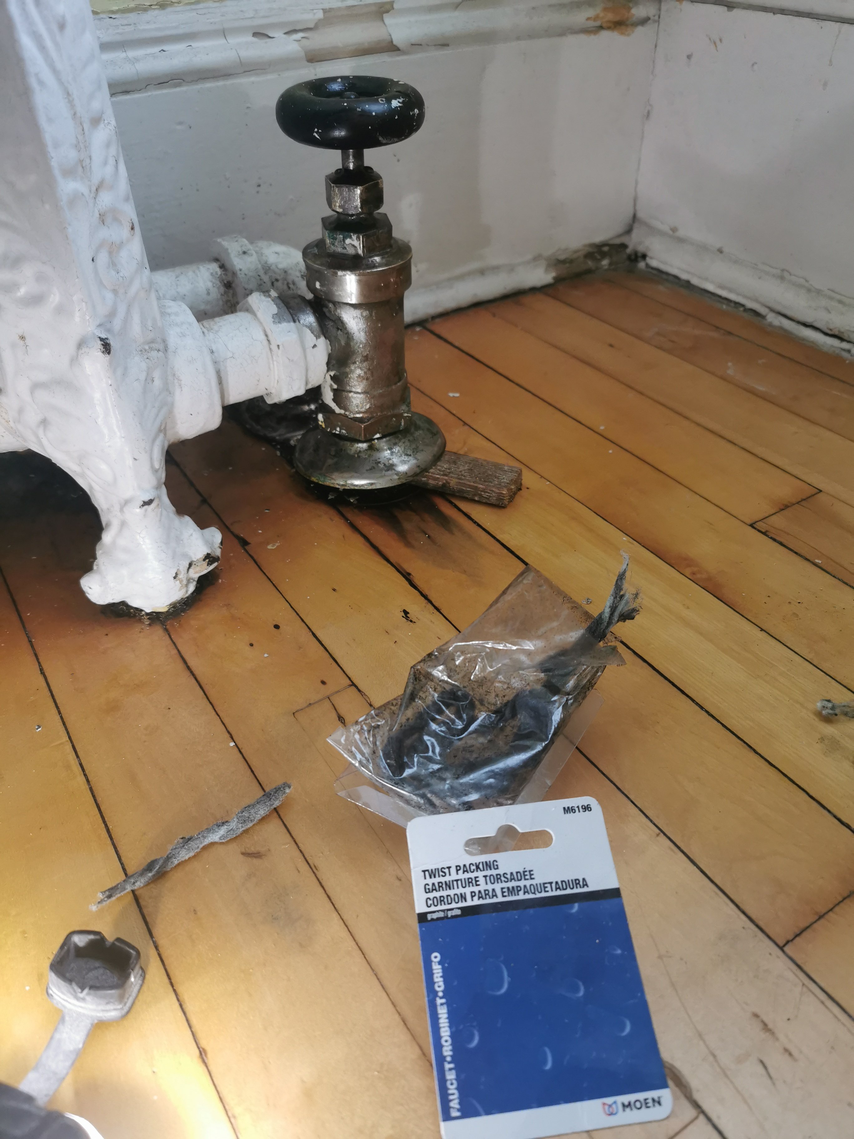

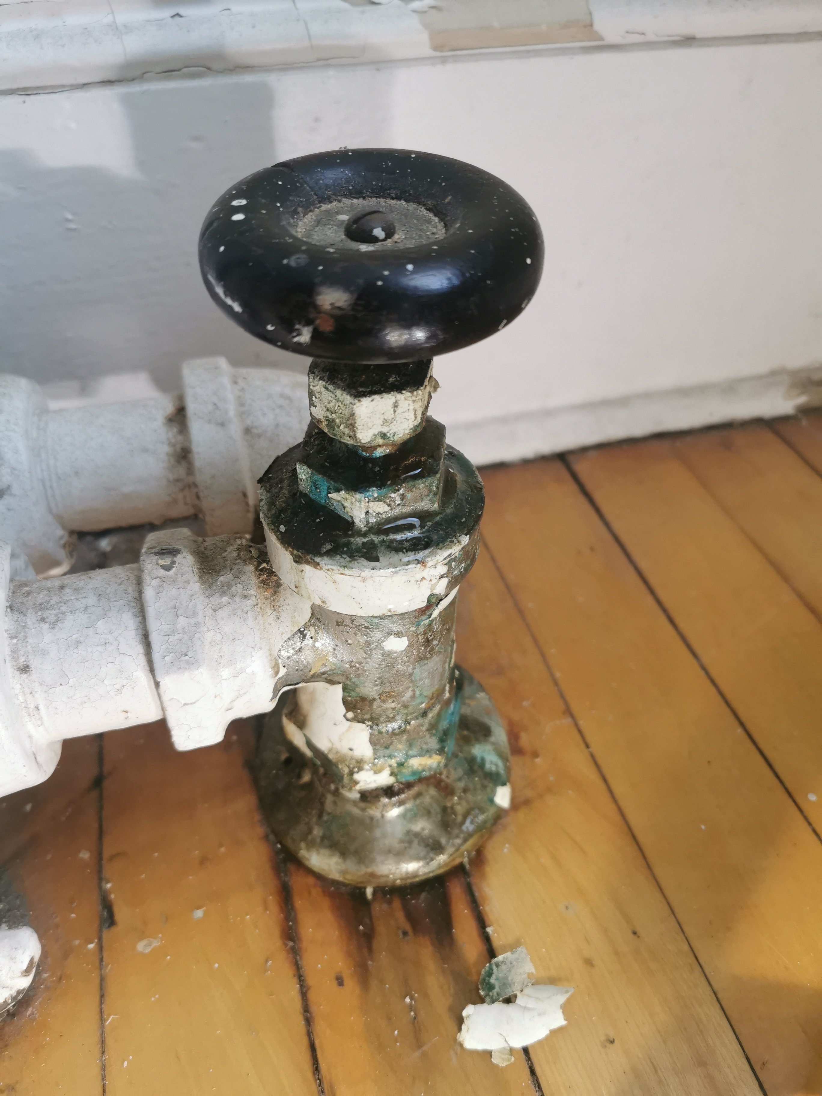

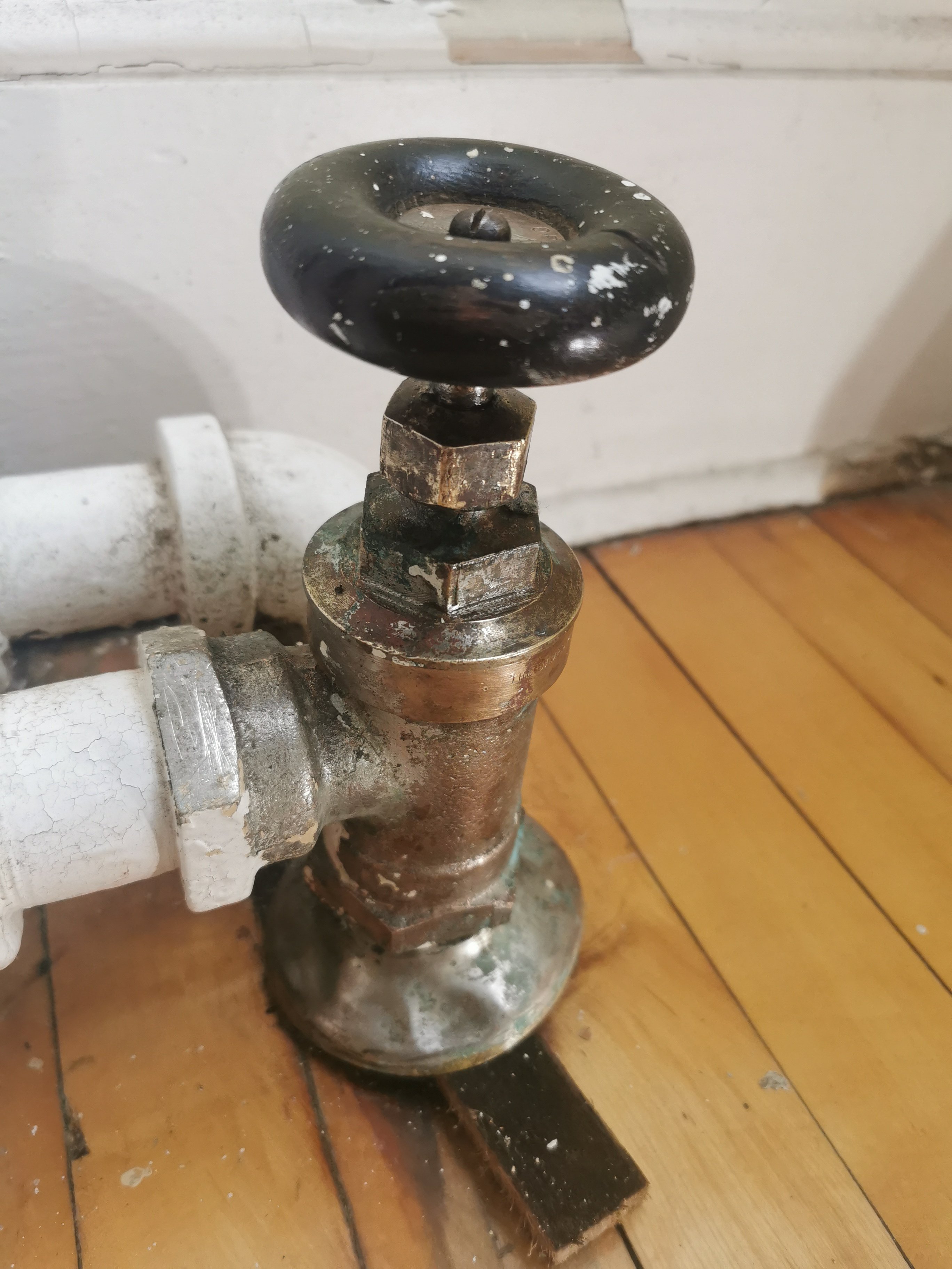

    I still haven't been able to locate the source of that leak, despite turning up the heat and waiting for the radiator or a pipe in the area to start leaking. It never leaks when I'm ready for it to. It hasn't leaked at all for 2 months. However, I discovered another leak at a different radiator a few days ago, and the source of that leak is visible and apparent. See below:

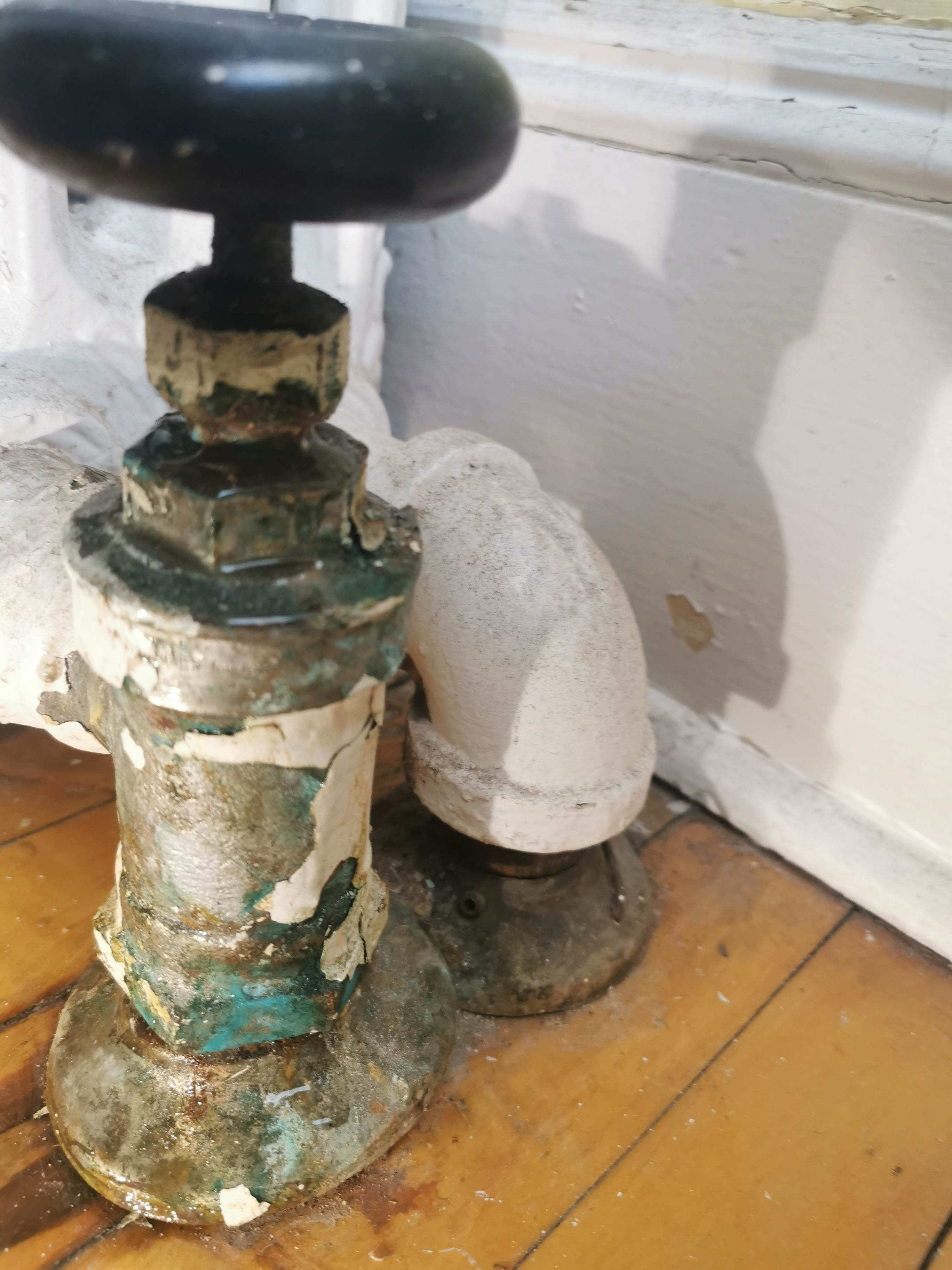

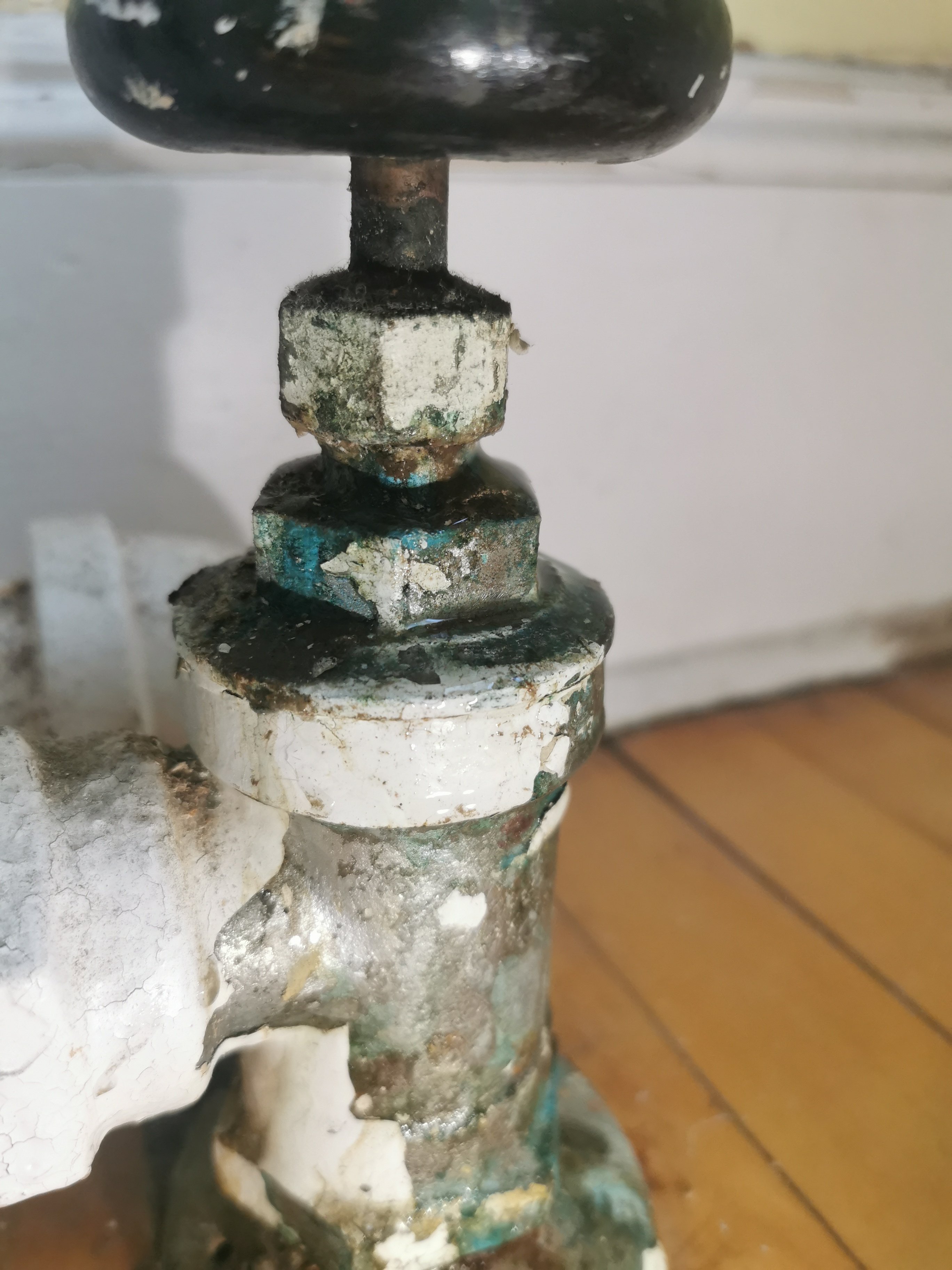

    The leak is coming from either the top nut below the wheel or the 2nd nut. I think I should replace both of them, and the length of pipe that comes out and goes into the wheel. That short section of pipe is likely copper, although I'll have to take a closer look. IDK what material the nuts are but will know after scraping off more of the paint.
    Should I also replace the wheel, or keep it?
    The pipes coming out of the floor are 5.5" in diameter so I'll just replace them with the same diameter. They're probably threaded galvanized steel.

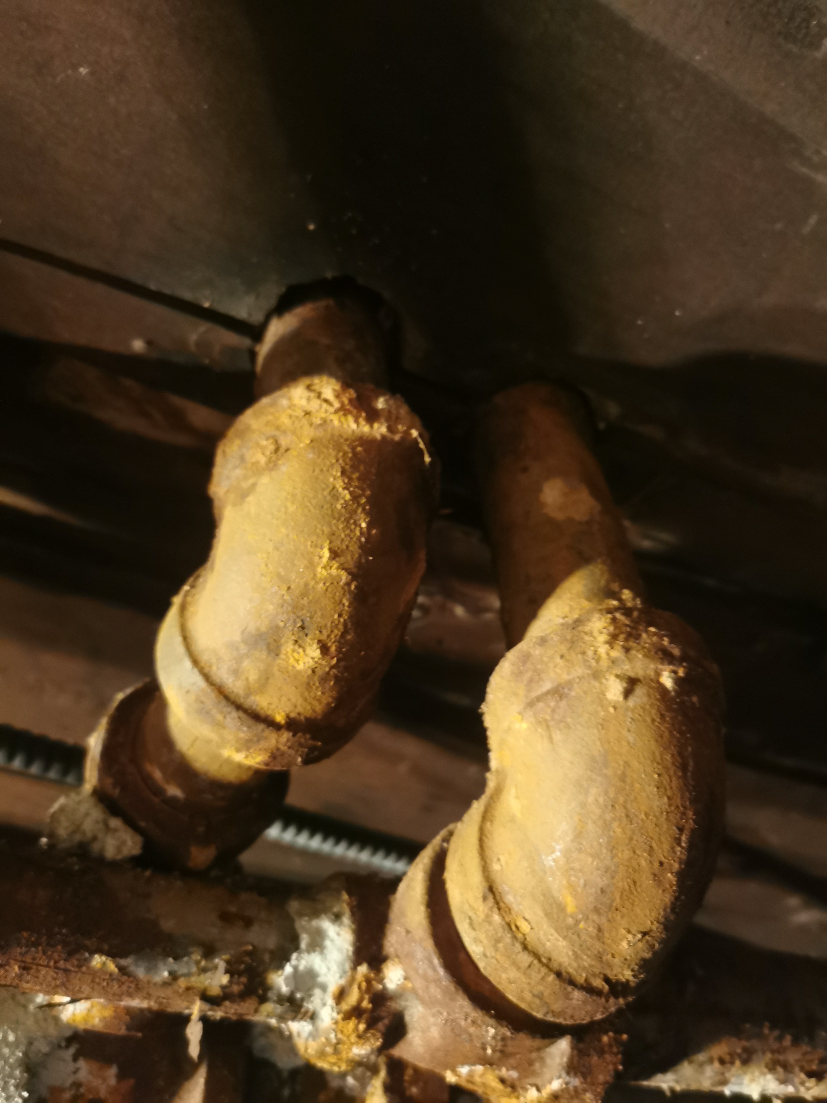

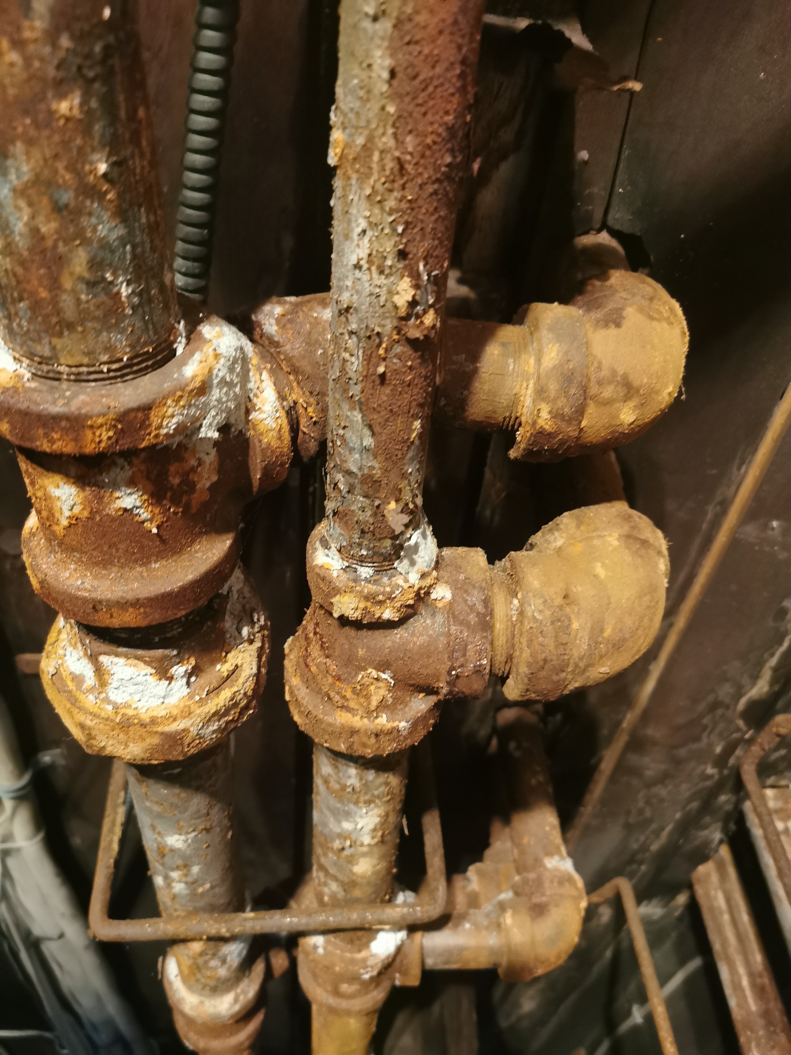

    That's pretty straightforward. Unfortunately it gets worse, as the pipes and connections below it look very corroded. I followed them to the basement, where I found these:
    First, before I went to the basement, I lifted up the pipe cover to find severe corrosion:
    This is after I scraped off the worst of the rust, corrosion and dirt with a wire brush:
    They look like this for a good 30 feet until they're well into the boiler room. Am I supposed to replace all of that, or are they fine and it's ok for them to look this bad? Is it a problem?
    How far do I need to replace? Just the top nut? More? Am I going to be able to attach brand new fittings/pipe to such corroded galvanized?
    it is leaking from the packing because it is wet above the place where the bonnet threads in to the valve body. put a little string packing in there, don't go crazy with tightening the nut because you can crack it, put a little in, tighten it, put a little more in if you need to and repeat until you stop the leak. cleaning the stem with scotchbright or steel wool will help too.
    it looks like there is friable asbestos on those pipes and probably in the general vicinity.

    Looks like the packing nut on that radiator shut off valve needs new packing . Drop the pressure of the system , remove the handle if you can . The packing nut below handle seals the valve stem . Loosen the nut from the valve bonnet and wrap the stem with teflon tape or rope. Reinstal the packing nut , catch a few threads with the nut first before using a wrench, and dont over tighting the nut . You do not want to strip or split the packing nut or you are stuck replacing the valve …Best to add packing a little at a time ..
    Good Luck
    Just the packing on the valve stem. No need to do any of the other things you mention.

    Thanks all, that's good news. Is packing string as effective as teflon, or more effective in this case? Because I'll buy some if it is. Otherwise, I have teflon here.
    hot_rod Posts: 28,699
    leaks like that tend to come and go
    When the system is hot, expansion can stop seeps like that
    In the off season parts contract and are more prone to leaking
    A stem packing will be the easiest of leaks to repair, threaded joints, maybe not as easily repaired

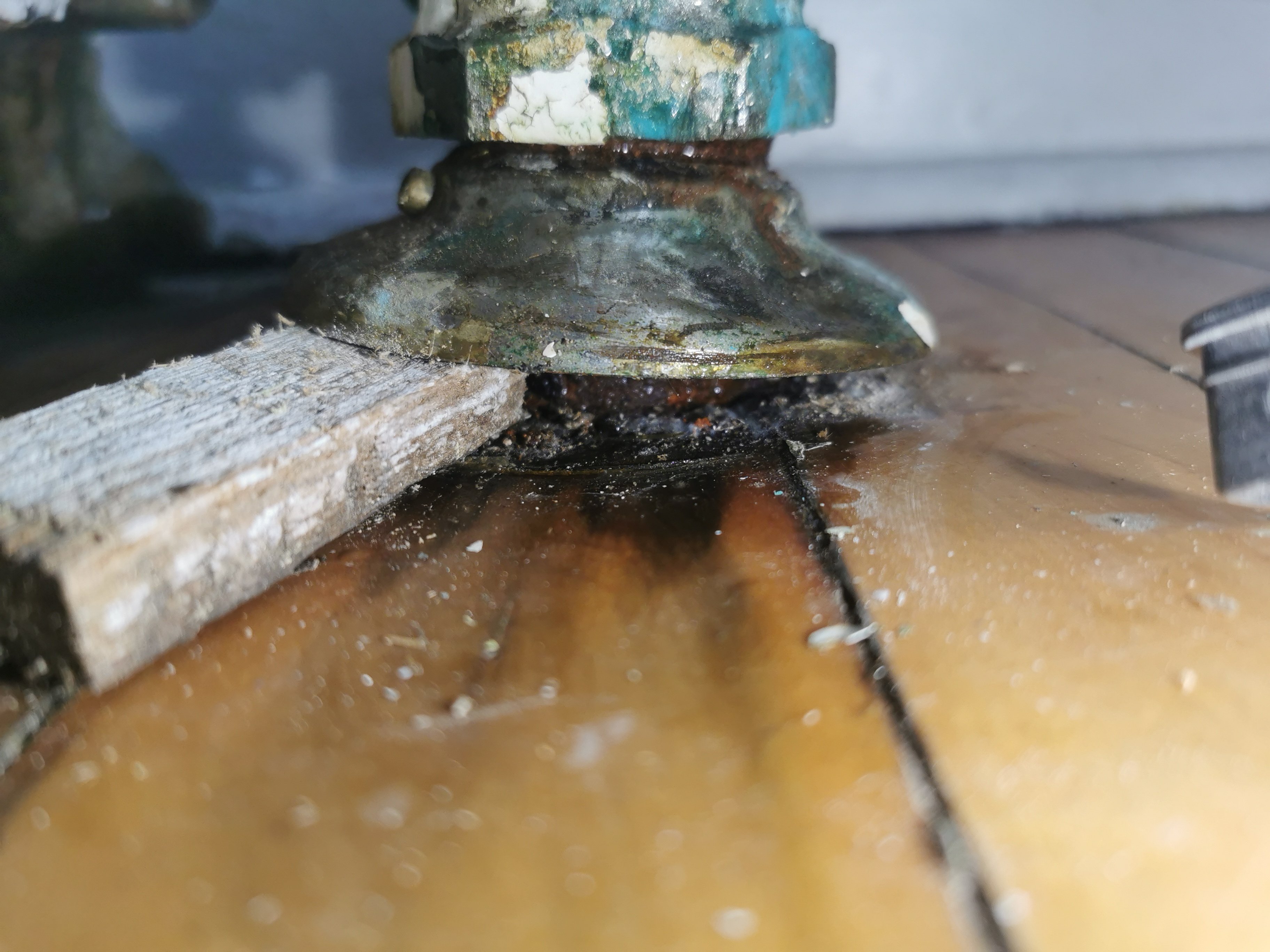

    MOEN 1/8" x 24" Graphite Twist Packing was the solution. It's thicker than the string that was in the packing nut before, but on the second try, I got it to fit snugly around the spindle and up inside the packing nut, and after several hours, it's not leaking. It leaked after my first attempt, yesterday. So this morning I watched an instructional video on using graphite packing. Armed with that, I tried again. On my 2nd attempt, I packed double the material in. One length wrapped around the spindle, the other circled around inside the packing nut itself. Turned the handle to ON, came back an hour later, no leaks. Came back an hour after that, still no leaks. So I think it's fixed. I'll keep checking on it. I didn't even turn the house water off the 2nd time.
    After 1st attempt
    After 2nd attempt
    ironic that the name slapped on it is a company that only makes washerless faucets.
    you can put a little piece in, tighten the nut down, back off the nut, put another piece in and you can pack it in that way. if you try to shove all of it in at once you can crack the nut.

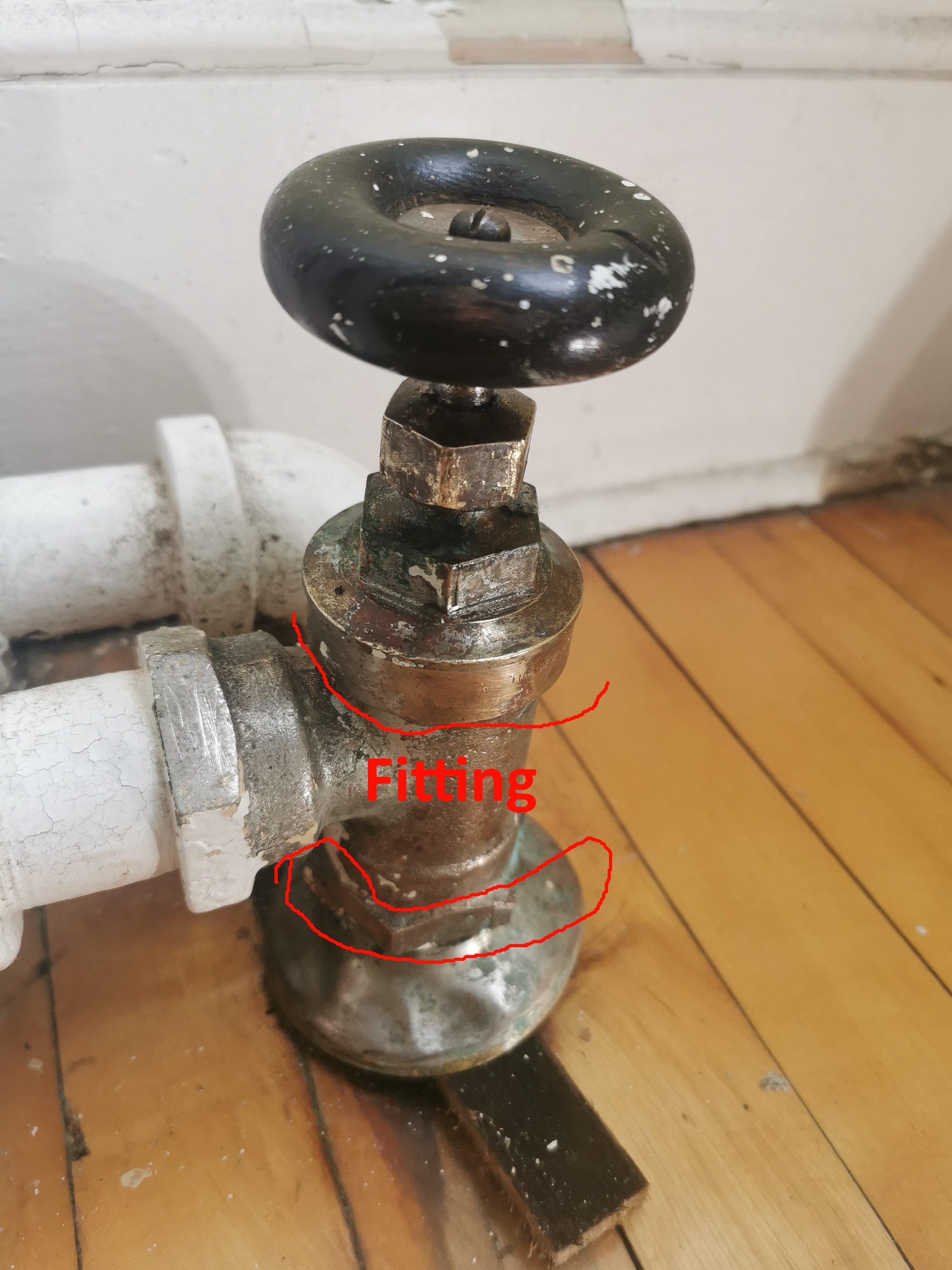

    he isn't suggesting you should replace anything, he is just trying to figure out how that valve got there and saying it may be difficult to replace because there is no union to unscrew the valve.

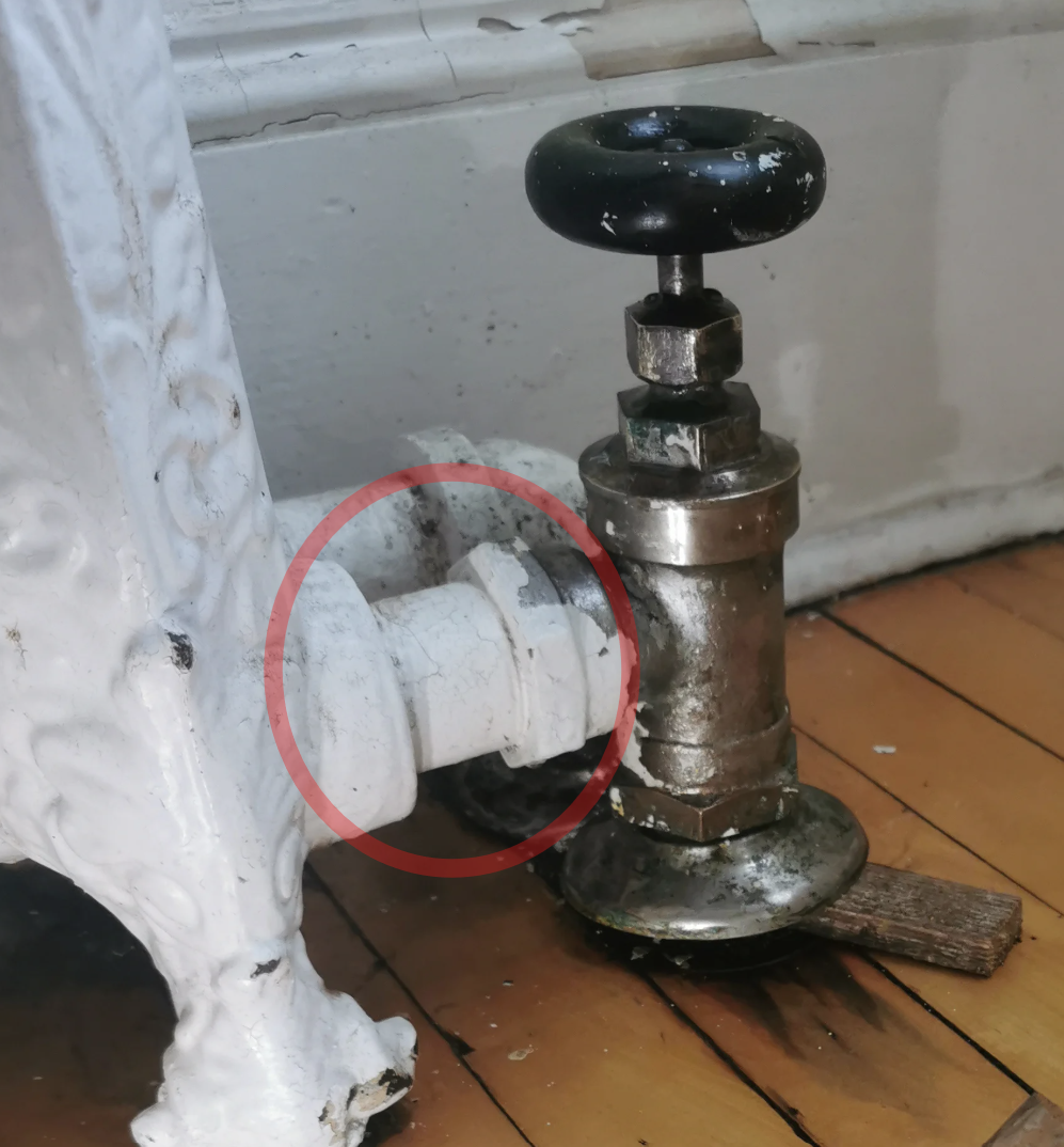

    he thinks this nipple may be right hand tread on one end and left had thread on the other:
  • Larry Weingarten
    Larry Weingarten Posts: 4,210
    Hi, Being a domestic hot water guy, I'm pretty clueless here, but might that actually be a union nut circled in red? 🤔
    Yours, Larry
    Grallert
    look at the other picture, it is just a female fitting.
  • sjh
    sjh Posts: 70
    edited July 8
    Oh, ok. To replace that, if it was necessary, I think I would have to first disassemble everything above the red line I just drew in, unscrew the fitting from the red peanut shaped 'ellipse', then twist the fitting off.

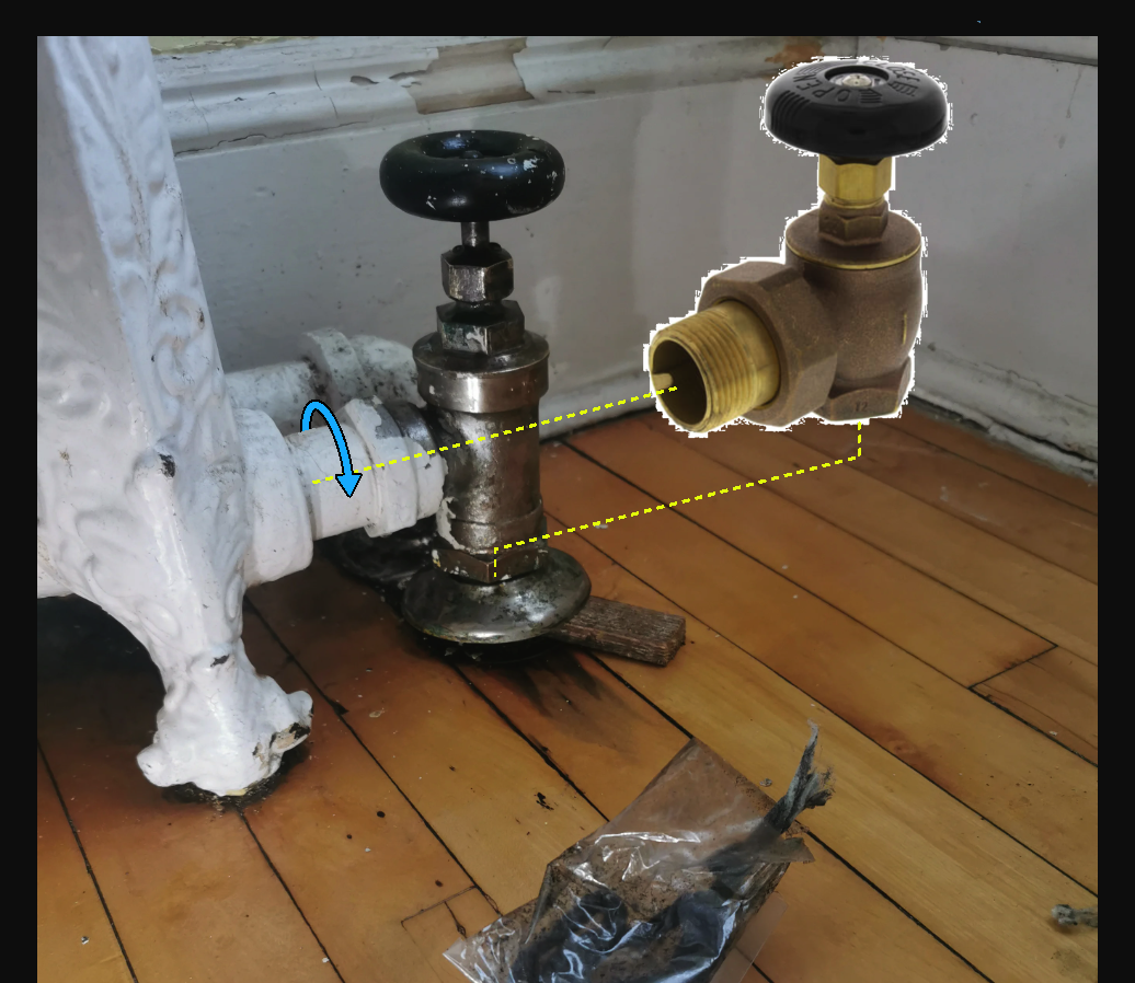

    the problem is that you'd have to turn all of the piping in the basement to unscrew it from the bottom of the valve or disassemble it up to that pipe. most likely the nipple i circled is left hand thread on one end and right hand thread on the other so you can turn it in one direction and both ends tighten and loosen at the same time because each has opposite threads.
    EdTheHeaterMan Posts: 12,940
    The most plausible assembly is the left-hand threaded nipple that is shipped with the valve, which also has left-hand threads, as indicated by @mattmia2 .
    Untitled Image
    I can’t see anyone doing all this work behind the scenes, starting at the radiator and ending up in the basement. You would normally start at the boiler with the biggest pipe (the shared piping) then reduce the pipe size as you branch off, until you terminate at the radiator location. After each branch, you would then reduce the shared piping as enough BTU capacity was delivered to the branches, until you reach the last radiator on the main pipe at which point the main has been reduced to the size needed to feed that radiator.
    Most valves come with a matching union spud that is threaded into the radiator and connected to the valve, or to the return bend on the return side, so the radiator can easily be removed without a bunch of pipes being removed from inside the walls back to the basement. That just does not make sense.
    When you want to paint behind a radiator, you just remove it and then put it back. The only way to do that with this connection would be to back out the opposite-threaded nipple the has been indicated by the red oval in the picture above.
    If you wanted to replace that valve, you would need to remove the nipple from the radiator and remove the valve as indicated by the blue arrow.
    If it did not move with an 18" pipe wrench with a 3-foot pipe over the handle for leverage, then I would cut it out with a saw near the valve so there was something left to grab with a pipe wrench, after filling the nipple with some wooden dowel to keep the pipe from crushing.
    Then you could fit a 36" pipe wrench on the cut-off nipple stub, with a 6-foot pipe over the handle for leverage. That will surely break those threads.
    Once you have the female thread on the radiator ready to accept a male thread, and the valve off of the riser ready to accept a female valve thread, all you need to do is put the new valve in place.
