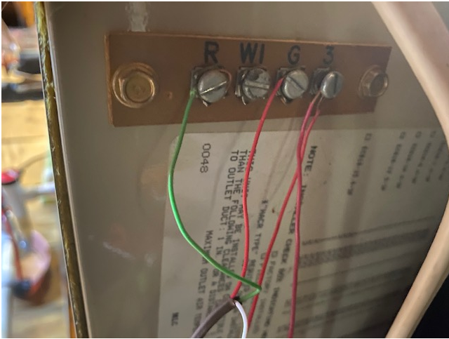

Could you possibly dig into your bag of tricks and spells and find a wiring diagram that explains the thermostat wiring for a 1989 Lennox Air conditioning unit? I was up in the attic and I noticed the low voltage board on the air handler only has 4 screw terminals for wiring between the Thermostat, air handler and the compressor (R, W(I), G, 3) but the W(I) does not have anything connected to it but the other 3 terminals do.
The air handler is CBS18-31-P (I do not see any boxes checked on the label to indicate heat strips are installed)
The condenser is a HS1.8-311-7p
The thermostat is a typical Honeywell RTH65XX wifi series (not sure of the exact version)
Everything is working and has been since 2018 when I bought the house, but as always when I notice something weird and can't find any information on it via the regular search engine, I come here to the best search engine out there Heating Help :)
Any ideas what the terminal # is for and also why the W(I) may not be connected.

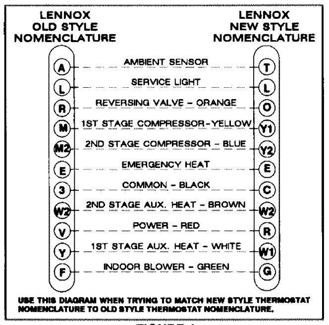

    109A_5 Posts: 4,759
    Maybe this will help.

    I think that explains it, it looks like the labeling on the air handler could be a little from column A (new) and column B (old)
    R (new) - power
    W1 (new) - aux heat - not used on my unit
    G (new) - indoor blower
    3 (old) - Common wire

    Thats what was throwing me off. I did not have some of the typical letters you're listing there. This is all I have.

    And don't you just love the color coordination from the colorblind installer. The Red wire goes to G and the Green wire goes to R.

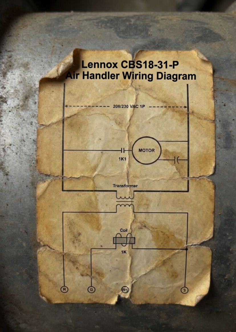

    And 3 has two red wires. Perfect for future technician confusion! I found the wiring diagram for your AHU! …or did I? Look at my edit on the bottom of my previous post @PeteA
    Untitled Image

    the 2 reds are probably because of 2 wire red and white cable to the condenser

    I will take a closer look at the multiple reds and how many conductor wires come up to the one spot in the attic tonight now that the sun is not beating on the roof. I am sure you're correct that in order to make things work, multiple wires were run in order to branch off to different parts of the system.
    Thermostat, AHU, Condenser and then the hotwater boiler in the basement. I'll make an attempt this season to get the wiring more coordinated to todays standards to avoid any confusion later in my more senior years when I try and fix this stuff myself.
