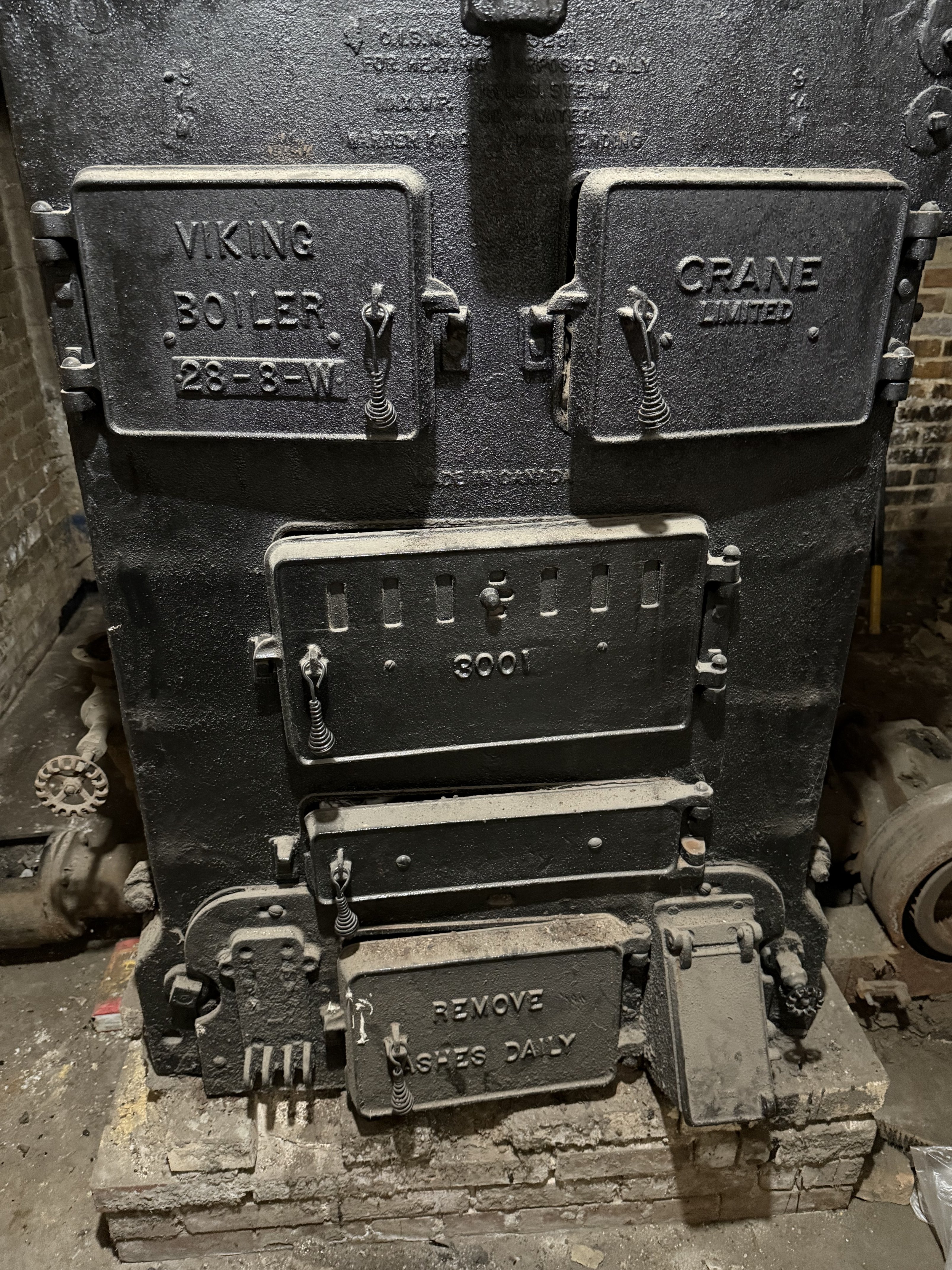

i am currently removing a 1930-40s boiler that is a crane viking 28-8-w. does anyone have any tips on removing the auger? does it go last? i have some pictures of the boiler and can post more of the auger if needed.

    the stoker is probably the first thing to remove, it was likely added later.

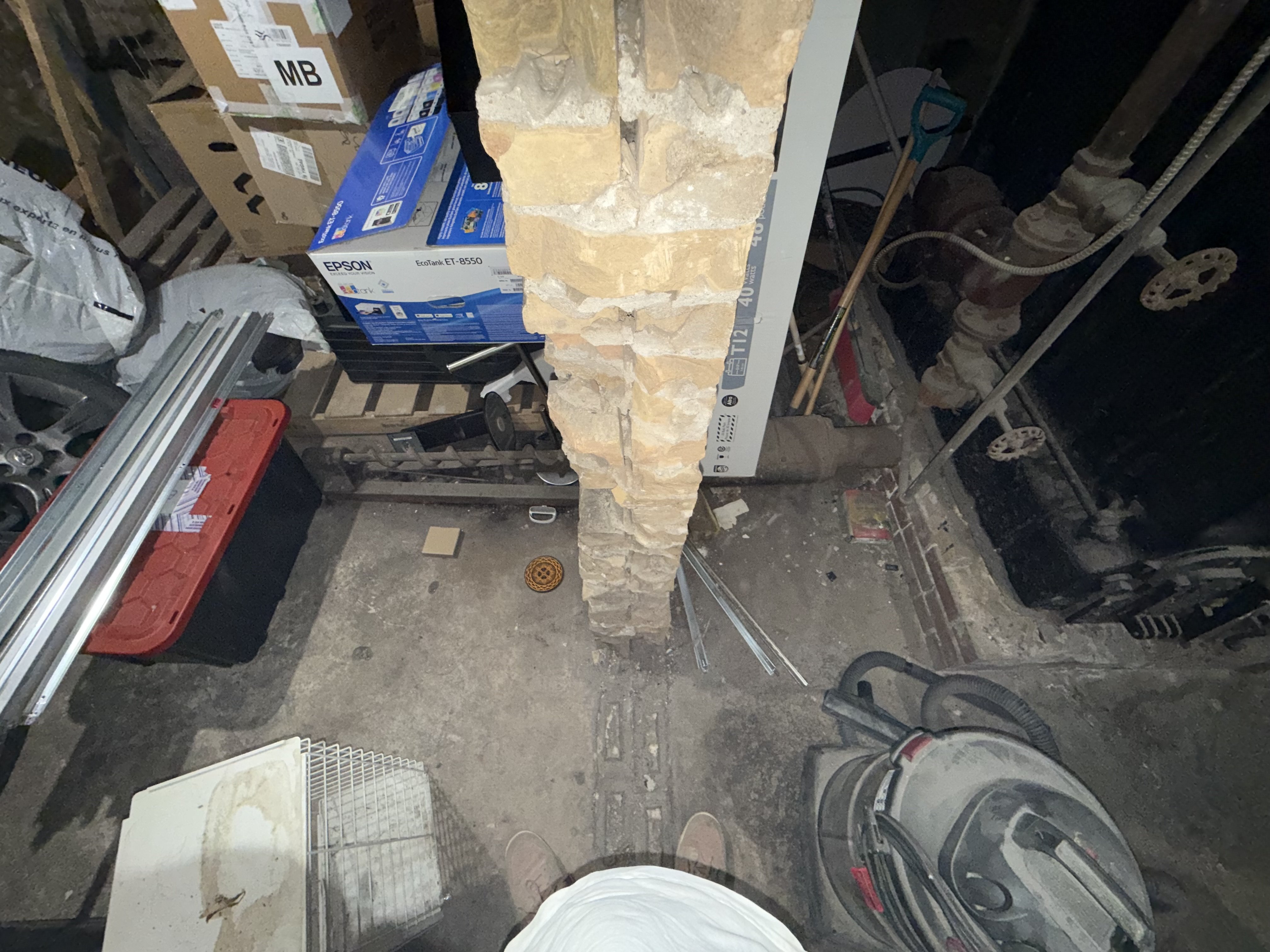

    that brick collum needs work.
    do not bump it removing that beast.
    mattmia2EdTheHeaterMan
    it looks like it used to be a brick wall. i would probably put a temporary post or a frame under whatever it is holding up depending on what exactly it is holding up.

    Are the rocking coal shaker grates still in the firebox?????
    Does the end of the ash auger have a square metal piece that would accept a long metal handle with square opening to allow the user to rotate the ash auger?
    hot_rod Posts: 28,699
    why does the auger need to come out?
    EdTheHeaterMan Posts: 12,940
    I would guess that you need to remove the front section and then everything else will just fall out with no problem. How many men are you using to carry out each section? the front looks like you need as least three Hulk Hogan type men and a Boy to take that out in on piece. Other wise you will be making a real mess with sledge hammers to make that front section into about 4 smaller pieces.
    When I sold a new boiler to replace something like that, I would cut the pipes from the boiler with a Sawzall or Torch, and hire a demolition company and just point at it. That way my back would still be in good enough shape to install the replacement.
