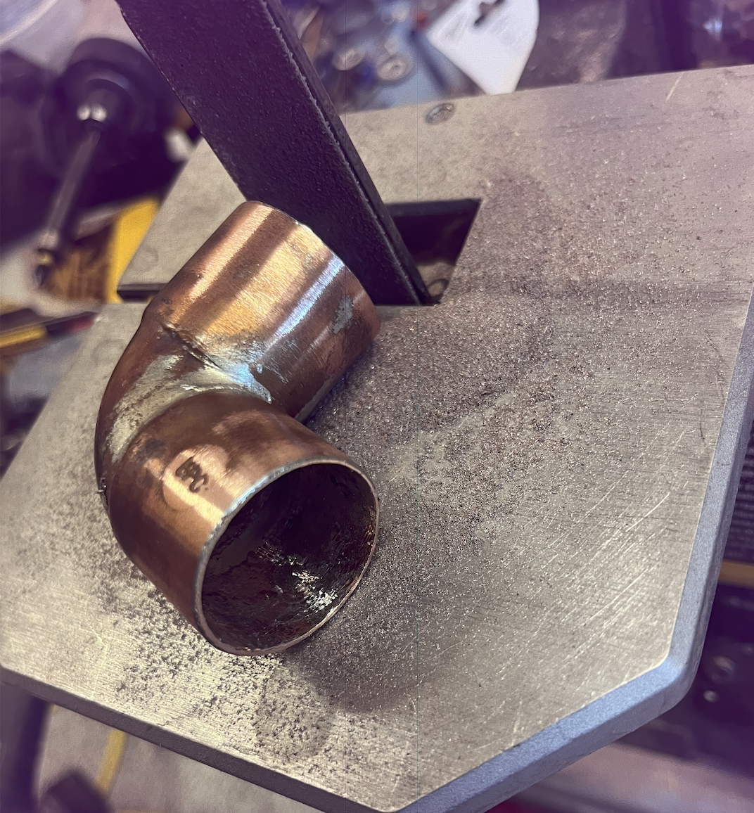

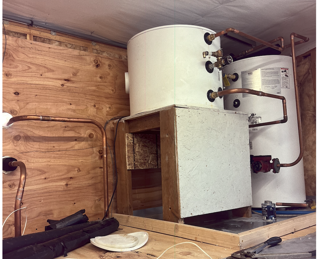

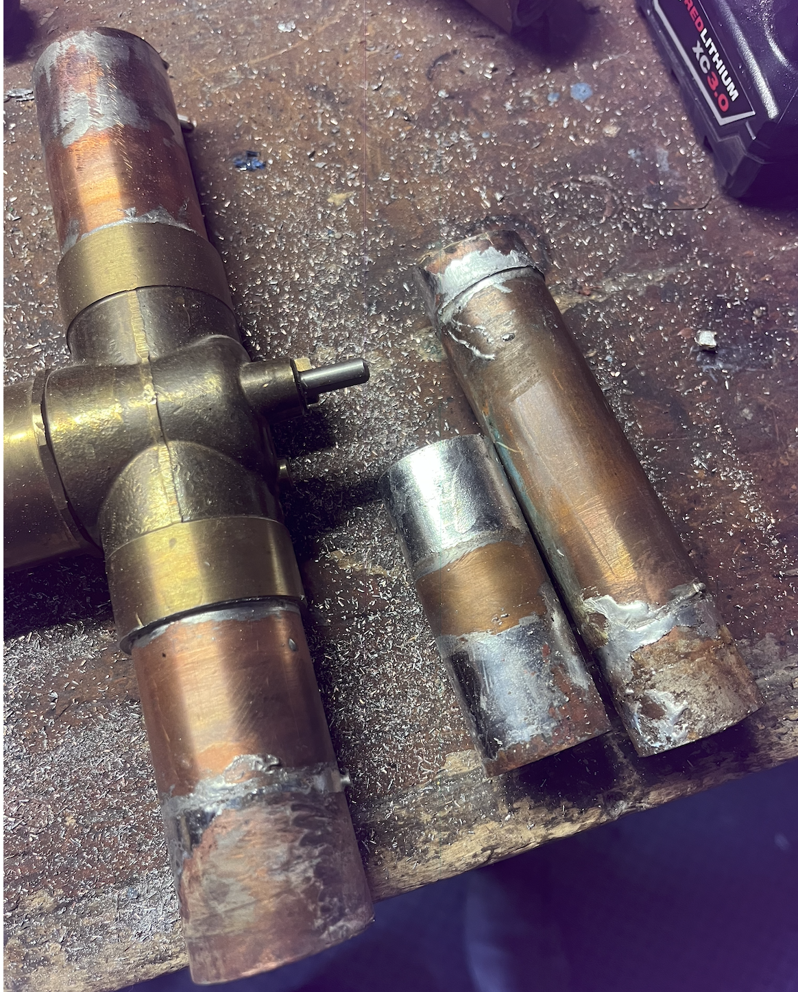

This was part of my shop system, installed in 2021.
I'm disassembling and repiping, re-using the old sweat fittings.
I remember feeling these joints were not pulling in solder as they typically do. However it was and has been leak free.
I tracked it to bad flux. Maybe too old? Or contaminated with oil or pipe dope? Regardless with a new can of flux the soldering is back to normal. Although many of the joints soldered fine? Certainly a workmanship issue:(

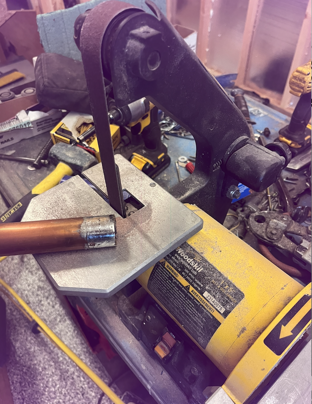

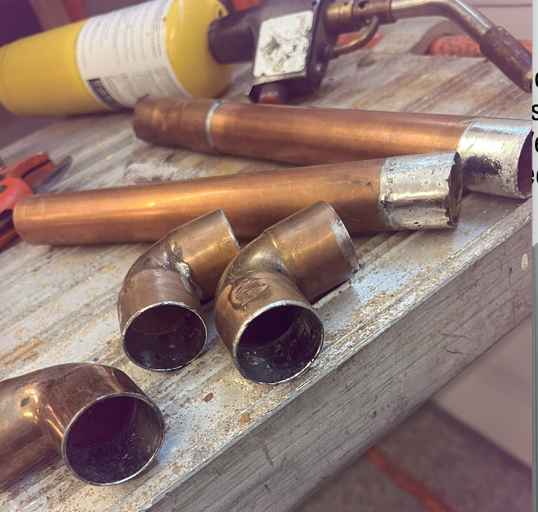

Here is how I reused about 30 copper sweat fittings.

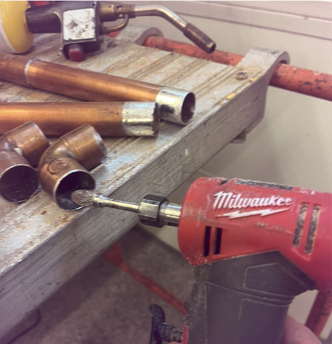

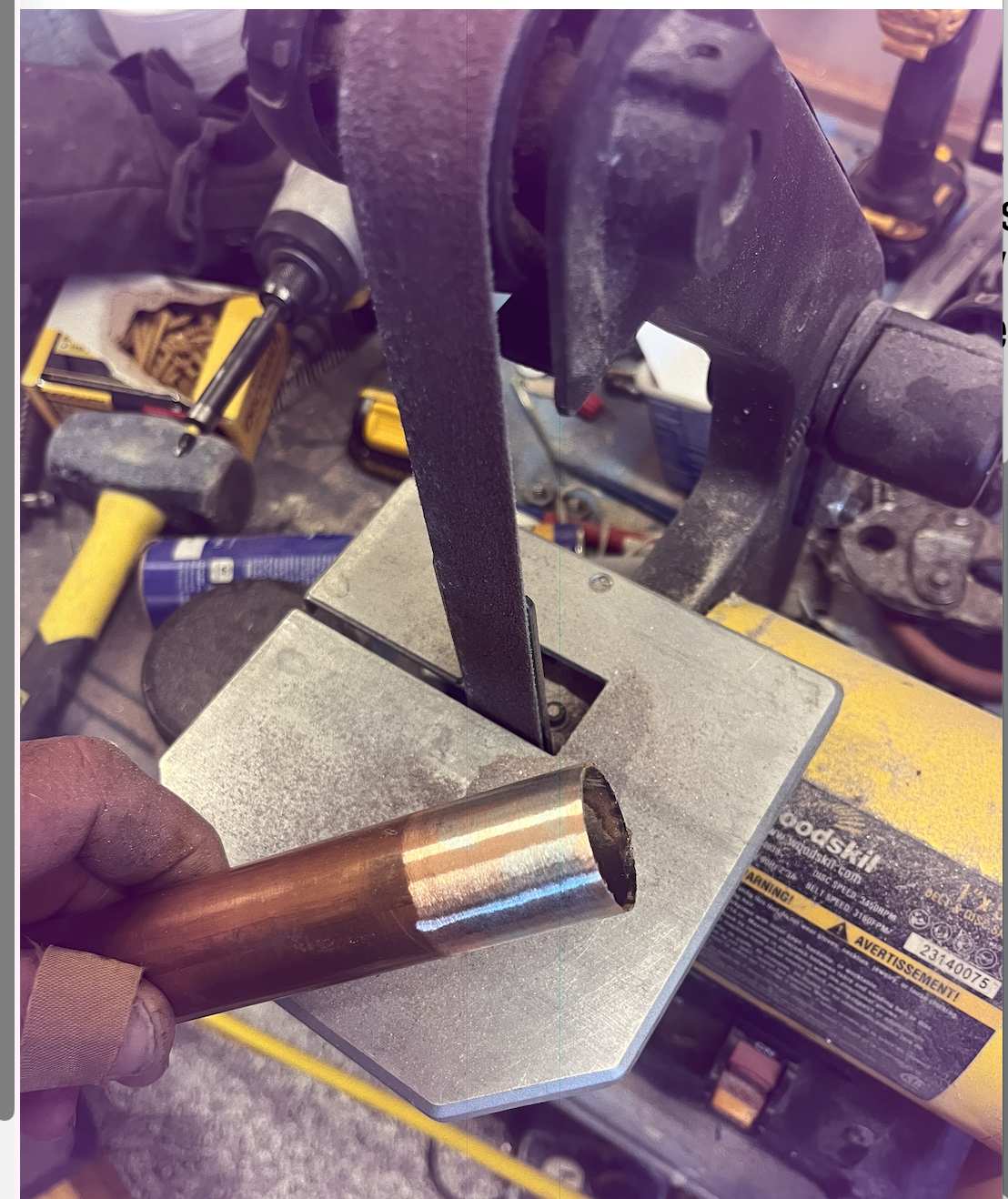

Milwaukee die grinder to clean out the fittings, a 1" belt saner to prep tube and clean outside of fittings.
I priced out press fittings for the rebuild, well over 200 bucks. I'm not a fan of press with glycol, however. Seen too many green fuzz seapers.

    could jsut get a reamer that is the id of the fitting. after seeing that sort of thing on stuff i have done i make sure i brush all of both surfaces with flux.

    I have used a 7/8 holesaw also, but it can grab easily. The die grinder, at low speed, it's variable, has been my best method so far. I also have fitting brushes for the cordless drill, but they don't remove solder build up too well..

    Drainback solar on right, lines to heat pump on left.

    what if you turn the hole saw backwards? the solder should be soft enough to still cut that way. the reamer might also be super pricey and only chuck up in a lathe or milling machine. the die grinder seems tedious. maybe put the bur in a drill press.
    I like the fitting brushes that go in a drill or driver but they are only good for cleaning.

    Every few jobs, I take the cover off the flux and scoop out the nasty black residue with a paper towel and stick a new acid brush in. Mad Dog

    I have had the "contaminated flux issue". A lot of people around here use the "Utility Brand" flux which I don't care for.
    I remember being sent to help a coworker finish a job where we were sweating Pex adapters to baseboard. I brought my torch in, and he had flux and solder. Utility flux. It looked okay but I did 3-4 joints with it, and I just didn't like the way it acted.
    I went out to my truck and got my container of "Nokorode" and it was fine after that.
    I learned through the years to buy flux in small containers (8oz or smaller..) and keep the cover on it. No sense risking contaminating a large container
    It can make a difference.

    I can do 100 joints with Silvabrite solder an Nokrode and have maybe 1 leak. Works for me.

    You have more patience and time than I do. Copper sweat fittings really aren’t that expensive considering the time it takes to clean up an old one. I agree, I think it was likely bad flux. I used the same method as Mad Dog. If I saw my Nokorode flux discoloring on the top, I’d scoop out however much was needed until I saw its original color. I also strictly used Staybrite #8 solder. Expensive? Yes. I have no idea what it costs now because I’ve been out of the game for 6 years. I rarely ever had a leak and the joints were clean. I still have 3 1/2 roles left.
