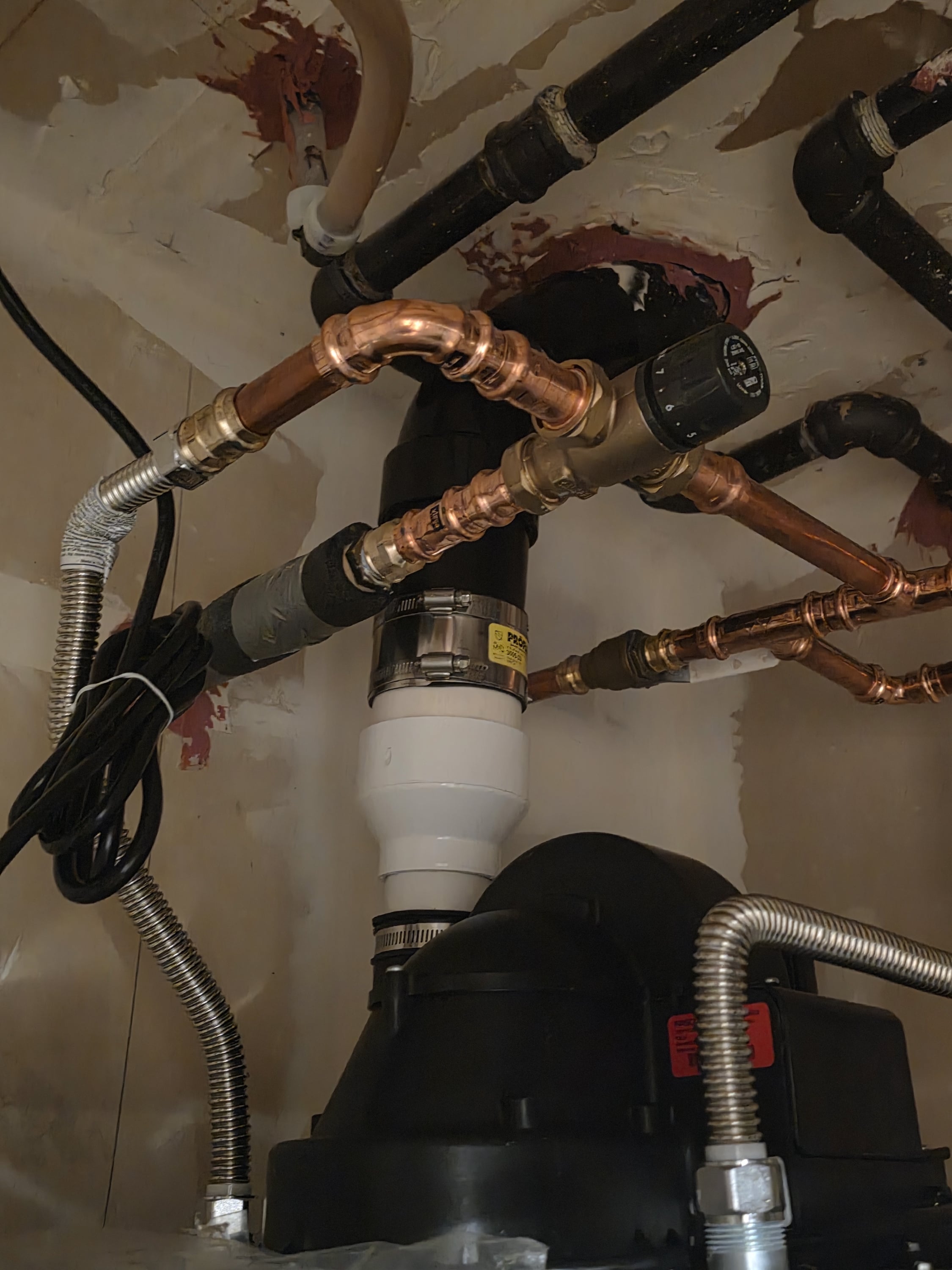

Hey folks,
I am looking for ideas for this setup. The current blower is a new one and heater is a new one. Yet we have replaced blower 2 times and same effects persist.
You can see blower attached to a white / black vent. This pipe vibrates on touch. This subsequently vibrates a portion of house. Also the fan has some humming voice but my heating guy says its expected.
I need help, am I doomed to have vibrations in house when heater runs + weird mmmmm sounds?
Any ideas or tips help as my quality of life is impacted and heater guy is not giving me promising ideas
I am leaning on your help and appreciate it

    Most likely problem is that the blower wheel — the fan — is out of balance. Something stuck on a blade that shouldn't be there? Out of balance from new (shouldn't be, but not unheard of)? But with two new blowers…
    A bit difficult to do, but can you take the blower off of the rest of the system — set it on a bench or something — and run it all by itself, as a test? That would isolate the problem.

    Thank you. I was thinking of that too, but what exactly am I watching for? To compare the 2 blowers or excessive vibrations?
    Also, is there no way to just absorb shock between blower and the vent pipes? Something like Fernco P1056-33 flexible coupling
    Jamie Hall Member Posts: 27,644
    The blower, by itself, should not vibrate perceptibly at all. If it does, it has a balance problem — which may be remarkably hard to isolate, unless it is something obvious.
    If you are dealing with hot air, not exhaust, there are flexible couplings which can be had or fabricated, depending on the duct work — but that's a band-aid on the symptom, not a fix.

    if the piping is right up against structure it may telegraph normal vibration in to the structure. I would concentrate on using some sort of resilient mounting between the structure and the vent.
    some of the blowers in powered vent water heaters are very loud as well. it might just be that it is engineered for price, not to be quiet.

    I would cut out the firestop around the abs 90 at minimum and maybe some sheetrock and see if the vent has some flex to it. If not it might be pinned against the structure and the normal noise made by the blower is resonating thru the structure. It might even be pinned against the gas piping.

    I had a bad vibration on a sidedraft blower that was audible throughout the house. It was kind of a bad resonance between the blower and another component (IIRC, the electrical box, but it doesn't matter exactly). I "fixed" it by placing a one- or two-lb weight on the vibrating part. (I used a C-clamp.) This shifted the resonant frequency, and greatly reduced my audible vibration.

    This is fixes humming or noisy fan problem for me when I weight it down with my hands. But unfortunately still the forced air or something is strong enough to vibrate the pipes? :O
    HVACNUT Member Posts: 7,584
    So this is the second blower assembly on a new tank and its same noise? What is the exhaust venting touching besides the high temp silicone? I just replaced a power vent water heater for my in-laws, and it purs like a kitten. Is the tank level and stable?
    I can zoom in pretty good on the pic, and I don't see glue or primer evidence on the PVC. Are those joints glued? IDK what the black pipe is. ABS?

    Black pipe is ABS, I am not sure if pvc is glued. This blower was replacement to first brand new blower. But it is definitely noisy and not quiet. I can link my reddit https://www.reddit.com/r/askaplumber/s/EnRlEIt1Om
    Plumber suspects its vent pipe vibration not unit itself

    Hi, Another test would be to remove the blower, hold it in your hand (safely) and power it up. Does it still make the noise then? I'm just trying to get to the actual source of the racket.

    I had a similar noise problem on the new Goodman furnace that was installed in my home a couple years ago. There was a humming noise when the furnace called for heat. The installers and their service people came out many times but could not find the source of the problem. They replaced the exhaust fan twice thinking that that was the problem. I discovered that the problem was caused by the exhaust pipe not held tightly enough and allowing the pipe to move slightly and cause a vibration against a wood member. The fix was to install a couple clamps to hold the pipe tight against the wood member and adding a flexible rubber coupling.

    Thank you! So for me its the black ABS pipe? To clamp it and steady it as much as possible to stop it vibrating?
    mattmia2 Member Posts: 17,753
    it might have shifted so it is touching the structure somewhere when the water heater was replaced
