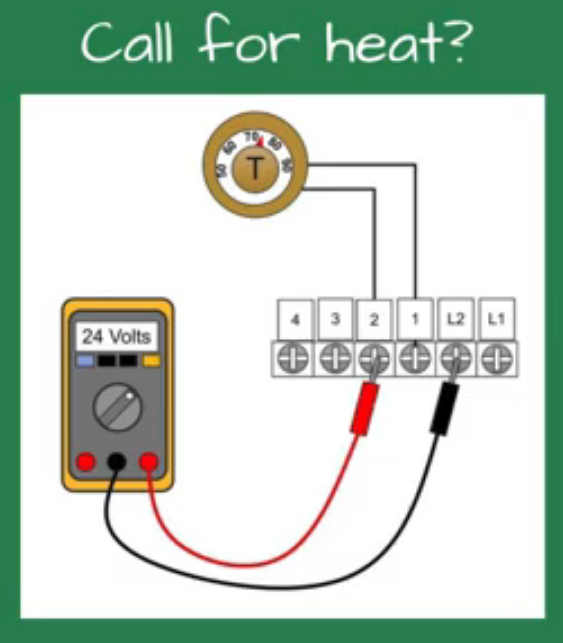

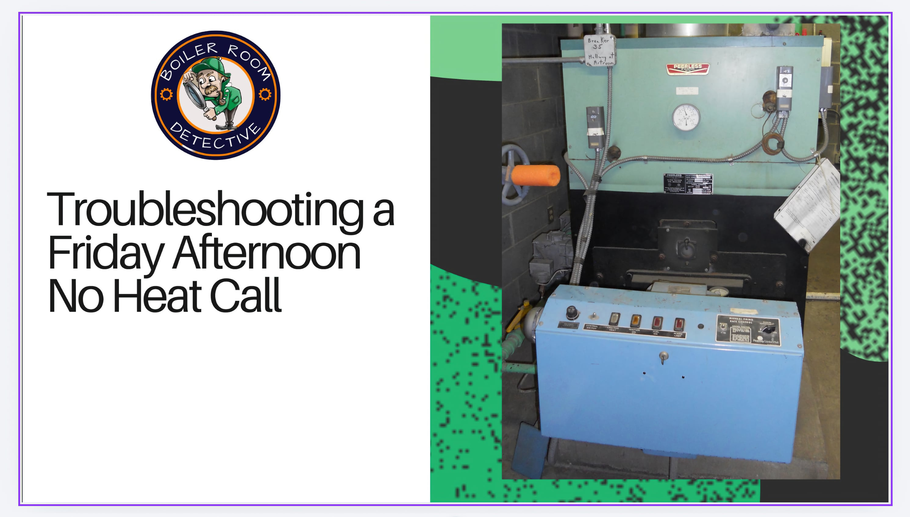

In this week's video, I talk about how to electrically troubleshoot a friday afternoon no heat boiler call without an electrical diagram.

    Is this really what you meant to show at 2:30 ? Wouldn't you want to measure the voltage across the thermostat and its wiring (terminals 1 to 2) ? If the thermostat (or its wiring) was open there would be 24 VAC as you show.
  • RayWohlfarth
    RayWohlfarth Posts: 2,091
    @109A_5 Thanks for watching and the question. I was showing that if there is power on terminal 2, it means the thermostat was closed and calling for heat.

    That was a good explanation for how to check a no heat call on a power burner. If you are speaking to a newby you may have to explain it in more detail. By the way, are there still Gordon Piatt burners out there. They were one of my least favorite burners and that Bryan boiler was a mess. I saw a lot of them in that same condition. Thanks Ray.
  • RayWohlfarth
    Welcome @retiredguy I hated them as well and we used to repp them eons ago.
