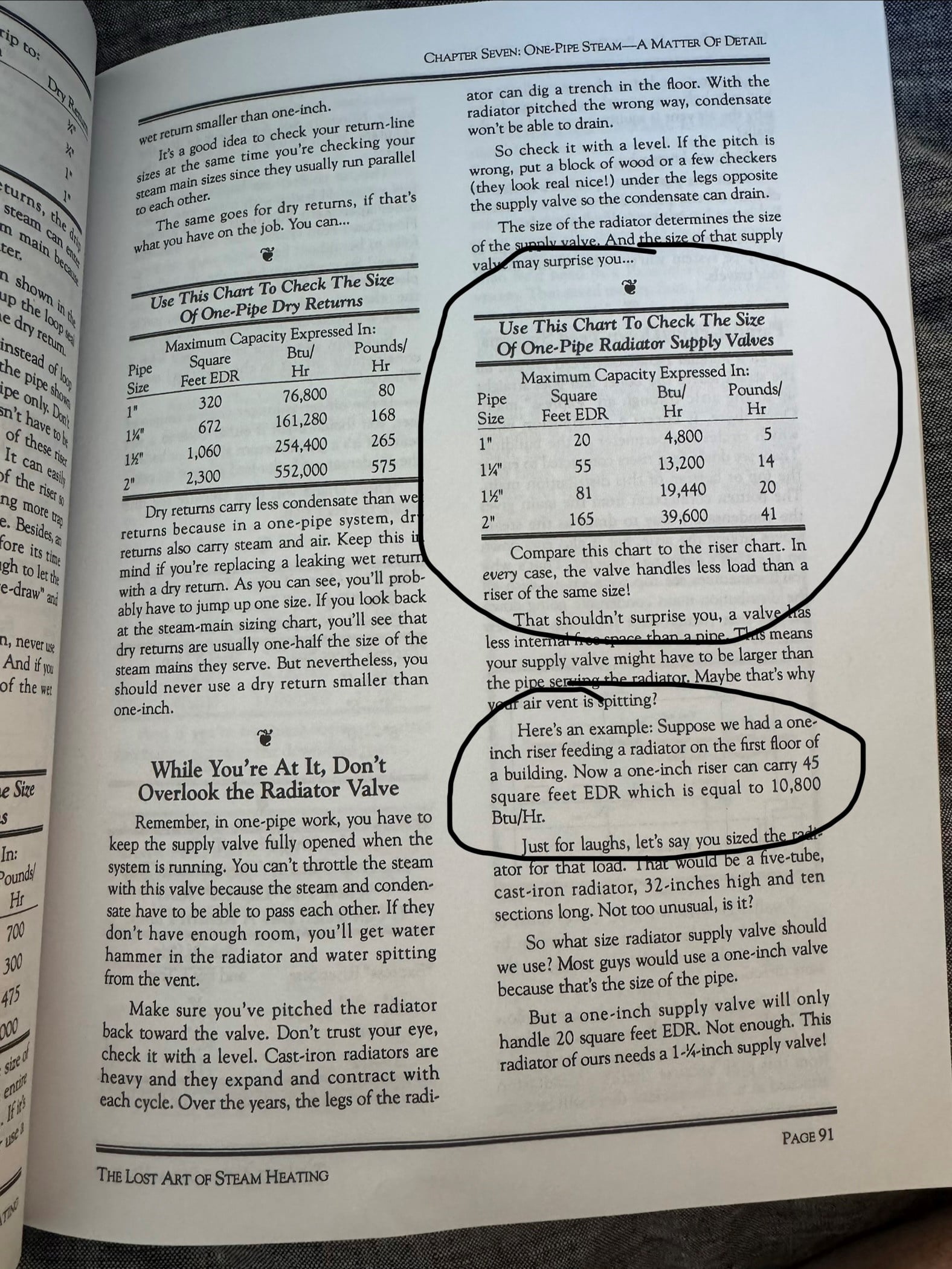

    In case helpful, I took a photo of the relevant page in the Lost Art of Steam Heating regarding EDR capacity of one-pipe radiator supply valves.
    EDR.jpg 854.3K
  • Robertw
    Robertw Posts: 95
    @NY2024 Thank you. I couldn't remember the exact number's ,just that it was a possible situation. I appreciate the follow up.

    Not sure what would make the vent "spit" in this scenario, but I'm dealing with a similar scenario. I have a 24 EDR radiator (2 column, 6 sections) on my third floor. This radiator is fed by a one inch riser connected to a one inch radiator supply valve. I have a maid-o-mist size 6 vent on the radiator. Generally, when the steam begins to move past the 4th section of the radiator and into the 5th section, the radiator begins to have water hammer inside the radiator. My assumption of what is causing this is that the one inch supply valve is too small to accommodate both the incoming steam and exiting condensate. This off-season, I am going to try to replace the one-inch supply valve with a one-and-a-quarter inch supply valve (or perhaps just remove the supply valve entirely and run one-inch pipe directly into the radiator).
