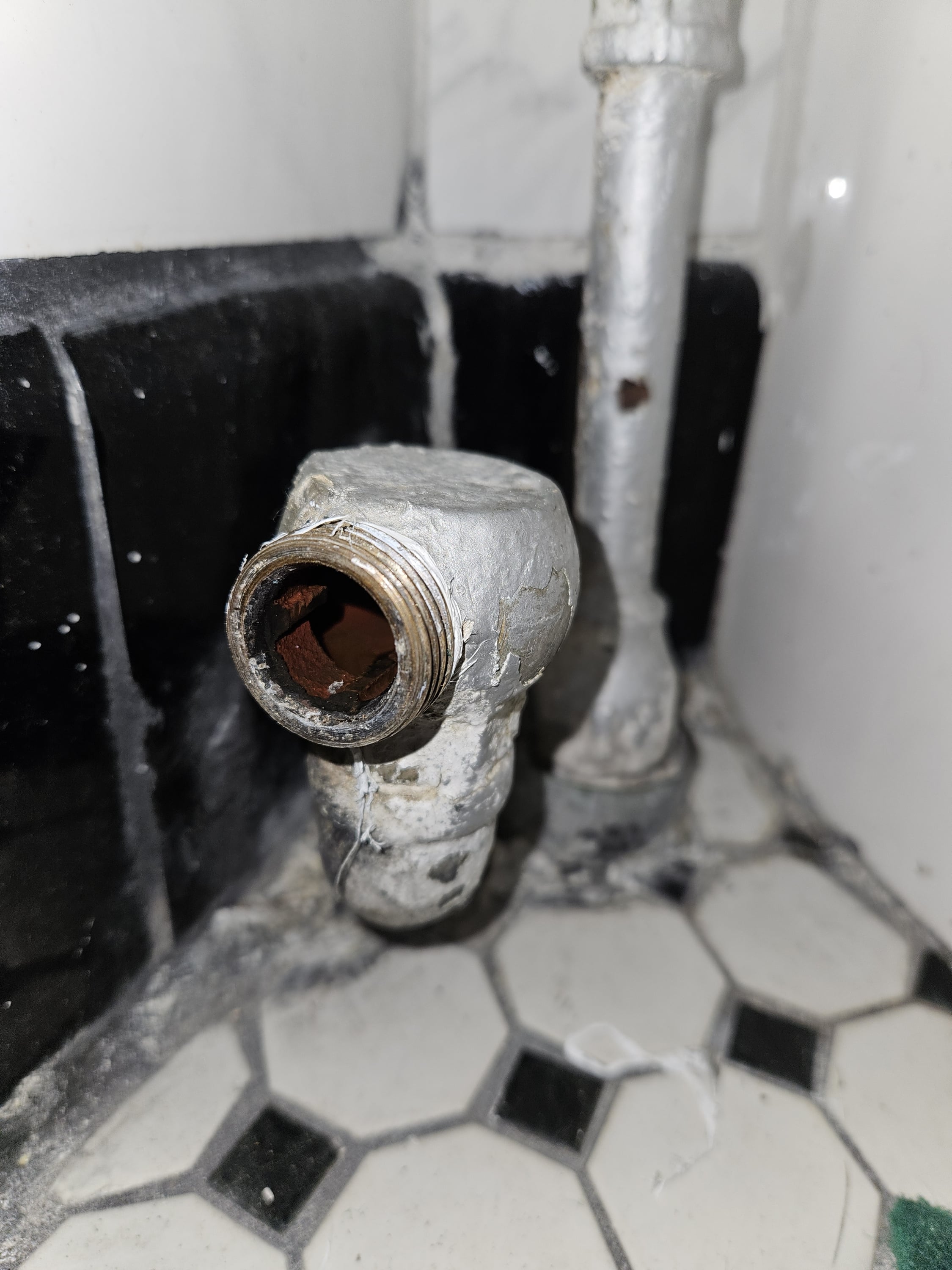

Should these be replaced? I don't exactly know how these work. I have one in a bathroom that does not get heat at all, but I confirm heat is able to come from the inlet. We have a two pipe system.

    There isn't much that can go wrong with those things… provided all the parts are still there.
    HOWEVER
    There is one thing that can go wrong: excess operating pressure. Anything over about 6 to 7 OUNCES per square inch is too much, and may prevent some radiators from heating.

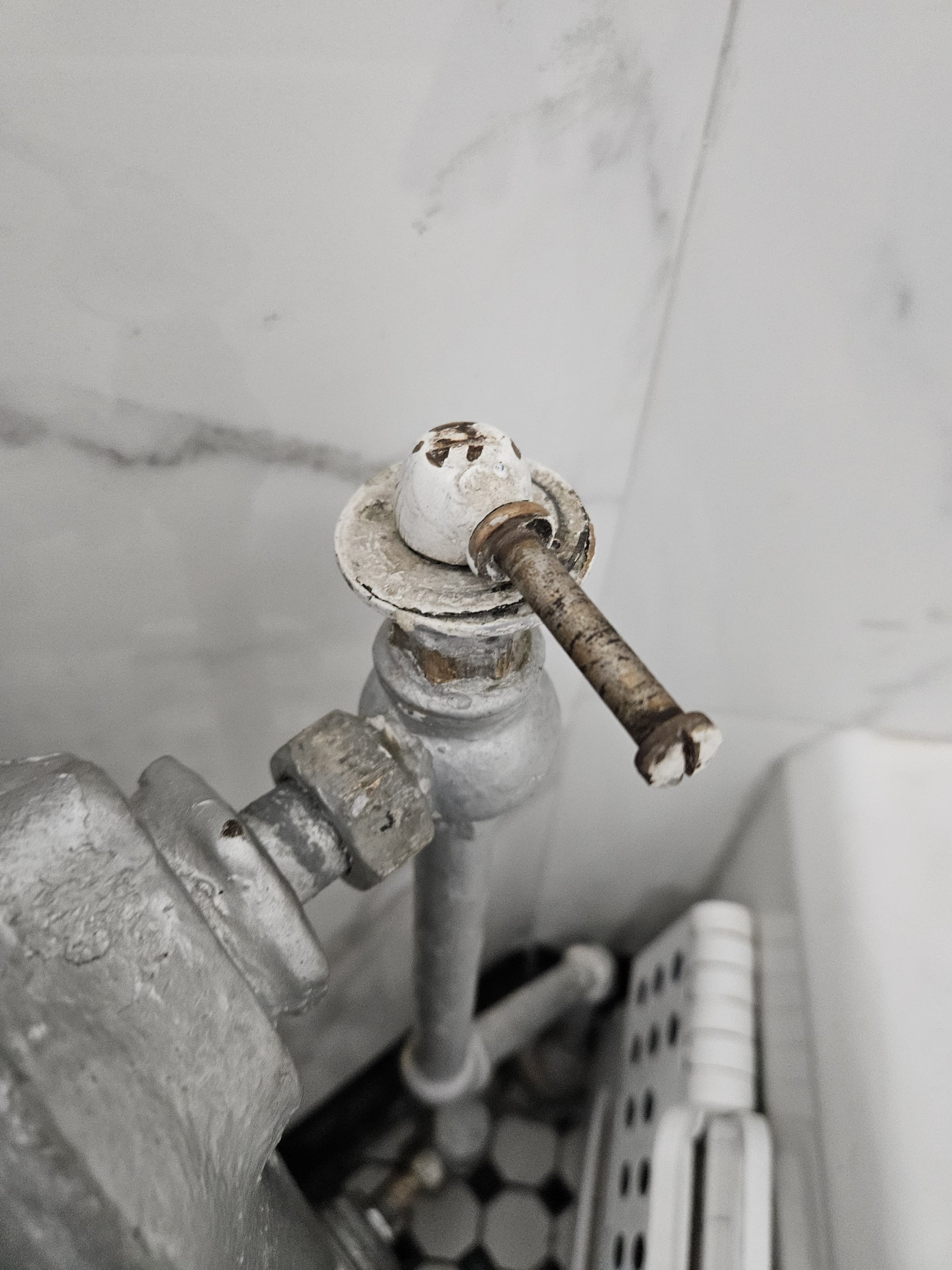

    Two other possible reasons for a specific radiator not heating are that something is amiss with the trap elbow on the outlet side and it is unable to vent or drain — stuck closed — or that someone closed the inlet valve. Check the valve first… remembering that clockwise is closed.

    @Jamie Hall I checked the inlet valve and made sure it stays open when the boiler is running. I removed the radiator from the span and tested. I saw steam come from the inlet. Once I put the radiator back on, the inlet stem was hot but the radiator remained cold.

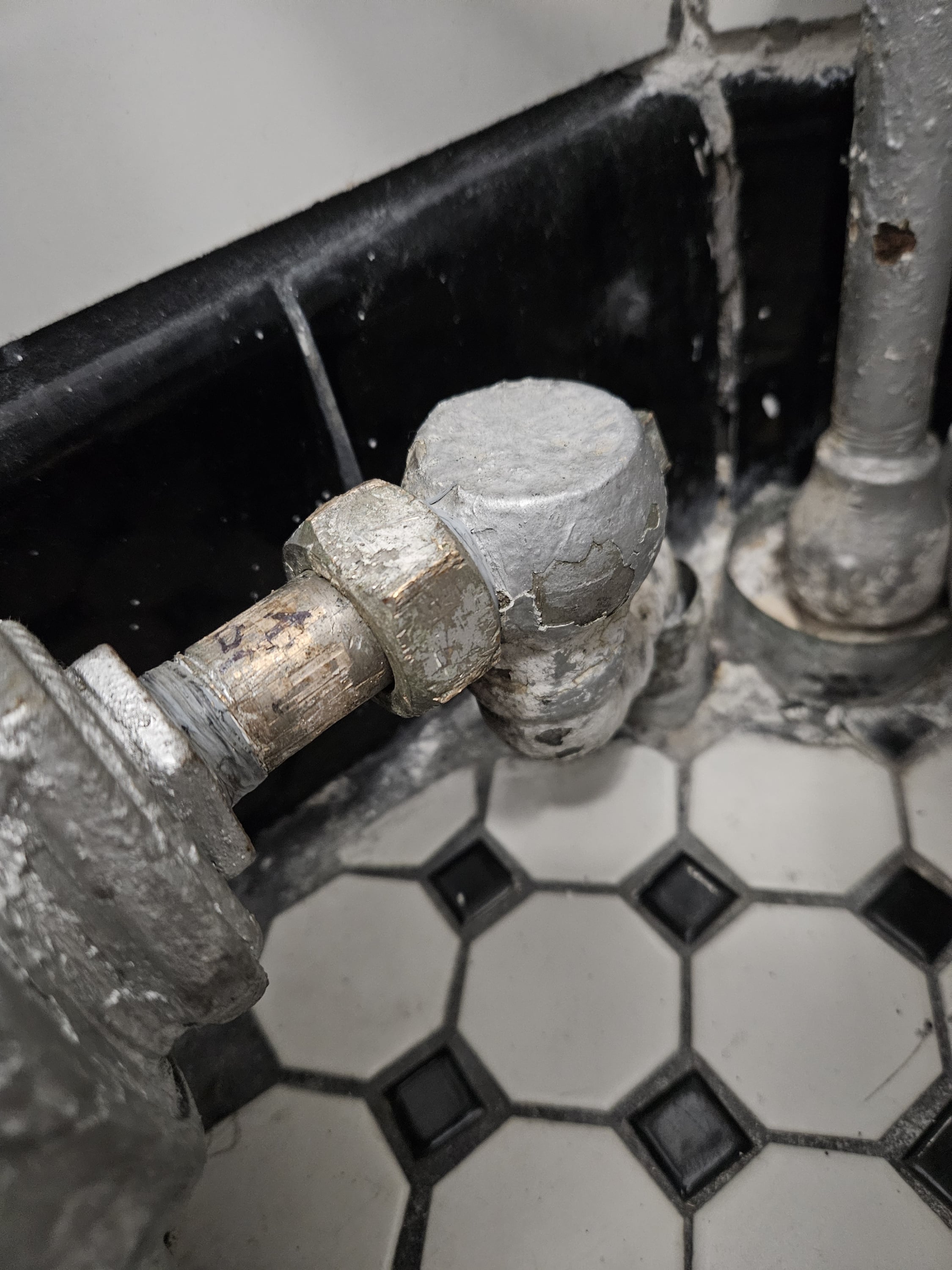

    Forward steps. If the inlet is hot but the radiator is cold, another possibility is that the air can't get back out of the radiator. Have you checked to make sure that the return line is completely free? I hate suggesting it, but you might want to take the radiator off again (at least the unions should be free now!) and pour water down the return. It should run freely.
    A related question, though. Is the return line warm or hot either at the radiator or in the basement? It shouldn't be — if it is, steam may be getting into it through another radiator or an odd connection somewhere and pressurizing it — which will keep your problem radiator from working.

    We do have a heater downstairs without a steam trap but it's in such awkward position from a fail bathroom remodel my uncles did. Not sure how I go about fixing this.
    does the bathroom radiator have a valve you can turn off? what kind of valve is on it? regardless of if it has a "trap" or not it needs to have a properly set vapor valve and the pressure needs to be kept very low.
    it is possible that water is getting trapped in the return and keeping it from venting as well.
    If you have an untrapped radiator it can be a problem, depending on the inlet valve and the system pressure. On not. Try — assuming that you have the system pressure under control and 8 OUNCES or less — simply closing the inlet valve partway, to the point where the radiator never gets fully hot across (tune out the complaints about it being cold in there!).
    And in any case, the outlet trap doesn't have to be right on the radiator — it can be anywhere on the radiator return line, and often some creative pipework and get one installed.
    remember, richardson system, so it isn't a thermostatic trap, it is just a little j bend with a ball in it. it may stop a little more steam than nothing but it isn't going to stop a lot more steam entering the radiator than it can condense.
    There is no reason at all that you can't put a thermostatic trap onto a Richardson system. It'll work just fine.

    You'll want to choose the trap carefully, since the vent holes in Richardson return elbows are rather small. I'd use a Hoffman 17C with a Dura-Stat inside (which current models have) since the air throughput of the DuraStat is lower than usual.
