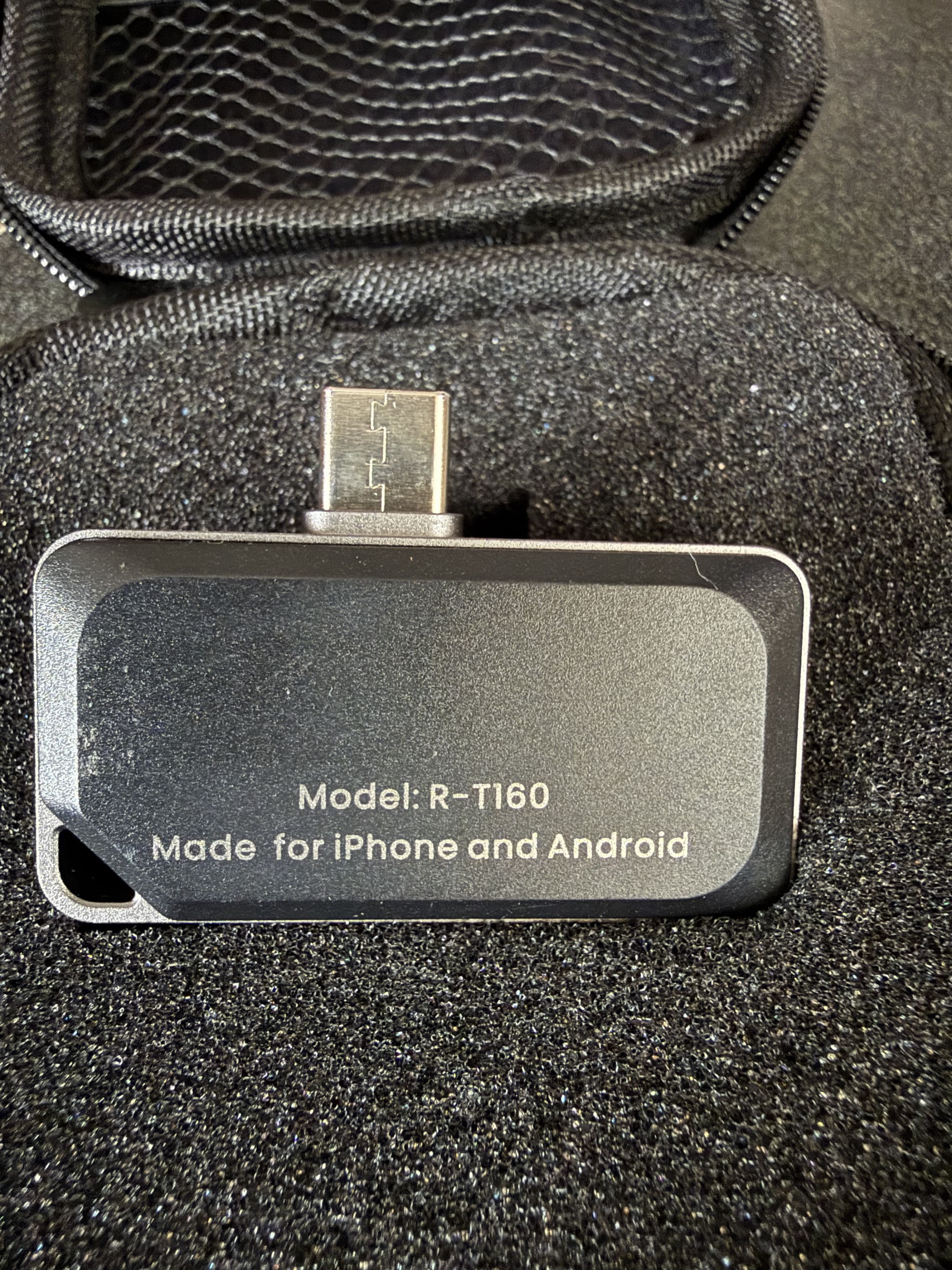

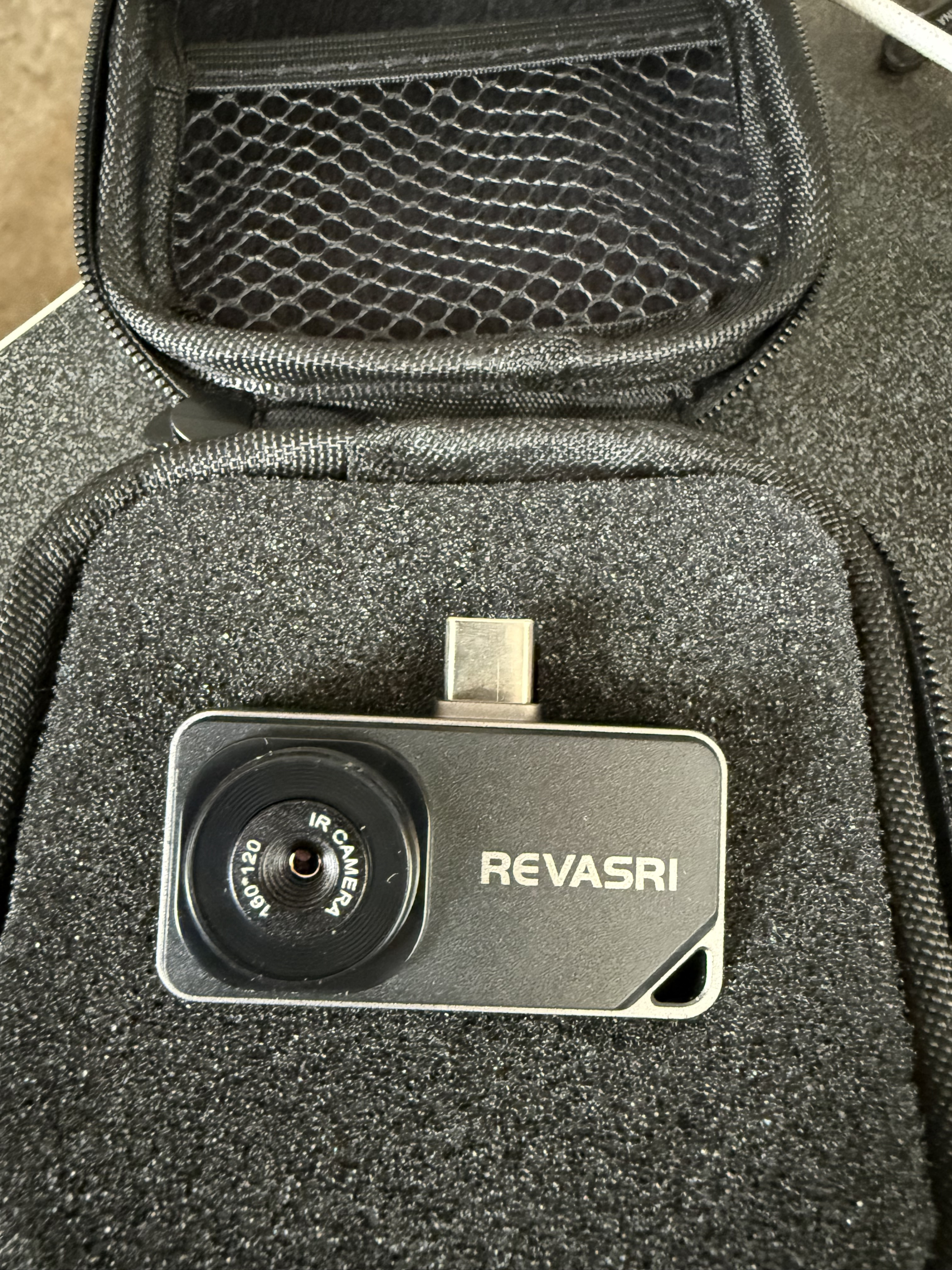

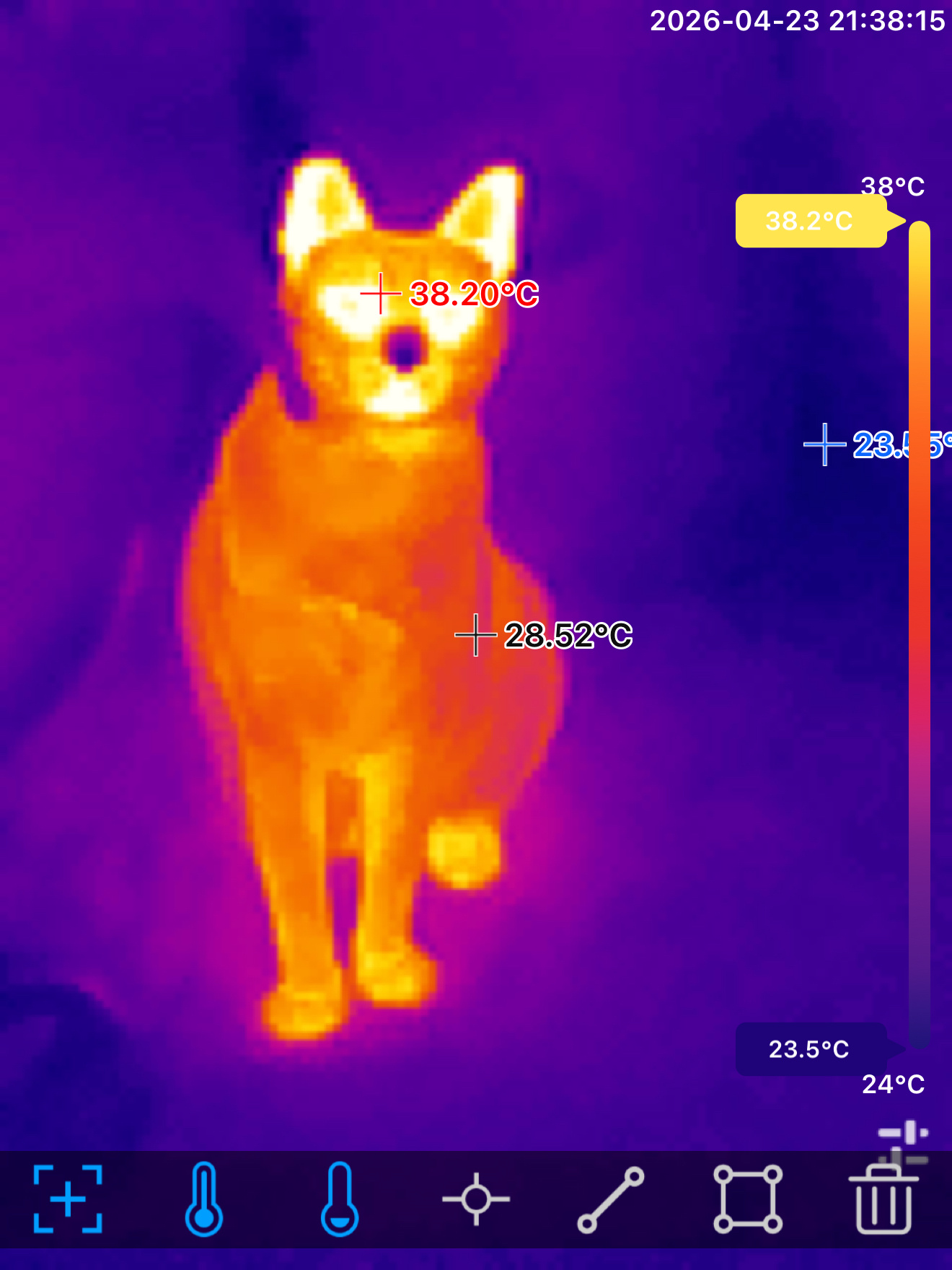

  • Larry Weingarten
    Larry Weingarten Posts: 4,212
    Hi, I'm always looking for excuses to get tools, and this seems a perfect opportunity for you. I recently got a very inexpensive thermal camera that plugs into my phone. Here are photos of the phone and my cat, who clearly has a cool nose. This tool could really speed up tracing down and finding the plumbing problem/s in your building.

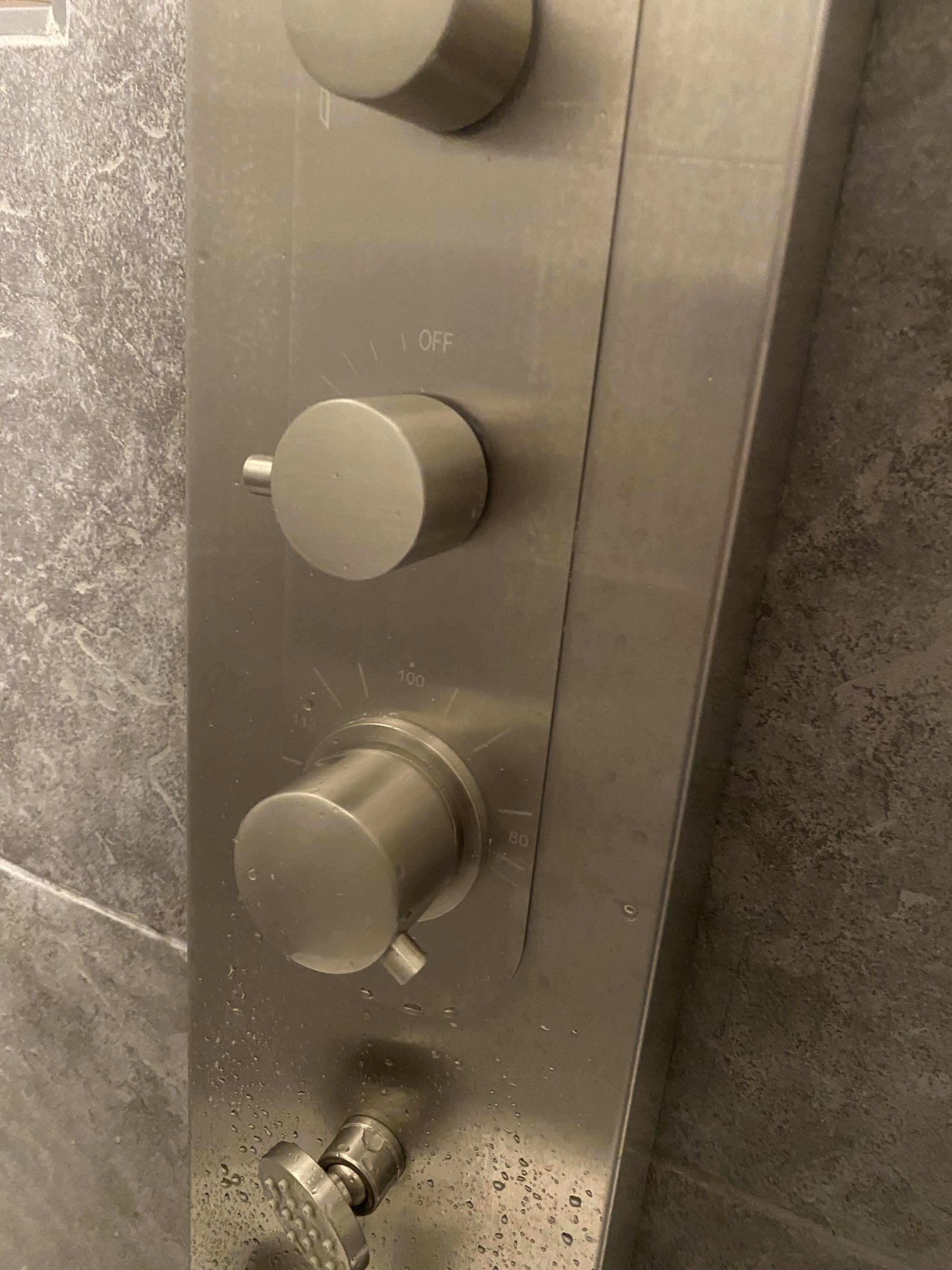

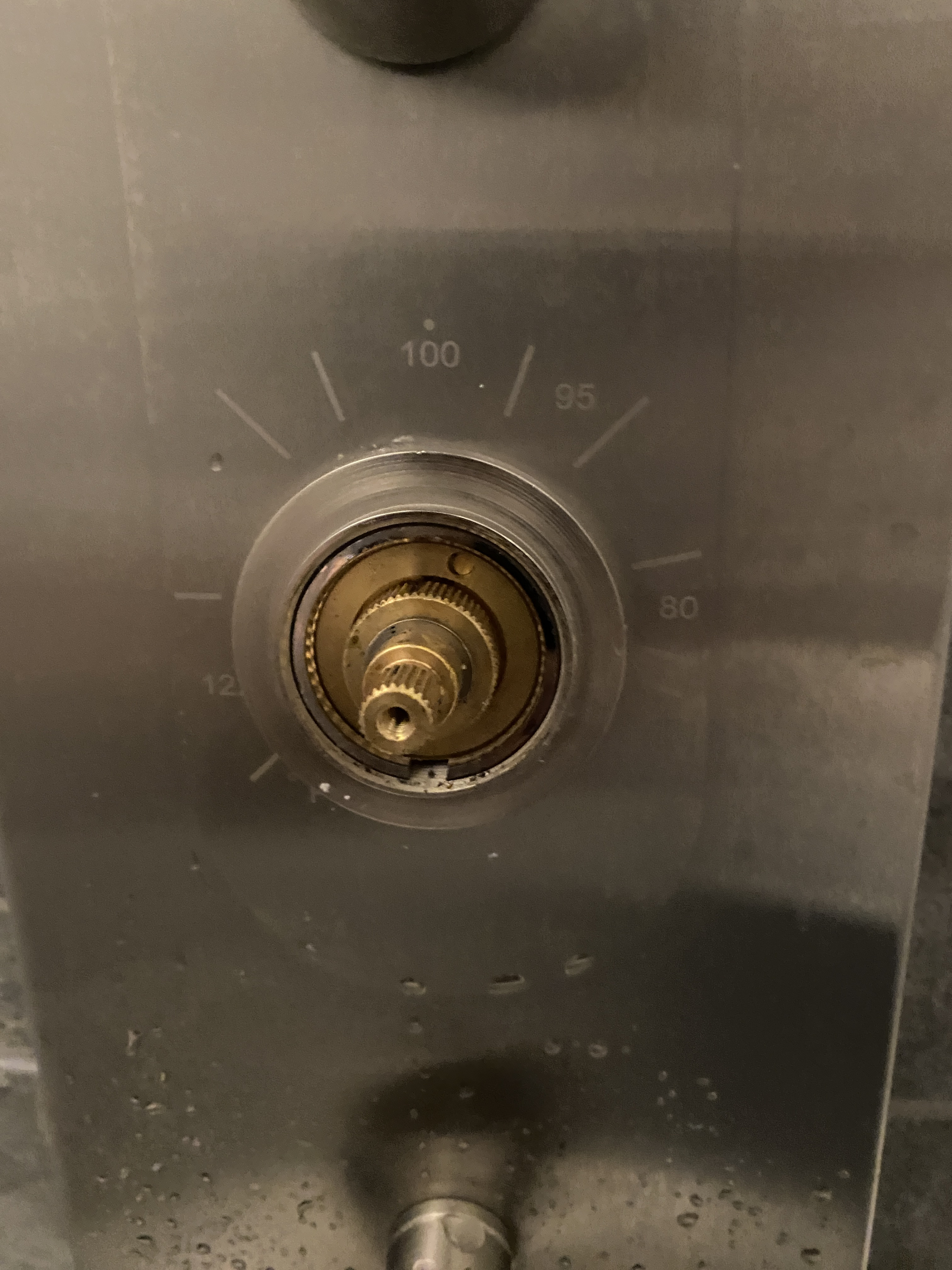

    The building plumber came by this morning. Multiple apartments have been having issues as well. "Cold water is warm" seems to be the theme. As well as low pressure.
    The plumber checked things in the basement (idk exactly what he checked).
    He thinks one or more shower cartridges have gone bad in the building. I have two bathrooms in a duplex apartment (401 & 501). He shut off the cold water shutoff. Turned my shower's thermostatic valve to cold. And turned on the shower. And there was a slow drip of warm water. He says it's my bad cartridges that's causing the problem. I am not sure how a bad cartridge on the 4th floor bathroom can propagate to the 5th floor bathroom. We did the same check on the 5th floor and there was no issue.
    I guess my next step is to replace the cartridge.

    pedmec Posts: 1,488
    The shower valve should be pressure balancing so to have a small drip is ok. Its suppose to shut the flow down with a loss of pressure on either side of the valve. the valve is doing its job. Unless there is something specific with the shower valve that test don't prove anything .

  • gotcha, so Booster pump just does a tiny little bit of pressure, which means when he's talking about a heat pump, he's probably just talking about a circulator to keep the lines hot, not to actually pressurize anything. If you had a large pressure differential between hot and cold pressures, that can throw cartridge balance off and cause poor behavior, but I doubt that's the issue here.
    I also agree that it's too early to pin everyone's issues on your shower cartridge.
    Any chance you have isolation valves for just your shower body and you can shut it off for a period of time to see if the problem goes away when you do?
  • branimal
    branimal Posts: 304
    There is a shutoff for both hot and cold in this bathroom. No shutoff for just the shower. So shutdown would impact, sink, toilet and shower. This is a secondary bathroom for the tenants, so maybe they can shut it off for a few hours.
  • That's really useful then. Id do whatever you can to have them do that to see if you can confirm if it still happens or not with that bathroom isolated. A mild inconvenience to perhaps prove that it's a building problem and not a unit problem.
