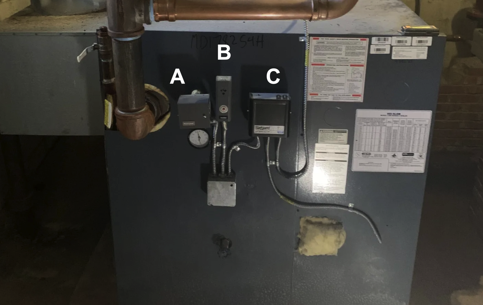

    I just found all these comments in the blog, had no clue they were in here. Sorry, I just signed up, and I'm still learning my way with the website. To clarify, there are total of 20 buildings in the development, built in the late 1940's.. Some buildings have 15 apts, others 20-25 apts. serviced by a single boiler. They all have radiators, mostly still the original plumbing, the boilers provide heat and hot water.
    My question is, with the warm wether around the corner and ni need for heating how do I set up the boilers so they still supply hot water, and the heat is off
  • 4343
    4343 Posts: 4
    Every boiler room has a heat exchanger for making hot water. The heat for the apts. is controlled by the boiler settings. There are no individual radiator controllers, very outdated setup

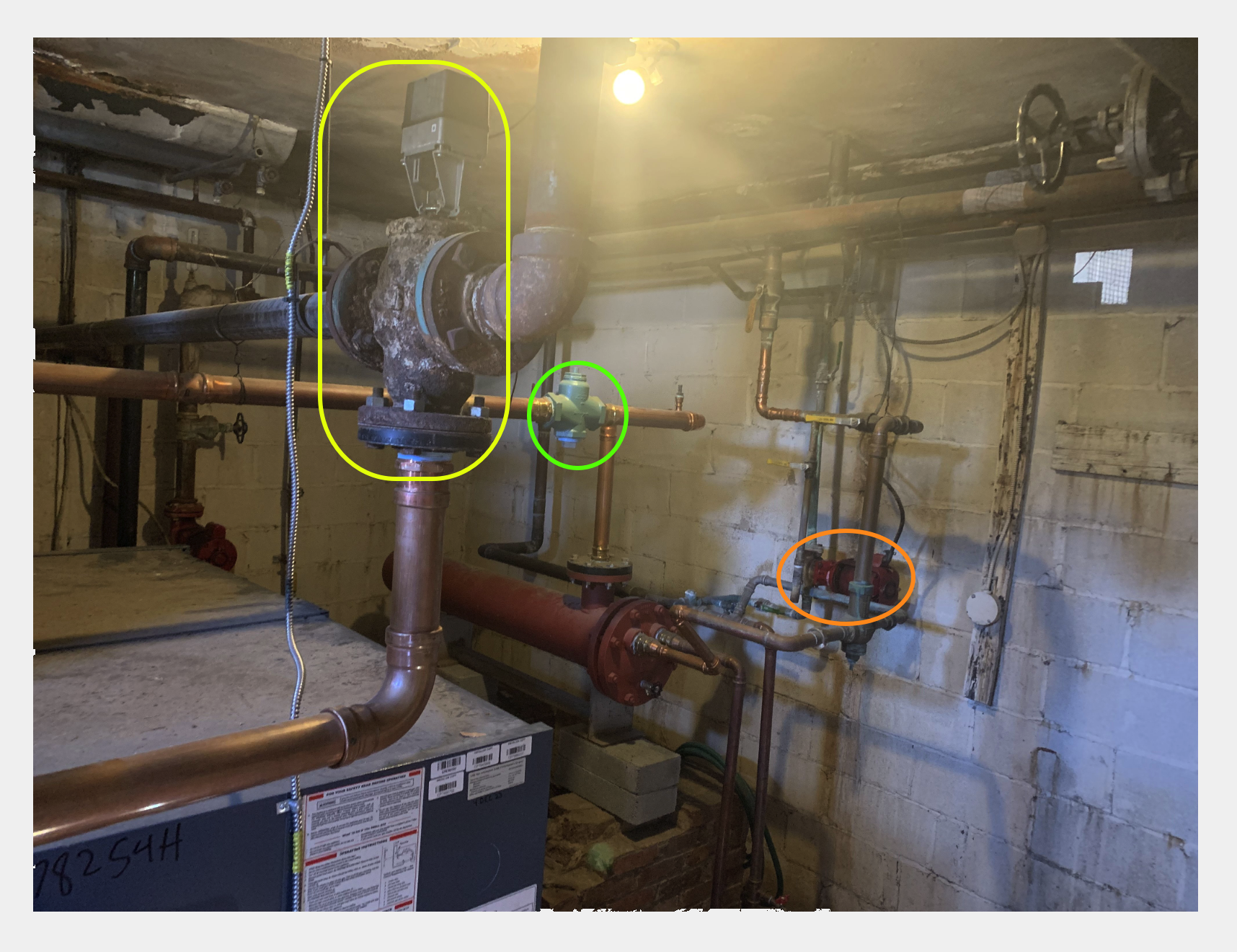

    From the photos you sent me via PM, it appears that your boilers use the Honeywell T775 Series 2000 Electronic Stand-Alone Controller. That control can manage boiler staging well in buildings with two boilers, but preventing summer heat migration into the space-heating zones is mostly a piping and flow-control issue, not just a control issue.
    In systems with shell-and-tube domestic hot-water heat exchangers, like the photos show, the boilers often fire in summer to maintain DHW temperature. When that happens, heat can migrate into the space-heating loops by gravity circulation (thermosiphoning) or through leaky zone valves. You should not need to do anything to prevent this from happening, since the systems have been operating this way for as long as they have been in service.
    The only time you need to address this is when a tenant experiences gravity circulation on an individual basis. If that happens, there is usually a valve stuck open when it should be closed. A temporary fix is to shut off the manual service valve to that zone until you can repair the defective zone valve or flow-control valve.
    You should share those photos on this post/discussion. Those photos have made your query very understandable, and easier yo answer your question. Basically "Do Nothing" is the answer unless there is a problem.
    On the newer Weil-McLain boilers, there are three controls attached to the side of the boiler. Each one has a probe that measures the temperature or level of the water inside the boiler.
    The double aquastat marked “A” operates the boiler at a minimum temperature to maintain domestic hot water temperature inside the boiler and in the shell of the shell-and-tube heat exchanger. The LO setting might be set at 160°F, so the boiler and shell contain 140°F to 160°F water, depending on the differential setting on the LO limit side (the red DIFF dial).
    When the apartments call for heat, the burners will operate along with the circulator for space heating. If the circulator operates so much that cold return water from the apartment radiators causes the boiler temperature to drop below the minimum temperature (about 140°F) needed to provide sufficient hot water for showers and other domestic hot-water needs, then that control has the ability to stop the space-heating circulator from operating until the boiler temperature increases back to the 160°F LO temperature setting of the control.
    Sometimes during extremely cold weather, calls for heat may continue indefinitely from several individual apartments or another, for longer periods of time, causing the burner to operate continuously. When this happens, the boiler temperature will rise above the 160°F LO setting to provide more heat to all the zones. If that temperature ever rises above a safe operating temperature, the HI limit on Control "A" will stop the burner from operating above that temperature (for example 180°F). Once the boiler water drops to about 175°F, the burner will restart and the heating process will continue normally.
    In the event that the HI limit on the operating double aquasta "A" fails to keep the boiler at a safe temperature, Control "B" will stop the burner. This is a manual reset control that might be set at 200°F or 210°F. If this control ever shuts off the burner, you will need to manually reset it and determine why the operating limit did not stop the burner from allowing the water temperature to rise above the operating limit (190°F, for example).
    Control "C" is a low-water cutoff that will stop the burner if there is not enough water in the boiler. If the water level ever drops below the safe operating level, the burners cannot operate.
    Hope this explains some of the functions of your boilers.

    There are three thing I want to talk about in this photo.
    This large valve in the yellow oval may not be operational anymore since I do not see wires connected to it anymore, but that may just be the glare from the light bulb. On your older system, that control may have been connected to some device that measured outdoor temperature, and that control may have adjusted the position of that three-way valve in order to send lower-temperature water to the radiators on mild days and higher-temperature water on colder days. So that valve on older systems may still be in operation today. The Honeywell T775 Series 2000 Electronic Stand-Alone Controller in the other photos is performing that function at the boiler and making boiler temperature adjustments as needed.
    The flow control valve in the green oval is designed to prevent gravity flow from occurring when the DHW circulator is not operating and the space-heating circulator is operating. There may be another valve like it on the space-heating side of the system so the space heating will not get gravity flow when the DHW circulator is operating and the space-heating circulator is not operating. If there is no flow control valve on the space-heating side of the system, then your individual zone valves are performing that function of the flow control valve.
    The orange oval shows a circulator pump with a bronze body, but someone replaced the bearing assembly with a cast iron section (not bronze). If this circulator is designed as a recirculation pump for the DHW open system, then you may find there is rust in your water from time to time, when taking a shower or filling a pitcher with hot water. Plumbers and handymen should refrain from using cast iron parts on potable water systems. That is just an FYI for the future and has nothing to do with the original question.
    I hope this information helps.

    I can't thank you enough for all the information provided, sir! This answers many questions I had about the aquastats settings that currently are set to 180 for the LO, and 210 for the Hi which, I assume were the winter settings. In this line of thought, would it be reasonable to lower the setting to 140 LO and 160Hi during the summer for more efficient operation? The other question I have is in regards to the piping and flow control you mentioned earlier, as in would it be any manual shut-off valves that need to be engaged to stop the water flow directed to the space heat radiators in the apartments. The radiators inside the apartments do not have any valve controls, and tenants cannot control the heat in their apartments. There are outdoor air sensors hooked to Johnson temperature control, the little blue box under the electric breakers on the wall panel.
    Again, thank you so much, you've been more than helpful! Very grateful!
