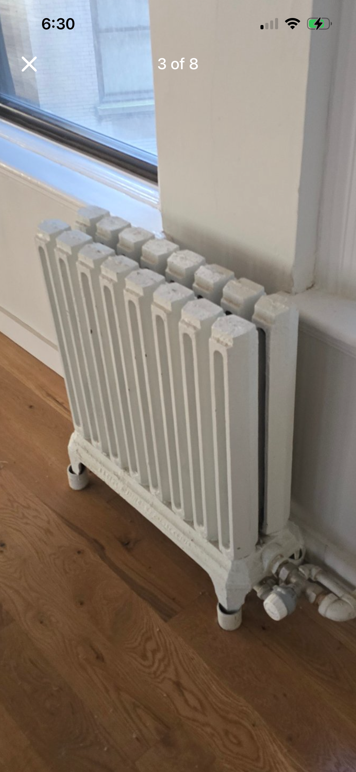

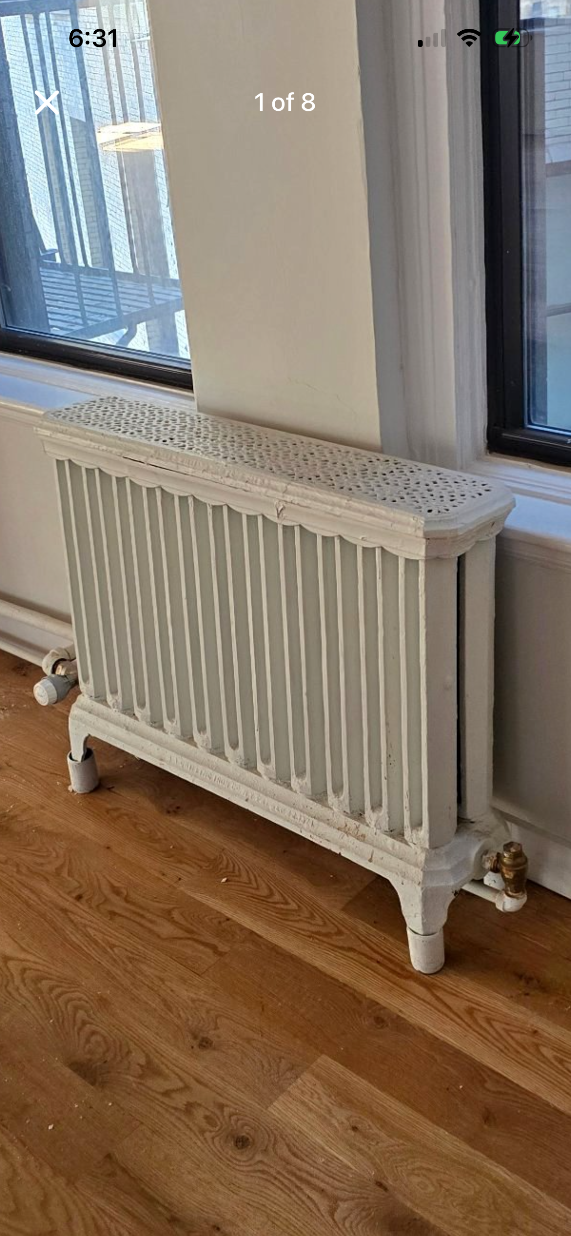

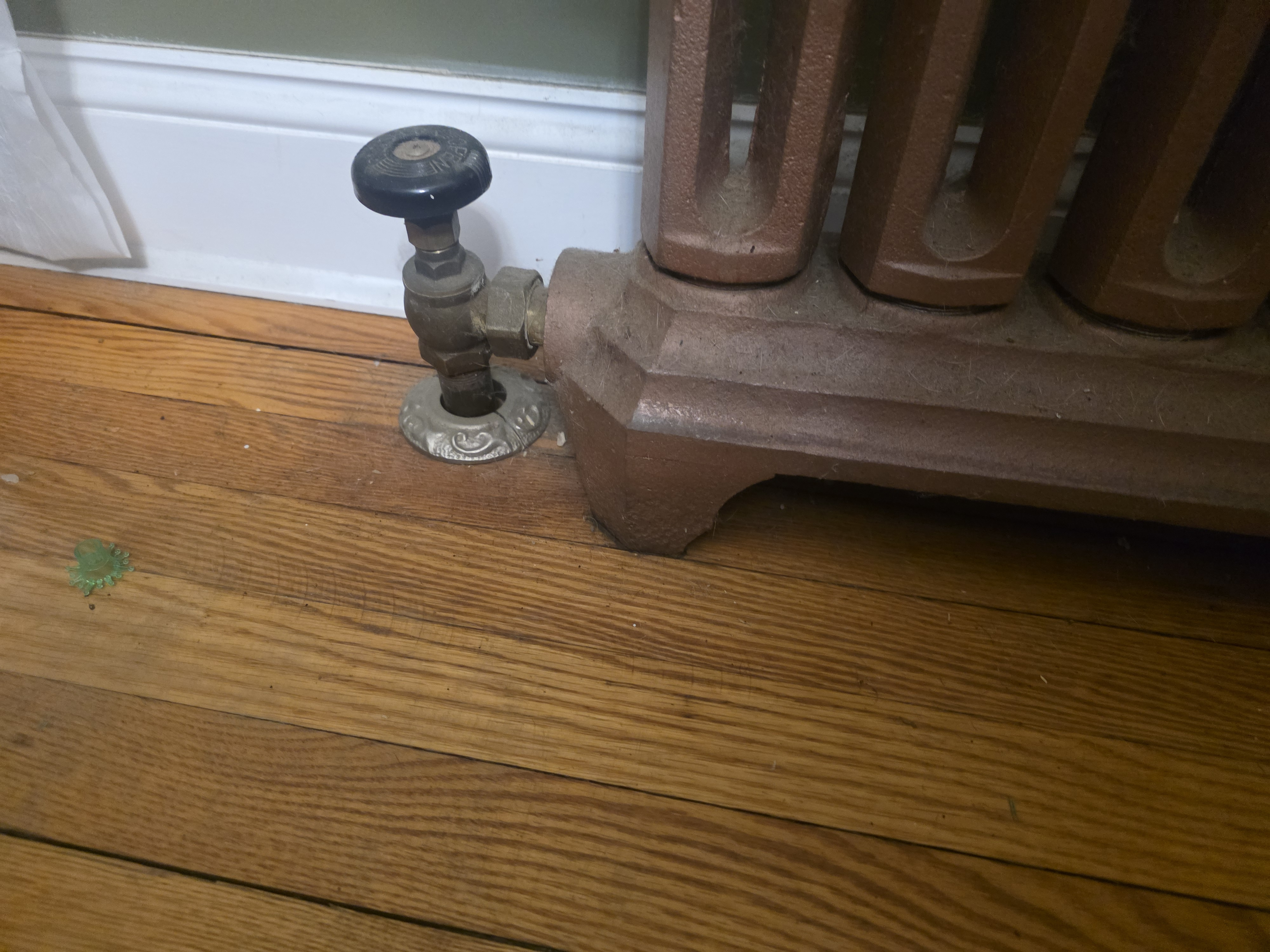

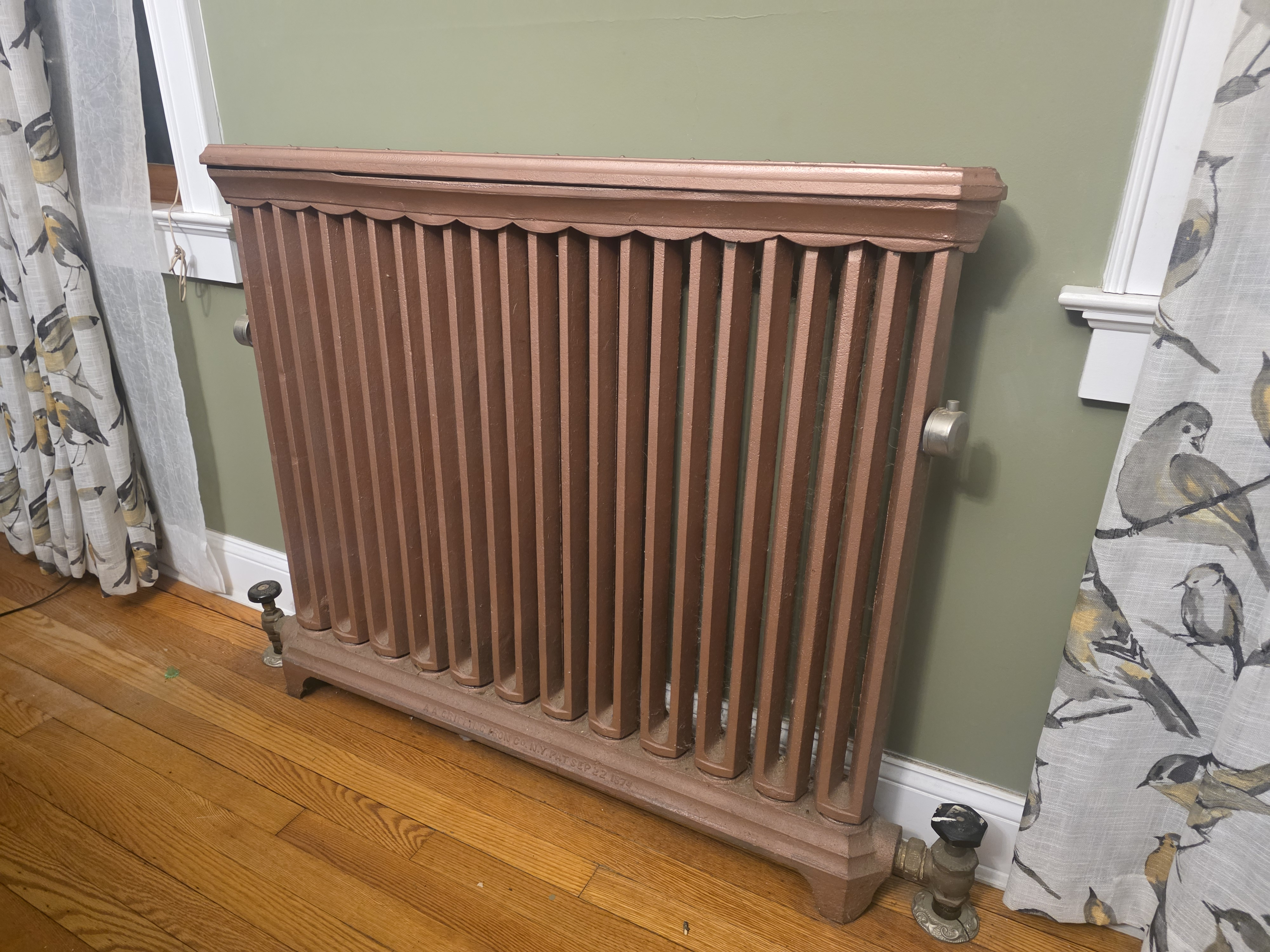

I found some Bundy loop style radiators in excellent condition that I’d like to pick up for my 1 pipe system. Does anyone know if they would work with 1 pipe steam heat? It has a tap for a vent so I’m assuming they are dual purpose but just want to make sure.

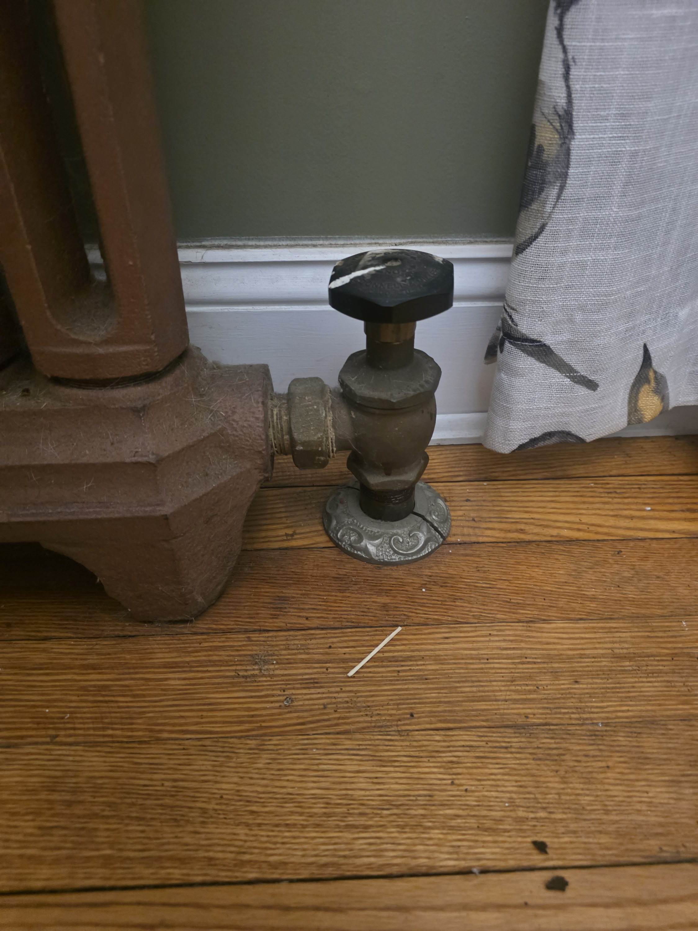

    What size are the pipe connection tappings?

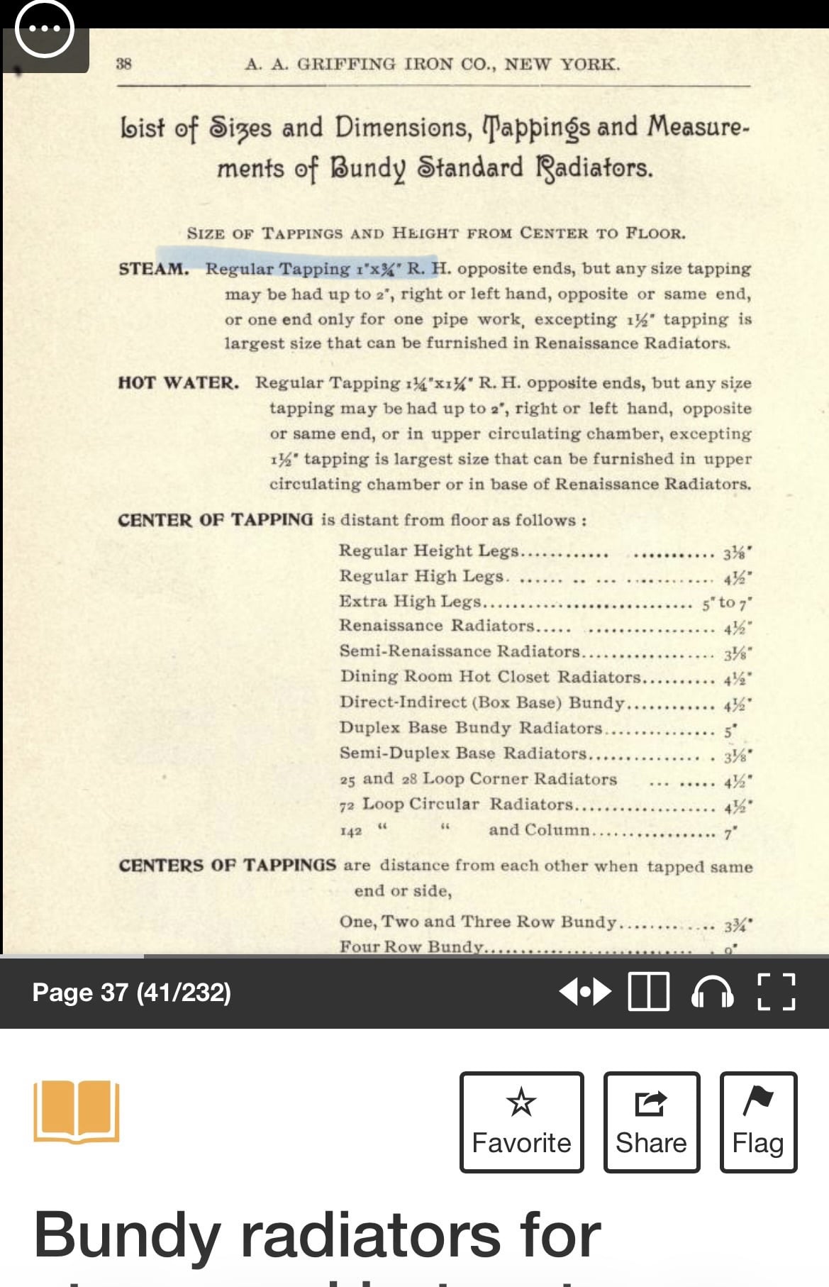

    I think 1 inch for supply and 3/4 for the return. Have to go check them out tmrw. If it is indeed 1” is that too small to accommodate steam and condensate return flow?
    Mad Dog_2

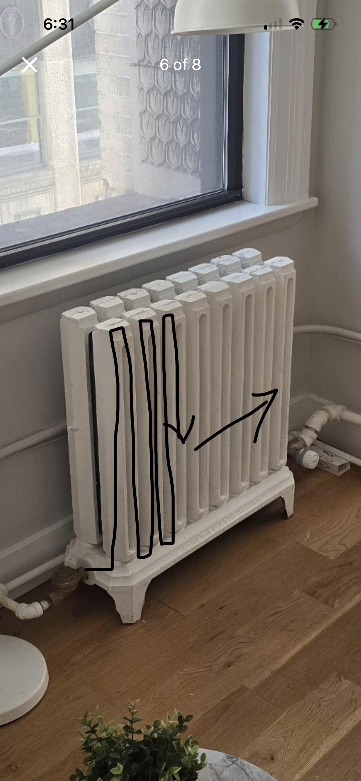

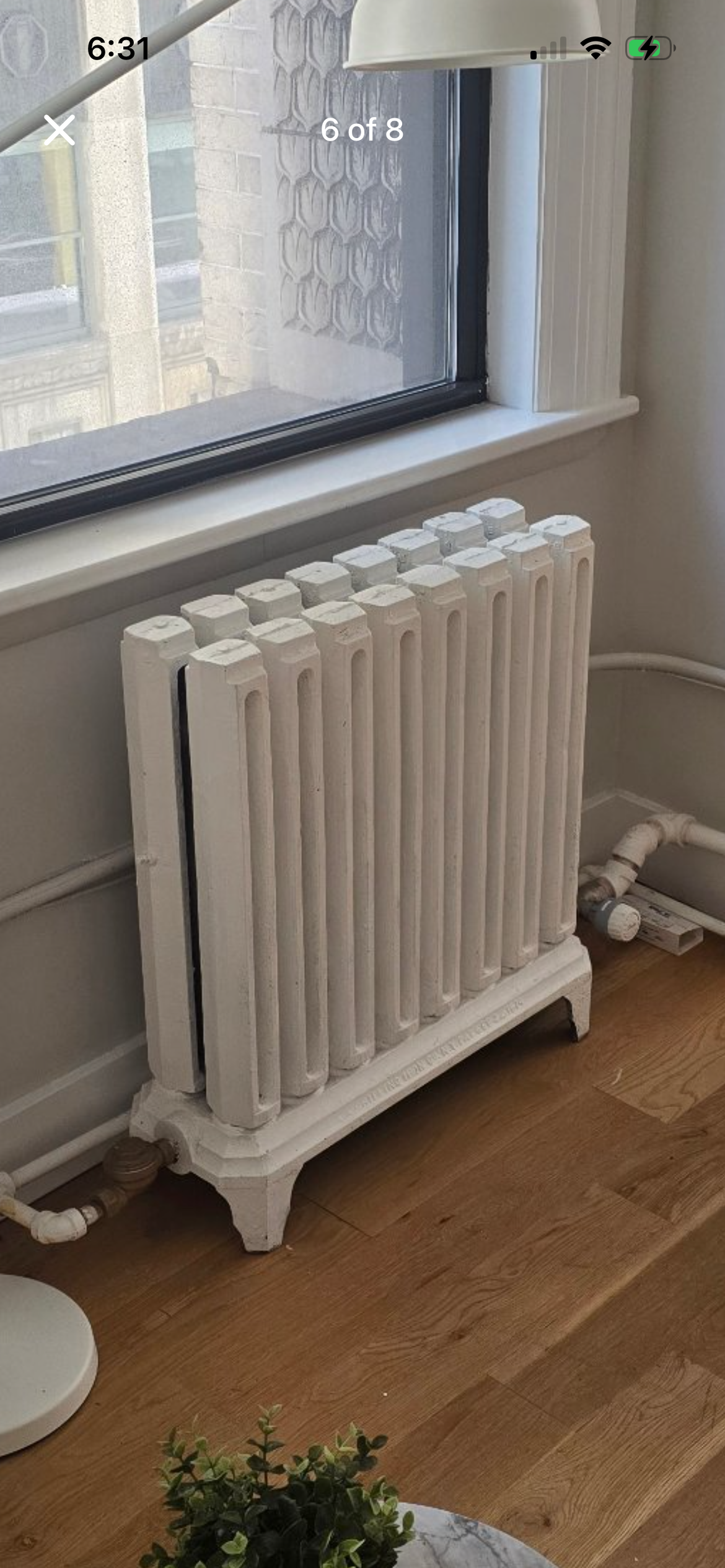

    I'm not at all sure they will. Why? Because it does not appear that they are connected across the tops of the columns — and that means that normal one pipe steam radiator venting, with a vent on the last section and air and steam moving across the top to reach that vent, won't happen.
    But maybe… @Steamhead ?
    Steamhead Posts: 19,007
    There is a bushing on the inlet end but it's hard to tell its actual size.

    Thank you Steamhead, I noticed that too. Hopefully it’s 1 1/4” but I think more than likely 1” since that was standard. I just read that 1 “ supports 25-30 EDR if this style does actually work. Jamie that is a great observation. I was hoping
    that the steam would push the air out through the columns in a up/down and repeat manner but I’m not so sure about that.

    I have a round one and piped it just like Mad Dog did his on single pipe steam.
    If it's going on the first floor you can use both pipes and put an inverted loop on the return into the bottom of the supply runout.
    13 Loops, 36" high, 1-1/4 inlet, 1" outlet. The steam distributes up and down the loops just fine. Put a vent in the last loop if you need it.
    Mad Dog_2Ldallas_87

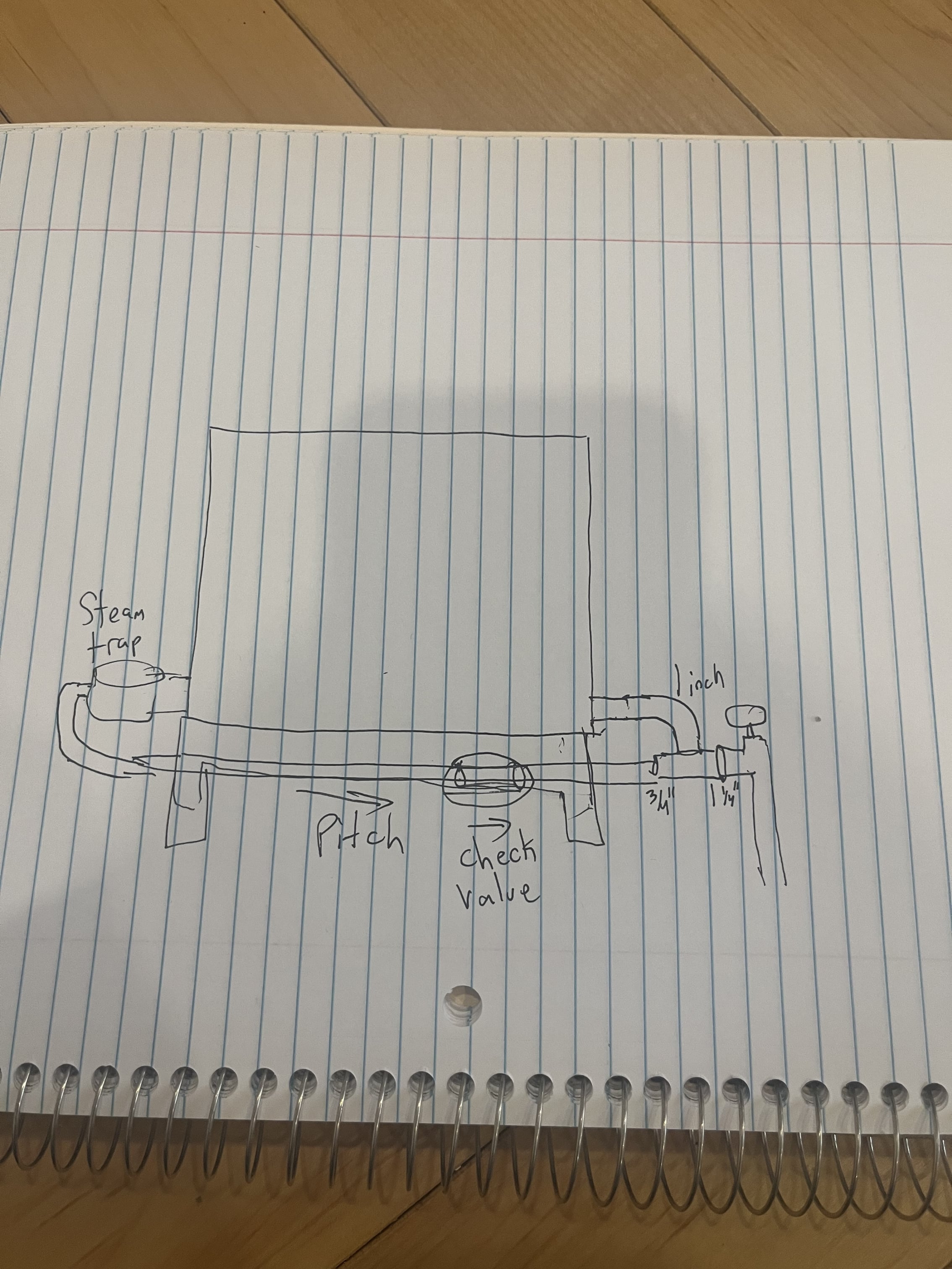

    Thanks for sharing. I wouldn’t be able to add a loop downstairs. Could something like this work for a larger radiator?
    Lose the trap. You don't need it.
    The check valve would have to have a very lightweight flapper so the weight of the water would open it. And the rad would need a vent.

    Mad Dog_2
  • Mad Dog_2
    Mad Dog_2 Posts: 8,755
    Just try to use one pipe. See how that goes. Mad Dog
  • Grallert
    Grallert Posts: 1,237
    It sure looks like there is two bushings on the supply side. Hard to tell but the TRV is in a bush and that bush looks to be in another 1x1 1/4"?
