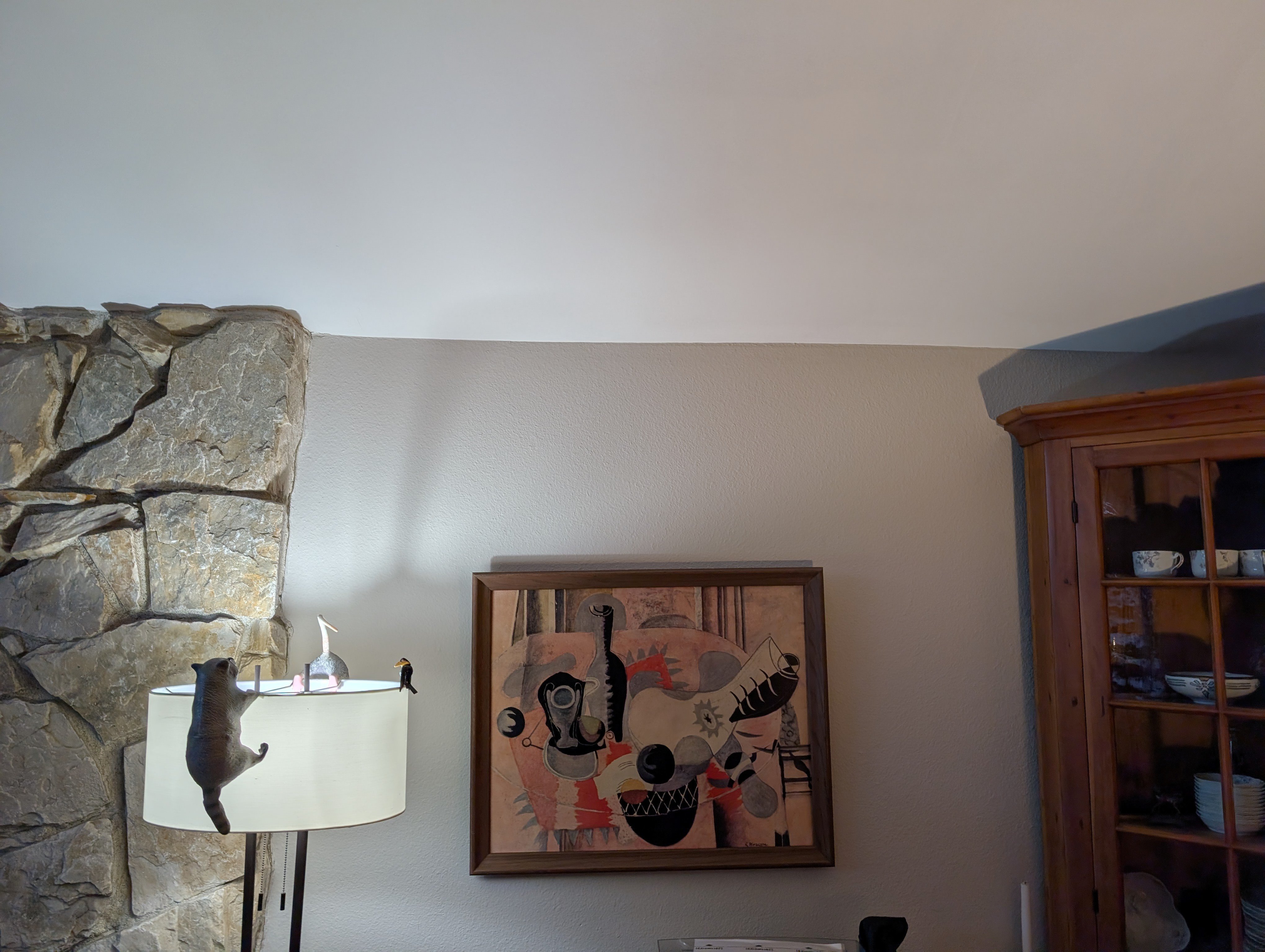

Pictured above is the south wall of our living room. Between the fireplace and the corner cabinet (only place in the house it works) and above the painting (print) is approximately 66" X 22". This is an exterior wall (second story) adjacent to the driveway and there are no obstructions on the outside. The electrical panel for the house is on the same side of the fireplace downstairs.
Like to put a self contained (not split if possible) ductless heat pump in that space. Thinking the heat pump will occasionally cool the living room (about 22' X 20' with a vaulted ceiling) a few days in the summer and take a load off our recently repaired central heat electric furnace in the winter. The house currently has heat but not AC,
The wall must be load bearing, don't see how it can't be. So any cutouts either have to work around the studs or otherwise be reinforced to compensate for losing vertical load capability. The outer wall is some kind of 1970s insulation board covered with wood siding.
We had our electric panel replaced a couple of years ago and they gave us an external conduit for a possible hot tub on our deck. So getting power to the unit should be easy.
For BTU calculating purposes we thinking doubling the square footage of the living room (at least) is in order as it is open to the kitchen, the hall to the bedrooms, and the stairs down to the entrance way. In other words we are hoping to cool the kitchen too and a great deal of the cold air will certainly go downstairs. But our electric furnace has a summer fan switch specifically for recirculating the always cooler air from downstairs through out the house.
If we have to go split the outside component will likely have to be mounted up off the ground above the driveway and the extremely incompetent drivers who inhabit the premises.
Like for the panel and vents on the inside wall to not stick out too far like a typical floor mounted hotel unit does. The space is there but it's an aesthetic consideration. Mounting a unit in the ceiling is not possible as there is no empty space above the vaulted ceiling. Mounting on the floor would displace my stereo cabinet.

    Load bearing or not, only a 2.5" hole needs to be drilled through the wall for refrigerant pipes, electric, and drain. The head doesn't weigh much, so that's not an issue. It WILL be a split system with one indoor head and one outdoor unit mounted above the snow line.
    At approximately 440 sq ft, without knowing the climate zone, insulation, and ceiling height, we can't give an accurate calculation on what size. But on the second floor with a vaulted ceiling, I might opt for a 12K, knowing it will modulate. 9K if there's a ceiling fan and a cool climate zone.

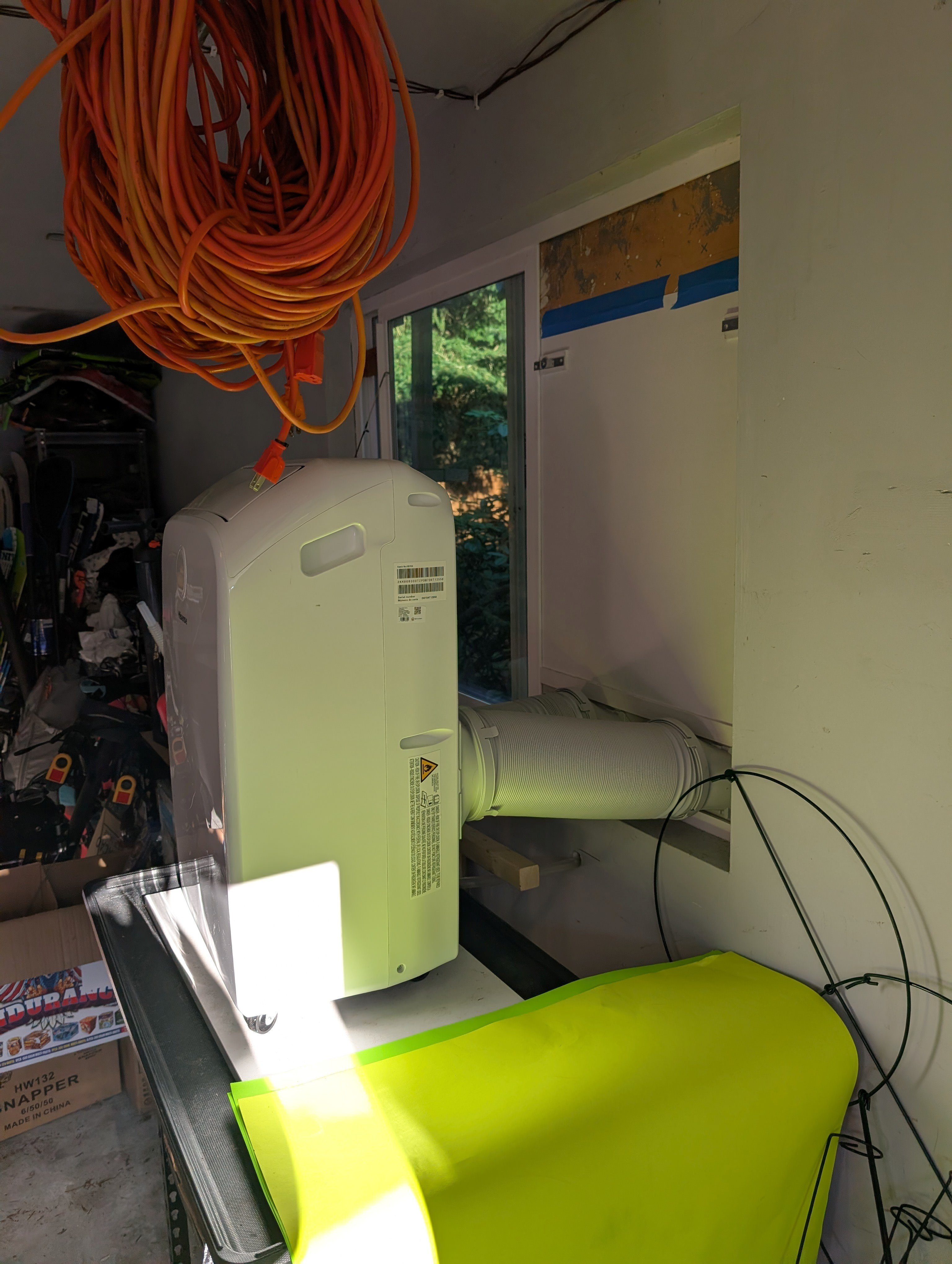

    We bought 2 Hisense portable 115v 9000 btu heat pumps to cool 2 upstairs bedrooms during the summer. They work great. Kind of a pain as they take up a lot of space and ties up a window but for short term summer use it works

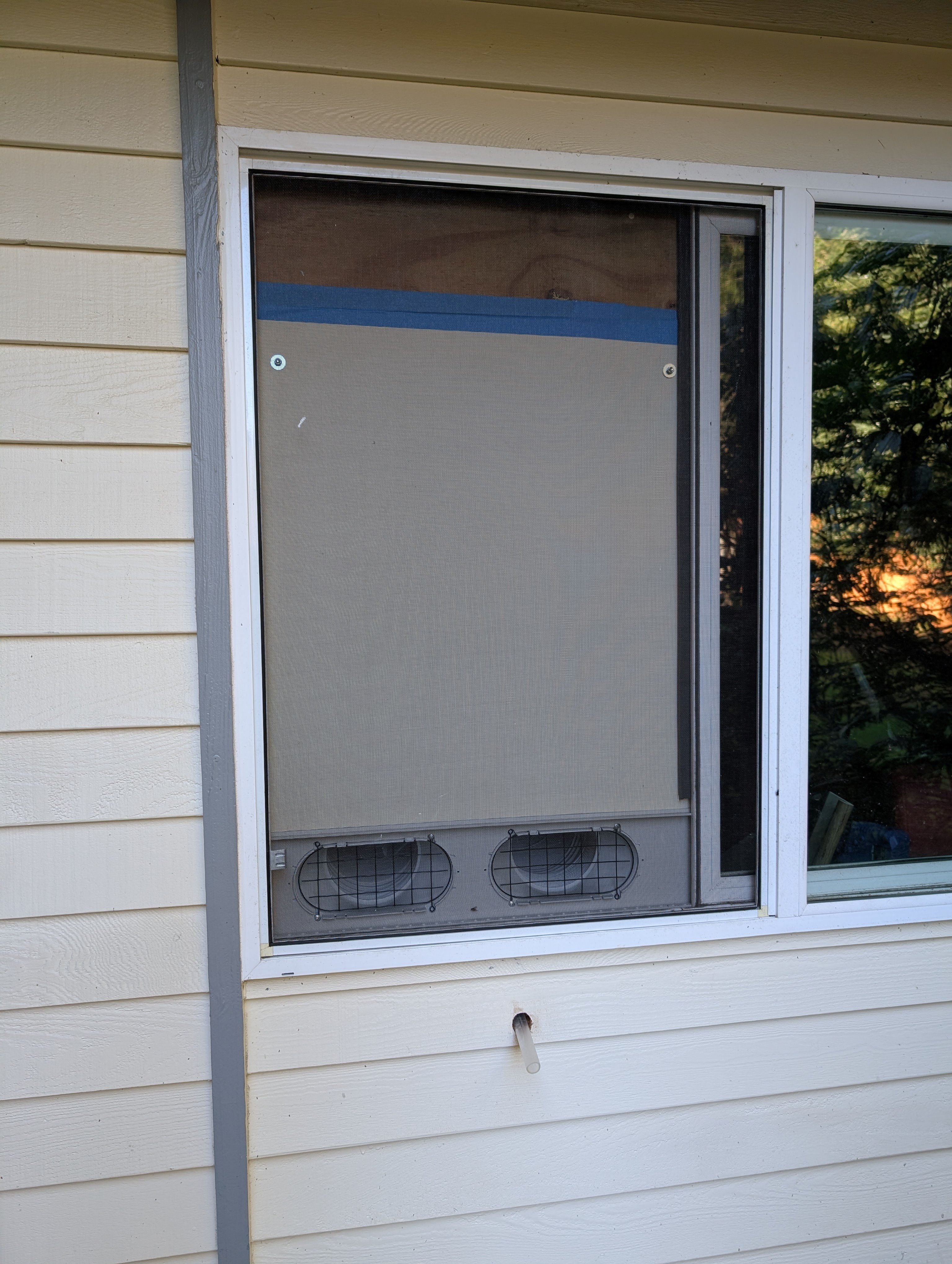

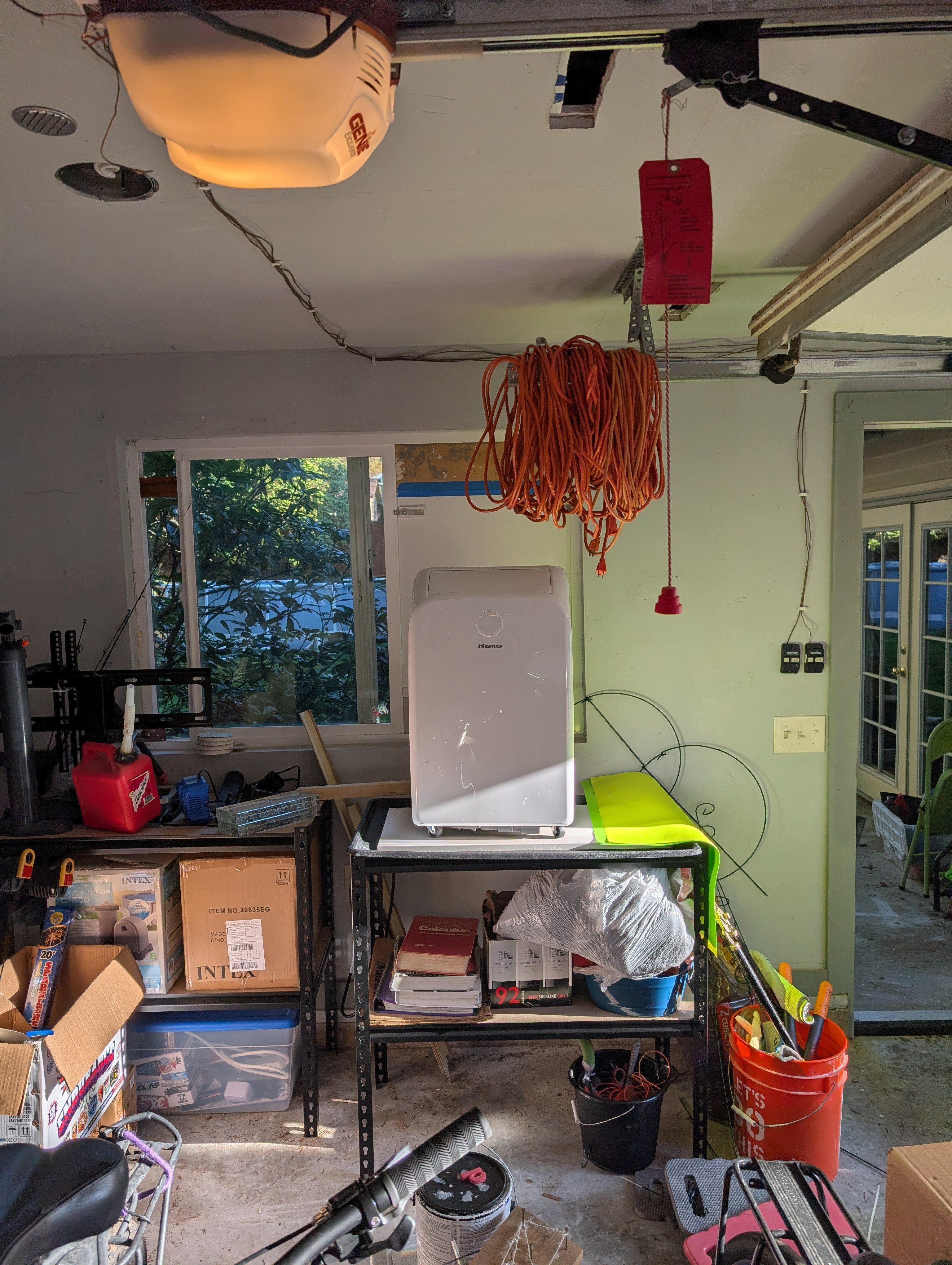

    Below is pictured an experimental set up of one of those units in my large un-insulated garage hoping I could get the temp in there warm enough to work on my project car during the winter.
    The unit requires a 115v outlet and and external inlet and outlet ducts.
    Plus I had to rig up a drain to outside. Heating fills the onboard tank up in maybe 15 minutes so continuous draining is needed. When we use the units inside for AC the units sit on the floor and the onboard condensation tanks have never needed draining for at least the last 2 summers.
    Long story short in ambient temps as low as 40 deg F the unit would heat the garage to 66 deg, the lowest heat setting available. And it will keep the temperature there. Experiment was a smashing success. If I decide to permanently heat my garage I will move the unit elsewhere and cut holes in the wall. The garage is my sandbox.

    I do not believe my Hisense 2 duct portable ACs waste conditioned air. If so I'd like to know.
  • pedmec
    pedmec Posts: 1,488
    Your unit is better than most. You are taking outside air and returning it back outside as opposed to the units chris i believe is referring to that only discharge air outside. There is only a discharge pipe on the rear of the unit. The air it is discharging to cool the condenser is conditioned air from the space.

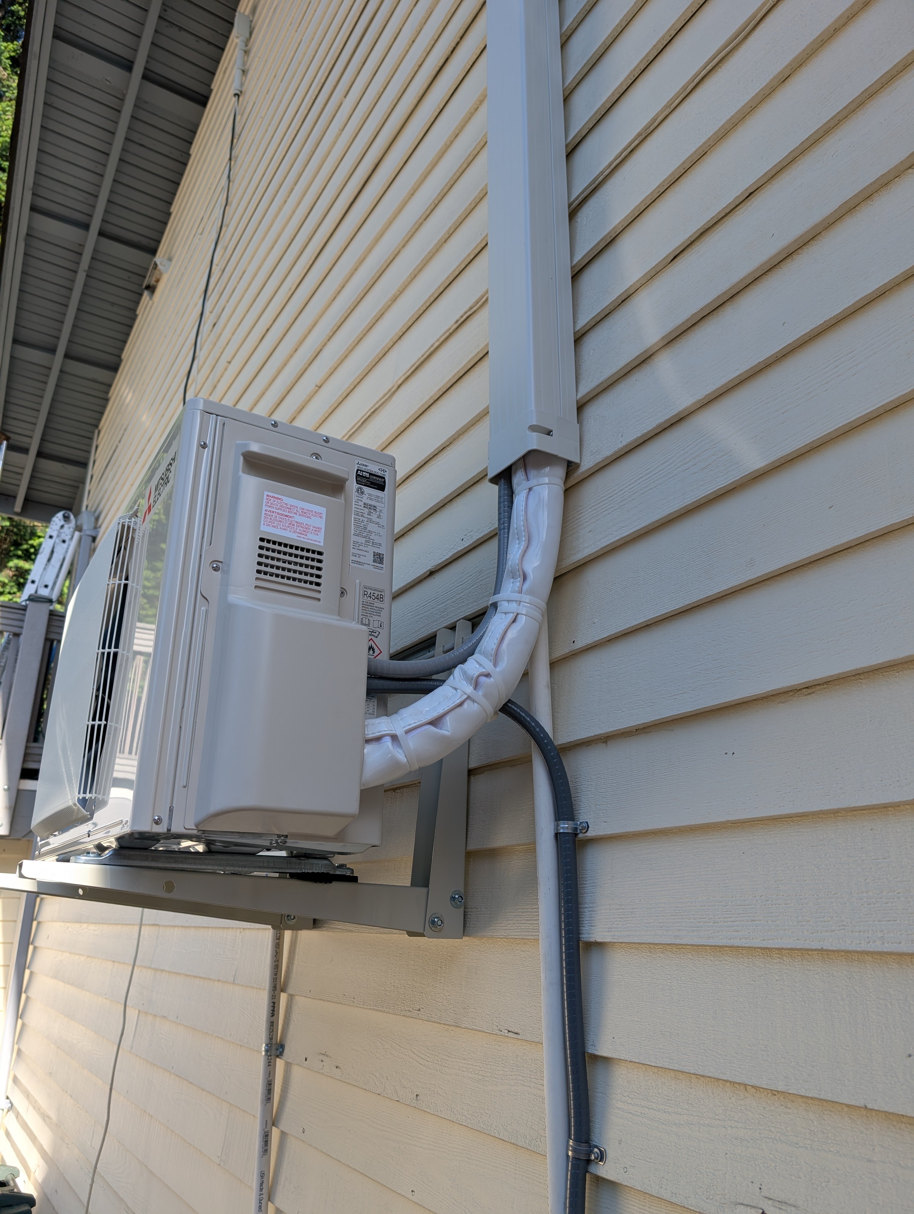

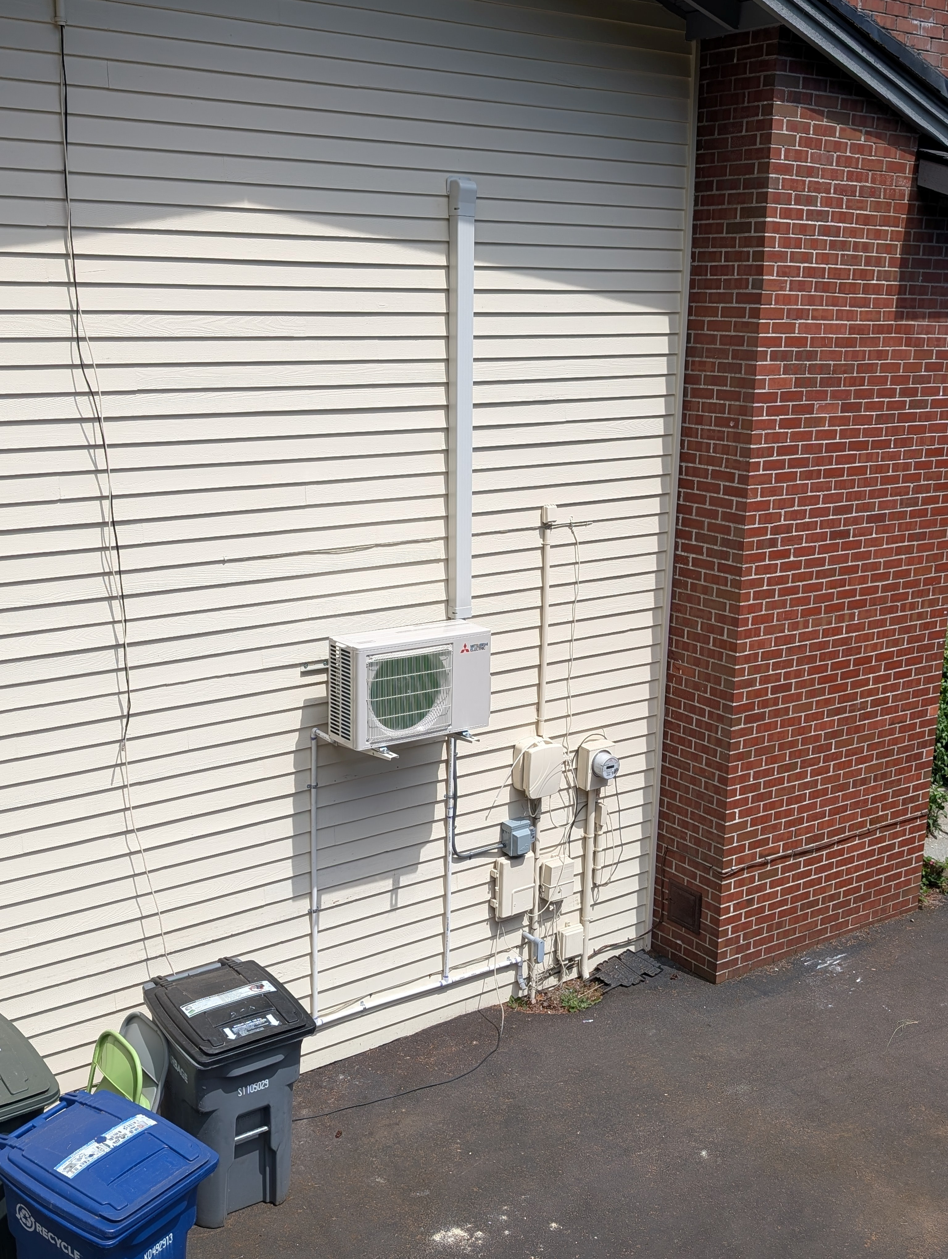

    This very inexpensive mounting bracketry (from Amazon) looks like it would work. Says it has rubber isolator mounts.
    I will pay somebody to install. 18,000 btu may be more than I need but rather have too much than too little. Have easy access to 220v connections from nearby house electrical panel. I like Mitsubishi but they tend to be pricey. I have been very happy with my Hisense portable heat pumps. I'm sure they have something similar to the above for less.

    One word of caution about mounting. Although those brackets are called wall mount they should NEVER be used on framed walls as the vibration will transfer into the framing. You always want to mount to masonry or ground mount the unit. Make sure the unit is above the expected snow cover. The outdoor unit makes a fair bit of defrost water in the winter, so mount it away from walkways.

    You can mount it on a framed wall and secure it to the studs for a solid attachment. You just need to install proper vibration dampers so the vibration does not transfer to the structure. Most of these units don’t produce much vibration anyway. Every one I’ve installed has been very quiet—both the indoor unit and the outdoor unit.
    here are 2 different types that will work:
    pecmsg
    pecmsg Posts: 7,634
    edited April 25
    the Fujitsu at our summer house certain harmonics would be noticeable late at night when everything was dead quiet.
    those mounts solved that.

    @kadini If you ware Ok with a window shaker, a mini split will be WAY quieter. The difference between one mounted on stud walls and one mounted on foundation/ground is the first one you hear, the other one is silent.
    The issue is depending on where on the walls the unit is mounted, it could resonate at certain compressor speeds (these are variable speed units, compressor speed changes with load). What usually happens is the unit is mostly Ok, but sometimes you hit a resonance where the house sings. If you are luckly, it will be quiet, if not, it will be annoying.
    @EdTheHeaterMan I tried every kind of isolator to fix a stud mounted unit. They definitely helped but there is no comparison with ground mounting.
    The challenge is most isolators don't have enough deflection and you need add a lot of weight (ie concrete pavers) to the wall mount brackets.
    To work at the typical compressor speeds you need about 3/16" static deflection and about 150lb of weight. Most isolators are not soft enough for that and the ones that are won't hold any shear load. Most wall mount brackets won't hold all that extra weight either.
