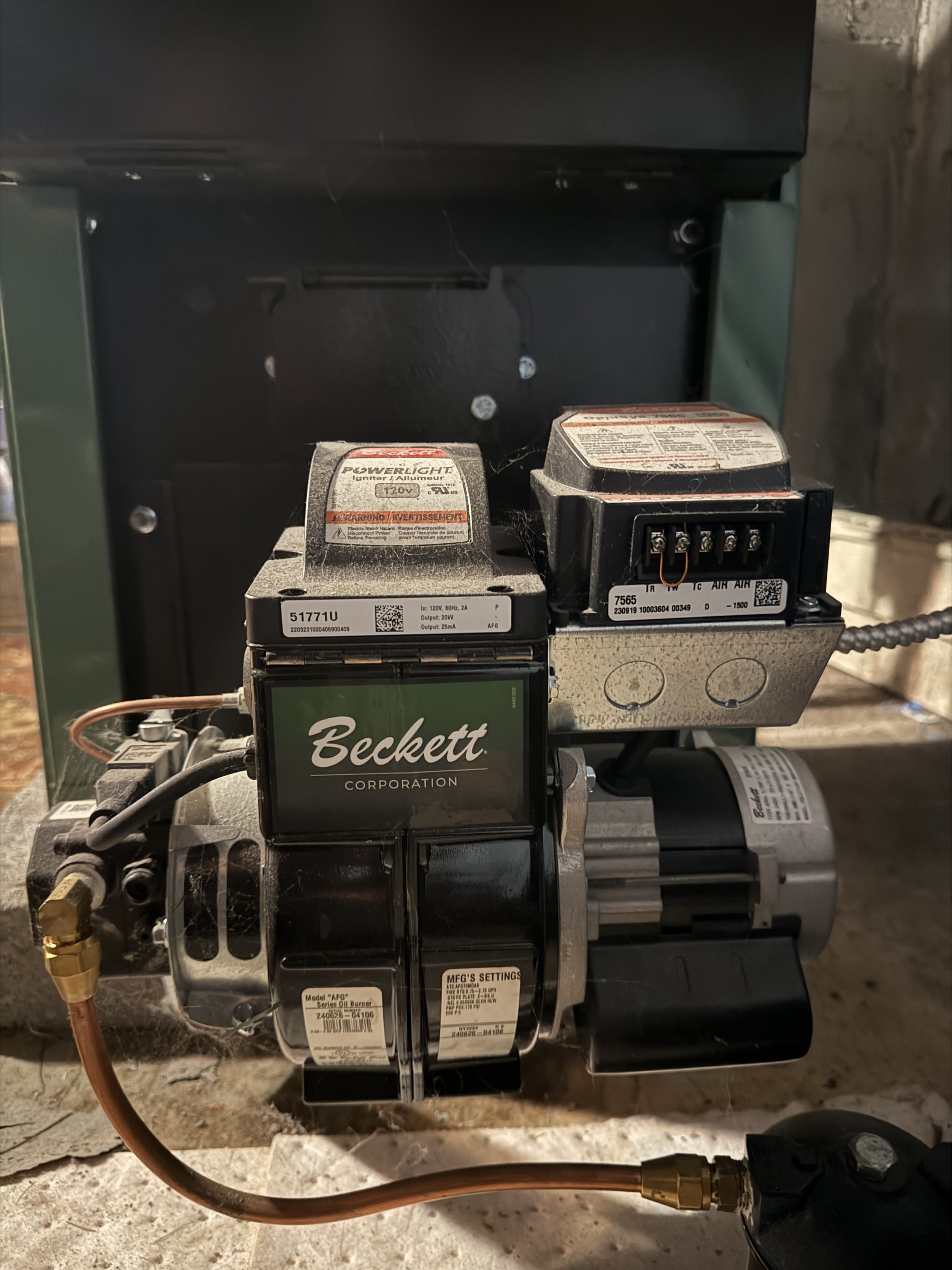

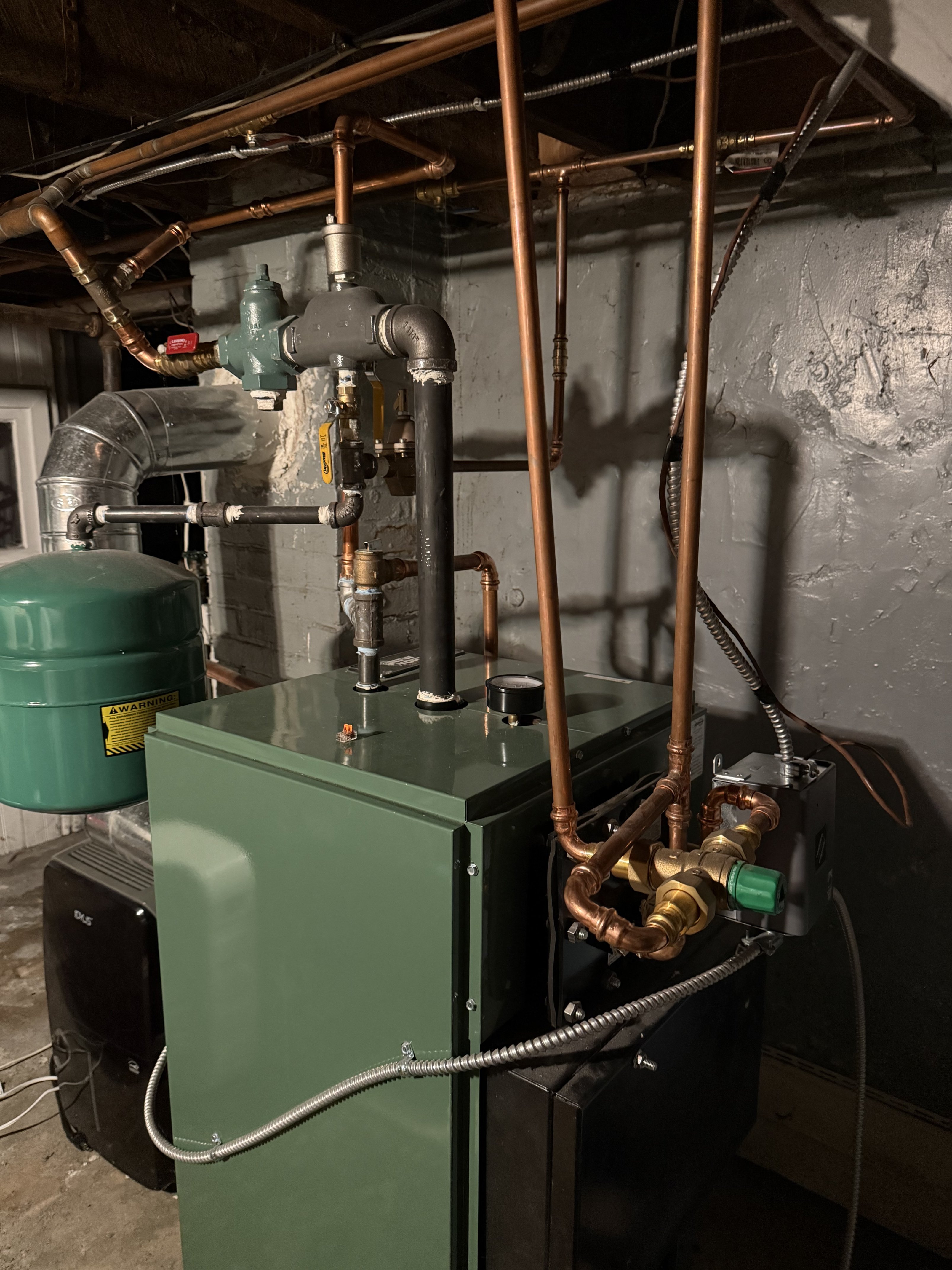

    Thank you for your willingness to assess. The water heater is on the other side of the basement and connected to the boiler via the copper pipe(s) next to the aquastat/control box on the boiler. Thanks again.

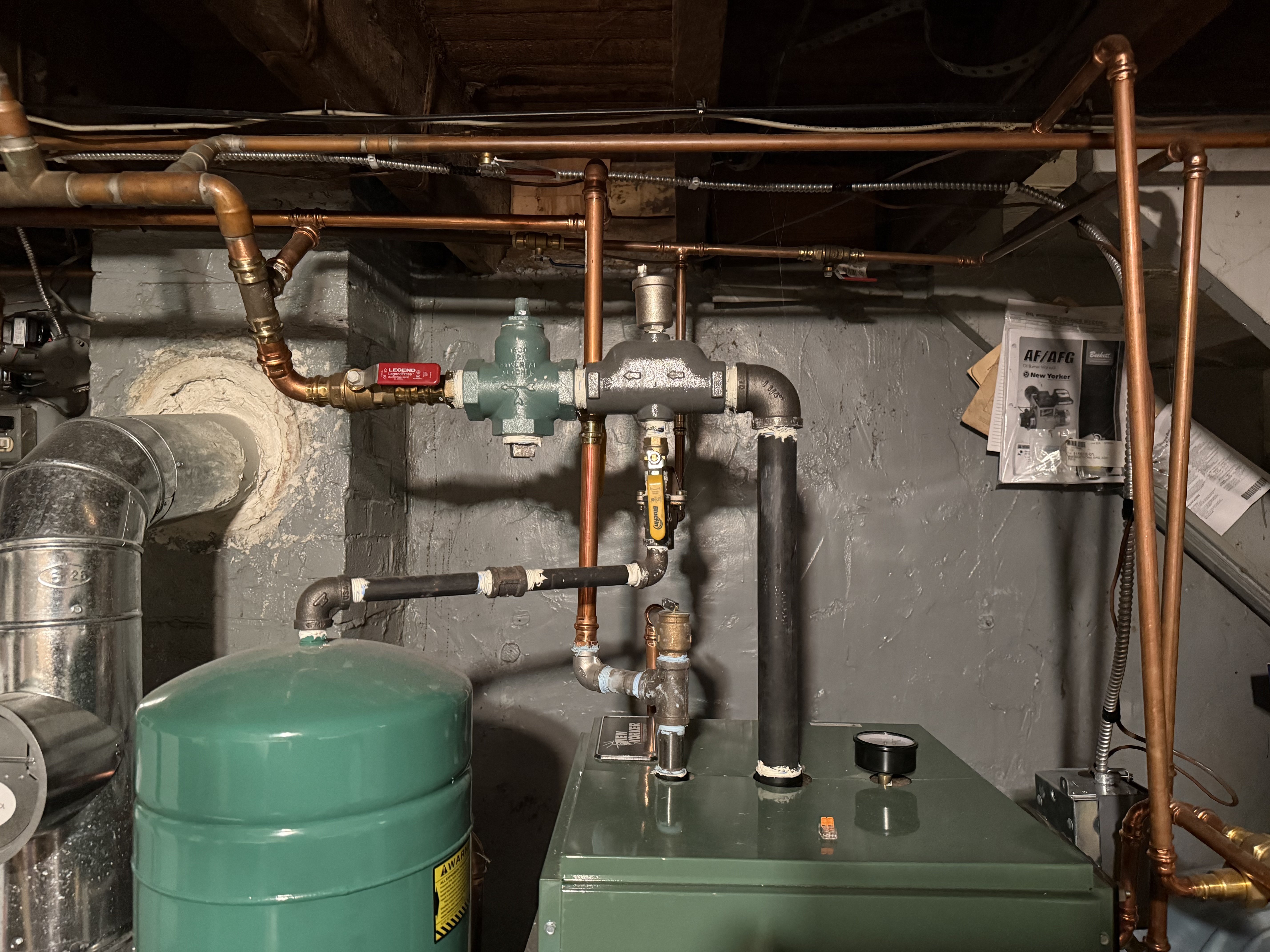

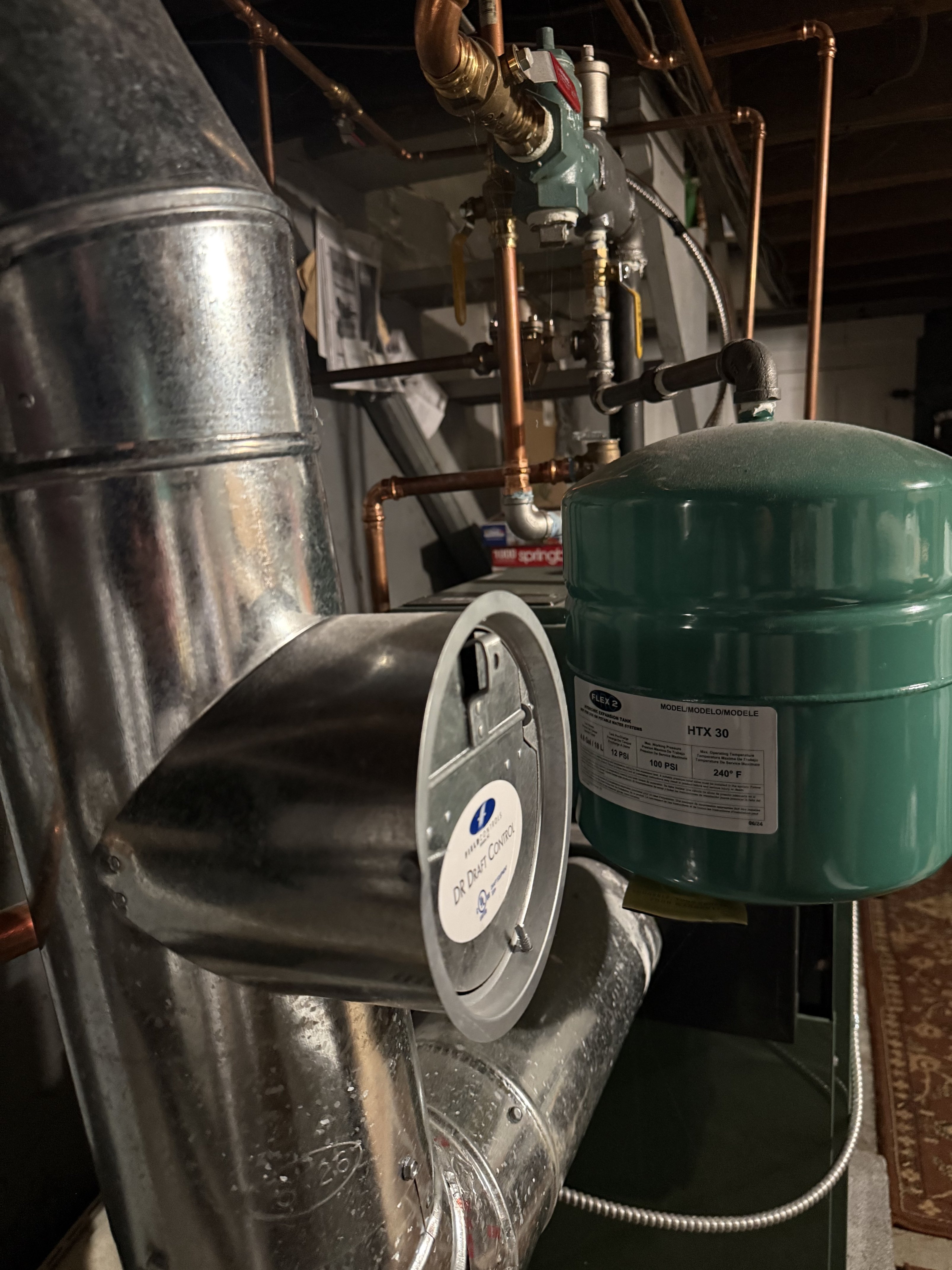

    Please have someone (or you) put a hanger on the expansion tank pipe. It could snap and cause a flood or other damage. If the boiler install is recent call the contractor back he should know better. His install is unfortunately sloppy and not professional.

    Thank you for the feedback. Please clarify what to do? The pipe to the expansion tank that is parallel to the ground requires support? I should use material to sling it to the ceiling? Thank you.

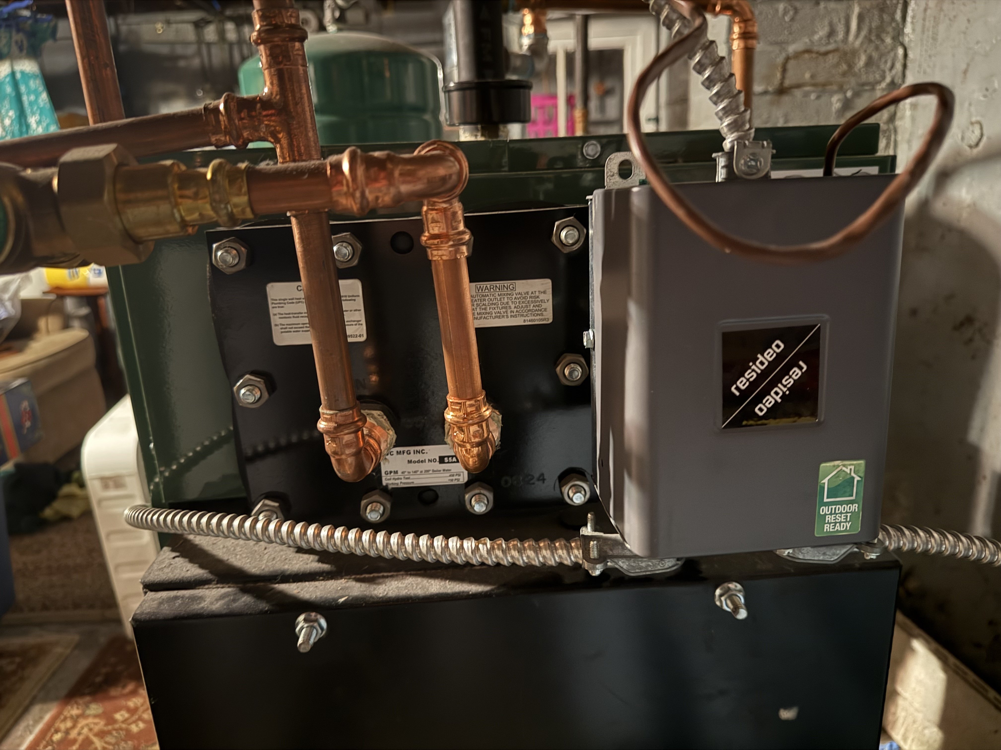

    Hi, I'm wondering if the tempering or mixing valve (at the boiler) is working. You should be able to use that to prevent "too hot" water from feeding the water heater.

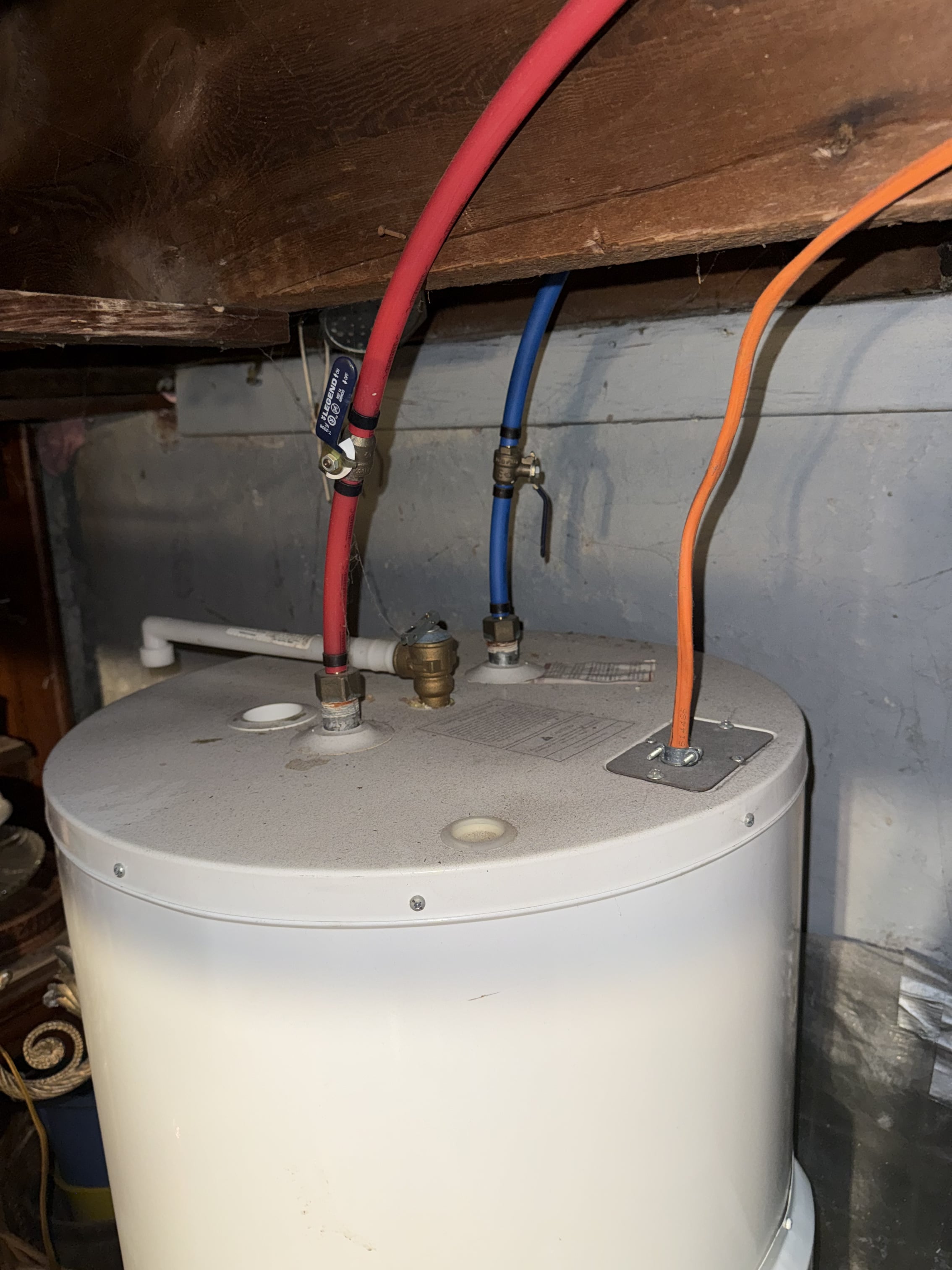

    i wonder if the electric tank is just used to keep the water heated by the boiler hot if it is traveling a significant distance to get to the fixtures.

    Yes. You could use metal "plumbers strap" you can get it at a big box or hardware store. The expansion tank is about 1/2 full of water and with that long horizontal pipe that is a bit of leverage on that joint.

    We really need to see all the piping. The boiler has a tankless coil with a mixing valve for domestic hot water. If the hot out of the mixing valve feeds the cold in to the tank water heater, it shouldn't be hotter unless the mixing valve is set very high. Trace out the piping.
    ethicalpaul Posts: 9,097
    or if the mixing valve has failed
