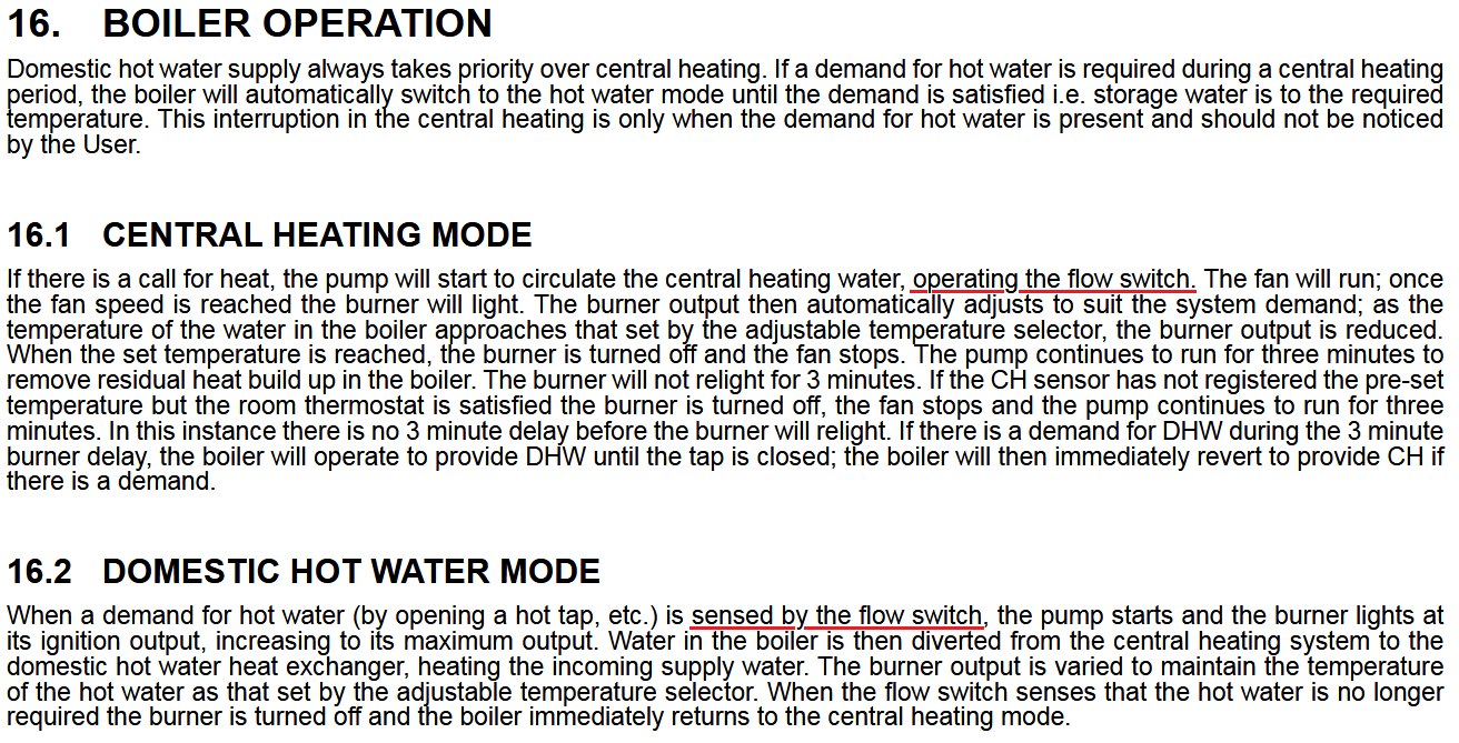

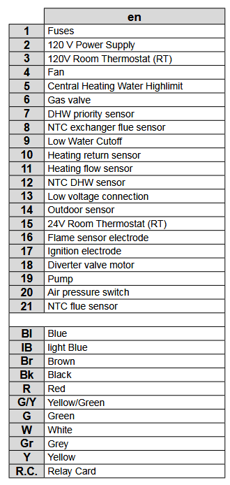

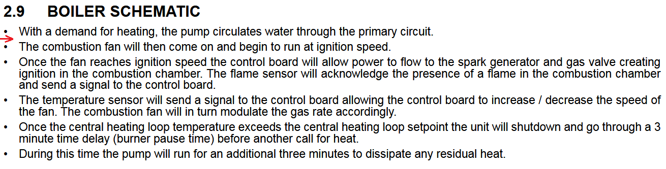

    With the information you provided and a bit of reading between the lines (Red Arrow). I would suspect the Heating flow sensor (item 11) is not sensing flow (amusing that is actually what it does). Anyway that is where it seems like where the process seems to stop.

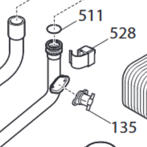

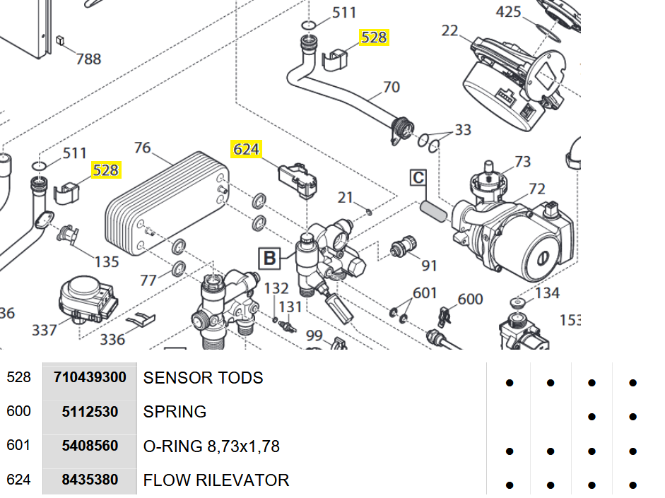

    Seems both items 528 may be temperature sensors, the documentation is a bit confusing, apparently different physically and possibly electrically different from the other NTC temp sensors. 624 is a flow sensor but may only be used for DHW use.
    109A_5 Posts: 4,759
    To me this implies there are two FLOW sensors, however I only see one actual flow sensor. Confusing.
    109A_5 Posts: 4,759
    All these items seem reasonable ?

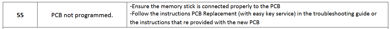

    When auto calibration is started, circ pump comes on, and then nothing. When I reset, it throws a E55, PCB NOT PROGRAMMED. ???????????????????
  • geofear
    geofear Posts: 22
    I have read the BAXI "How to reset E55 Fault Code", which is basically a hard reset. nothing.

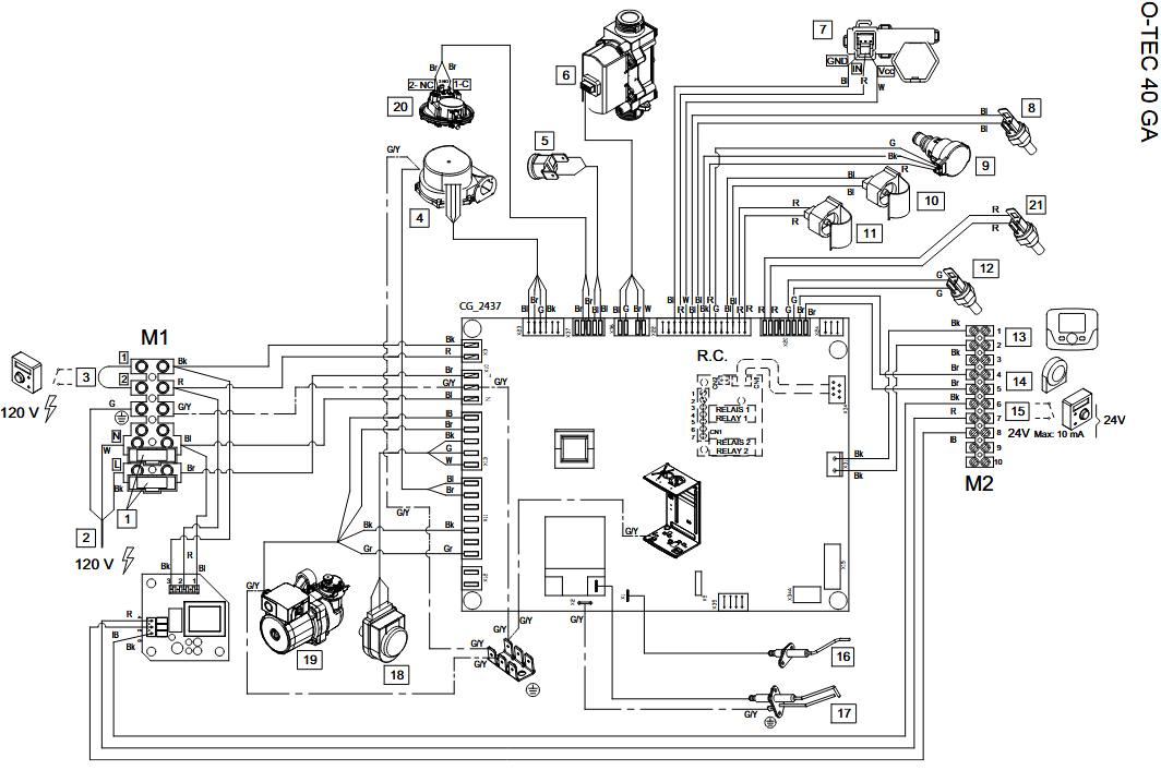

    The wiring schematic is the road map to see where the open circuit is

    Now you say there is a code 55. So now you are fighting two issues, the original AND the code 55.

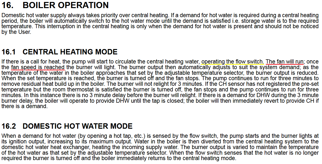

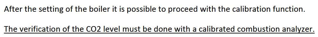

    The procedure is in the Troubleshooting guide posted above, however you probably need a combustion analyzer to complete the procedure once the boiler fires.
    Did you try the new PCB with the old memory stick?
    Originally I'm thinking this is not being satisfied.
    When the circulator starts the boiler wants to see a temperature change to verify the flow. Presently I would imagine all the sensor temperatures should be close to the same temperature since the boiler has not run in a while (Sanity check).
    If the water can't flow there won't be any temperature change at that sensor. So maybe a bad circulator, the system has too much air in it, or some valve (probably for air purging) is closed blocking the flow.
    Can the original PCB and Memory Key be reinstalled ? I'd try the original Key first (with the New PCB), may get you back to the original issue.

    I think the call for heat is valid since the circulator starts, I assume it is the circulator inside the boiler.

    "The procedure is in the Troubleshooting guide posted above, however you probably need a combustion analyzer to complete the procedure once the boiler fires." If only it would fire !
    Did you try the new PCB with the old memory stick? I shall, but I have repeatedly verified all the parameters.

    At the point that the startup sequence seems to stop it appears it is looking for data from this sensor to prove water flow.
    So since the boiler has not run in a while all the temperature sensors except the outdoor one should read about the same temperature (a sanity check).
    Since I believe this sensor is a temperature sensor and not an actual flow sensor, the system must be looking for a temperature change as the circulator starts to move the water. No water flow for what ever reason, no temperature change.
    Does this sensor display a reasonable temperature ?

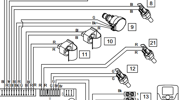

    If this is the board you are referring to, at the Red arrow, it appears it does two things; It makes 24 VAC to possibly power external equipment connected at M2. Also if a 24 VAC thermostat or switch is placed at M2 (the Green arrow) it may control a relay on the board at the Red arrow. The relay contacts may act in parallel to or as a substitute for a 120 VAC thermostat or switch is placed at M1 the Orange arrow.
    Your drifting voltage may be normal depending on the points the meter is connected to.
    However I am not confident the wiring diagram is showing the whole story.

    I have since replaced the wet sensor in the lower left (probably what is referred to as the FLOW SENSOR, and now i04 reads a more reasonable 64.4 degrees.

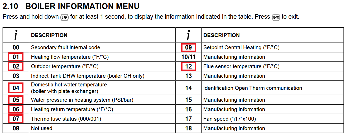

    On another note, i07 shows the status of a "thermo fuse" (000/001) . I am showing a reading 001. Where the hell is this fuse?
    109A_5 Posts: 4,759
    If the numbers in the chart below correlate with your display information. I would expect 01, 04, 06 to read basically room temperature since the boiler has not run. 02 should be the outdoor temperature. 12 should be about room temperature however if there is any draft of outdoor air through the air intake / vent system it may be offset a bit by the outdoor temperature.
    Any large deviation from expected could be a sensor defect a poor or wrong sensor wiring connection or a compromised (crushed) wire causing issues.

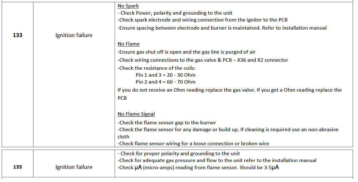

    E133 is an ignition failure. So maybe you have progress (with the flow issue) and maybe moving on to another issue.

    I can't find anything I would call a "thermo fuse" the closest thing is item 135, which I believe you changed. I would call it a thermo switch. However it may be a one shot deal. If that thermo switch was defective it may be wired into the system (by design) to disable the Heating flow sensor, hence the crazy temperature reading of 254.

    Here you mention info readings of 01, 04, 06. Please see 07, and its reference to a thermo fuse and 000/001. That's the FUSE I was asking about. I do appreciate your expertise and helpful comments.

    I looked at the wiring diagram and other documentation. Maybe you missed that post, as I stated previously
    " I can't find anything I would call a "thermo fuse" the closest thing is item 135, which I believe you changed. I would call it a thermo switch. However it may be a one shot deal. If that thermo switch was defective it may be wired into the system (by design) to disable the Heating flow sensor, hence the crazy temperature reading of 254. "
    As far as the meaning of the status 000/001, I would think 001 would be On or the fuse is good and 000 would be Off or the fuse is bad or open. I could not find any more information on the "thermo fuse".
    If it was me and I was curious, I would unplug the unit remove one wire from item 135, make sure the loose wire can't touch anything, restore the power to the unit and see if the status of 07 changes.

    E133 is an ignition failure, which could be caused by an insufficient power issue or a wiring error.
