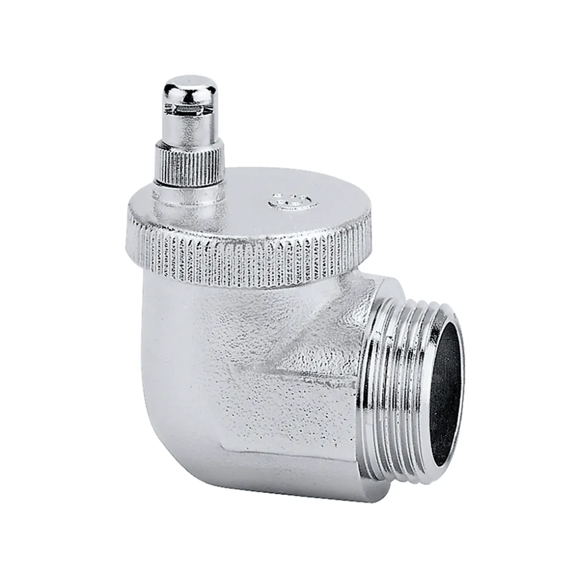

I've encountered some quirks using the Caleffi 504 aercal, and I wanted to see what the folks here thought. The Aercal is a right angle radiator vent similar to the Minical, available in Europe, but not yet in the USA. However I was fortunate enough to pick up some up on a trip to Europe. The threads should be G 1/2" A on the 504401s I have, which is a British Standard Pipe Parallel (BSPP) thread, not compatible with National Pipe threads due to a different thread shape and pitch. However, in my case I'm using Hudson reed radiators imported from the UK, which appear to use the BSPP threads, so in this case, the valve should be appropriate without an adapter, since both parts are on the market in the UK. I will say that in the 1/2" size, NPT and BSP are the same threads per inch, so sometimes they will appear to mate up particularly when tapered fittings are used, but I think this will be an unreliable joint.
Now, it's obvious that a straight threaded joint will not make a reliable water tight seal. It appears there are two approaches discussed on this topic. One is the use of hemp or loctite 55 to seal a straight joint. The other is the use of an o-ring or gasket. The Aercal comes with a fiber gasket. Easy right? use the gasket. The Aercal screws easily into the radiator up to the last thread, then becomes very tight, well before the fiber washer is compressed. I used the Loctite 55, and it seems to seal. But something is weird, why would it not enter far enough to compress the gasket? Is the radiator actually NPT? I tried an NPT coupling and the Aercal goes only 1 turn before the threads do not work, although hotrod previously showed an NPT nut screwing onto one. It could make sense depending on the portion of the taper included on each fitting.
So my questions are, why doesn't my straight threaded Aercal penetrate deep enough into the radiator to compress the included seal, and is the loctite 55 joint properly made?

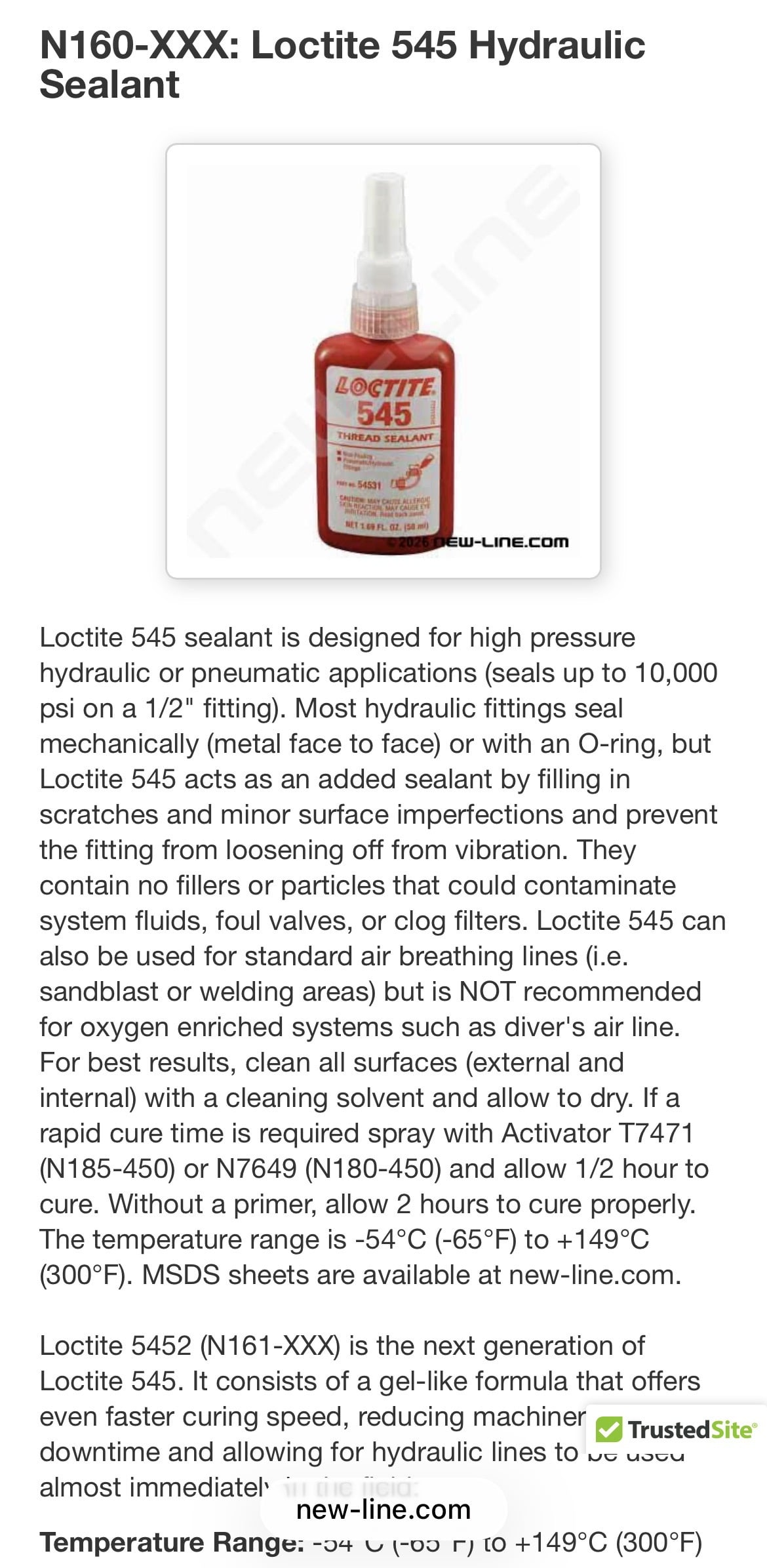

    545 and 272 are the Loctite we use at the factory to assemble BSP without gaskets

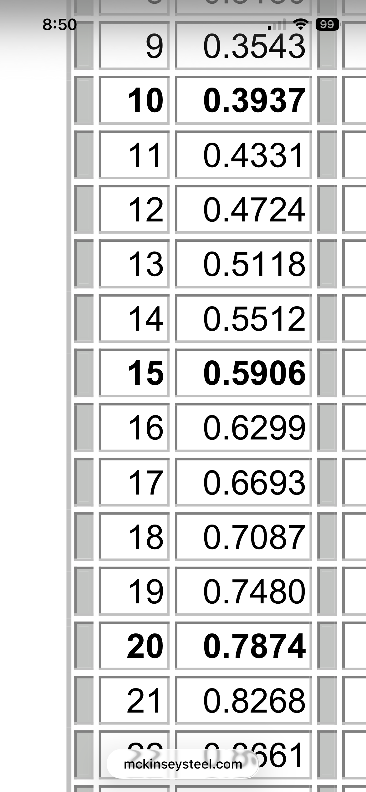

    With a bit of work you can make a 15 mm fitting work on 5/8” od, .625” copper tube. The dimension are a few thousands off

    pretty much any ball valve you purchase is assembled at the “belly seam”with loctite, we use 545 for fine thread assembly That is a very shallow thread if you have ever disassembled one, and they test to 300 psi or more.

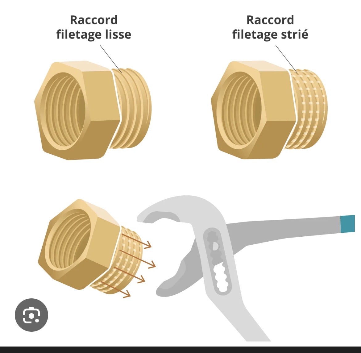

    Many of the fittings Caleffi makes have hemp threads The threads get a knurling tool run around them so the hemp stays in place. Ir make your own hemp thread with a slip joint pliers🫣
    The hydraulic industry also seals connections with loctite that operate at high temperatures and multi thousand psi conditions
    If you can get at least two threads into the radiator, with Loctite, it should hold 30 psi without an issue

    Second question is, I thought this is BSP to BSP, I will confirm tomorrow when I receive a G 1/2" BSPP tap, and a thread gauge. I also note that the caleffi 504 is pre-knurled, which suggests the manufacturer is expecting it to be hemped/sealed at the threads. So if it's BSP to BSP why does it bind after 4 turns? It would seem surprising to me if they tapped everything NPT parallel since other radiator importers do not do this. But I guess I need the thread gauge to know for sure what it is.

    Actually there may be a 3rd option as the interior appears that it may be milled to take a 15mm compression olive, you definitely cannot see this in the photo in your post, but the bevel is there in the units I have. Not sure if that's intentional as I can't find any documentation on the approved connection methods. Still waiting on the thread gauge and tap.

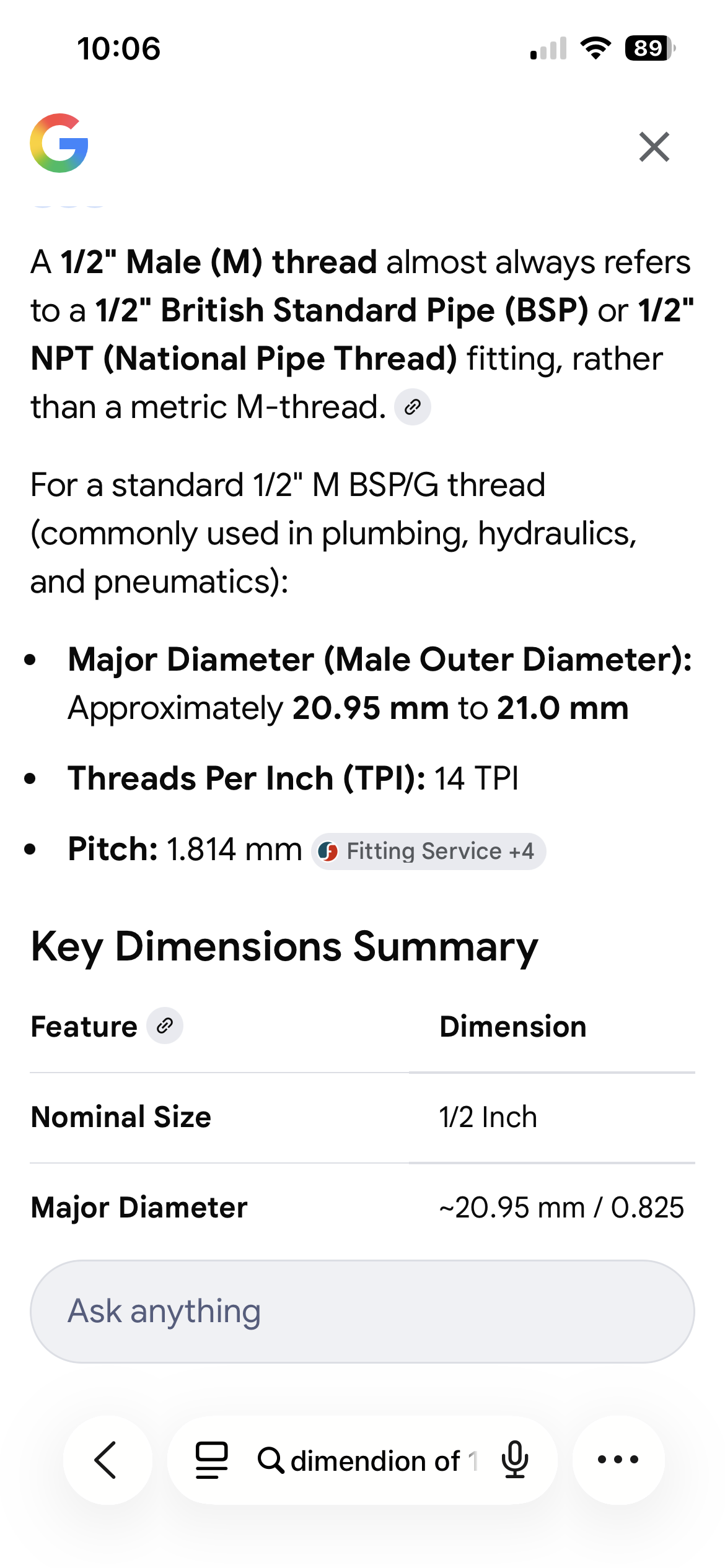

    the thread us called a 1/2” M thread, described here
    Do you have the spec sheet in the radiator indicating the thread types
    A thread pitch gauge could help determine what you have

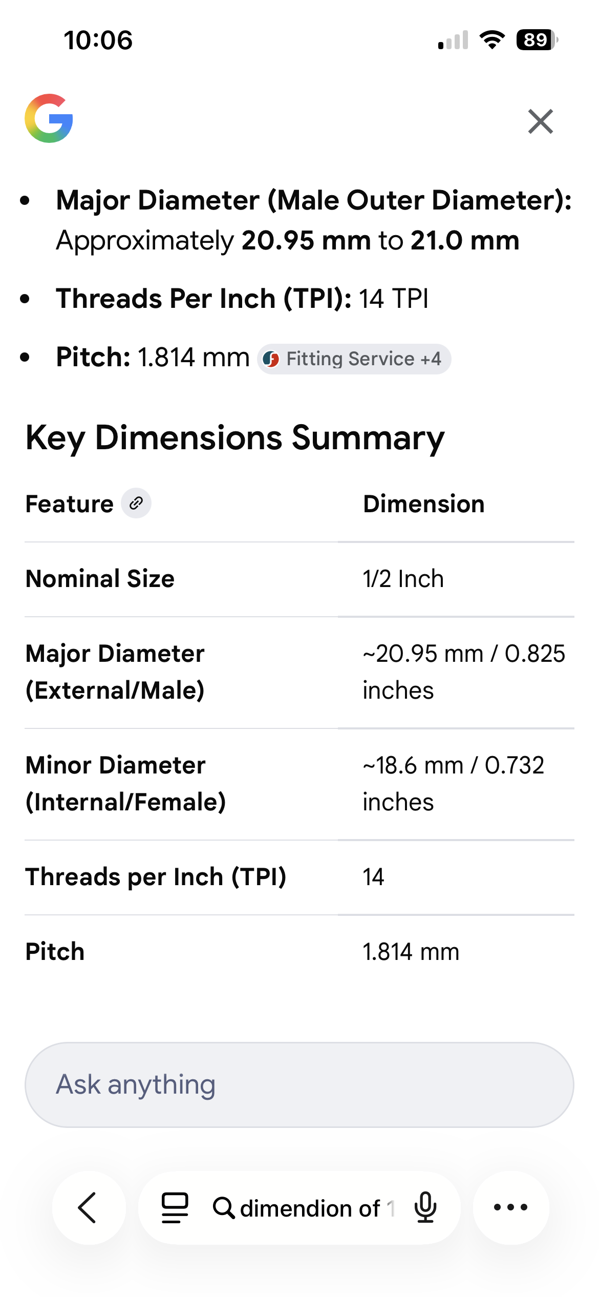

    Hudson Reed did not supply the thread specs, and I even tried asking them for it but never received a clear answer. However today arrived the thread gauge. The threads fit nicely in the 55 degree G gauge, but I don't have a straight NPTS to compare fit with, and it's so small. However the 1/2" G tap was more helpful. I threaded it into the radiator by hand, it went in nice and smooth, then suddenly at that 4th turn became immediately stuck. I used pliers to turn it every so slightly, less than 1/16th of a turn, and it went back to threading in clean by hand the rest of the way. Radiator was factory new, never used and never had a valve in that port. I tested some other ports and found sometimes they could be sticky as well. So I think it is a thread quality issue. I definitely was not cutting metal with the tap, just chasing the threads and had resistance only at that one point. So I think it's a thread quality issue on the radiator.
    Now the 504 Aercal threads in nicely be hand, and it looks like there is plenty of room to compress the fiber washer and get the valve facing straight up. If I can't for one of the radiators, I might try to get a thicker washer or use a different kind of washer. I think it's it's worth the extra 30 seconds or so to put the Loctite 55 cord on the the threads, since that would likely reduce the severity of any leak to develop, but also provide a backup seal. I've noticed that the o-rings on some of the blanks and tend to need tightening up after a few years, but you wouldn't want to do that with the Aercal since it would become crooked, so that would probably require depressurizing the radiator and installing a new washer.
