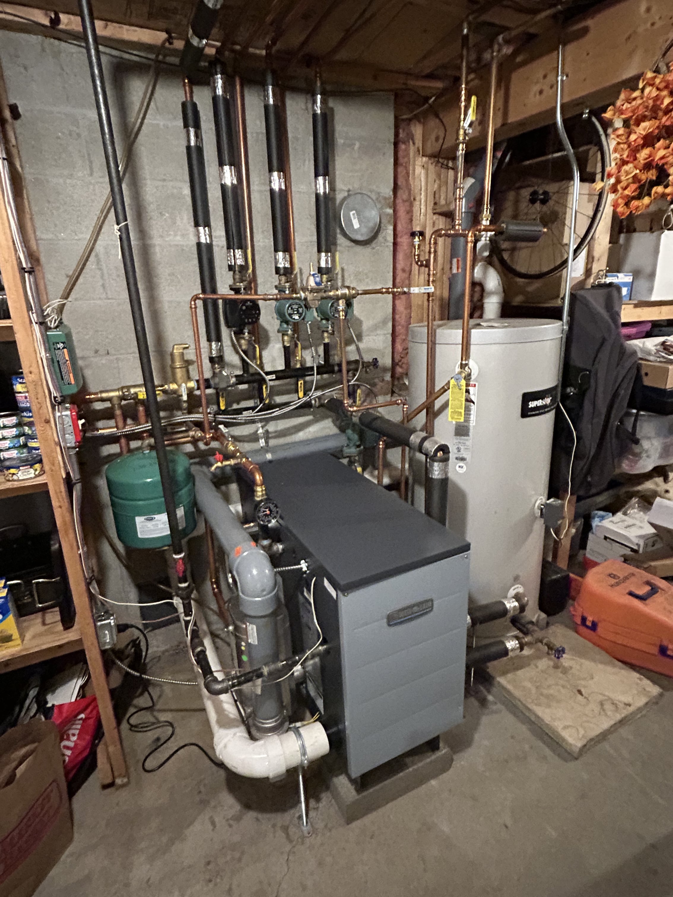

repeatedly getting air into baseboard hot water - need to find root cause
Hello - I have 3 zone NG boiler hot water heating. 1 zone (first floor) keeps getting air and the pump stops working. Have had multiple HVAC services, pump replace 2x, and they all bleed the system and then it works for about 2 months and then quits again. None of them seem to know how to diagnose to find and fix the root cause. Other 2 zones work fine; have never failed. System also has a "4th zone" superstore hot water tank. Appreciate any advise on how what might be the root cause, how to diagnose, and resolve. Picture of system attached. Thank you!

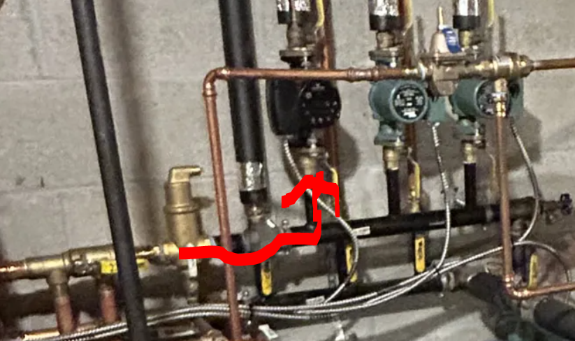

    The spirovent could be stuck closed or clogged or have a plug/cap in the otulet, i can't tell if it is open to the atmosphere in your picture. Although unlikely, air could come around in a big enough slug that it fills the chamber in the spirovent and airlocks the pump all at once. since that is the first zone after the spirovent that is certainly a possibility. It looks like a bunch of air could hang out in the coil of the indirect unless you were carful about how you purged it.
    hot_rod Posts: 28,708
    I think that indirect has a 3/4 coil, so it takes a good flow to first purge them, being low go the boiler they can be tough to purge. Air, hot air, like to rise up to high points.

    the pump on the left is a grundfos either upse or alpha? looks like it anyway. those have a dry run protection feature, not that they are perfect but it should just stop pumping when it detects no fluid to protect the motor. Is that what was happening?
    I meant earlier that if you are purging (vs bleeding), flushing fresh water through to get most of the air out, there will still be small amounts of air trapped places and all that fresh water will contain dissolved air which will also come out of solution as the pressure is lowered and the temp is raised, that air should be removed by the spirovent but if the spirovent isn't working it may just collect and find its way to the circulator.
    If the spirovent isn't working it will still collect the air but it will spill over in to the manifold once the chamber in the spirlovent is full so that may fill over time then when the circulator starts it moves that air bubble over to the veloute of the first circulator.(or possibly the combined flow of the other 2 zones can pull the air over where it rises up in the first zone which is off and gets stopped by a flow check in the circulator.)
    I have to admit that I find it very hard to buy the idea that all the air problems are coming from the makeup water, unless there is just an awful lot of it. And I still wonder — and haven't had a reply — what the pressures are in the system at all possible leak points when the system is running.

    maybe a stupid question at this point in the thread lol but do you have bleeder tees on your baseboards? Have you taken the covers off and checked for any possible leaks in there
    think about what happens if the vent on the spirovent is closed or plugged. the air will collect in it then move along and airlock the first circulator. it wouldn't take a ton of air to airlock that pump if it has a flow check and the other zones pull a slug of air out of the spriovent while the black circulator zone is off

    @frumpf , can you post some pics little closer so we can see how the boiler and zones are piped? Is it piped Primary/Secondary?
    looks to me like it is just supply and return manifolds along the back but we need better pictures
    it looks like a Webstone P/S tee valve left of the circulator?
    But the black speedy headers don’t make sense?
    Could be a mis piped P/S
  • pedmec
    pedmec Posts: 1,488
    You need way more pics. I can't even see the boiler circulator.

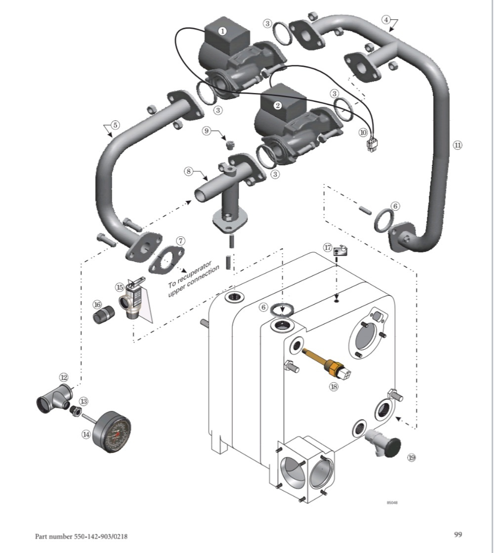

    There's two circulators in the boiler.
    There's also external circulators. That's why we need to see the piping.
  • leonz
    leonz Posts: 1,994
    That mess makes me even more happy to have a single loop and one circulator.

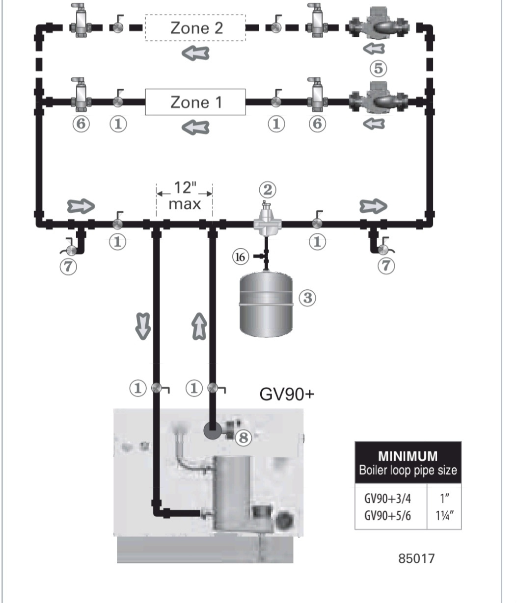

    that boiler has a thermostatically controlled bypass circ for return protection
    In some instances it can be direct piped, the manual shows direct and P/S along with recommendations for the choices
    It sort of looks like a P/S injection into parallel piped distribution?
