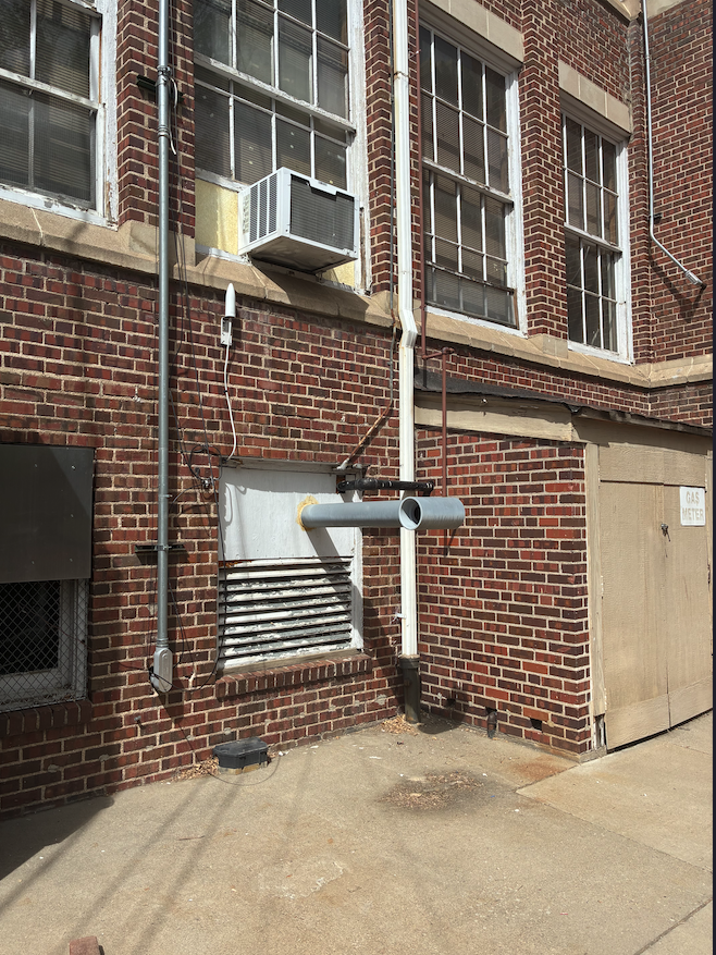

  • I work in a school in Denver. The hot water boiler for the heating system is side wall vented. Do you see any problem with this setup? It's been this way since the install in 2015. Probably the A/C unit wasn't there at the time. Most likely they will not be run at the same time but I can't guarantee that.

    I don't believe that type of AC unit is actually pulling air into the space. There are several code violations in that picture. At first glance, the intake for the boiler room is directly below, which is dangerous for folks in the boiler room. You are not allowed to exhaust at that height into the alley. The vent also needs to be protected from vehicular damage. I am sure there are others.

    Codes vary, but I suspect the exhaust vent is too close to operable windows, and it probably should be rotated 90°. It should not significantly affect the air conditioner.

  • I have boiler inspector coming for the annual inspection of the steam boiler ( we have both steam and HW) so I'll ask him what he thinks about it, as far as Denver code.
  • pedmec
    pedmec Posts: 1,488
    @michaelmiracle That unit is considered power vented which would require you to be 4" above any fresh air intake located within 10'. in mass. that looks like the old combustion air inlet for the boiler room. also 3' from in inside corner to prevent wind eddys

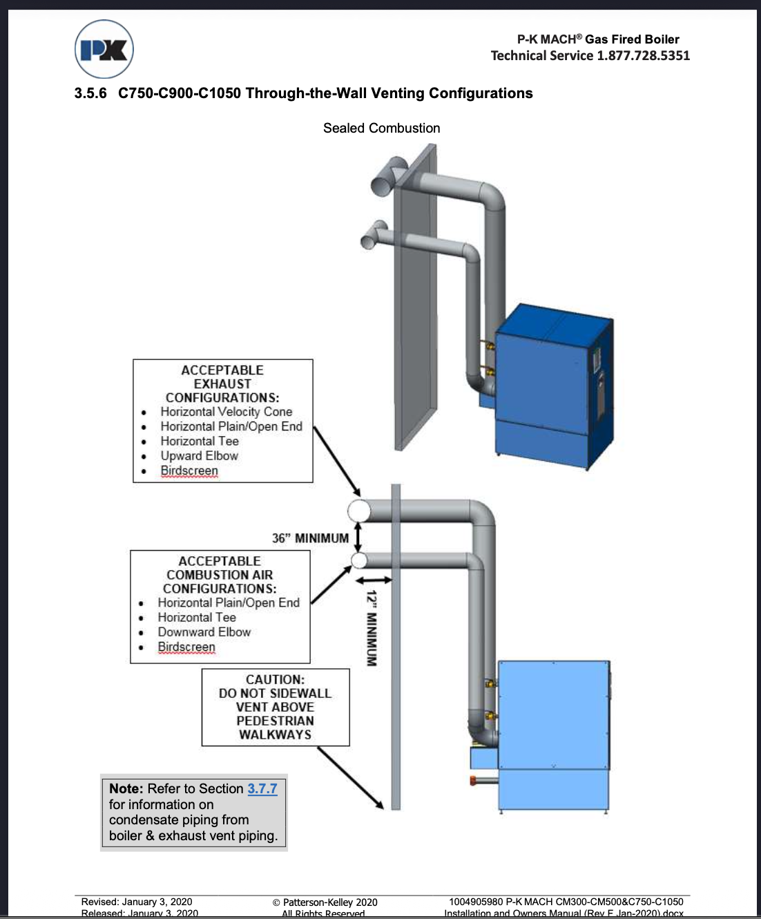

  • I looked up the manual on this boiler. PKMach 750. It's interesting how they show it. I don't have an intake affixed to the boiler, just vented to the boiler room. But here it is;
