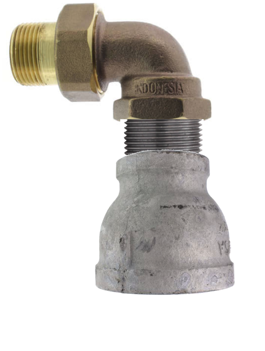

I have a one pipe steam System. I have a one and a half pipe going from the basement to a second floor bedroom. Right now this bedroom has a baseboard heat unit converted to steam. There in a 1 1/2 to 3/4 adapter on the pipe. My new radiator has 1 inch pipe. can I bump that 3/4 adapter up to 1 inch by just getting a adapter, 3/4 to 1", or do I have to remove that 1 1/2 to 3/4 fitting on the main pipe and replace with a 1 1/2 to 1" adapter.
Your help with this would be greatly appreciated
It will be better if you remove the smaller adapter and put the right one on. If the section of pie in question is horizontal or nearly so, there is a real risk of creating water hammer if you don't.

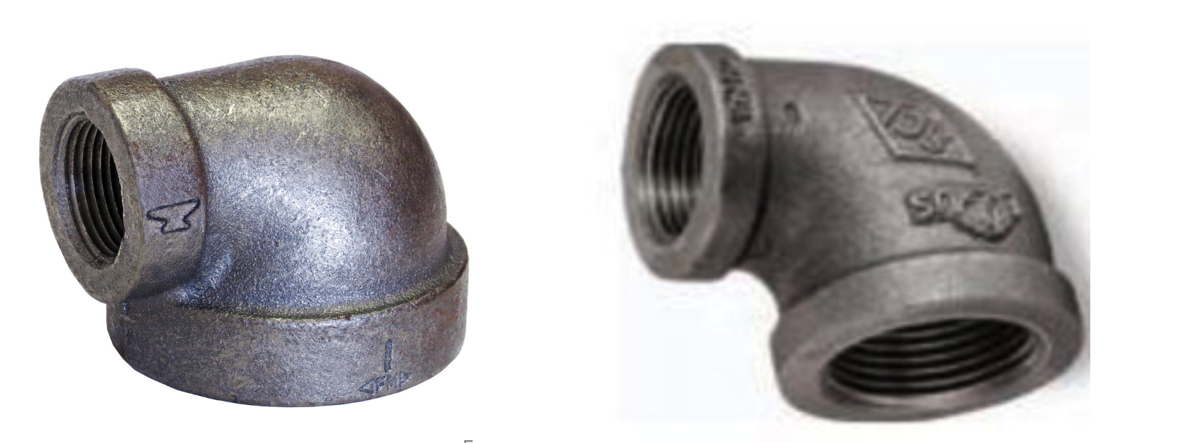

the fitting is a 90 that ties in to a 1 1/2 inch pipe and then drops straight to the basement. Thanks for the advise. will do my best to crack that fitting free.
If it is malleable iron, it won’t crack. If it is cast iron, it will. Left is cast. Right is malleable
You should actually have a 1" radiator union so you don’t need to break it apart when it is time for service in the future. Maybe like this.
i think they mean unscrew. but if it won't unscrew cutting almost to the threads hen splitting it with a chisel or sometimes even a screwdriver will release it
