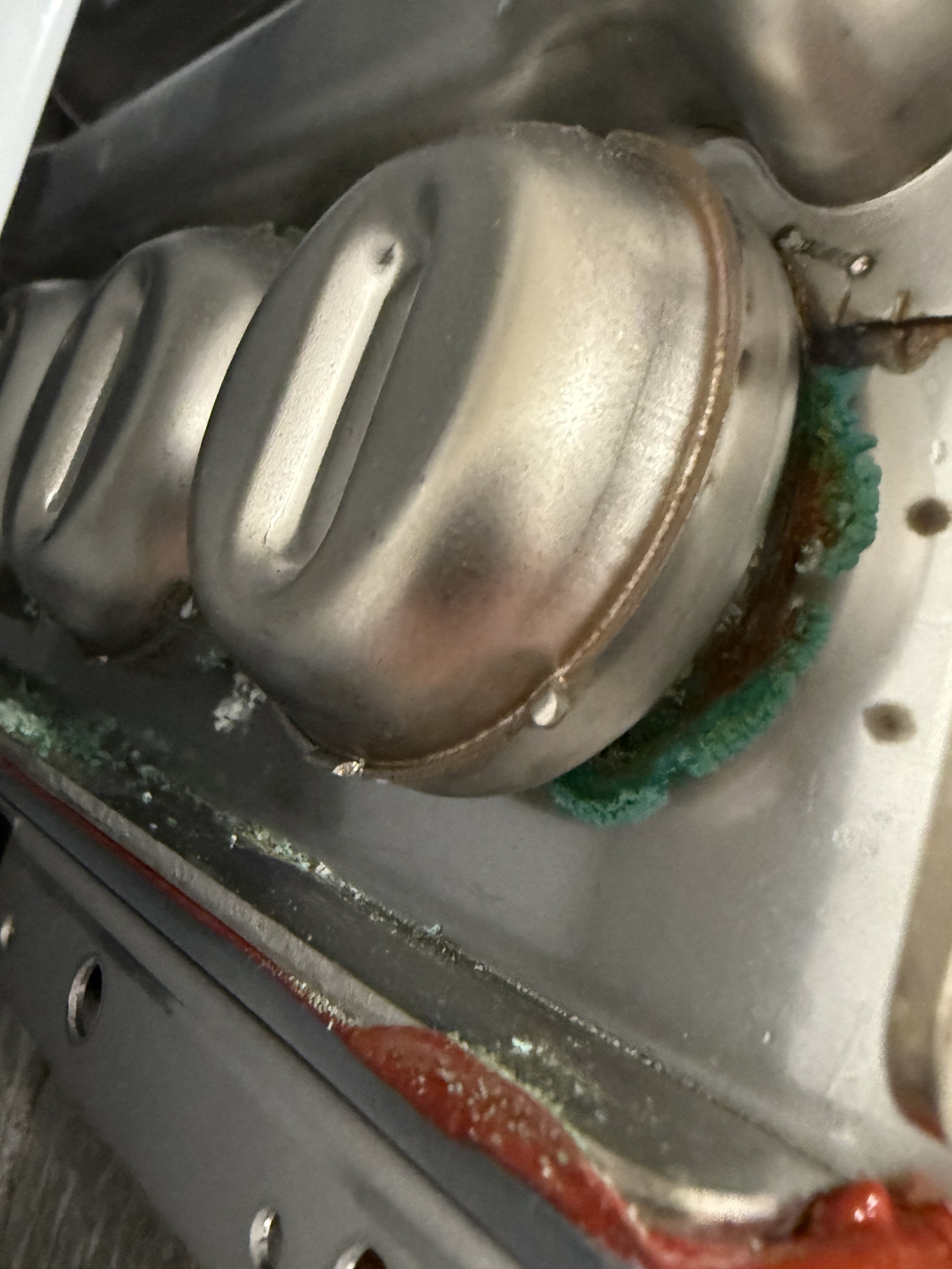

Problem:
A combiboiler with stainless steel heat exchangers has been running a mixed metal (brass, copper, stainless steel, cast iron) hepex, and other oxygen barrier pex radiant system for 2-1/2 years on municipal water. This is the 2nd heat exchanger failure. The first failure happened at 1-1/2 years. Both failures appear to have the same result.
The Primary heat exchanger seems to be the only one failing (leaking with a slight pressure drop…Had to top it up once). This seems to be the same problem that happened to the first failed heat exchanger.
There is green/blue corrosion coming out of the ends of the primary stainless steel heat exchanger which is running the closed loop radiant. The secondary heat exchanger is running the municipal DHW appears to be fine. but it's covered with a material.

After the first heat exchanger - New to 1-1/2 Years:
The system was flush with municipal water and Fernox F1 was added. The water that was removed from the system has some sediment after sitting a while but according to others in the field it seemed normal.
Sample water was not tested
After the second heat exchanger - 1-1/2 to 2-1/2 Years:
*Sample water was taken and currently has not been tested at a lab.*
I tested an 8.5PH myself. The sample water appears crystal clear with no noticeable sediment. Fernox seems to be doing a great job.
Something must be wrong in the water chemistry?
Where can I get a sample of my water tested in Canada by a lab that specifically deals with hydronic radiant water chemistry experience that will know what is wrong in the water to prevent this once a new 3rd heat exchanger is installed?
Grok AI stats that the water may have an aggressive chemistry.
possible outcomes could be that copper ions are pitting the stainless steal heat exchanger…gathering platelets?…which eventually caused a leak and the oxygen reacted with the water/copper ions making it appear as a green/blue corrosion like residue own the ends of the heat exchanger.
There are many homes in the same subdivision using the same municipal water for drinking some are probably using tankless water heaters and hot watertanks. Local plumbers I have spoken with think the municipal water very clean here and there is not a publicly know issue (at least 2-1/2 of use in my situation). So why do I have this problem? Is it because I am trapping the water in a closed loop?

    mattmia2 Member Posts: 16,730
    does the system keep pressure if you turn off the makeup water supply?
    usually a lot of makeup water is what kills boilers.
    what does the ci circulator look like? a lot of makeup water would corrode that too.
    it was not running glycol, correct?
    a lot of chlorides in the water is hard on stainless steel but I wouldn't expect that to be a problem unless there is also a fair bit of makeup water but i suppose very high chlorides on their own could do it.
  • cloudd
    cloudd Member Posts: 52
    edited 8:00PM
    I only topped up the closed loop radiant and shut off the makeup valve directly after. It's been 2 weeks since I noticed it. It's getting worse and the green/blue discoloration on the ends of the heat exchanger are starting to get worse. The PSI of the closed loop has dropped about 1-2 bar since I topped it up. I can tell the closed loop is leaking because I have a bucket under the unit and when the psi drops more a very small amount (1/2 tea spoon) of water appears in the bucket. It has happened multiple times over the last 2 weeks as it slowly loses its PSI.
    Jamie Hall Member Posts: 27,355
    Chlorides. Your municipal water people shuld be able to tell you what the chloride concentrations are in your water. And note you are interested in chlorIDE, not chlorINE. That's "ide" not "ine". There is a world of difference from the water chemistry standpoint.
    hot_rod Member Posts: 27,445
    maybe buy a ph and chloride test kit. It seems to be water related
    I’d imagine there are water testing facilities up there. You need to tell them what the concerns are. Most often potable water is tested for health concerns, not corrosion
    If it is high chloride fill it through an Axiom DM cartridge on the boiler side, but high chloride in potable water will still be a problem in the HX
  • GGross
    GGross Member Posts: 1,882
    I'm always a bit hesitant when I see boiler water in a closed loop run crystal clear. to me that says the system was taking on makeup water, and lots of it. just an observation. Prior to the failures was a fill valve left open to maintain pressure, or was the valve only ever operated manually?
    A further thought. You don't mention a water softener. Are you using one?
    or more specifically, did the system maintain pressure with the feed turned off before the boiler started leaking?
