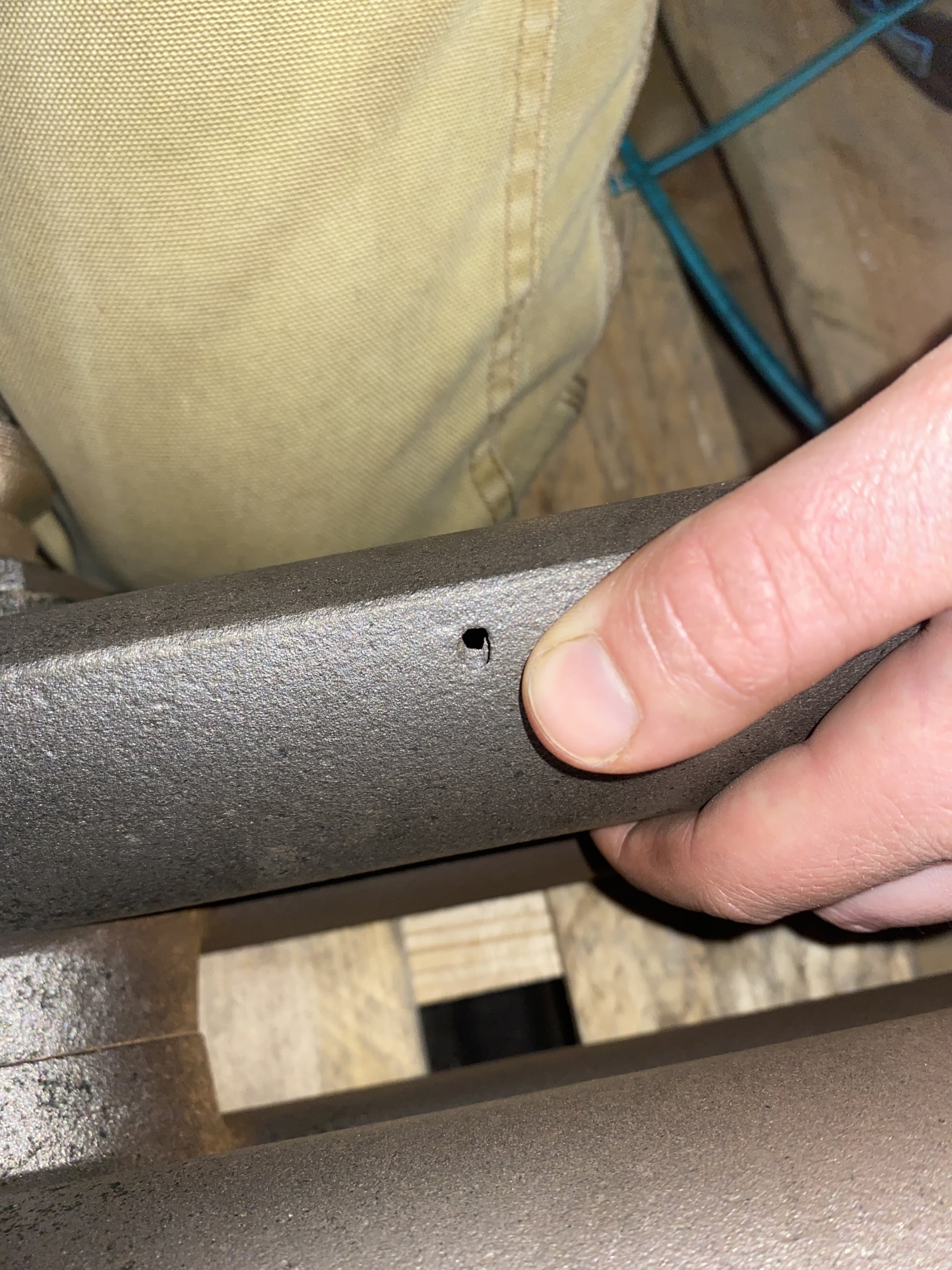

Hi

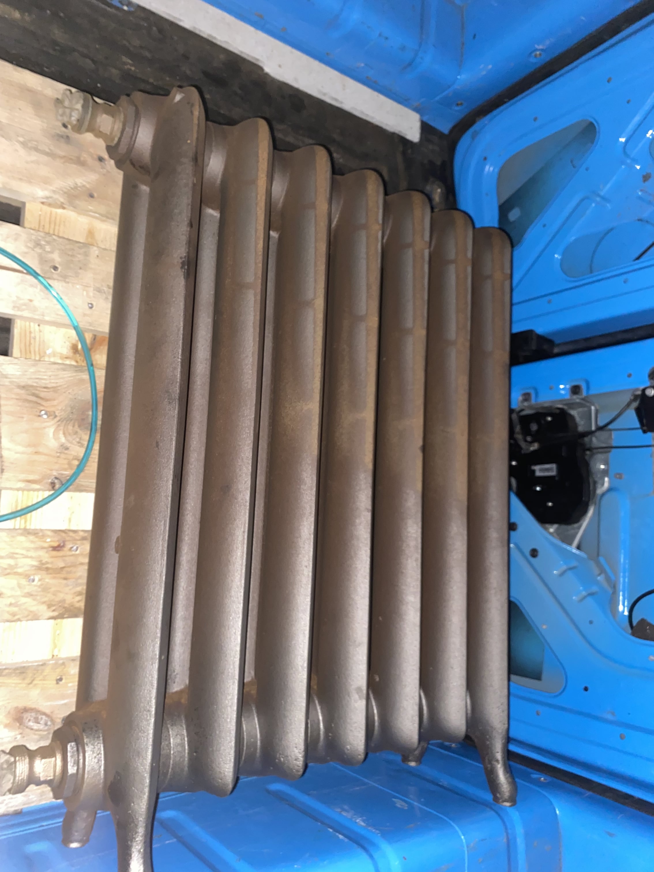

I got given a set of cast iron Radiators. Was hoping to get someone opinions on moving forward. So I work in a fab shop and I am a welder so I have access to industrial machinery. I put this radiator through an industrial sandblasting machine and came out with a small hole on one of the columns. I would like to repair it so it lasts if that’s possible. Anyone have any suggestions on how to fix ? Thanks

    braze it
    you could also drill it out and tap a 1/8" npt plug in it.
    are you using this for steam or hot water?

    I’m based in the Uk. I will be using it for hot water so the pressure won’t be going above 1-1.5 bar

    J-B Weld from Amazon

    I would tap it and throw in a plug.

    Listen to the pro @DanHolohan . A relatively small hole, a low pressure application, and you've cleaned the surface prefectly for adhesion by sandblasting. Some JB Weld will last forever.

    @mattmia2 suggests drill and tap. A very good idea. From the look of it, you can probably tap the hole without needing any drilling. In viewing the picture a 1/8" or 1/4" tap should do it with the appropriate sized plug?

    a plug or series of plugs with a certain loctite formula is how they fix cracks in ci engine blocks.
