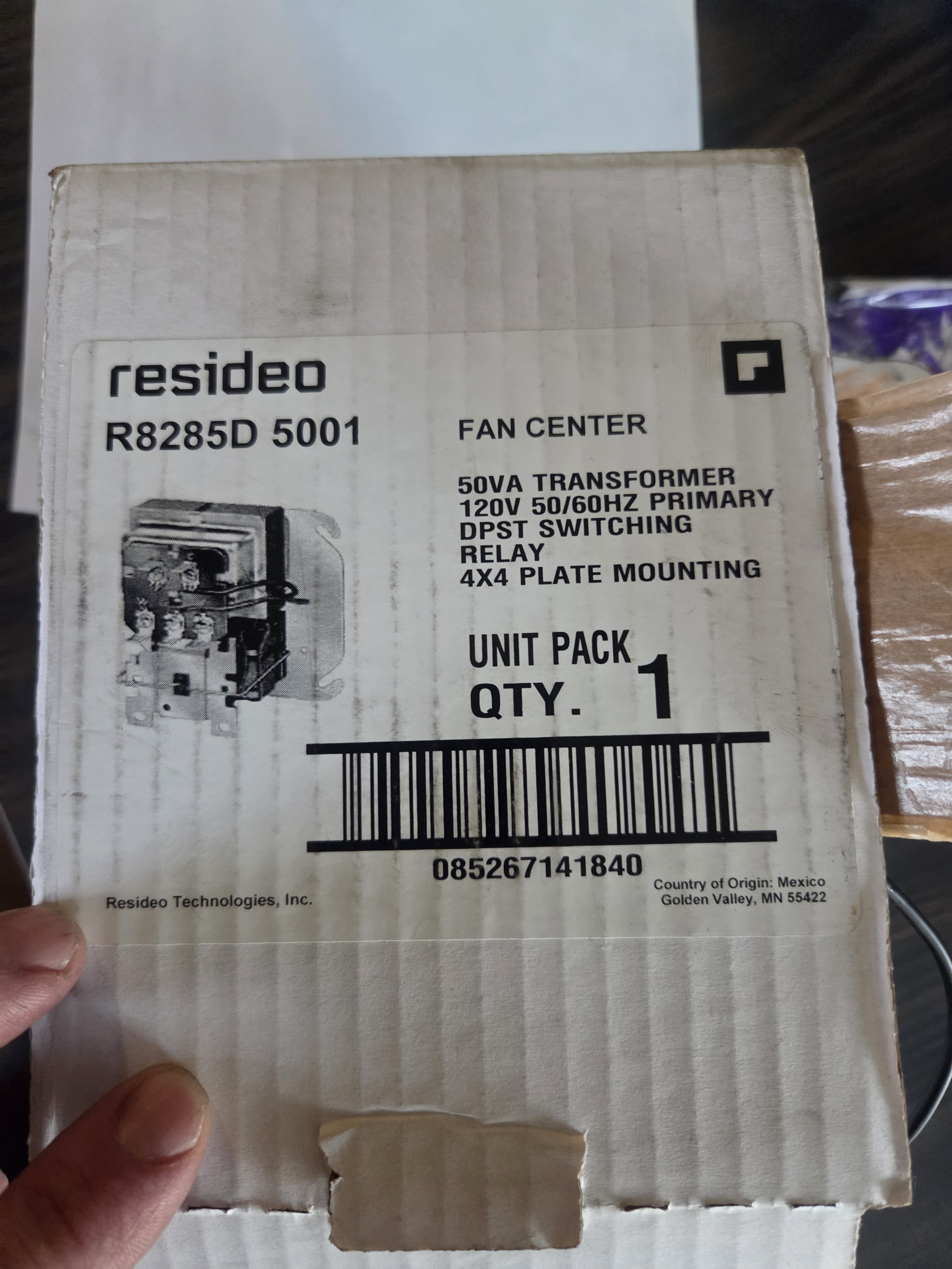

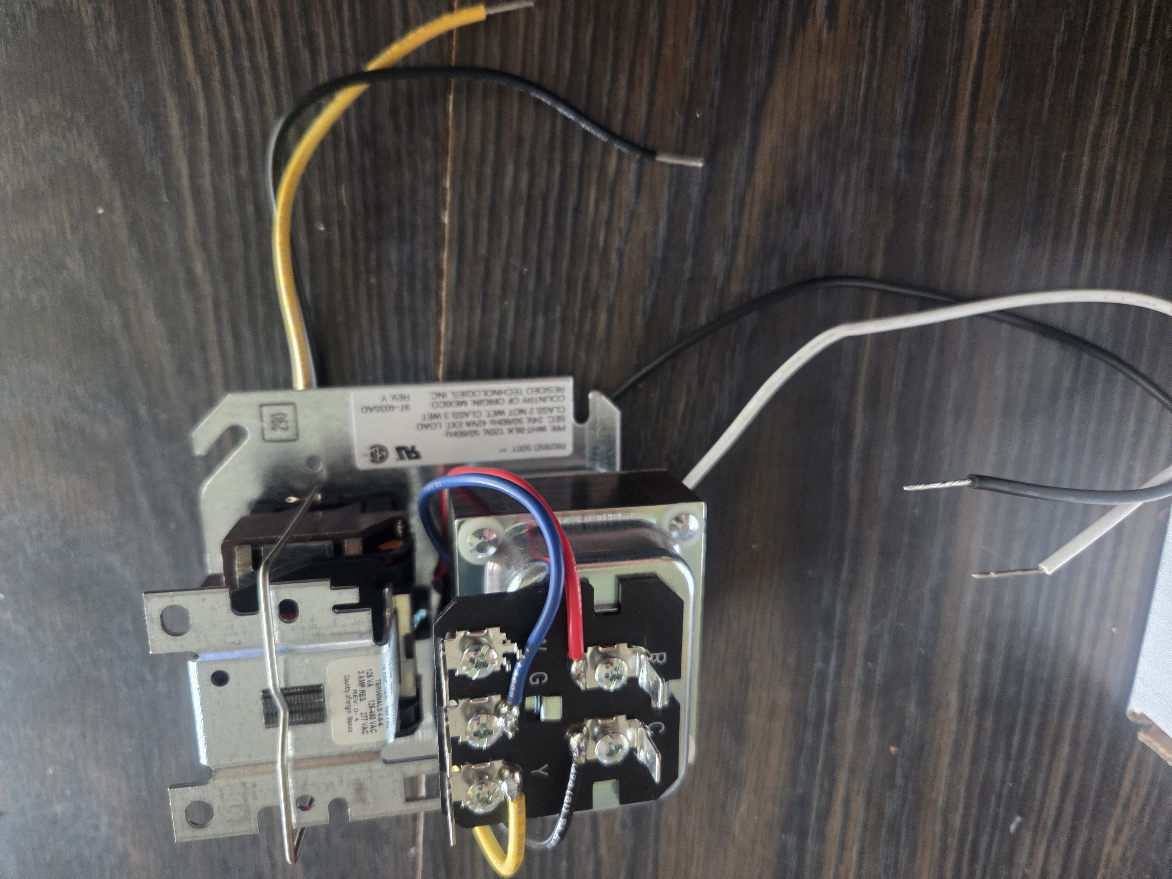

    First things first. Wire the fresh air louver into the thermostat circuit. Get an R8285A fan center, like this:
    https://customer.resideo.com/en-US/Pages/Product.aspx?cat=HonECC%2520Catalog&pid=R8285A1048/U&category=R8285&catpath=1.2.8.3.2&rank=0&v1=Sort.1.Product.Rank&asc=1
    Mount it on its own 1900 (4" square) box. Feed it with 120V and route the two normally open relay contact wires (black and red) out of the box through a bushing to keep them from abrading.
    Wire the louver so it gets 24V from the thermostat when it closes. The thermostat connects between R on the R8285A and the damper motor feed. If the thermostat needs a common wire, that goes on terminal C, as does the other side of the louver motor.
    Feed the end switch with the same 24V that goes to the louver motor. Wire the other end switch terminal back to G on the R8285A. This will pull in the relay when the end switch closes.
    And the two relay wires sticking out of the box? These go to TT on the boiler.
    Sequence of operation: On a call for heat, the thermostat sends 24V to the louver motor. The motor opens the louvers. When the louvers finish opening, the end switch closes, sending 24V back to the relay to pull it in. This closes the thermostat circuit to the boiler, which then comes on, opening the flue damper as part of its cycle.

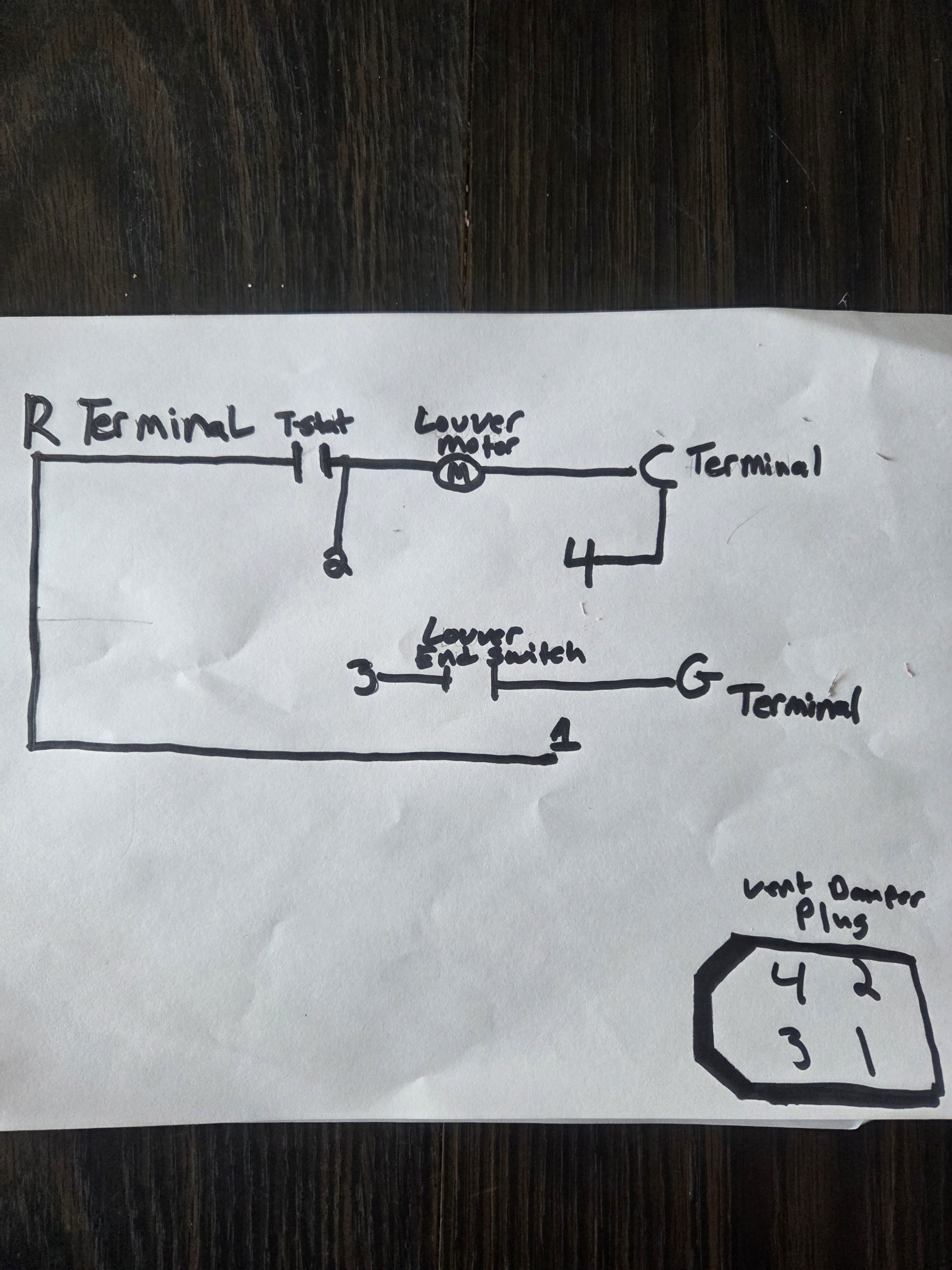

    This is what I came up with.

    @Steamhead
    If I wired it in right off of the service switch, if one of the 120 limits opened the transformer would still stay powered and the burner would still be on because of the call from the thermostat.
  • Mail4tommo
    Mail4tommo Posts: 90
    @Steamhead unless. I rewired the 120 limits with 24 volts directly in series with the end switches?
    Steamhead Posts: 19,023
    edited March 26
    No. Remember, that relay for the louver motor only operates another 24V "thermostat circuit" that is part of the boiler. The limits are wired in after that- this is the factory configuration. The louver relay can open and close all it wants, but nothing will happen if the limits open.
    The beauty of this method is you don't have to change any wiring on the boiler itself.

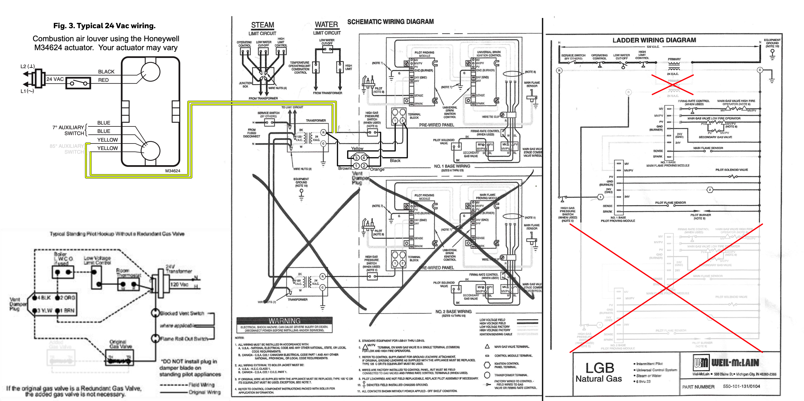

    This is your wiring diagram. The actual diagram that should be on the boiler, should not show the dual burner configuration that you get from the manual, but since this is what you have offered as your diagram here is what you need to do:
    Since there is only one transformer that powers only one set of burners on the smaller LGB boilers, you can connect the Field Controls 24V vent damper to the 24V boiler transformer, as long as the boiler transformer is rated at 40 VA or greater. The Field Controls factory-recommended plug with pigtail ends FCU-8 (not the 6-pin Molex end) can be connected as recommended by Field Controls. That cable is sold separately. The Field Controls diagram is shown in the lower left of the diagram, and only the 4 pin Molex plug and wire colors are shown in the boiler schematic diagram (I did not show it on the ladder diagram).
    Since commercial boilers may not have a room thermostat, you may or may not have any low-voltage control to power the combustion air (CA) louver actuator. I have elected to use a Honeywell 24-volt actuator, model M34624. You may use another brand or model to open and close your CA louvers. I recommend a separate transformer for this part of the wiring since that motor may draw too much current for the boiler's on board transformer.
    When using that 24 VAC device, you need to have an operator that can switch the system on with 24 VAC and connect that to the CA louver. If another line-voltage limit opens like the LWCO or the manual reset limits, to shut down the boiler, the CA louver will lose power and spring closed, reducing the amount of air through the boiler room—even though the 24V vent damper will remain stuck open since there is no power to close it, you will still have a significant reduction on air flow thru the boiler to the vent.
    This is the best option that is simple to implement and will yield some savings during standby loss when something other than the 24 v. operator shuts the burner down.
    This will meet the minimum code and safety requirements if properly installed and wired. Hope this helps you get where you need to be in getting your Quote ready.

    Thank you for the diagram/instructions Ed! That made everything click for me, I was having a hard time with it just trying to find a way to make that vent damper work all the time. But that's ok! This will work indeed and I'm very grateful that I feel confident that this will operate as intended and safe!

    I wanted to thank you greatly for the effort that you put in and giving me this modified diagram that you made! It worked absolutely perfectly!!
    I ran a relay for the transformer for the motorized louver, and made all the connections.
