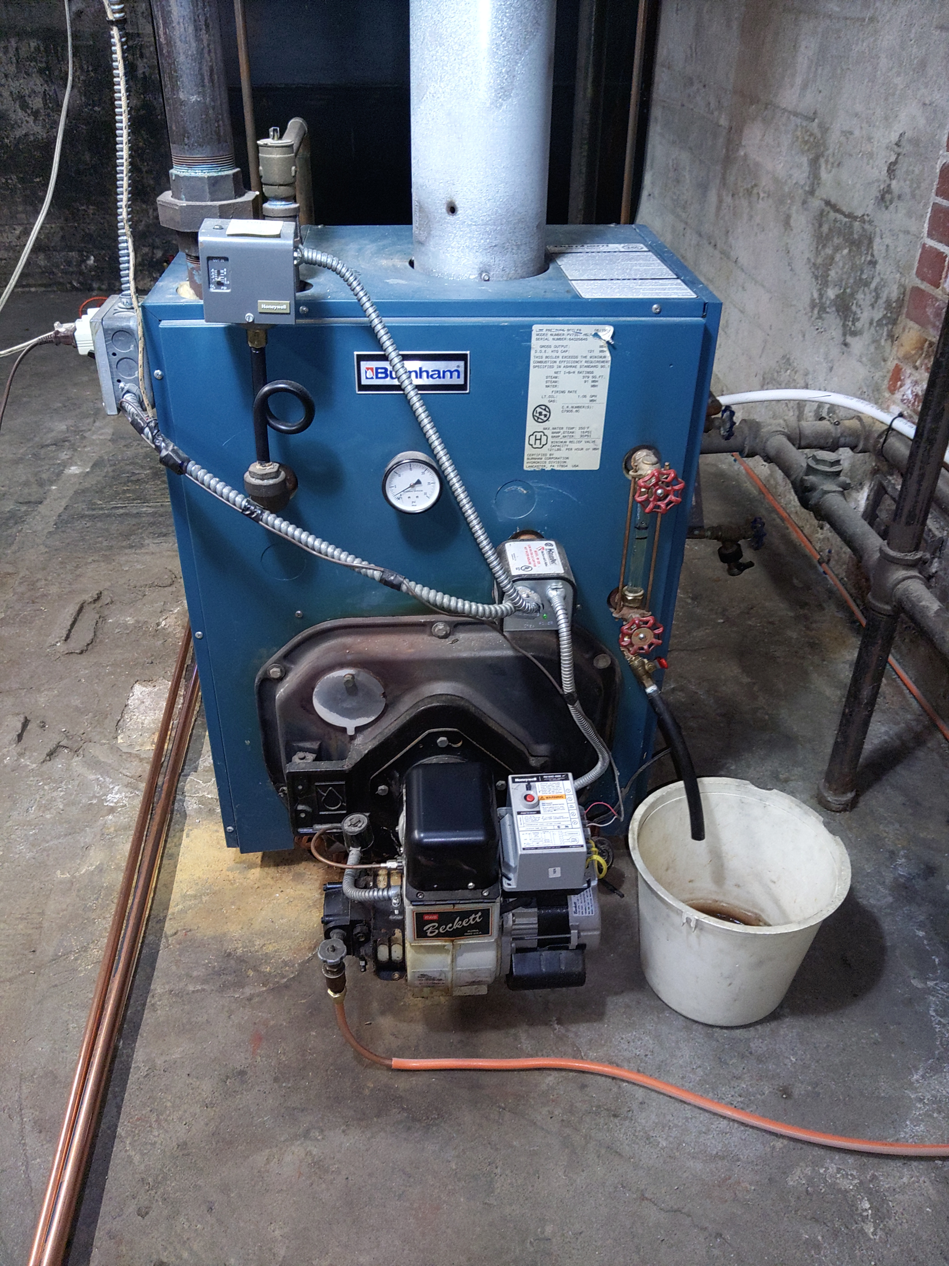

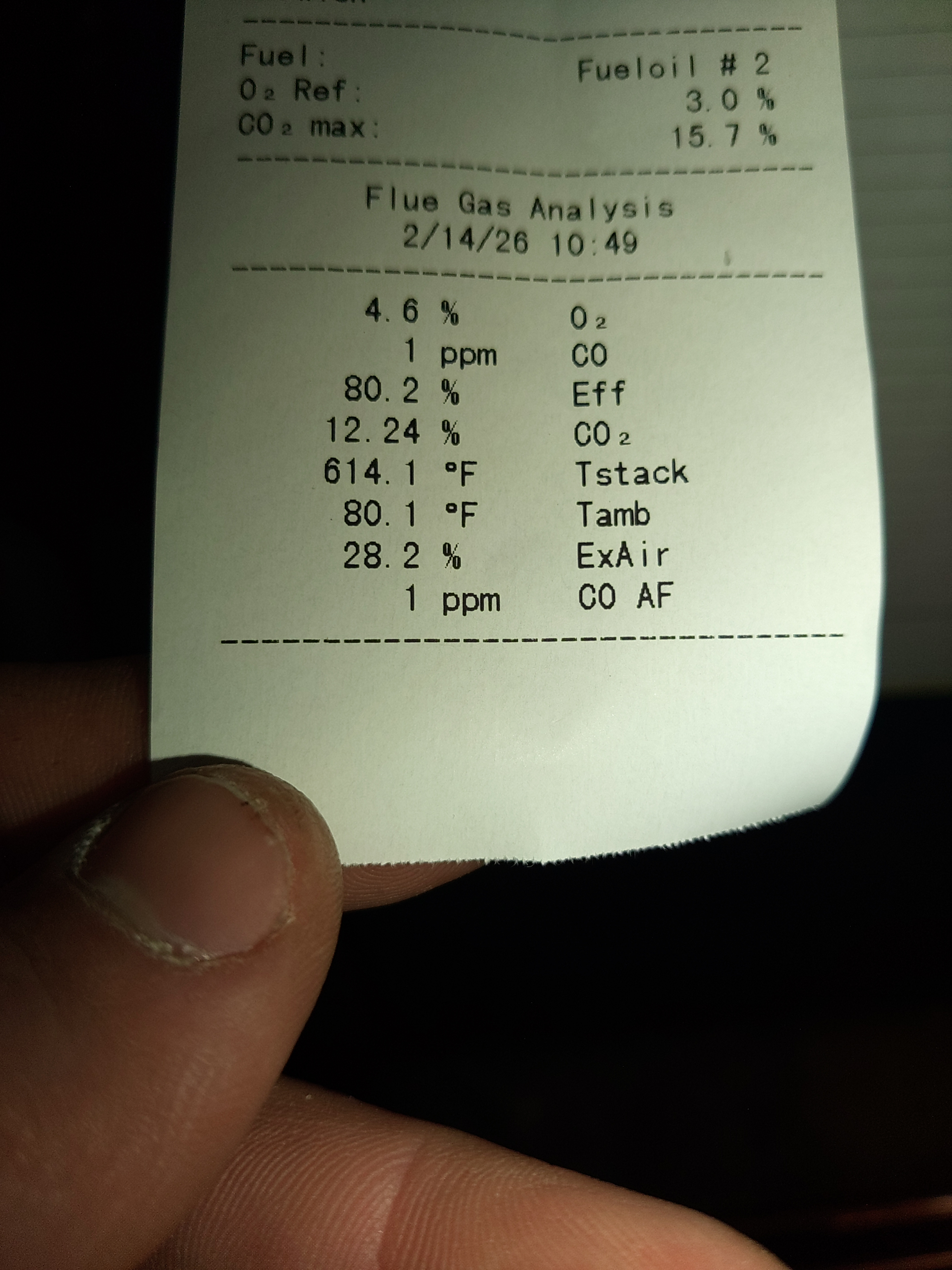

  • Only time I would replace the Burnham V7 steamer at my place would be if it leaks all over the floor or starts sending steam up the chimney. Otherwise runs great and efficiency is pretty damn good and combustion numbers last month were probably about as good as they can be. She was installed in October 1998. Haven't had any real troubles other than a new LWCO 10 years ago, a leaky drain valve which I capped and then just regular maintenance. Last month I had a plumber friend help me put a new combustion chamber in it and run the combustion analysis.
