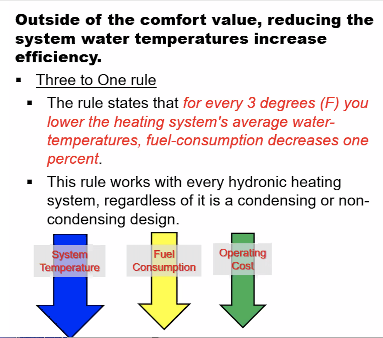

    hot_rod Member Posts: 28,076
    I suppose gravity hot water system could still be built, requiring no electricity.
    No need to drive the transfer medium, water, through another phase change to enjoy radiators and their radiant warmth.
    In a typical new well insulated residential home, under 2000 sq ft, (40,000 btu/hr design) Never having lived with steam heat, is it more comfortable, efficient, than a cast radiator at 180 degrees? Or lower?

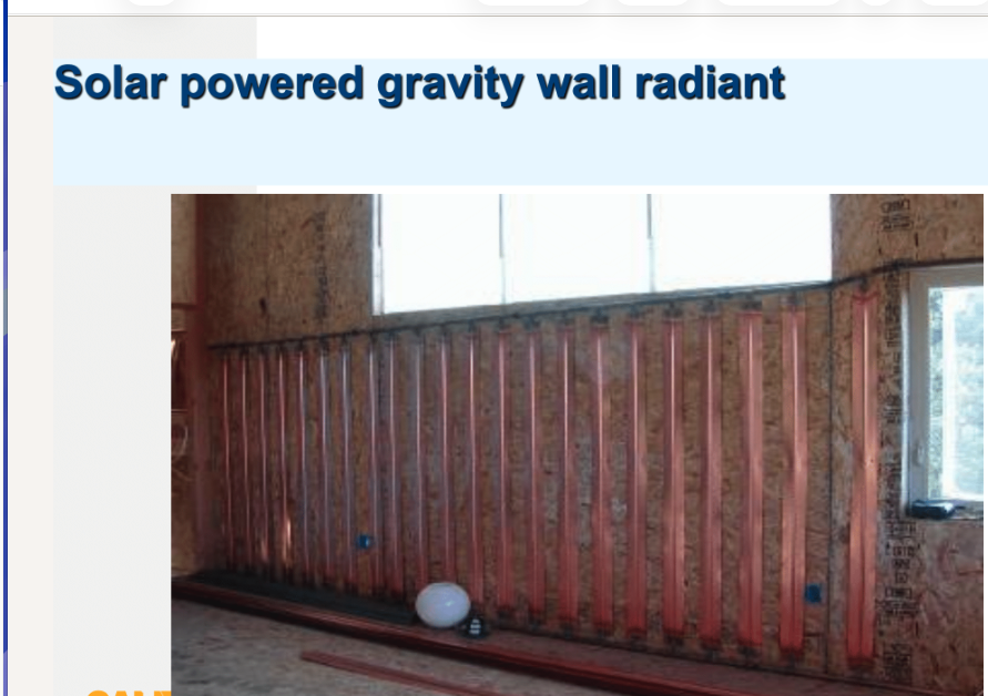

    Larry Weingarten
    Our resident guru of DHW btus has a gravity driven radiant wall heating system, runs on solar thermal temperature water.
    I imagine it is an incredibly cozy, comfortable home with invisible heat emitters :)
    If efficiency is part of the goal, heating the home with water under 120°F has some benefits

  • Larry Weingarten
    Larry Weingarten Member Posts: 4,185
    Hi, To follow up on @hot_rod 's post, the house maintains 70 with 80 degree water. I burn about 1/4 cord of wood for supplimental heat per year.
    Yours, Larry
