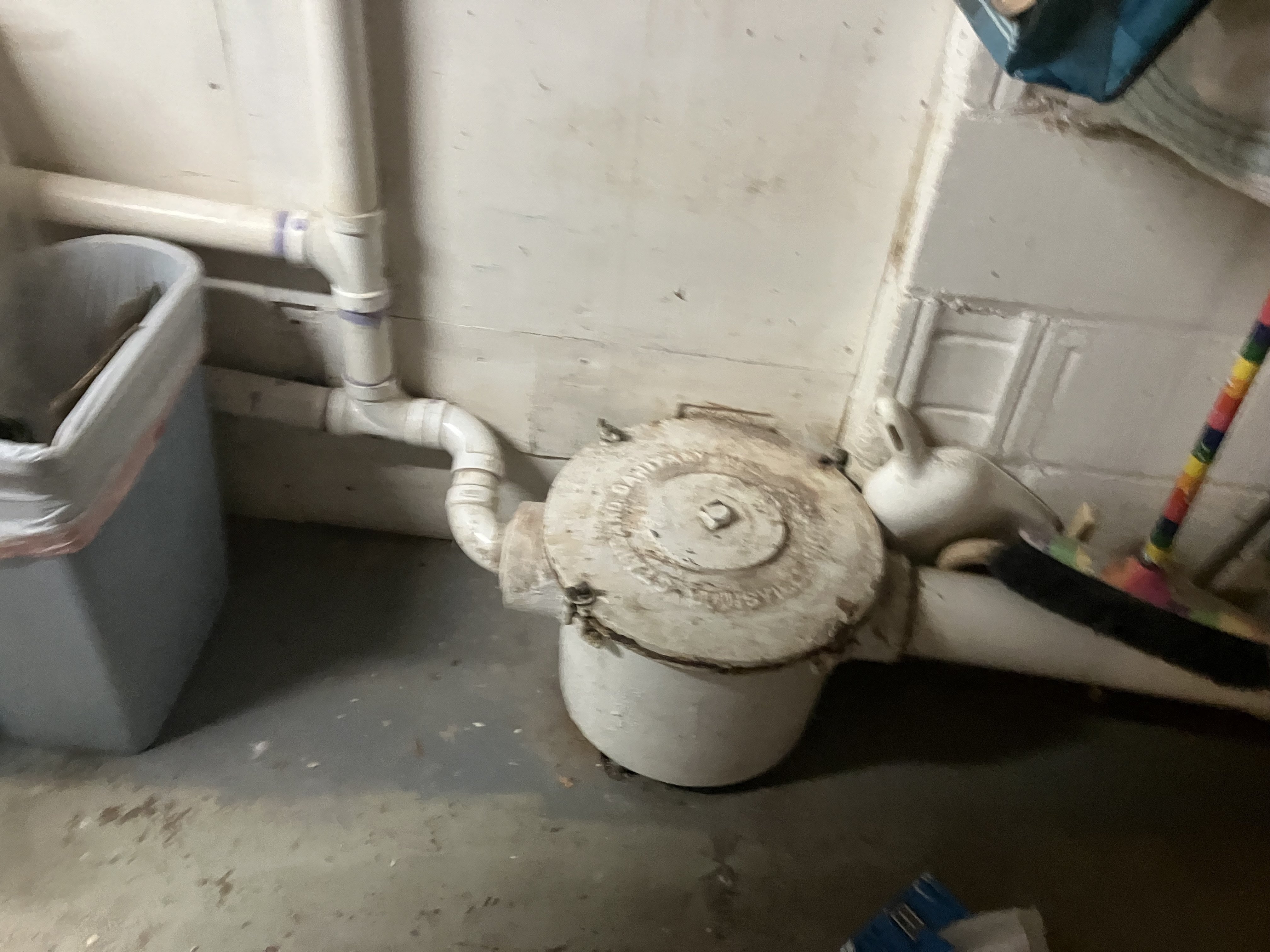

Hello All,

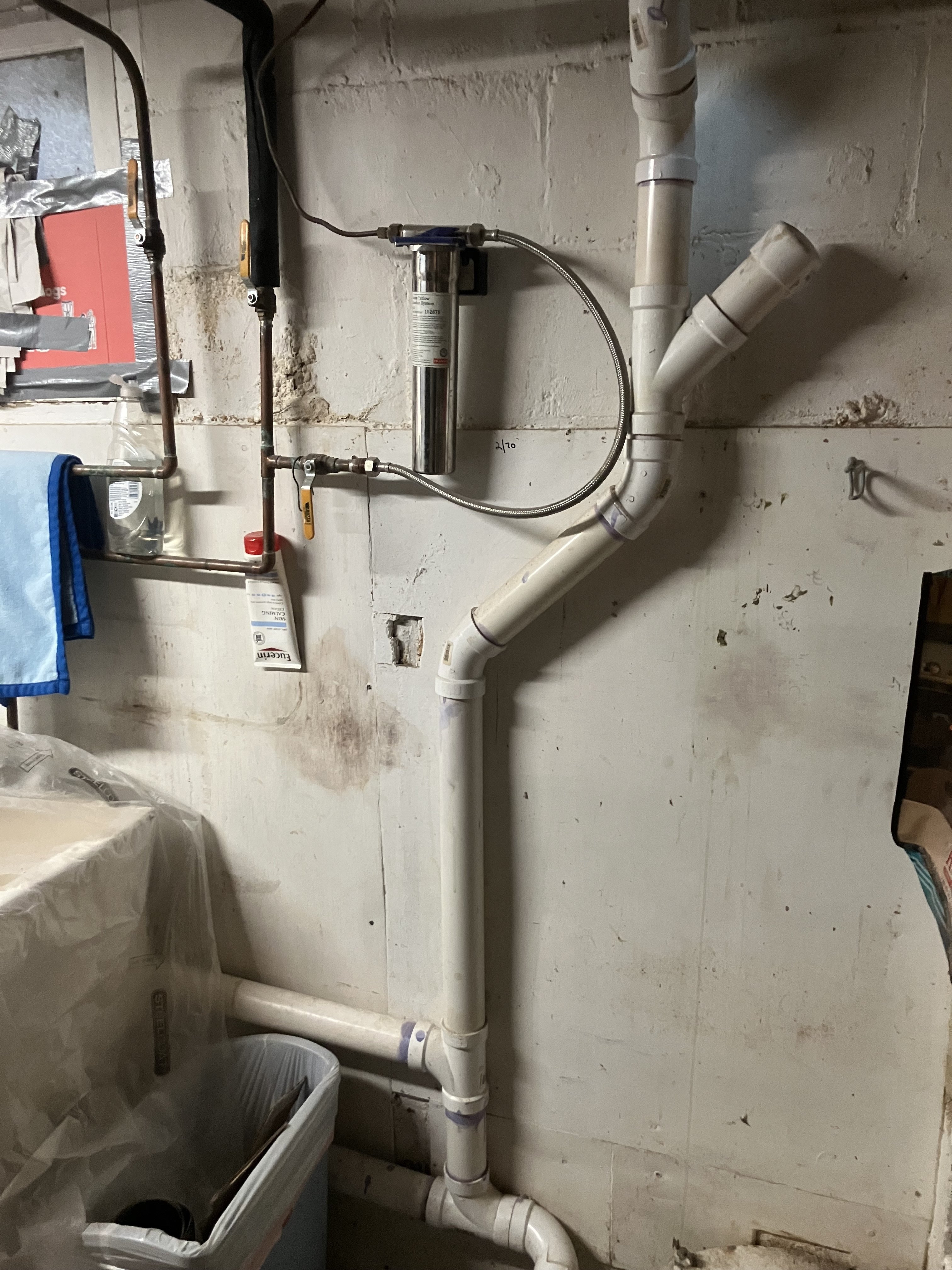

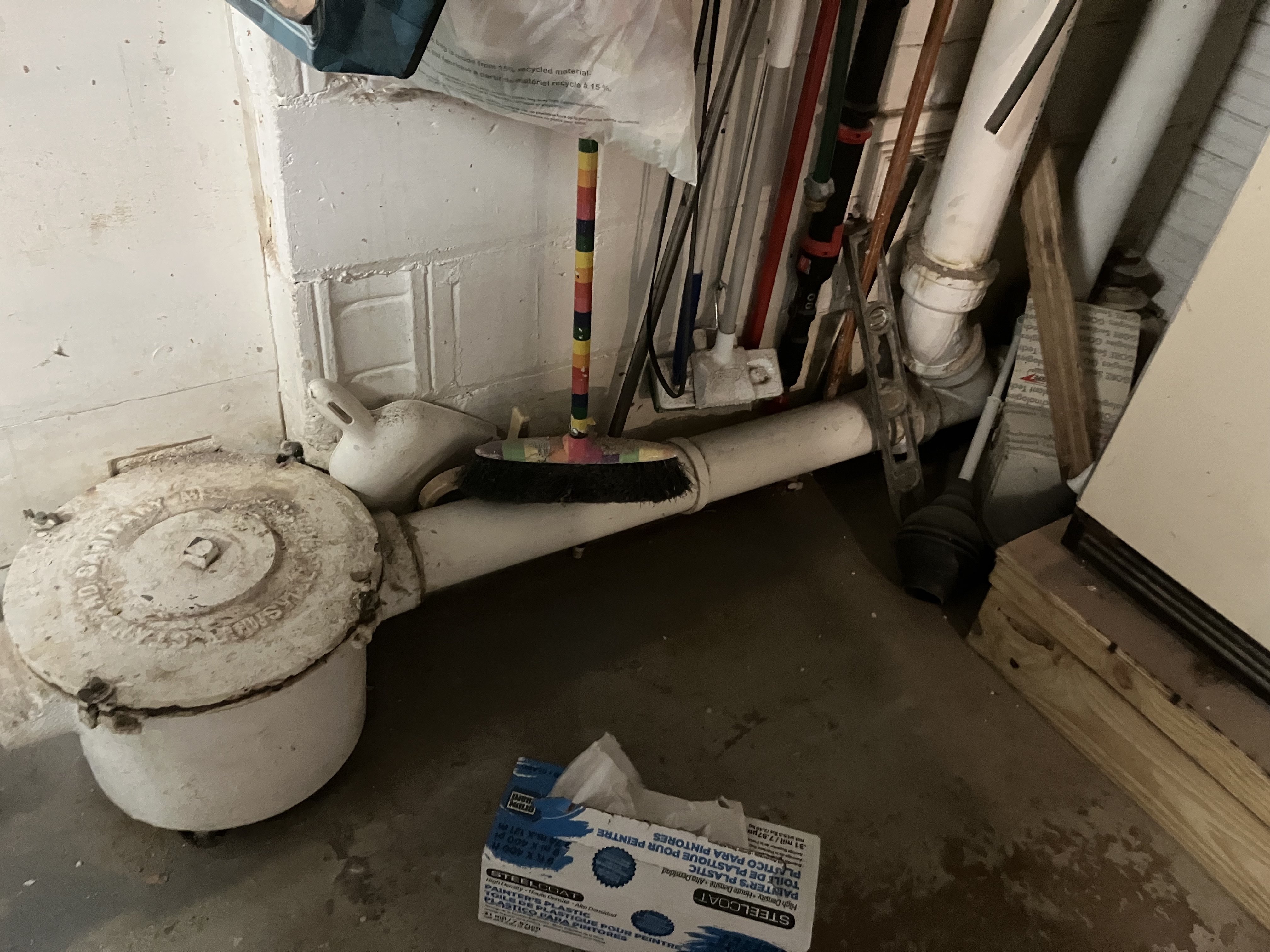

I am on a job on the north shore of Long Island. It is installed after the housetrap before the main 4" waste stack for two second floor bathrooms but before a slop sink and washing drainpipe in the basement.
Any help would be appreciated.
Thank you

  • Grease trap.
    And clean it out. Which won't be any fun at all….

    Hi, Good chance you'll want some ventilation going when you open it up. Who knows, maybe that long-lost gold ring is in there 🤩

    That looks like a separator (probably not for grease), also not after a house trap. If that's the kitchen and laundry going into it, its like a gray water tank, but tied into the sewer...weird. pour some bleach into the laundry tray before opening it, and take pics when its opened.
    hot_rod Posts: 28,704
    Looks like a plaster trap (solids interceptor) possibly. They were used at some sinks in medical facilities.
    Or a pottery person lived there and used the sink for clean up?
    Or a grease trap.

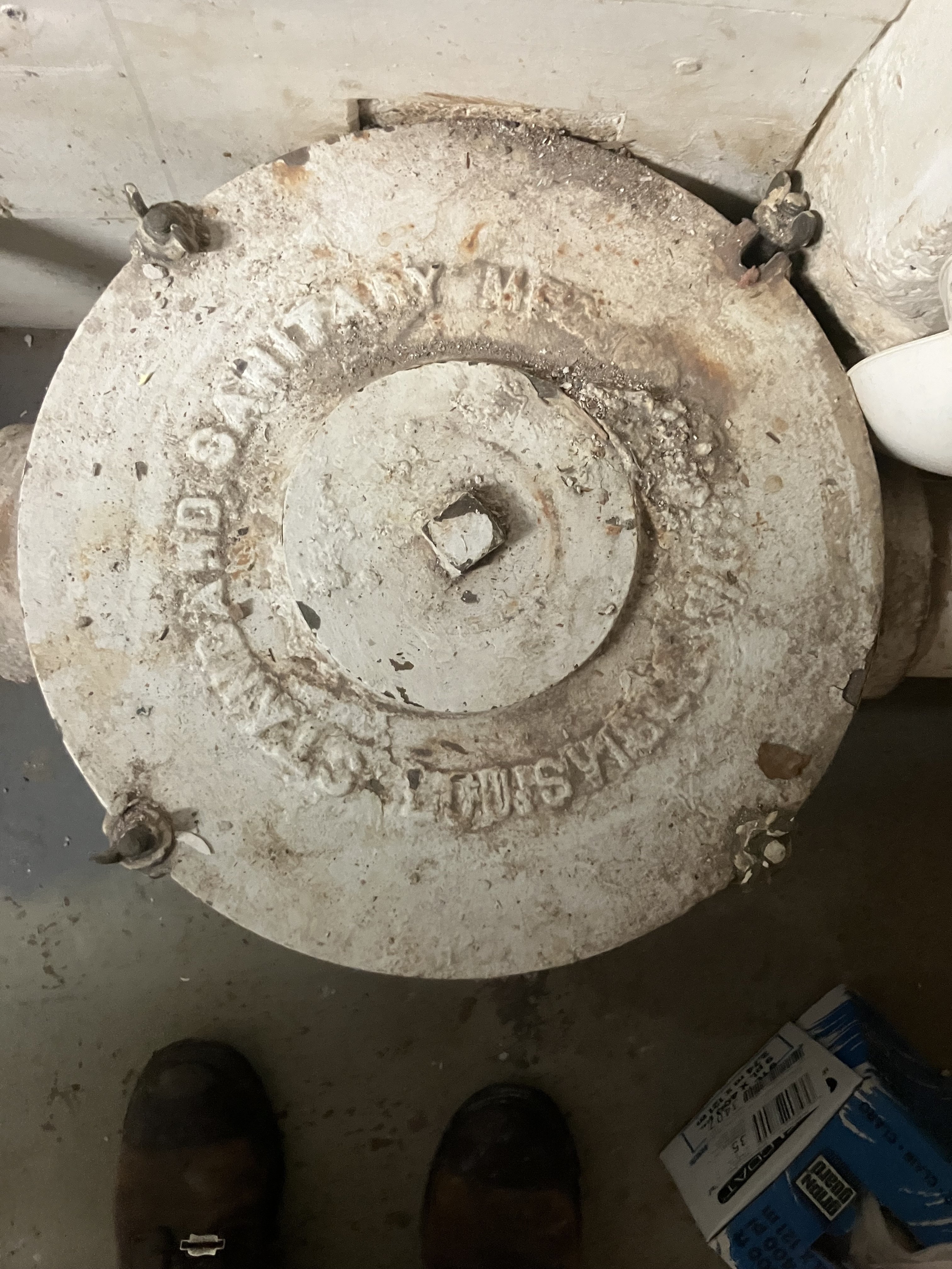

    I agree- grease trap. And yes, that's the same Standard Sanitary Manufacturing Co. that later became half of American-Standard.

    weren't they still branding stuff standard sanitary fixture and arco for decades after they merged?
    Steamhead Posts: 19,007
    In some cases. But it could help us date when the house was built. That merger happened in 1929 IIRC.
    Semi-retired
    i've seen fixtures branded "standard" in buildings built in the 50's or 60's
    That was one of the last of their product line to make the change- in 1963 IIRC. But their heating equipment had both names decades earlier.

    you will know when you open the top if it is a grease or plaster trap
    Grease traps have baffles to slow flow and allow grease to rise or float up
    A plaster or solid interceptor forces solids to the bottom
    Seems odd to have either trap in a home? Was there a butcher shop in the basement? Or an artist studio?

    Thank you all for all the replies.
    I was told the house is around 100 years old. I did not intend or need to be open it up (Pandor's box to me). I was just wondering what it could be and the purpose of it. I find it odd that it is 4", I would think a grease or plaster trap would be smaller. I have installed either, just a thought.
