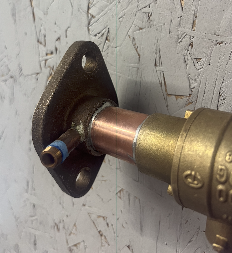

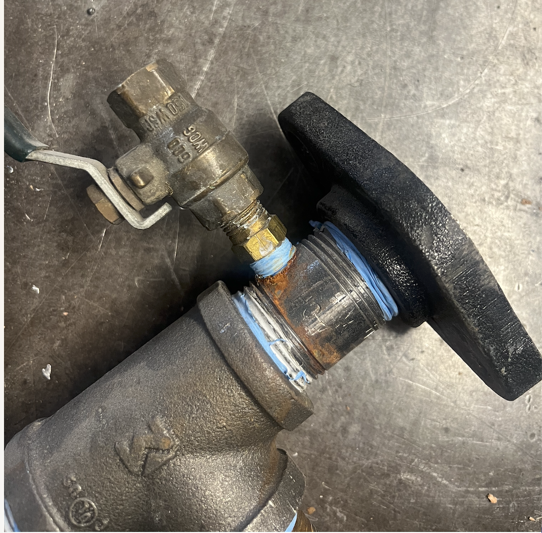

    I've drilled and tapped into a number of schedule 40 nipples with 1/8 and 1/4" NPT. Works fine on low pressure hydronic systems.
    For building pressure tap ports around circulators.
    Screenshot 2026-03-22 at 8.13.46 AM.png Screenshot 2026-03-22 at 8.13.34 AM.png
    Use a dab of Expando for a tight seal.
