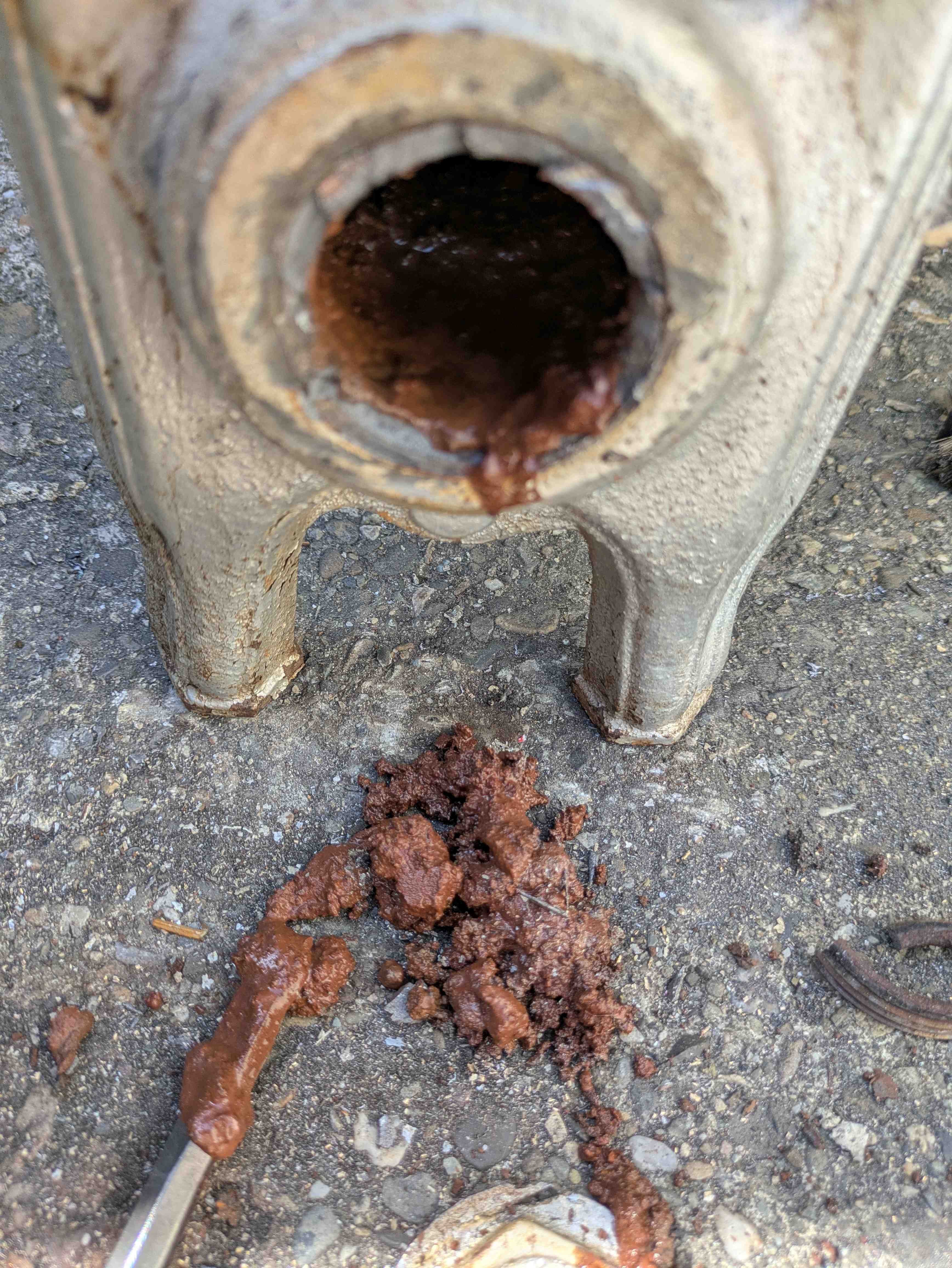

I'm converting an old 1-pipe steam system to hydronic. New boiler (obviously), all new copper piping, but I'm trying to save my cast iron radiators. I've managed to remove all (but one) plugs and replace with bushings, tapped and installed new vents, but the old radiators are gunky! (See photo.)
I'd like to power flush 6 radiators before plumbing them to my new heating system. Note that the radiators are not connected yet to the system. My plan is to temporarily connect them together in a loop for power flushing in my garage before installing them in the house.

    What does the top of the radiator look like? Are all the sections connected at both the top and bottom (not just the bottom)? That makes a difference, because if they are not connected at the top, you can't use them as water radiators.
    As far as flushing or power washing is concerned, you may need the help of a pressure washer with a homemade 90° spray. Perhaps just a piece of 1/2" copper with a cap brazed to it and a 1/8" hole drilled into it on one side. That will force water out at a good velocity to dislodge much of that gunk.

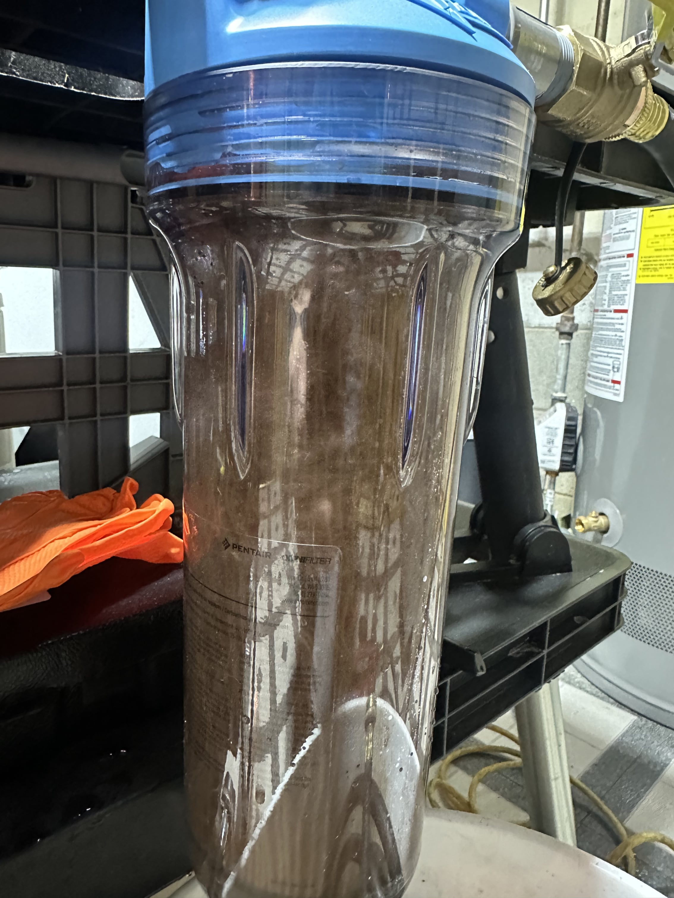

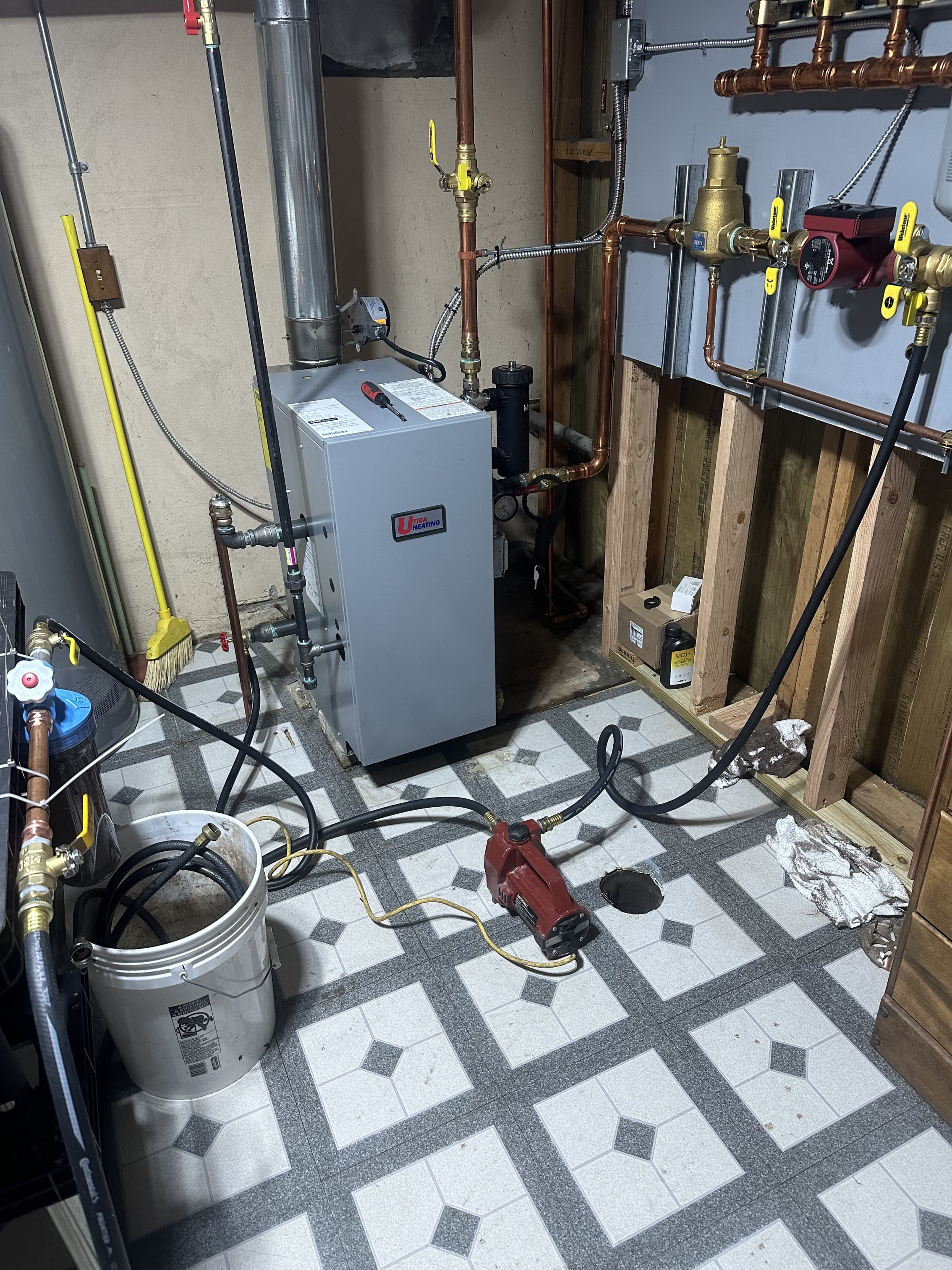

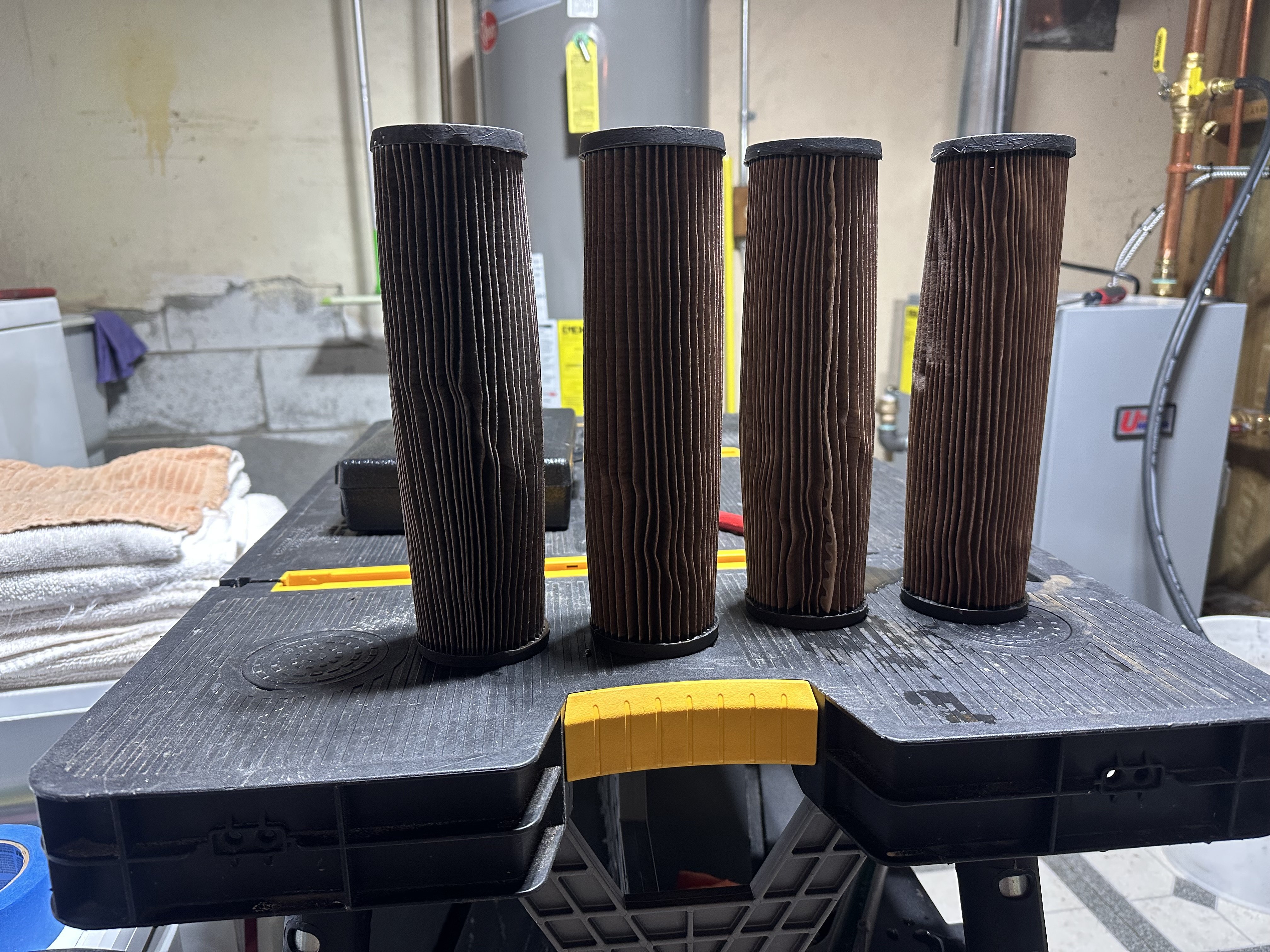

    I have a distributor who will rent out a power flush cart in my area to contractors. If you can't find a contractor that is willing to do this you can DIY it. You will need a good pump with enough velocity. I use a Liberty 331 transfer pump or you can get an inexpensive shallow well pump. I use a Adey magnetic cleaner with their chemical to clean and get the magnetite out. Bring your return loop through the mag filter and discharge into a bucket or trash can. Put a bulkhead fitting on your trash can going to the suction/intake of your pump. The pump discharge gets connected to your radiator loop.
    It might be easier to do all of this when the radiators are connected to the new boiler system so that you clean the entire system. With preplanning you can install valves in the system to allow you to do this and bypass the boiler heat exchanger. Here is a set up I recently used on a cast iron boiler that had to be replaced, where the system had to be cleaned up because of water quality issues.

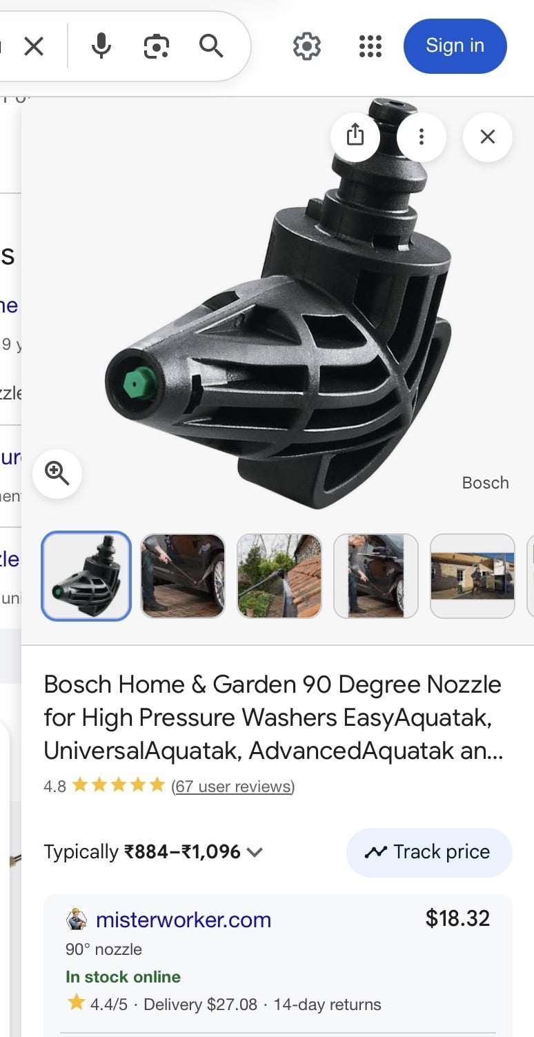

    Or an inexpensive electric pressure washer with a 90 degree nozzle
    If this fits in the opening?
