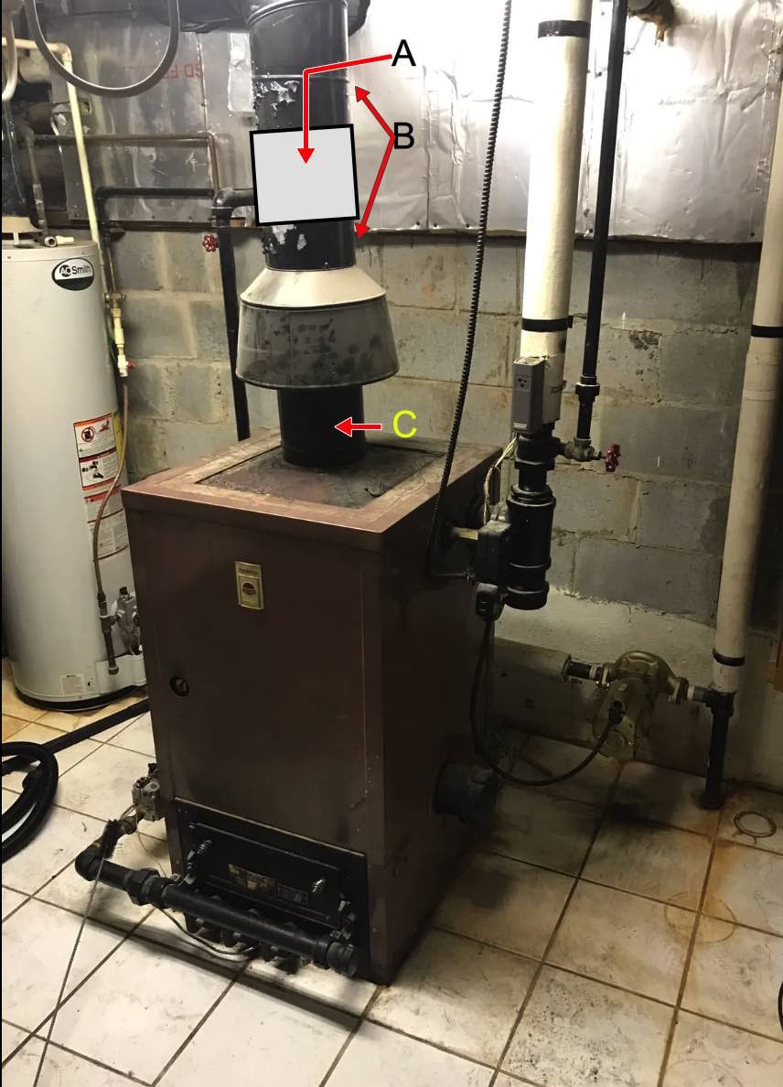

    Regarding combustion readings on a boiler with a draft hood like yours: you’ll likely need to sample flue gases before the draft hood. Any readings taken after the draft hood are contaminated with what we call dilution air—essentially room air pulled into the flue. Those samples don’t reflect true combustion and can be misleading, so I wouldn’t rely on them.
    This is a photo of a typical Am Std boiler from the 1960s.
    Location A is a possible Ameritherm damper location.
    Location B is the incorrect place to sample the flue gas for a combustion analysis.
    Location C is the proper place to take a flue gas sample for a combustion analysis test.

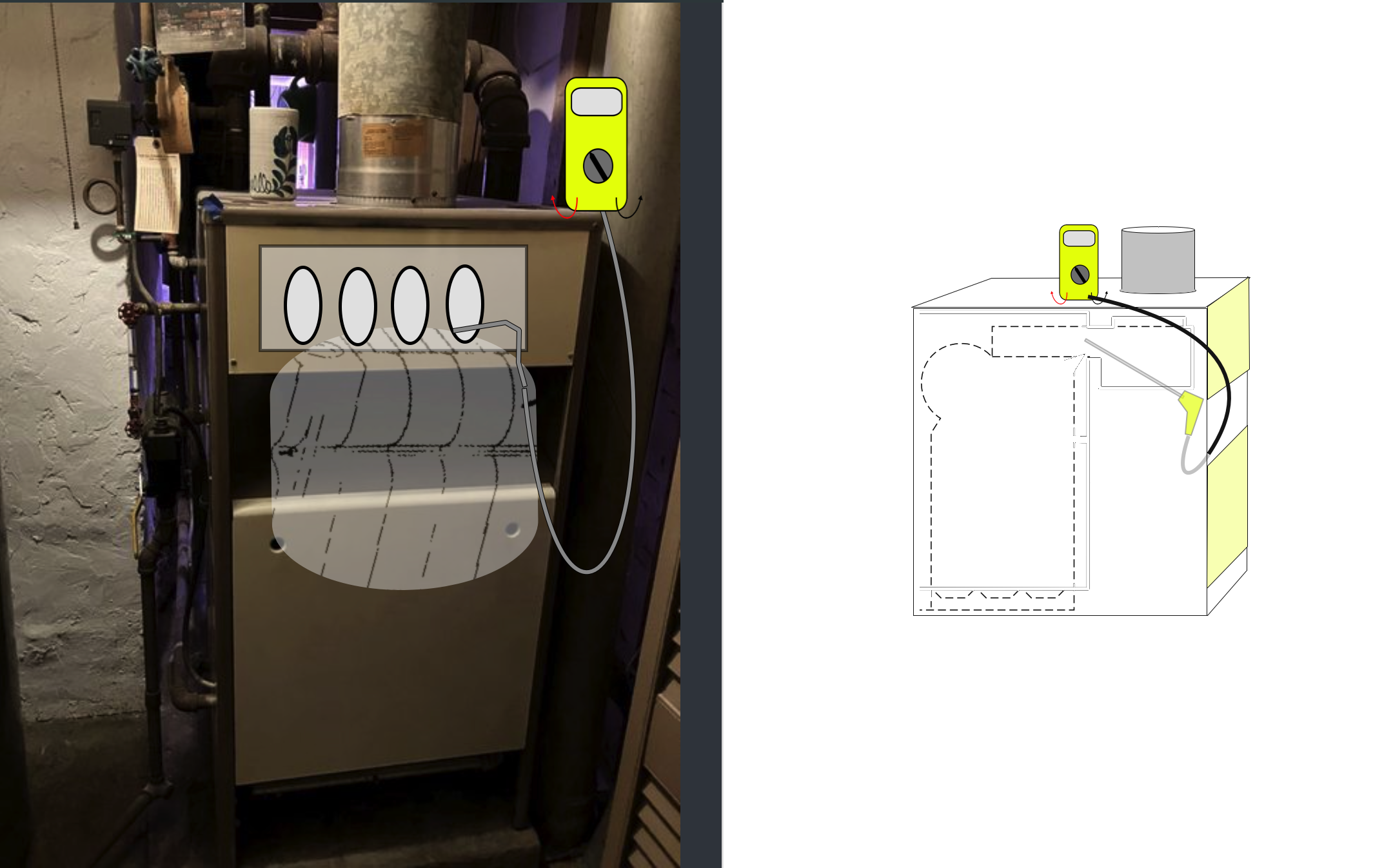

    My damper sits atop the boiler housing. Is it even possible to get a reading without make up air? I recall the temp was > 400 maybe 430 degrees.
    https://imgur.com/a/KRQERTp
    Steamhead Posts: 19,022
    That big rectangular opening in the front is your draft hood. One would need to insert the analyzer probe into the flue collector behind the draft hood, in effect sampling the flue gases as they come up out of the boiler.

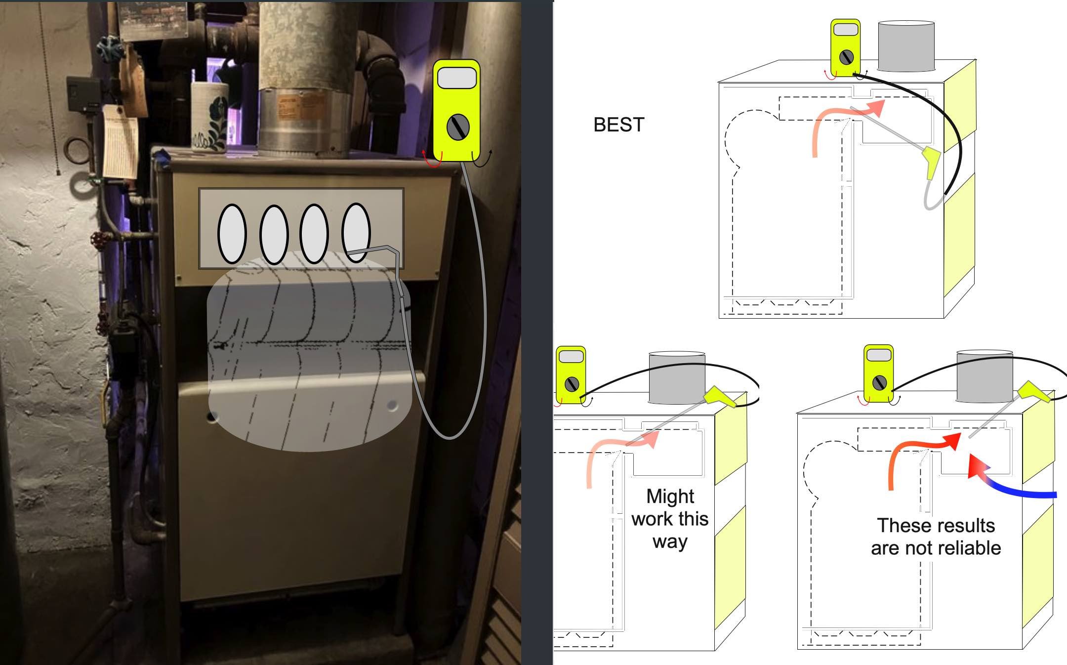

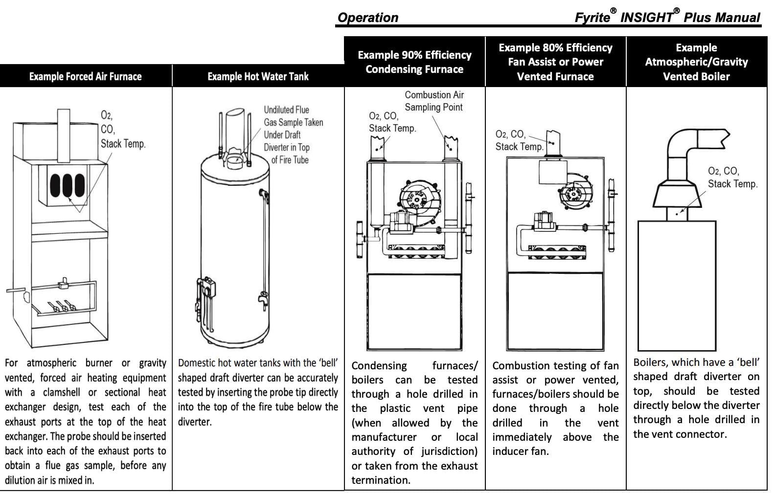

    So the combustion analyzer probe should be placed inside the draft hood and collect a sample before the flue gas exits the actual cast iron sections
    these illustrations of how to take a flue gas sample from the Bacharach combustion analyzer illustrate how to take a sample that does not have dilution air that will invalidate the results. Since your boilers uses a flue collector in combination with the draft hood your sample location is more like the firced air furnace on the left than any other appliance shown.
    Depending on the assembly of your flue gas collector, you may need to take measurements at multiple points across the cast-iron heat exchanger, as some burners may be operating differently from others.
    That is why I don't believe you can trust the combustion readings you received.
