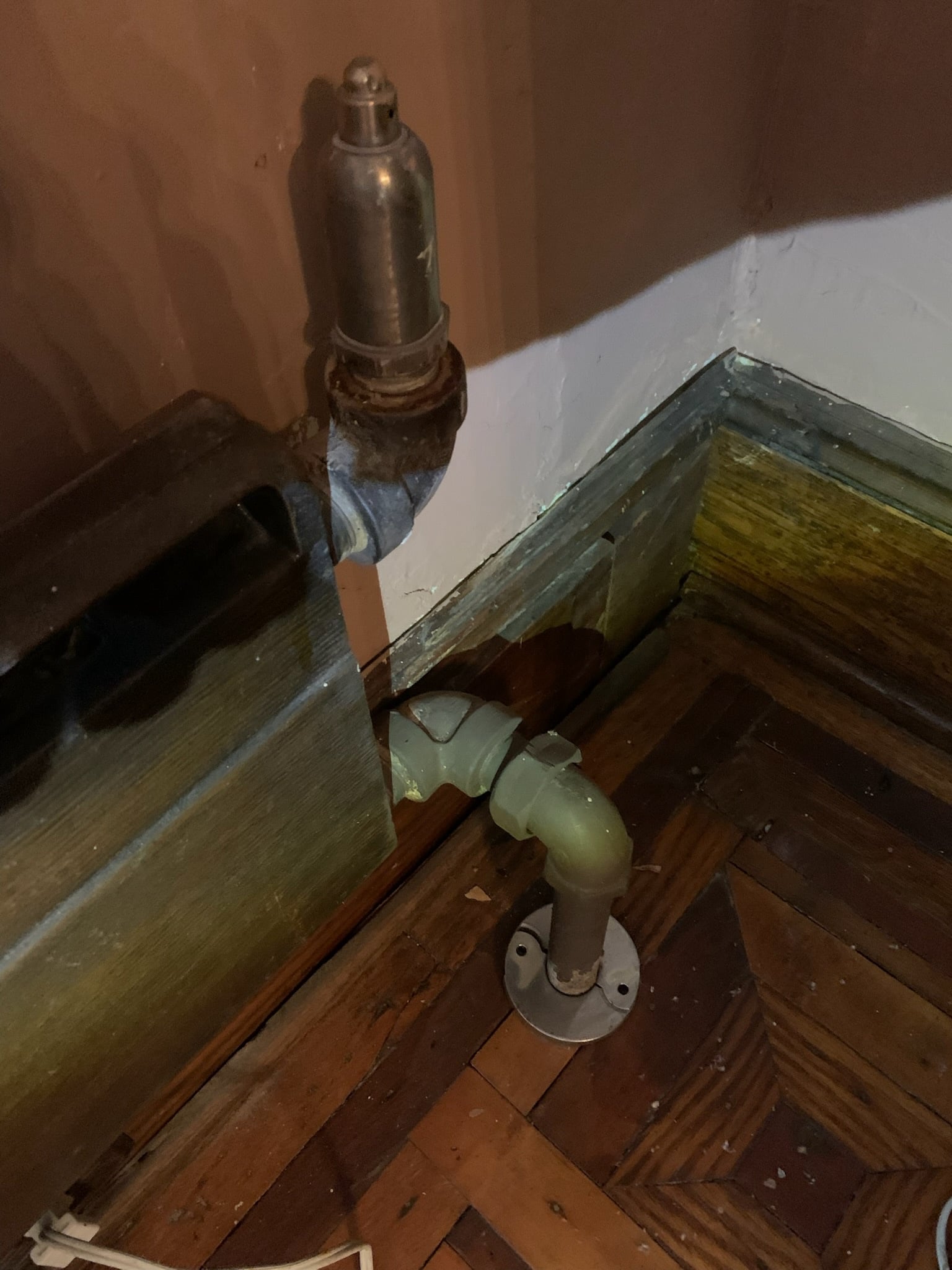

As per my previous inquiry, I replaced the non-functioning, undersized main valve on my mother's heating system with a Gorton # 2. Whether the ideal fit or not, it sped up the heating time by about a third and reduced gas consumption per week by about 25%.
The only major issue now is two runs of baseboard heat on the first floor furtherest from the boiler in rooms that were "modernized." They still take around 25 minutes to heat up end to end. One is 8 foot in length, the other is 10. They are off a main run of 1 1/2 inch pipe approximately 18 feet.
Using the formula in the G & P guide to balancing, I calculated that they would require a Gorton C or D. However, upon closer inspection (which admittedly, I should have done first), I now realize that these units are vented in a different manner. From reading up in this forum, it seems like this is the preferable way to vent long runs of baseboard - as a two pipe system, allowing the condensate to flow more freely.
So, how does the current configuration affect vent size, if at all? .
Also, the current vents are 3/4 inch and what I believe to be main line type. I haven't had the chance to remove one to inspect it more closely. Is this scenario possible - could they be main vents? Do they make 3/4 radiator vents (not that I have found)? If not, what would be appropriate?
Thanks!

    You're right. That looks like an old Flair vent, but it's 3/4". 3/4" convector vents do exist however, and they vent more slowly than main vents.
    Since Hoffman has moved production of air vents to China, with accompanying drastic reductions in venting rates (hey @gerry gill, any way you could test them?) I no longer use or recommend them. But you might try a Vent-Rite #35 or #75 on those baseboards to see how that works.
    But that would still leave the problem of differing thermal behavior between those baseboards and the cast-iron radiators in the rest of the house. This can cause uneven heating.

    OK, is that Gorton #2 on the main feeding the baseboards? If so, how long does it take for the steam to fill the main?
    Also, either of those Vent-Rites should vent considerably faster than the present vent or the one from Lowe's.

    Yes, it is.
    Everything on the first floor begins to get warm on the valve end within 4-5 minutes including the baseboards. The heat then just creeps along them at a snails pace, unlike the other tubular radiators .
    I have Gorton # 5's on everything on the floor except for a #4 on a smaller radiator almost directly above the boiler and one on the room with the thermostat. I'll probably change that one to a #5 — it is diagonally across the building from the boiler and I think that the distance alone will slow it down sufficiently.

    are those baseboards connected at both ends to the steam main? or are they connected only at the end with the vent?
  • MikeC_3
    MikeC_3 Posts: 77
    Yes, connected at both ends to the main. That is the pipe below the vent in the picture.
    Does that have any bearing on proper vent size?

    Take out the 3/4 vent and use a 3/4M to 1/8F adapter so you can use a straight radiator vent there. The 3/4 to 1/8 might be tough to find, you can use a 3/4 X 1/2 and a 1/4 X 1/8 to get what you need. Then just hope you can find a vent that actually works.

    yes having connections at both ends, while helping to drain condensate, can lead to early closure of the vent because steam comes up from the steam main and quickly gets to the vent just above that pipe connection.
    Fixing the situation may be tough. Do the baseboards adequately heat the spaces they are in?
