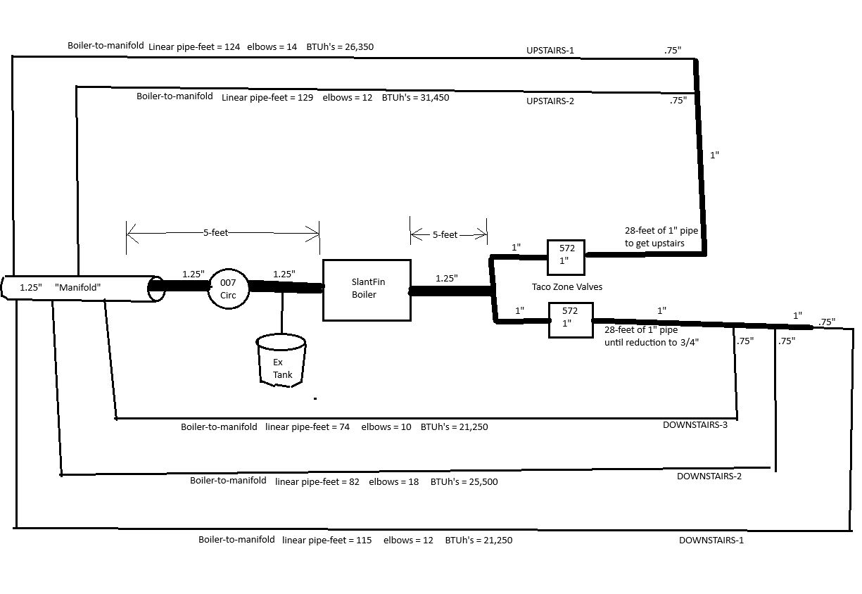

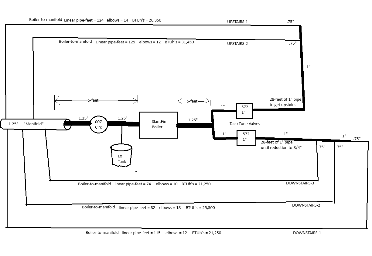

I wanted to do a deep-dive and really calculate my GPM and head-pressure; something I don't think was done in 1999 when my current 126,000 BTUh SlantFin boiler was installed. —Taco 007 was installed with it. Before then it was the in-line Taco 110. I'm in a 2-story home, with some long pipe runs, and one of my zones has eighteen 90degree elbows.
One zone comes up to 6.8GPM at 22feet of Head, and the other comes up to 5.7 GPM at 18feet of head. so…… If both zones call at once, I need a pump that moves about ~12GPM at 22feet of head. Remember that this house used to have an in-line Taco 110 connected.
Taco007 won't handle this. I can provide a summary of my data & calculations if anyone wants to help determine if I'm way out in left field on this. Thanks!

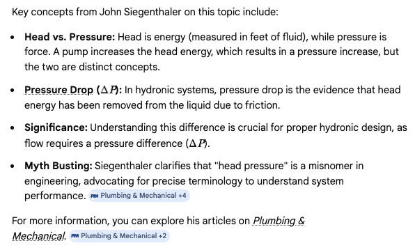

    It is a bit complicated but there is really no such thing as head pressure. Head is the energy contained in the hydronic system, measured in feet of fluid. Pressure is a measurement of force, typically psi is used in hydronic systems.
    A deep dive here.
    https://www.pmmag.com/articles/101174-siegenthaler-theres-no-such-thing-as-head-pressure
    Or a snapshot here

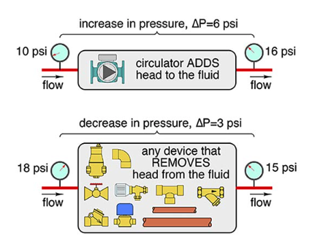

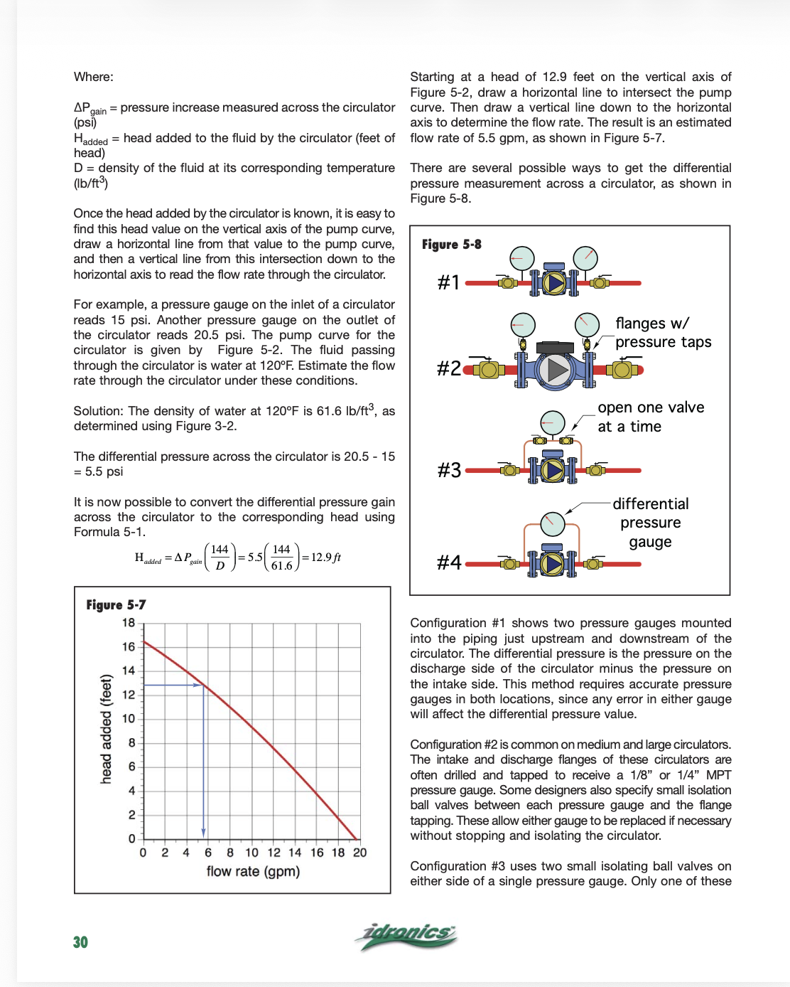

    Circulators add "head" energy to a closed hydronic system. All the piping, components in the circuit use up or consume that head added. Pressure is used to determine the amount of head added to a circuit.
    The simplest way to know or measure energy being added by the circulator is check pressure on inlet and discharge side when it is running. Fig. 5-8 has some examples of how to use a gauge to do that. I prefer a single gauge so you do not have error between the two gauges. A small circ is not adding that much pressure, so you want an accurate number from the same gauge.
    Idronics 16 takes you through the steps to determine with this pressure measurement, how many GPM the system is moving using the pump curve from the brand and model of pump you have, Fig. 5-7.

    Are you sure about those 'head' numbers? They seem really high. You should show the math.
    Are these zones separated by zone valves and one circulator?
    If you're math is somehow correct, you would only need a 7gpm circulator @ 22' of head. But let's go over the math.

    OP here.. OK; here's all the math! —-first off, the assumptions in my model (please indicate where I might be wrong).. —> every 100feet of linear pipe introduces 5feet of head. —>Each elbow introduces 2feet of equiv linear pipe. —> The Taco model 572 Zone Valve Body (1") introduces 60 feet of equiv linear pipe. —>I didn't bother with Static Head to get up to the 2nd floor, because this is a closed-loop, and what-goes-up, must-come-down, so it's a wash as far as head goes. —>my Fin-Tubing emits 850BTUh per foot, at 180F water temp, at 4GPM.
    Downstairs: all-told: all pipe-feet, and elbows, and the one Zone Vave Body: 441 equiv linear pipe-feet, 68,000 BTUh and 40 elbows. 441 divided by 100 = 4.41. 4.41 times 5 = 22 feet of head (this assumes that my ENTIRE system is 3/4 pipe, which it's not. I know I'm wrong in that respect; my head is a bit high because of this. 68,000BTUh divided by (20 X 500) equals 6.8GPM for the Downstairs.
    Upstairs: all-told: all pipe-feet, elbows, and the Zone Valve Body: 365 equiv linear pipe-feet, 57,800 BTUh and 26 elbows. 365 divided by 100 = 3.65. 3.65 X 5 = 18 feet of head. (this assumes that my ENTIRE system is 3/4 pipe, which it's not. I know I'm wrong in that respect; my head is a bit high because of this. 57,800BTUh divided by (20 X 500) equals 5.78 GPM.

    I'd be helpful to know the length, size, type of pipe, and size, type and number of fittings. Then I can calculate it easier.
    100' of 3/4" copper pipe is 7.88, 1" is 2.26

    you don't need to use the btu/hr output your baseboard is capable of as your load, you should really use the load the space requires on design day. Also just in case you don't know regarding the 20 degree delta T, we really only use that to make the math easier, systems run on variable deltas constantly and the system seeks to achieve equilibrium. in your equation if your boiler setpoint were 180 at a 20 degree delta T the average water temperature is 170 so you can safely adjust your load numbers to the output at 170 if you don't know the spaces actual load.

    What actual problem are you trying to solve? You said you have a Taco 007 but it "wont handle this." Is the house not heating evenly? Did the Taco 007 work OK before, but then someone added more radiation/piping?
    hot_rod Posts: 28,705

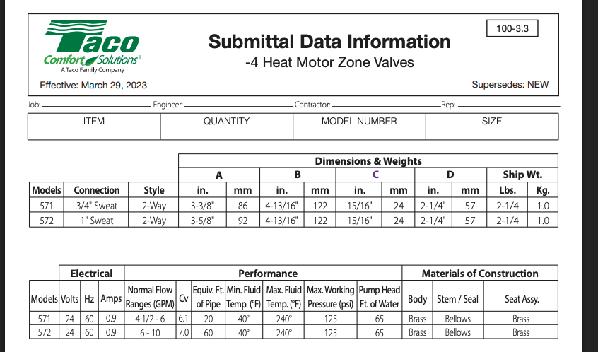

    Are you saying you have 441' of 3/4 tube & fittings EL in one loop? a typical 3/4 fin tube loop is 65- 70'
    Something seems odd about the Taco 571/ 572.
    The 3/4" 571 shows 6 Cv, 20' of pipe equiv.
    But the larger 1" 572 with a 7 Cv show 60' of pipe equiv.
    That seems like a big difference?

    —> What am I trying to solve? it seemed that certain areas of the house were warmer when we had the 110 in-line circ. The furnace and circ were replaced in 1999. I do not know the size of the old furnace unfortunately. The 1999 SlantFin is AGA Input=175,000 D.O.E. capacity = 145,000. I=BR capacity = 126,000. Otherwise I'm trying to answer the question, "do I really have the proper circulator"?
    —> 441 equiv. feet seems like alot..? (Please see my attached diagram and read the text on that posting; it should explain, or depict everything. The issue on that downstairs loop, is that the furnace is on one side of the house, and one of the loops goes to the other end of the house.. it just takes alot of pipe-feet to do that… All tubing is copper pipe, of the depicted size (see diagram)—> I can go thru my calc again, if someone can tell me how many feet of head a given length of 3/4inch copper gives, and a given length of 1" and a given length of 1 1/4 pipe gives. This will probably result in lower head numbers.

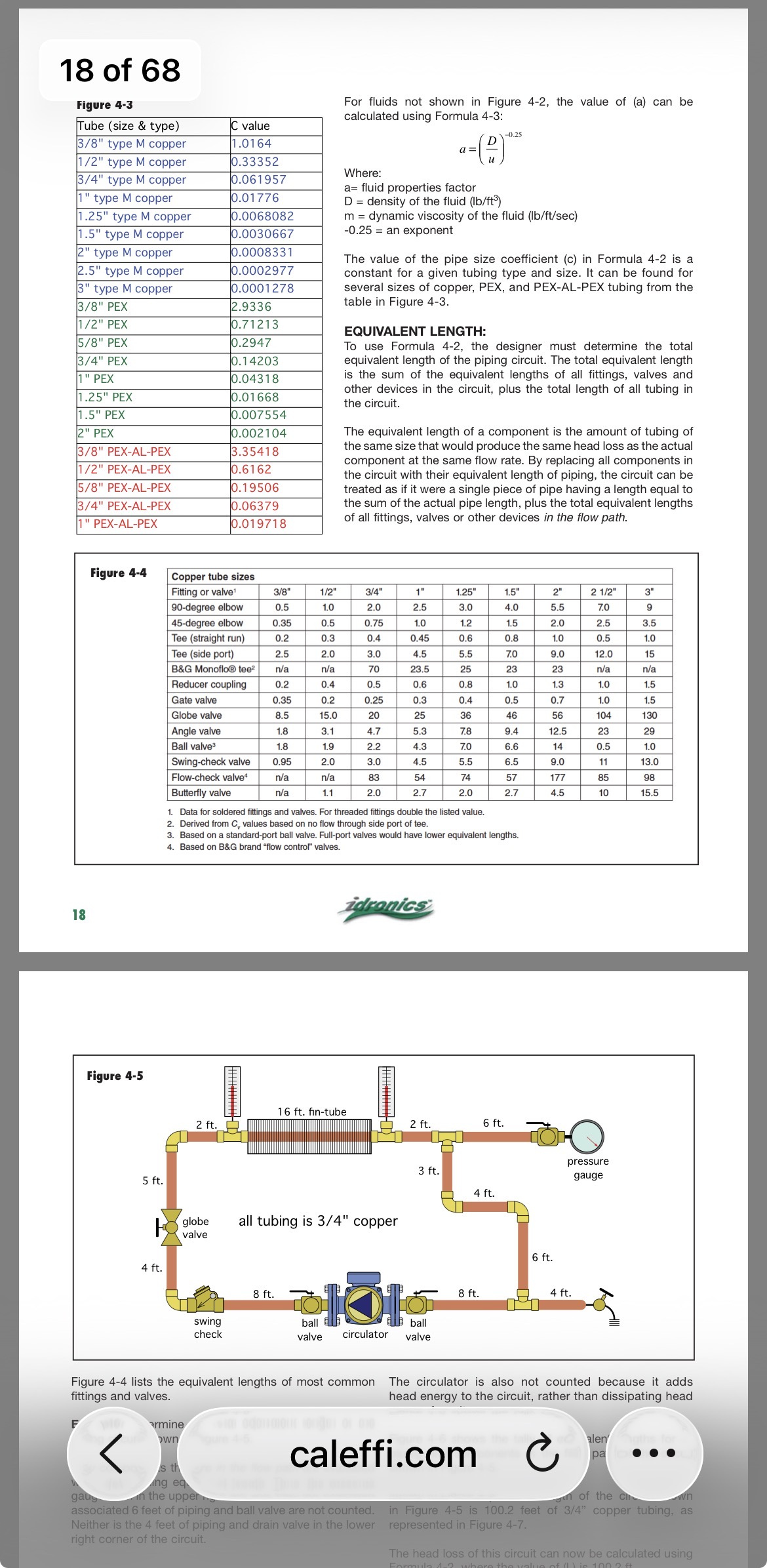

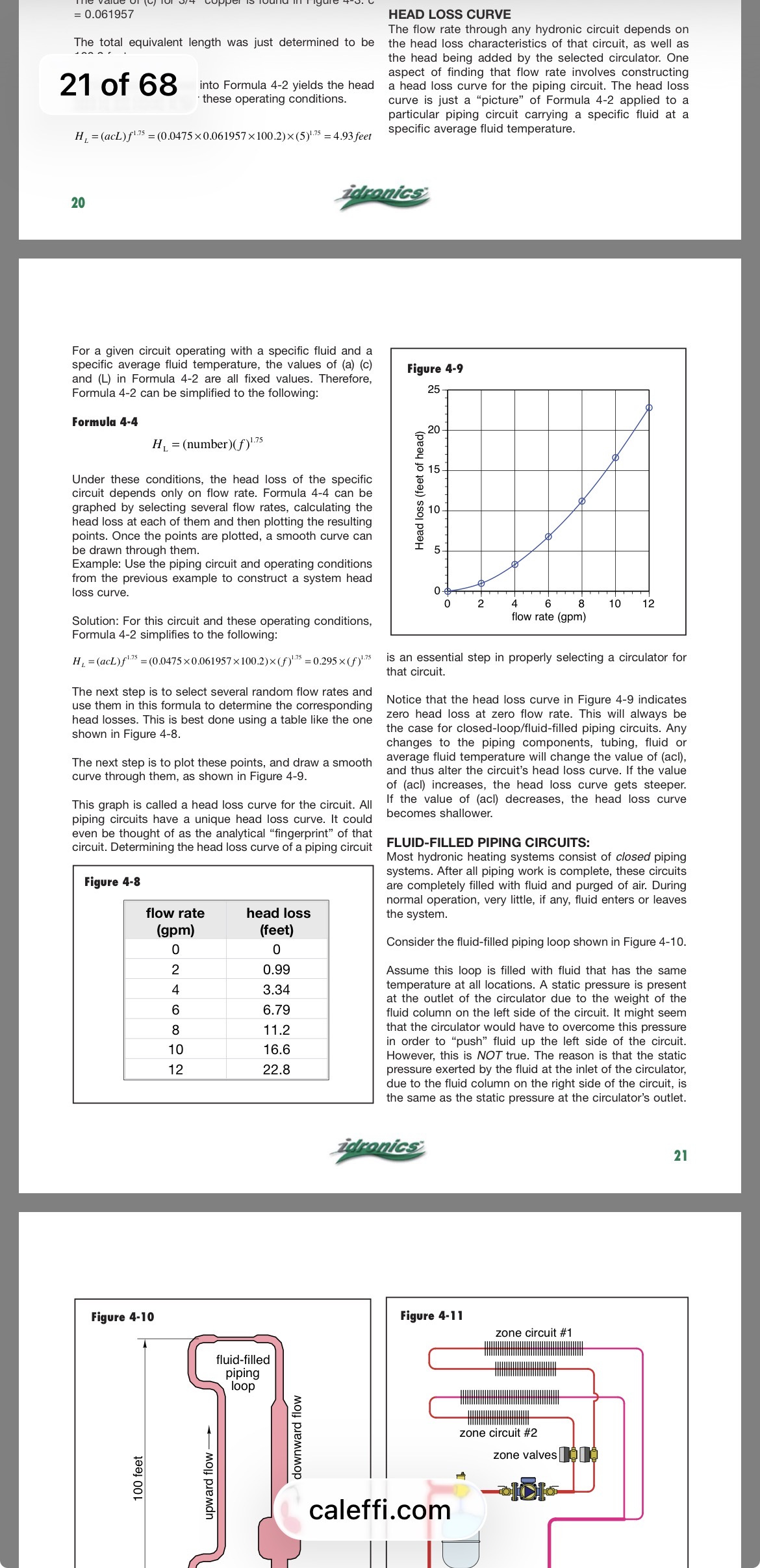

    the flow resistance in a pipe, a circuit changes with flow rate. Either 3/4 copper tube 4 gpm is about all you way to flow
    Idronics 16 takes you through a circuit analysis along with a typical system example
    Fig 4-8 gives you the pressure drop formula tor various flow rates
    2-4 is most common in hydronic design
    Too slow and air does not move with the flow. To fast and the piping gets velocity noise,
    https://www.caleffi.com/sites/default/files/media/external-file/Idronics_16_NA_Circulation%20in%20hydronic%20systems.pdf

    I'm ging to ask a pretty dumb question. I honestly can't make out from the discussion how this thing is piped. I get that there are two zones. OK. But. Are they series piped — that is, the outlet from each bit of radiation is the inlet to the next? Are the zones home run? Are they parallel return? Are they reverse return? Might they even be monoflow?
    I've held off commenting on this thread, because I simply can't answer the fundamental question you are asking — why are some areas warmer than others? — without knowing how the piping runs.
    I don't think your problems have anything to do with the head and flow characteristics of the pumps.
    Sketch or diagram, please.

    You don't add all your pressure drops together to come out to a total head loss. you only have to be able to overcome the largest one. If you can move the water thru the highest resistance loop then you can get flow thru the others as there resistance will be less. You add the GPM's so you have enough moving when all zones are calling.
  • pedmec
    pedmec Posts: 1,488
    What your really going to have a problem with is balancing the system. You have a split loop with multiple paths on each loop. You need to ensure proper flow thru each loop or some loops are gonna get more flow than others. You need circuit setters or similar devices on the loops for balancing. Obviously the accuracy of your drawing is going to play a major factor in getting the correct replies
