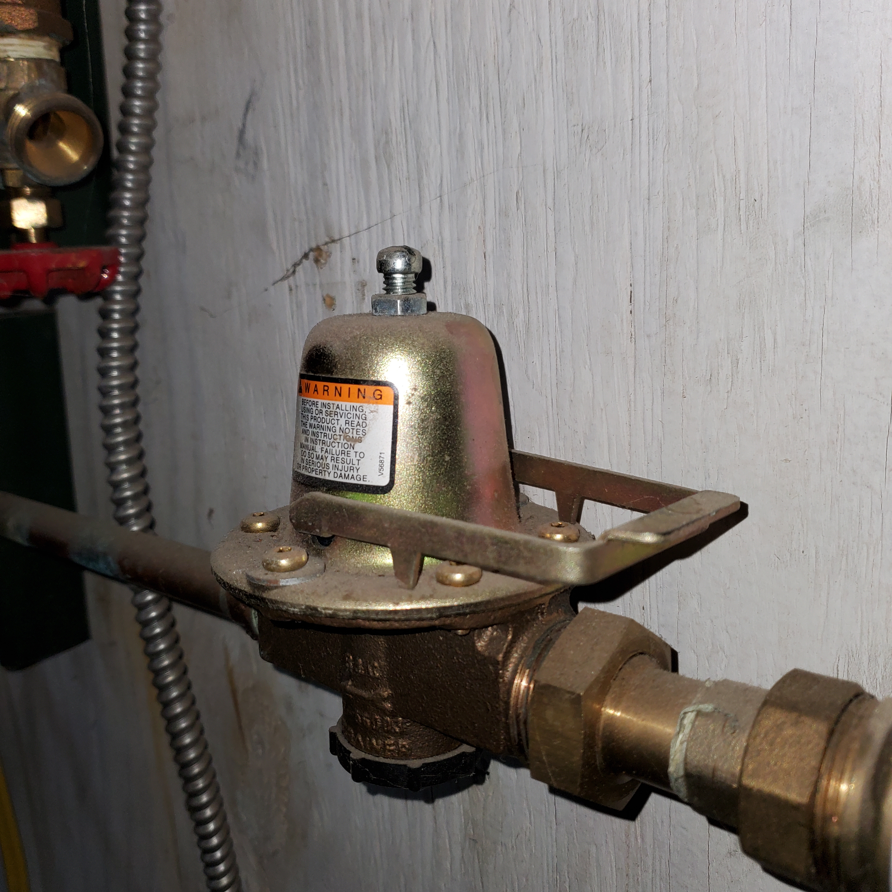

Today, when I went to move the plumbing for the make up line I realized that the isolation valve to the make up regular valve was in the OFF position and I'm pretty sure it had been. It's set to make up water when it dips below about 17lbs.
It seems like wasn't set up to AUTO add make up water (isolation valve was in off position), but of course could be done manually when needed.

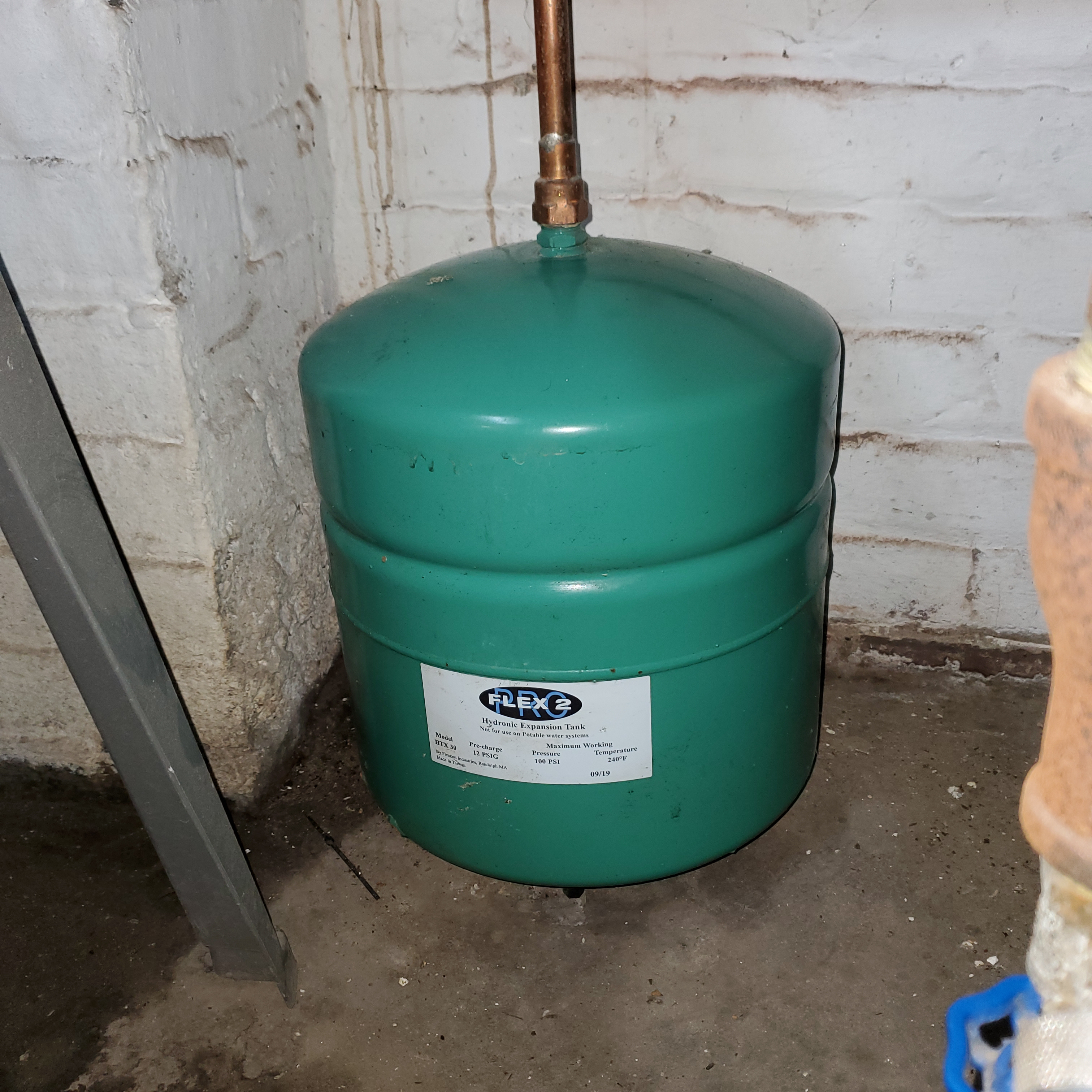

    It's not your feed valve. If pressure is increasing like that when the boiler turns on, it's the expansion tank. It may have lost it's charge — or it may have failed.
    First thing to try — press the Schrader valve on it. If you get air, at least the diaphragm is probably intact. Probably. Next thing is, if you can, isolate the tank and drain it. The remaining air pressure should be around 15 psig. If not, try raising it to that and leaving it a bit to see if it will hold. If not… may be time for a new tank.

    what kind of expansion tank does it have? when was the last time it was serviced(what kind of service it needs depends on tank type)?
    Does the pressure creep up with the system off? The manual valve might have been off because the pressure reducing valve is leaking so the pressure creeps up slowly with the valve on.

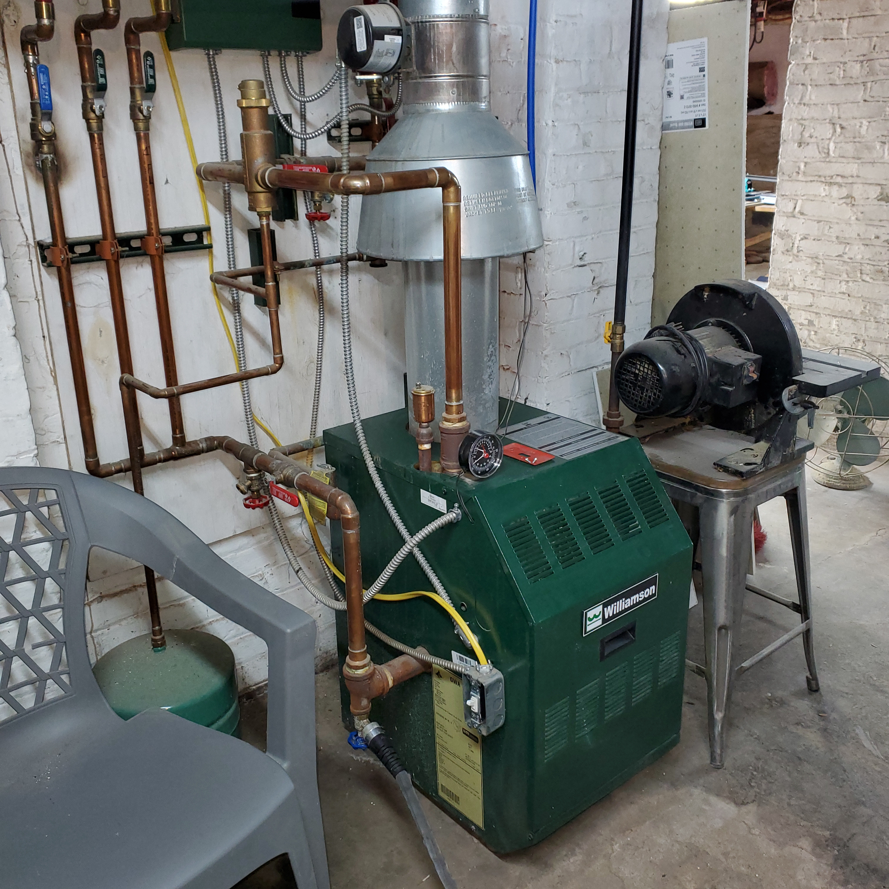

    This is a couple shot of the "whole" system, so you can see the bits and pieces.

    if the prv or something else is leaking in to the system and adding water you wouldn't hear it.
    does the pressure go up within a couple minutes once it starts heating and stays stable while it is cold?
    pex is rated something like 80 psi at 200f.
    if you made the piping smaller and created a restriction such that the prv is on the suction side of the circulator and the circulator is creating a significant pressure drop in the system then that could cause water to be pulled in through the prv.
    if it only started after you opened the system then the most likely causes would be that the prv isn't holding or it has a older style compression tank without a diaphragm up in the ceiling of the boiler room and you somehow waterlogged that while draining and refilling the system. I suppose it is possible that the diaphragm was in bad shape in a diaphragm type expansion tank and the stress of removing the pressure then rep-pressurizing it caused it to rupture. also possible this has been happening for a while and you just noticed it now.
    you should bring it down to about 12 psig while it is cold and turn off the manual valve and see what happens when it heats.

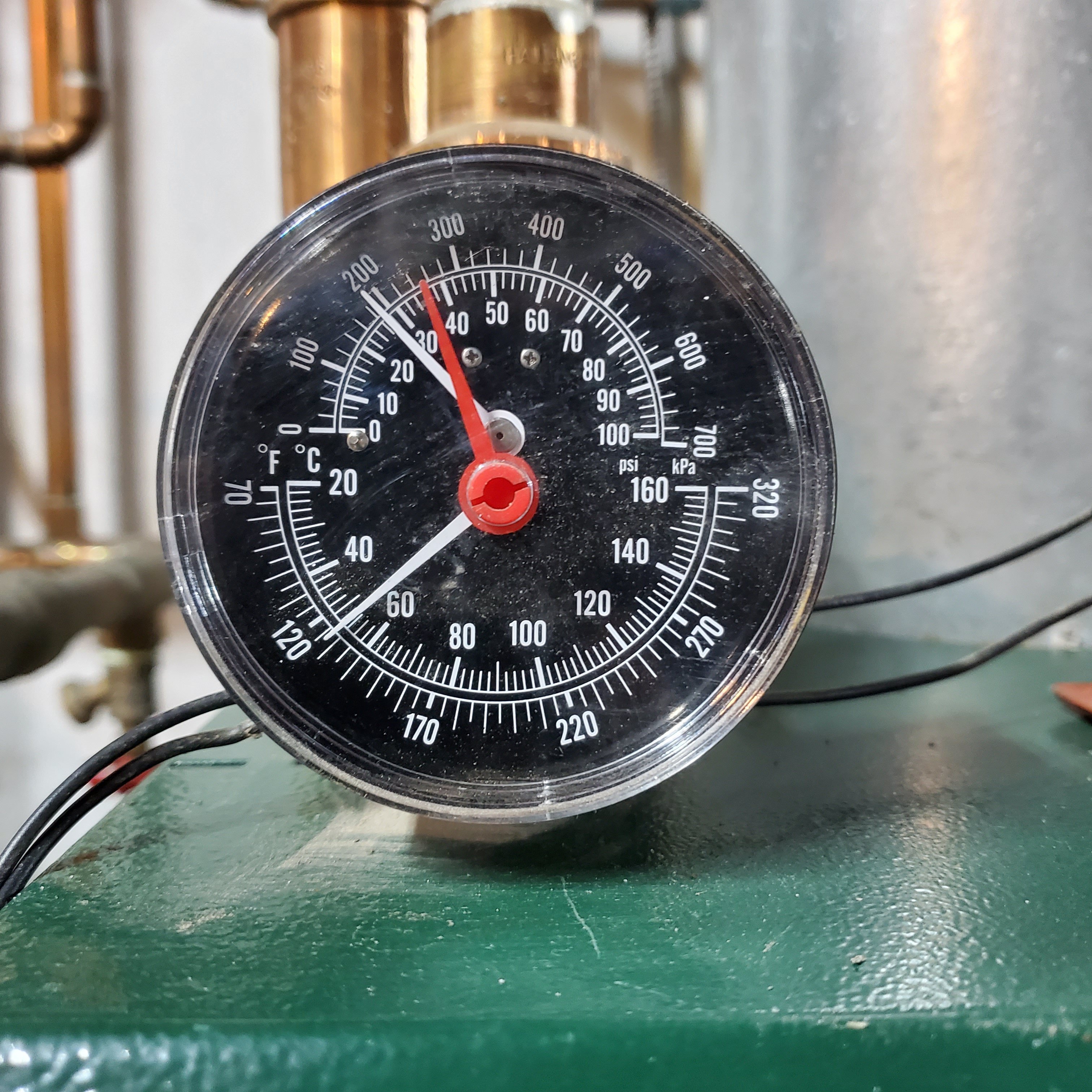

    So,,, at the moment, I am running both zones set at 76… It's running and the psi (H2O temp is still coming up) is at the BTW 15 and 20?
    Earlier, when I finished "fixing" **** and turned it on only ONE zone pump ran. That's when pressures went up. Could it have been a big old air bubble?

    So, it's running now and the pressure crept up to just under 20 from about 17psi... I drained of a little more to about 15psi and am watching it.
    When I turned on both zones I heard LOTS of air, water and bubbles moving around. When I just drained a bit of water off, lots of air bubbles and sloshing again. I feel a bit relieved,,, bit don't feel like I am out of the woods.

    I got all panicked not without reason I think… seems like things are leveling out. House reached the 76degrees up and down stairs, pressure went to 19-20, 160degress at the boiler temp gauge. After shutting down pressure went to just above 15, boiler off.
