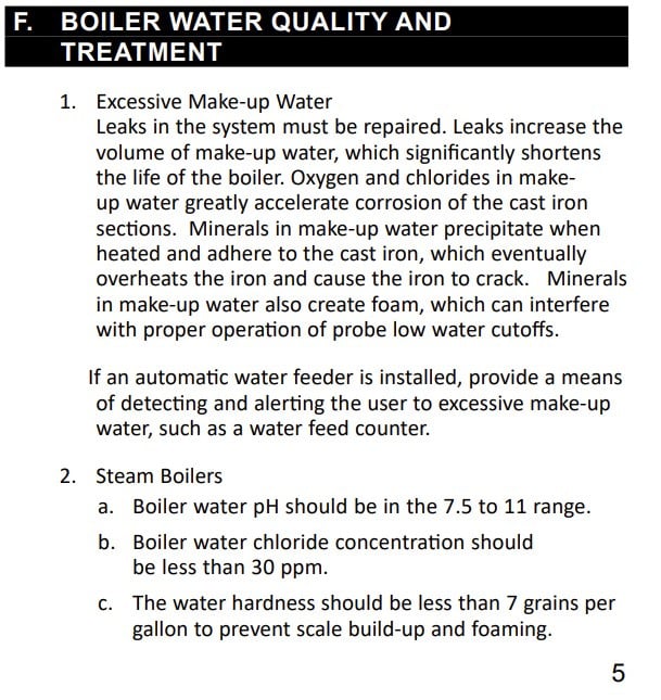

    It could be more alkaline than you think if you didn't calibrate your pH meter with some reference pH 10.0 solution. Alkalinity above 11 (maybe even 10.5) or so can cause foaming, surging, carryover, and priming and it can be worse or less depending upon the quality of the water in the boiler such as Total Dissolved Solids (TDS) and Total Suspended Solids (TSS). If your TSS is above 50 ppm from loosened stuff by the 8-Way that could be giving you surging and carry over. TDS is actually problematic if it is too low sometimes but that probably rarely happens in a boiler even with distilled water because the system is usually scaled up from years of previous use. I think you don't want it below 500 to 1,000 ppm or above 2,000 to 3,000 ppm.
    The Rectorseal 8-Way does have phosphate in it to buffer the pH and that is supposed to keep the alkalinity from going too high. Boilers tend to get less alkaline during operation over time due to things like carbonic acid accumulation. That's what happens in mine. I'm fine with distilled water (my tap water is too high in hardness and chlorides) and 2 oz. per gal of 8-Way believe it or not and my pH after a month was down to 10.0. I didn't test it initially. No surging in the sight glass at all. I'm not recommending that for others because it is almost twice what the bottle says and I am using preboiled rebottled distilled water which very few people do. Also my system is very dirty from 100 years of operation probably without proper water or treatment and carry over and my returns are always pretty dirty which I'm hoping will be getting better over time now.

    FWIW this is what Peerless now says in the installation manual. ph 7.5 to 11 is a HUUUUGE range (3,200 x) since it is a logarithmic scale. 7 grains per gallon would be equivalent to 120 ppm CaCO3.
