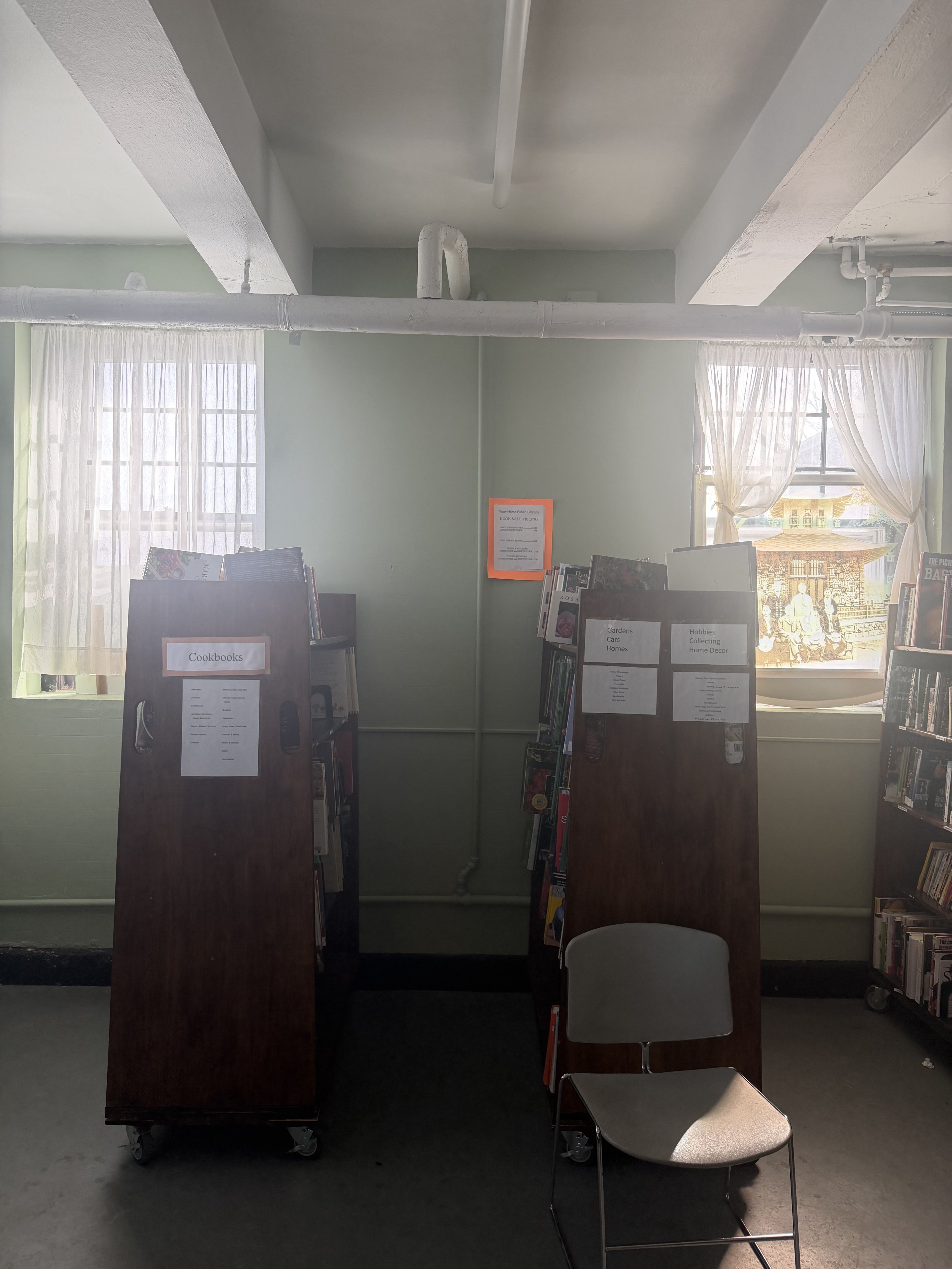

Title is for attraction. I’m quoting a replacement boiler for a public library. At least that’s what they think they need. What they actually need is a venting/trapping plan for the building piping. Built in 1853 and a large addition added sometime in the 1950s. The homestead is now a large public building. Current boiler is an LGB 8 natural, with boiler feed pump, 3 zone valve header. Just obscene water hammer, crazy fuel consumption, eats a boiler every decade and has been since the 1950s. I’ve audited the building and can find no intentional venting of any kind. There are copper fin tube fan coils that have been repaired by brazing ruptures shut. And one active rupture that is acting as a vent currently I suppose.
2 pipe steam with thermostatic traps on all rads/fan coils. The larger zone main supply runs out about 80’ and deadheads a tee and splits to two separate runs on each exterior length of the addition. At the end of main drip connection there is no venting or trapping, simply drops down to a wet return and runs back to the feed reservoir.
The smaller zone is similar except it has a dry return and again no venting or trapping. Just drops to the wet return and back to feed reservoir.
The third zone is pointless, as it simply leaves the header and runs about 30’ to a point where it just tees into the smaller zone’s end of main supply. I have no ideas why this was ever done, but I had to put it out there. There is no radiation off this 3rd zone.
Now, in all these years all our local guys have done is replace boilers and crank the pressuretrol up to 6 psi, changed a rad trap or two along the way. I’m told by the maintenance man who monitors the boiler regularly that it actually build 6psi at times, and in the 8 hours I’ve spent there I’ve seen 3.5 on a mild day.
looking for opinions on venting and trapping. Currently thinking B&J big mouths at end of main and f&T traps to separate the supply from wet. Am I missing something? It seems so silly what I’ve seen so far, but there is always something to learn with steam heat. Thank you in advance fellas

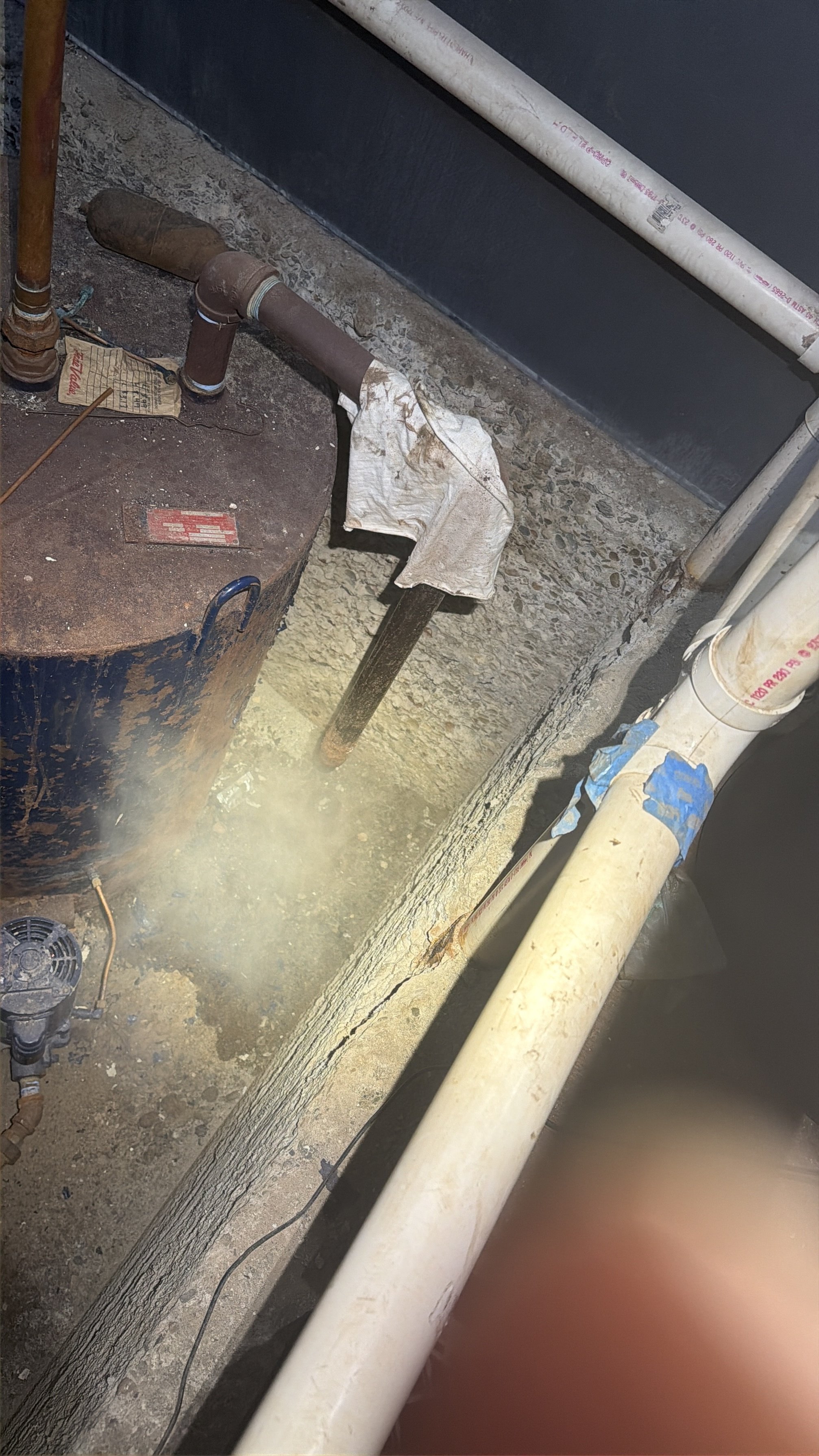

    @AndythePlumber said "Steam regularly dumps out the reservoir overflow."
    Now we know why the boilers don't last. With all that steam leaving the system, you need a lot of fresh water coming in to offset the loss. That much fresh water will rot out the boiler quickly.

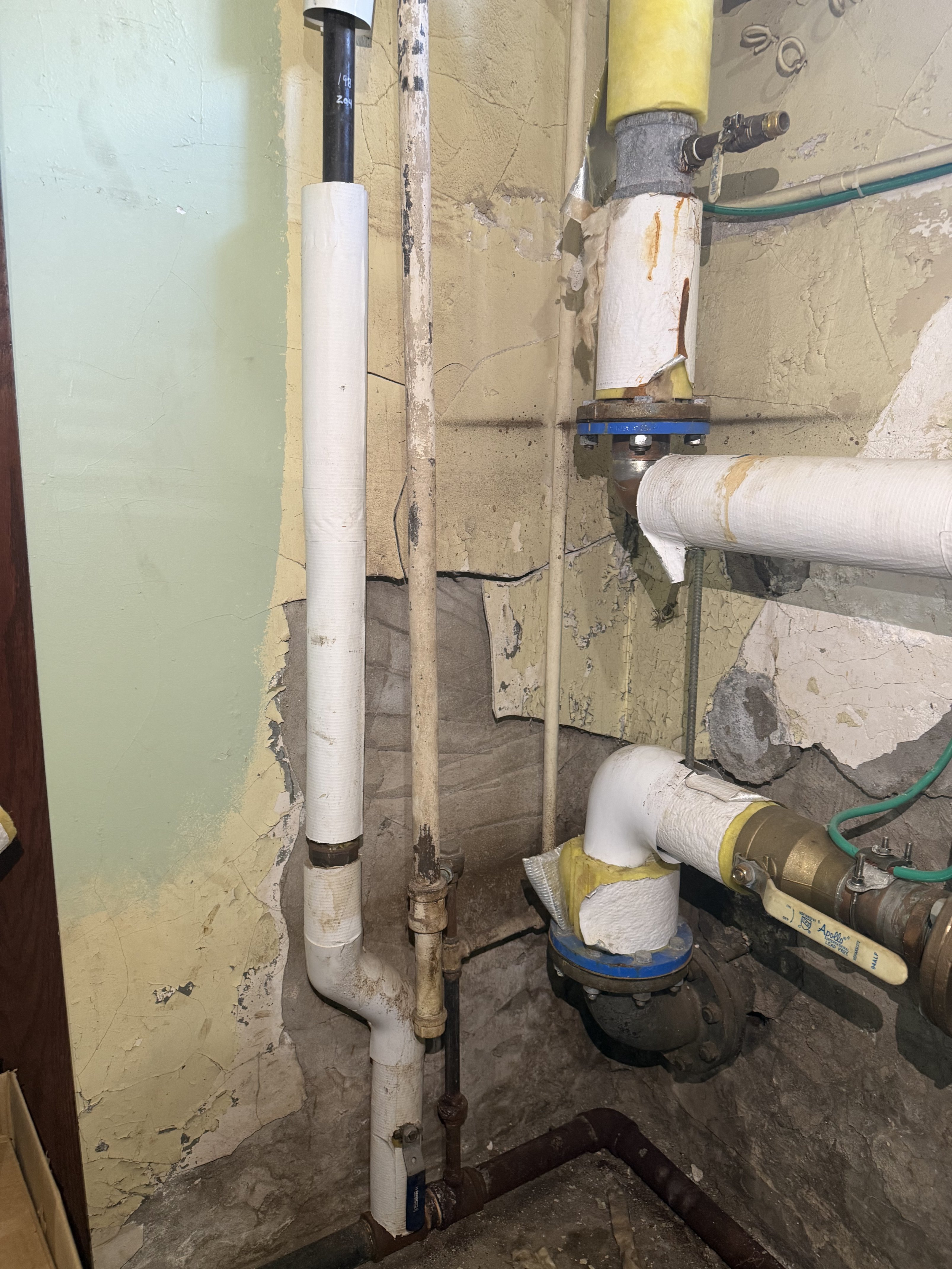

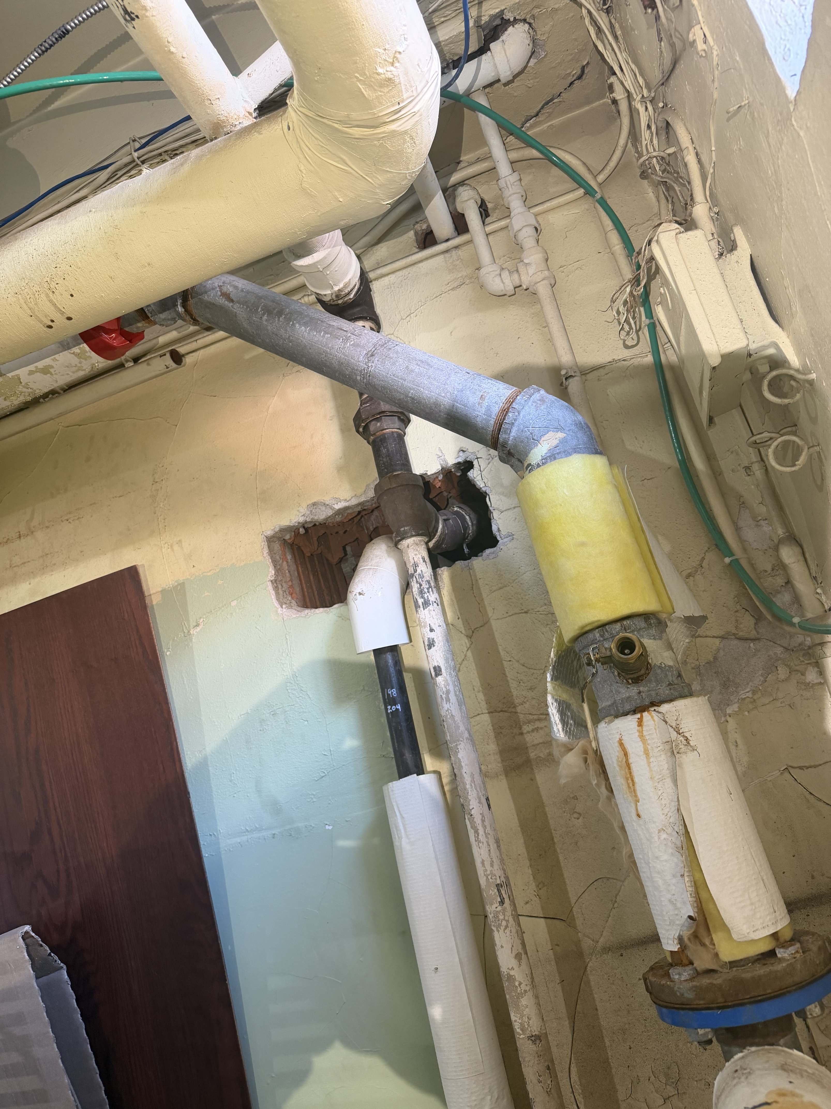

  • AndythePlumber
    AndythePlumber Posts: 111
    The 6 x 11/4” 90 is gorgeous steamhead. Thing of beauty and even cast iron to boot. Top notch work brother! There is no known pit installations. The feed pump is recessed in a pit. One thing I must mention that I’m beginning to think is more and more important here. Of the two separate zones…
    The original homestead zone is the smaller, and the addition dated to the 50s is the larger and has the feed pump in a pit and the lions share of the wet return. Ok…
    The original homestead zone has a supply and a dry return with no operational venting or trapping and a drip connection to the wet at its end..
    The addition and larger zone has no dry return each radiator drops to the wet return all with rad traps in assumed failed operational conditions. Page 125 of the Dan’s Bible speaks on this and I’m trying to understand its significance here. I’m going to share some pictures soon…and wait till you guys see the pressure gauge it’s glorious and operational

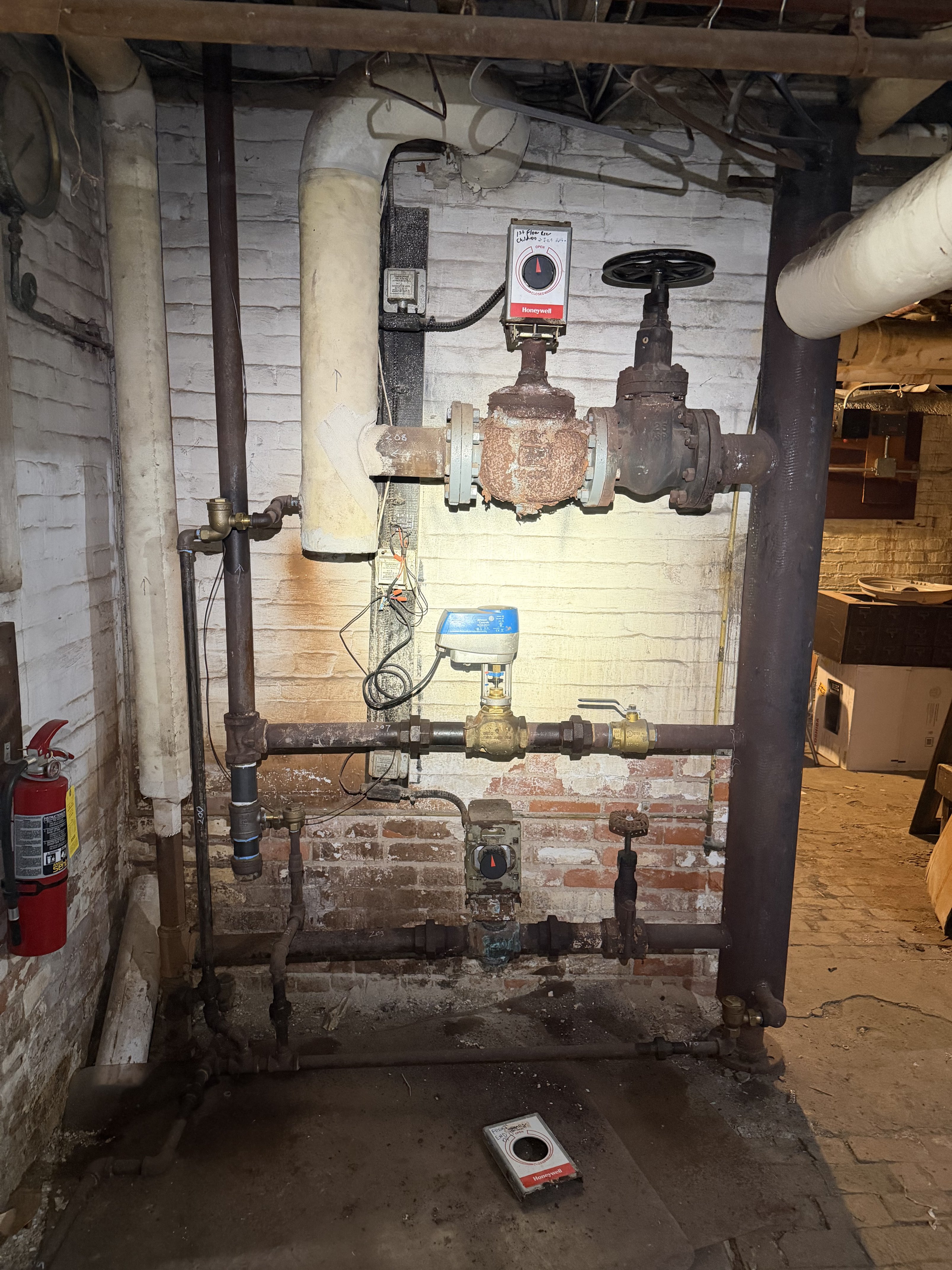

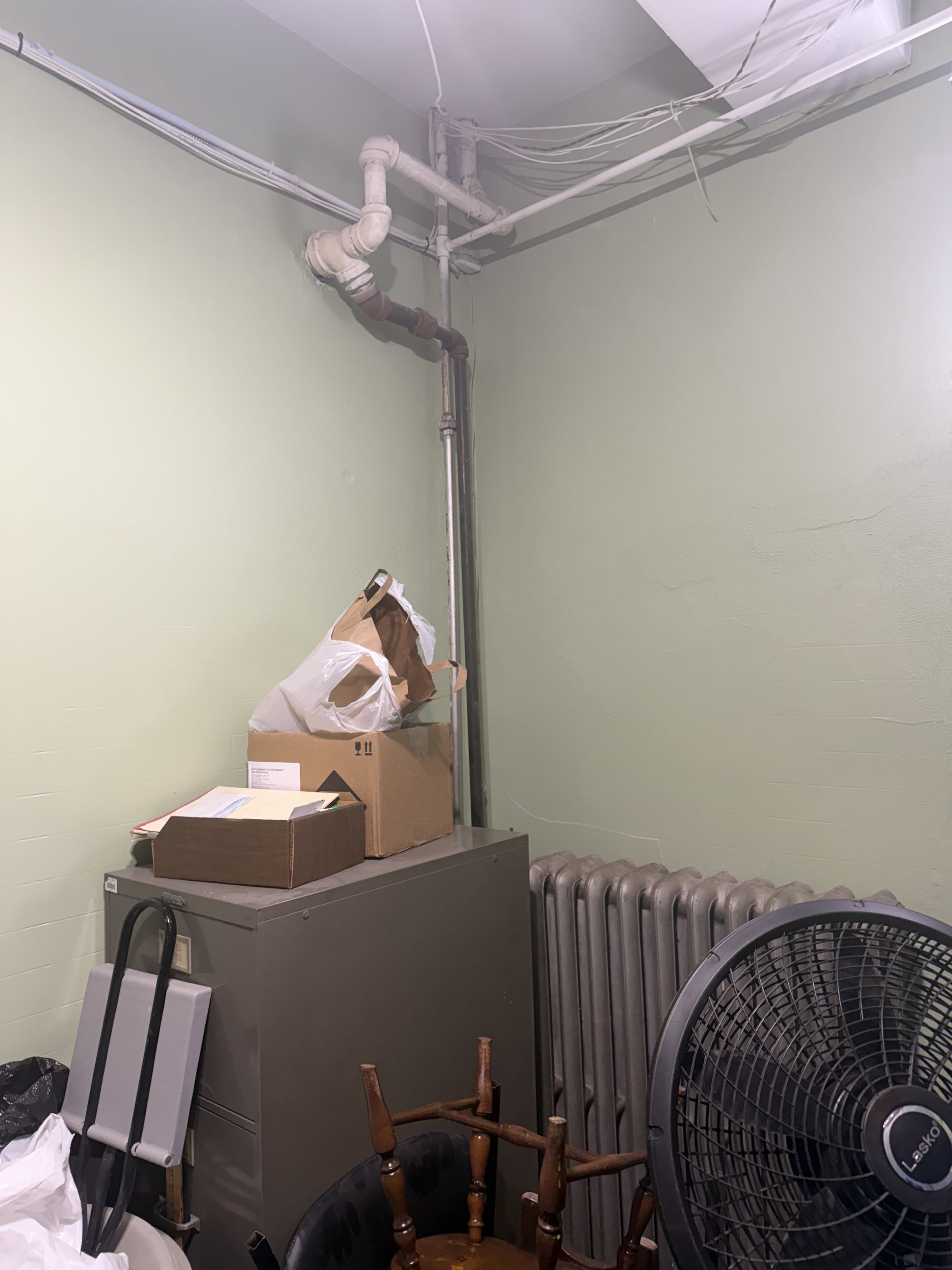

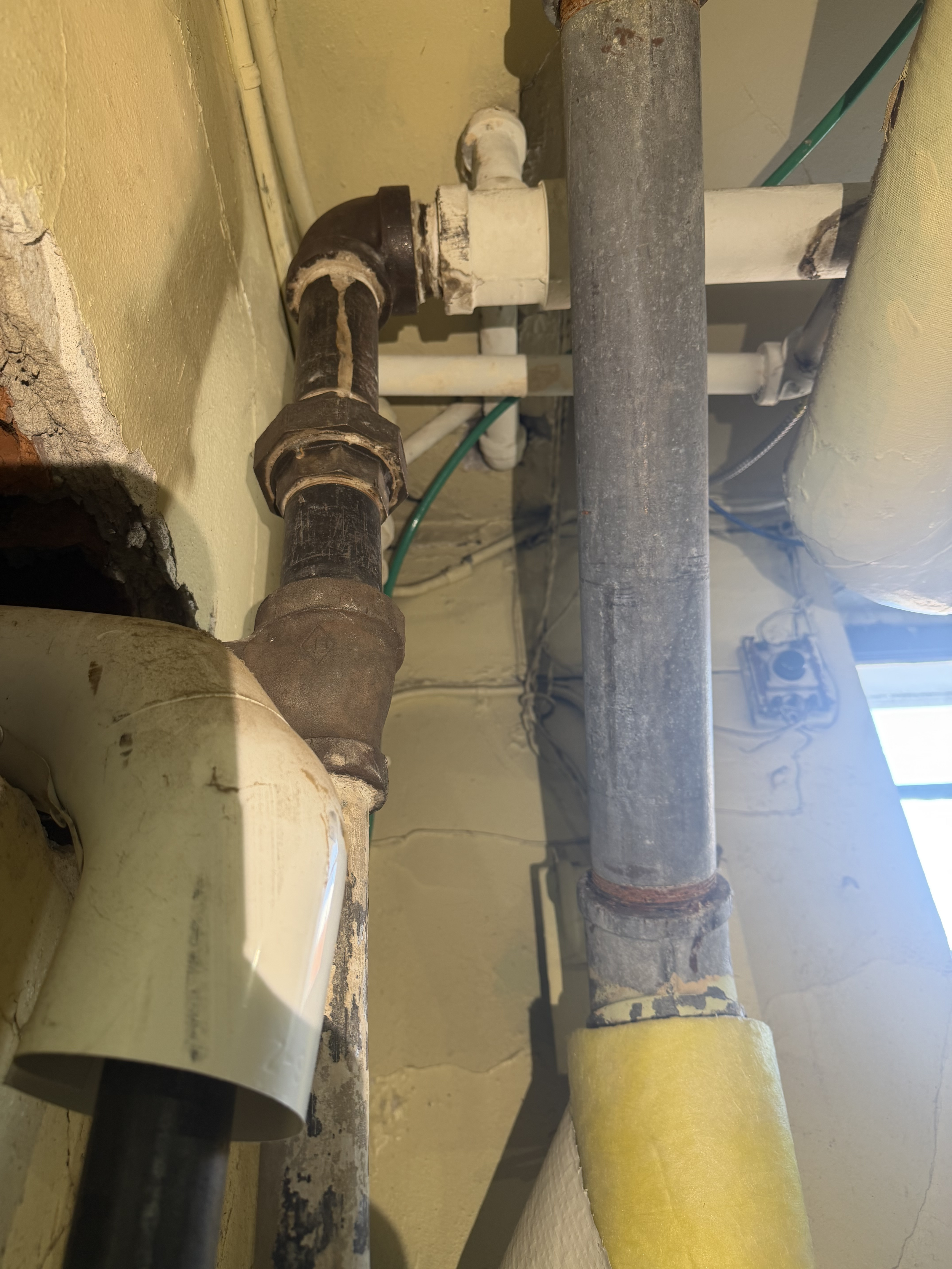

  • AndythePlumber
    IMG_4740.jpeg IMG_4747.jpeg IMG_4715.jpeg IMG_4713.jpeg IMG_4706.jpeg IMG_4717.jpeg IMG_4748.jpeg
    all I have for now. Is it possible to share videos?

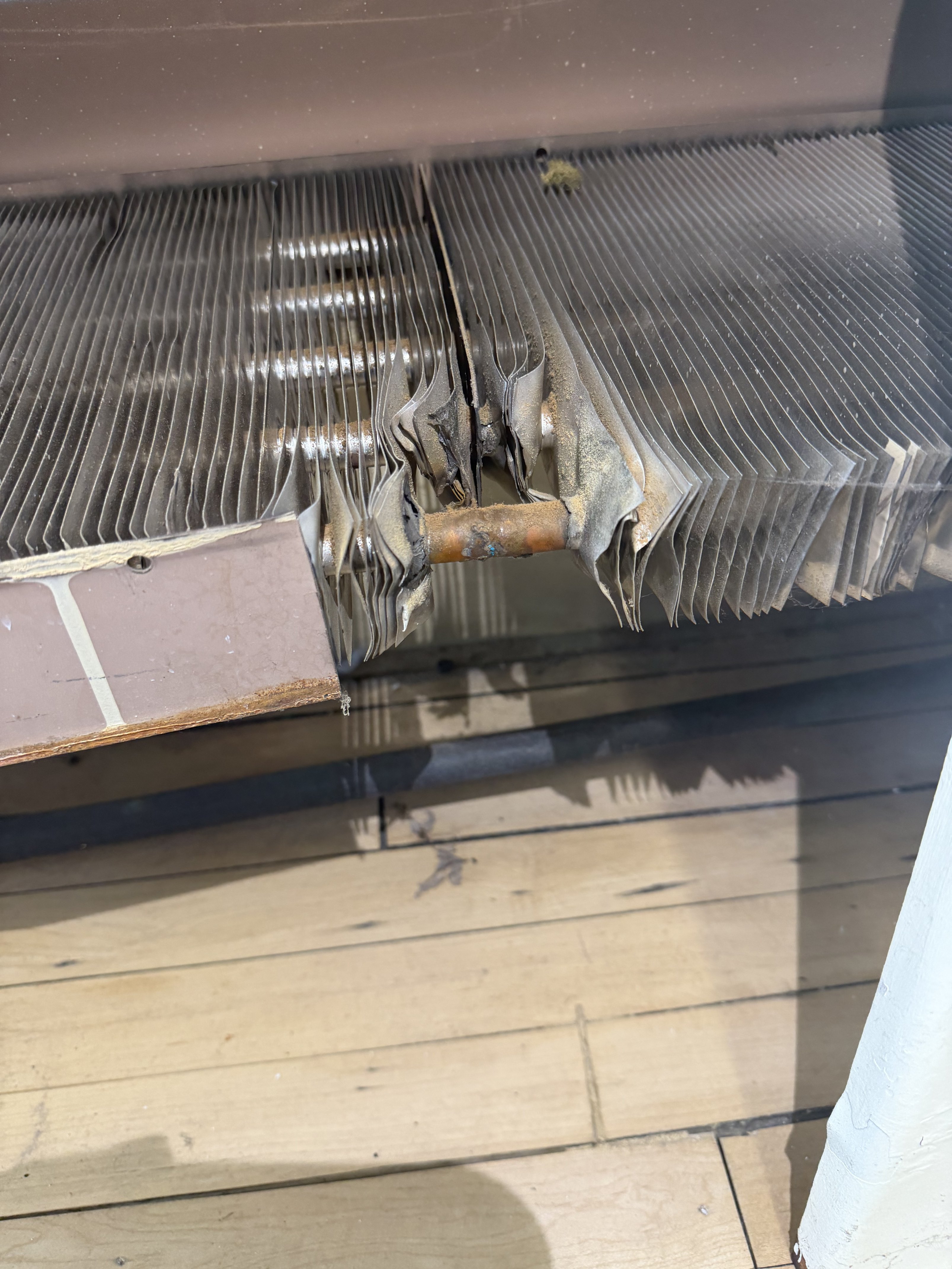

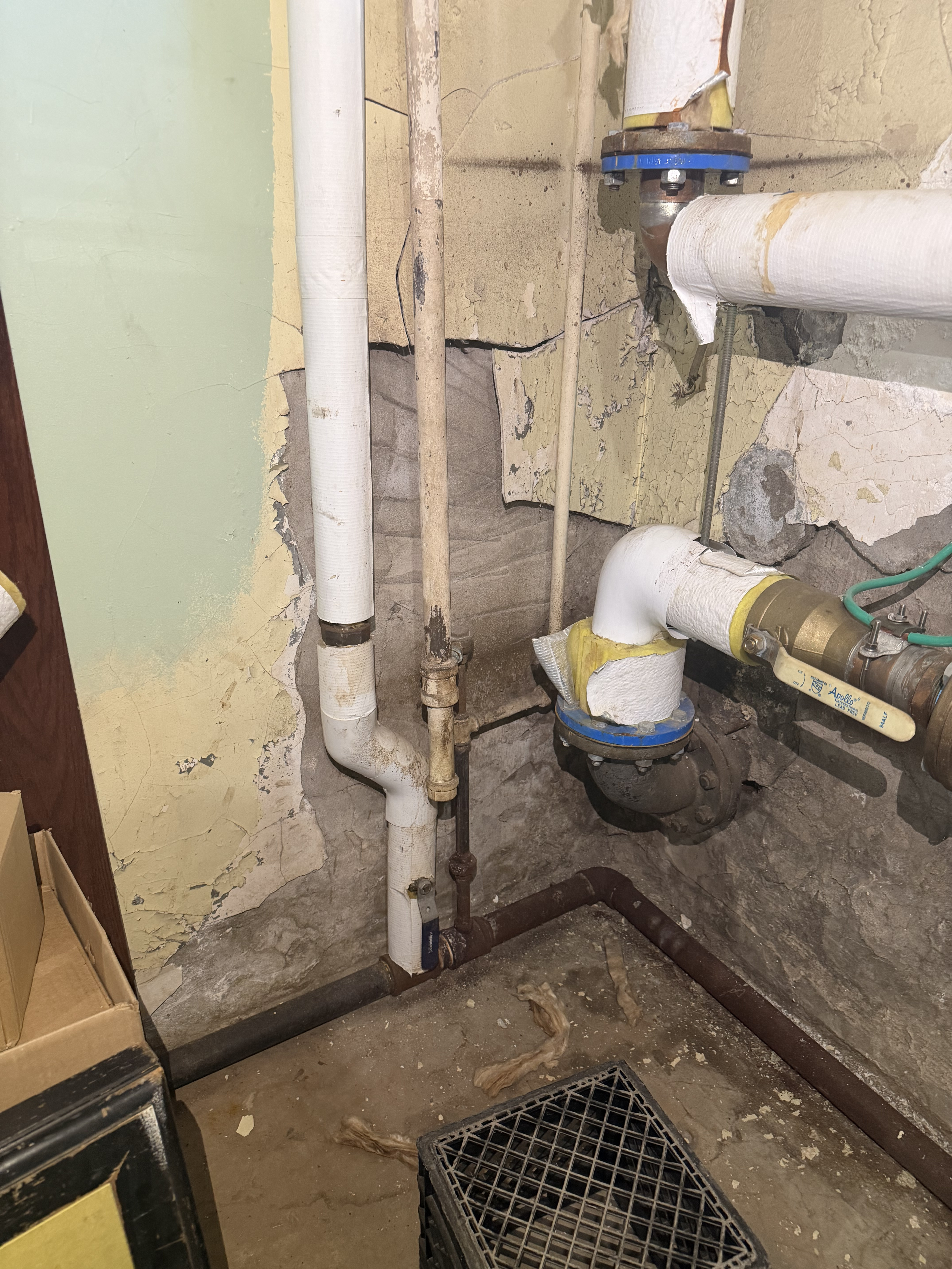

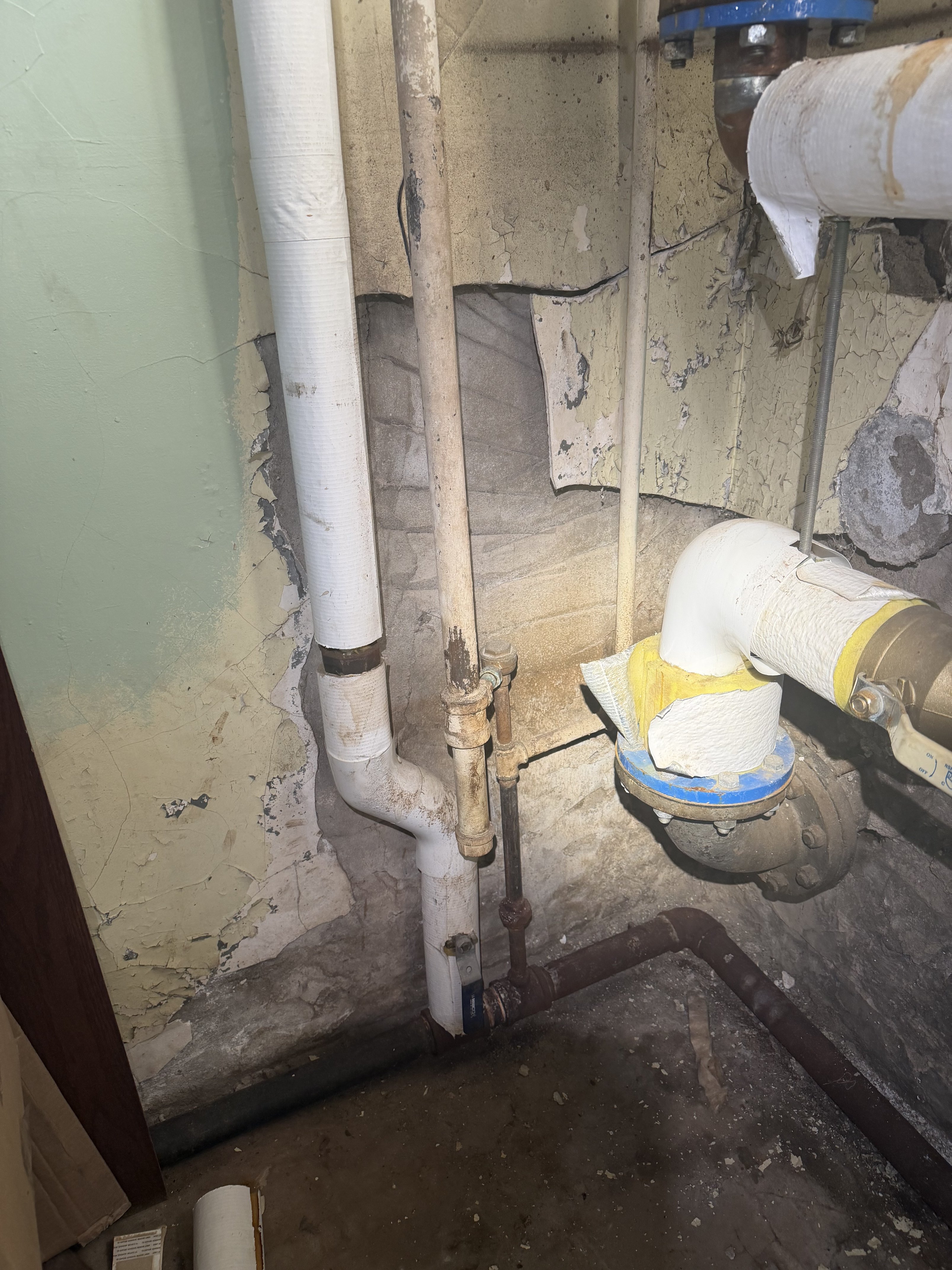

  • AndythePlumber

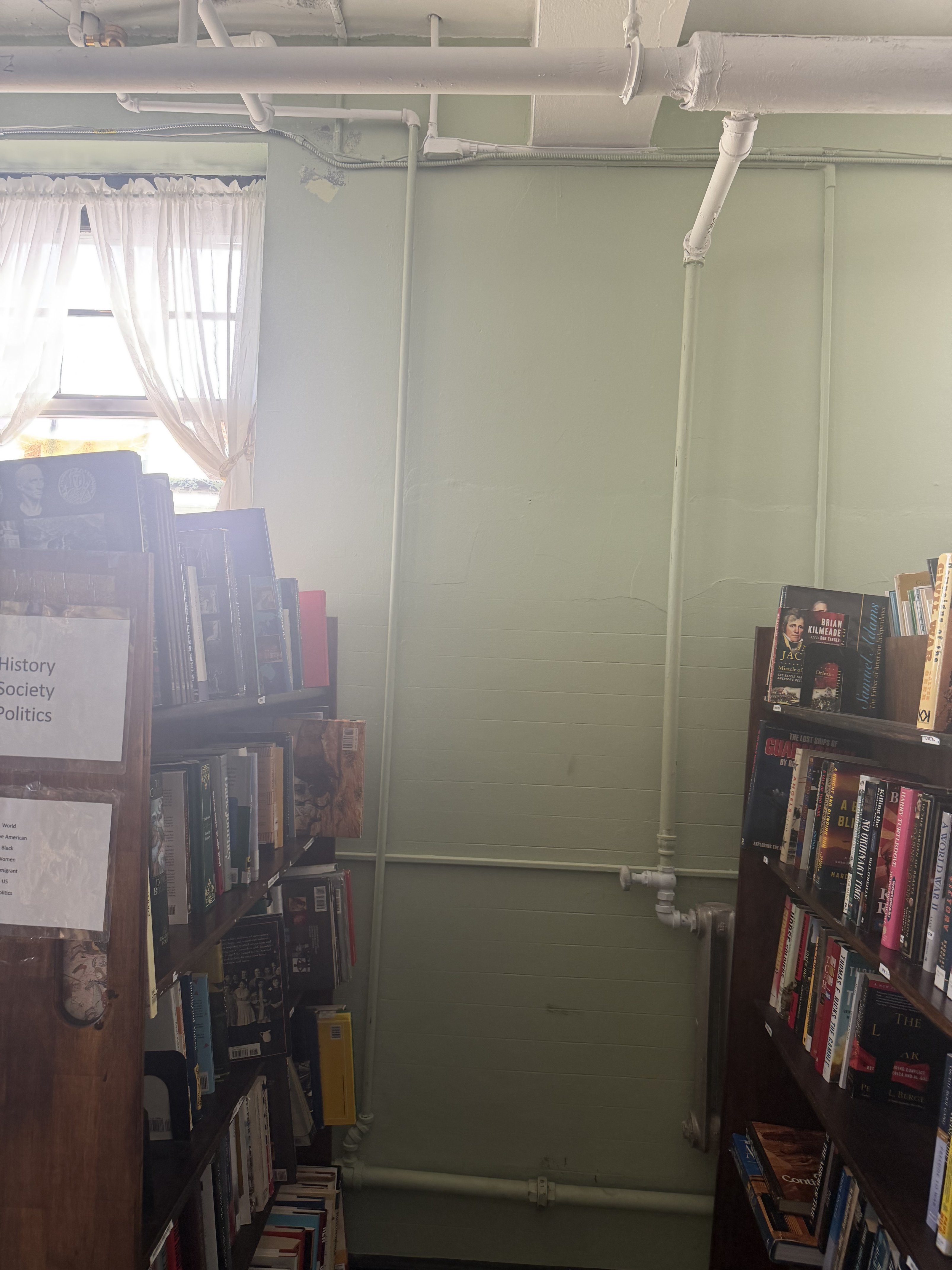

    these pictures illustrate what I mean about individual rads dropping to wet return. It’s the basement level of the addition. Wet return gravities to the recessed pump. Any basement level rads rad trap to the wet. All radiators have a trap in again unknown condition.

  • AndythePlumber
    edited March 2
    typically what you see at the pumps, I’m told it fills the room with steam a few times a week…

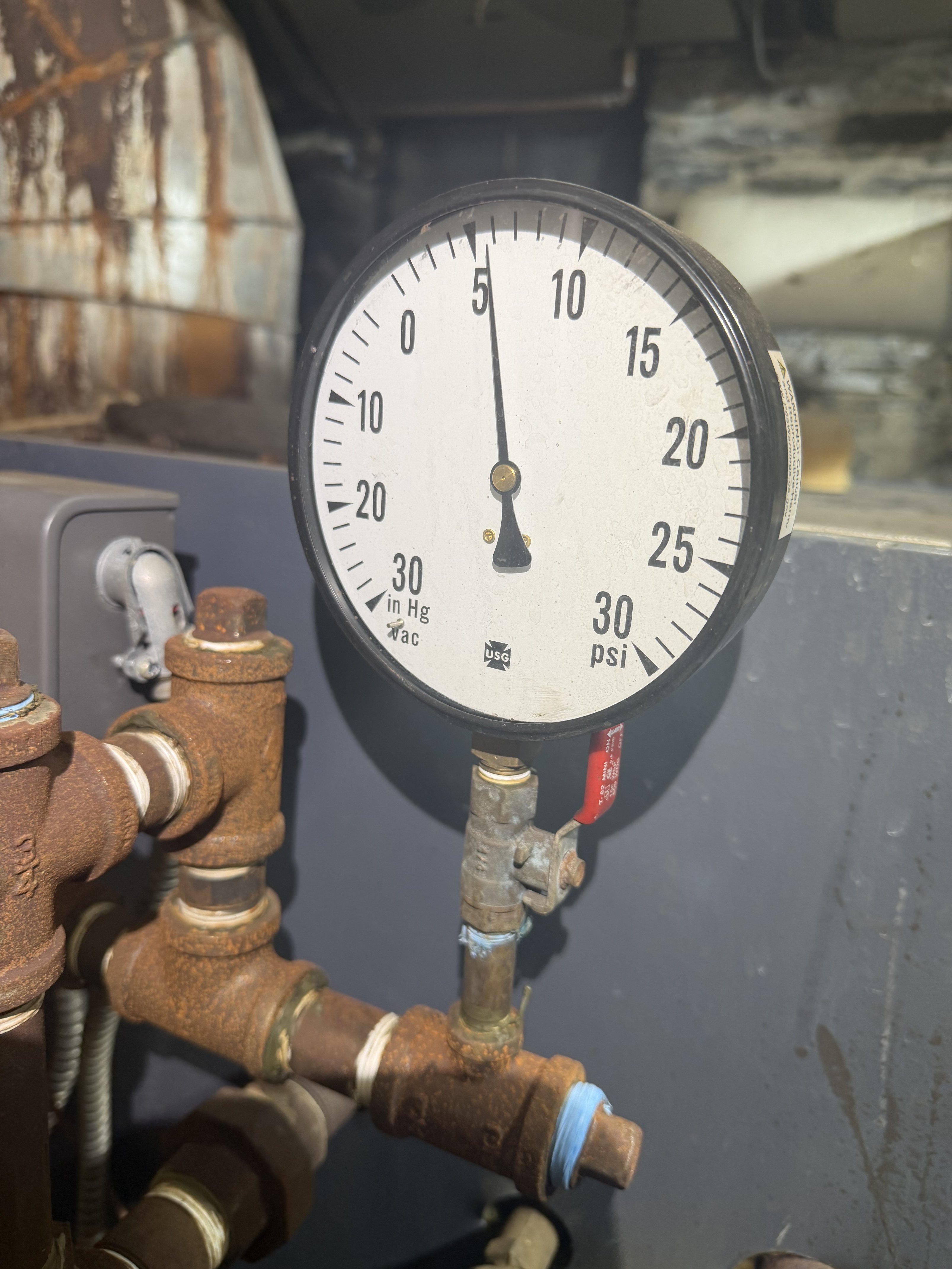

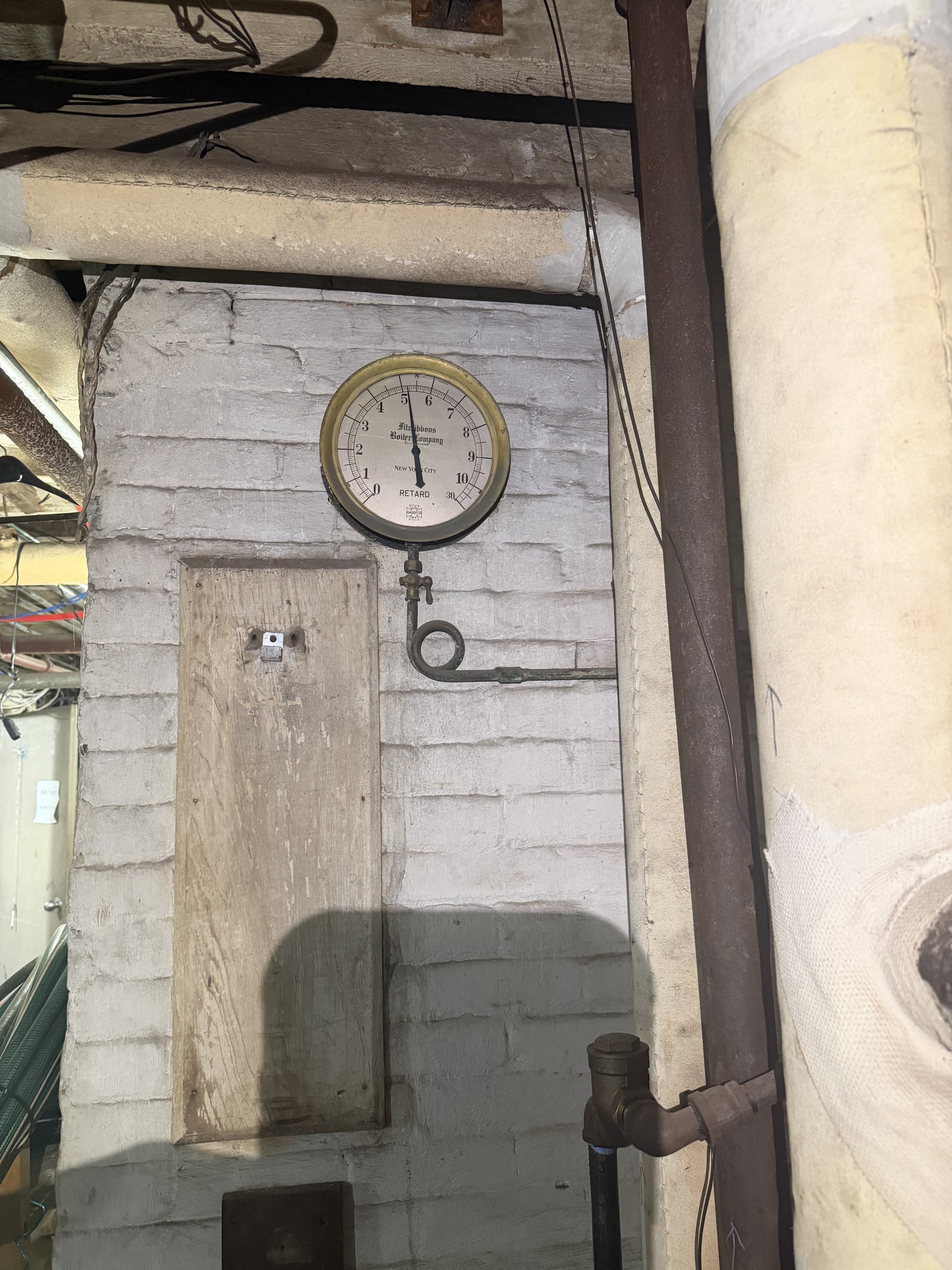

  • ChrisJ
    ChrisJ Posts: 17,763

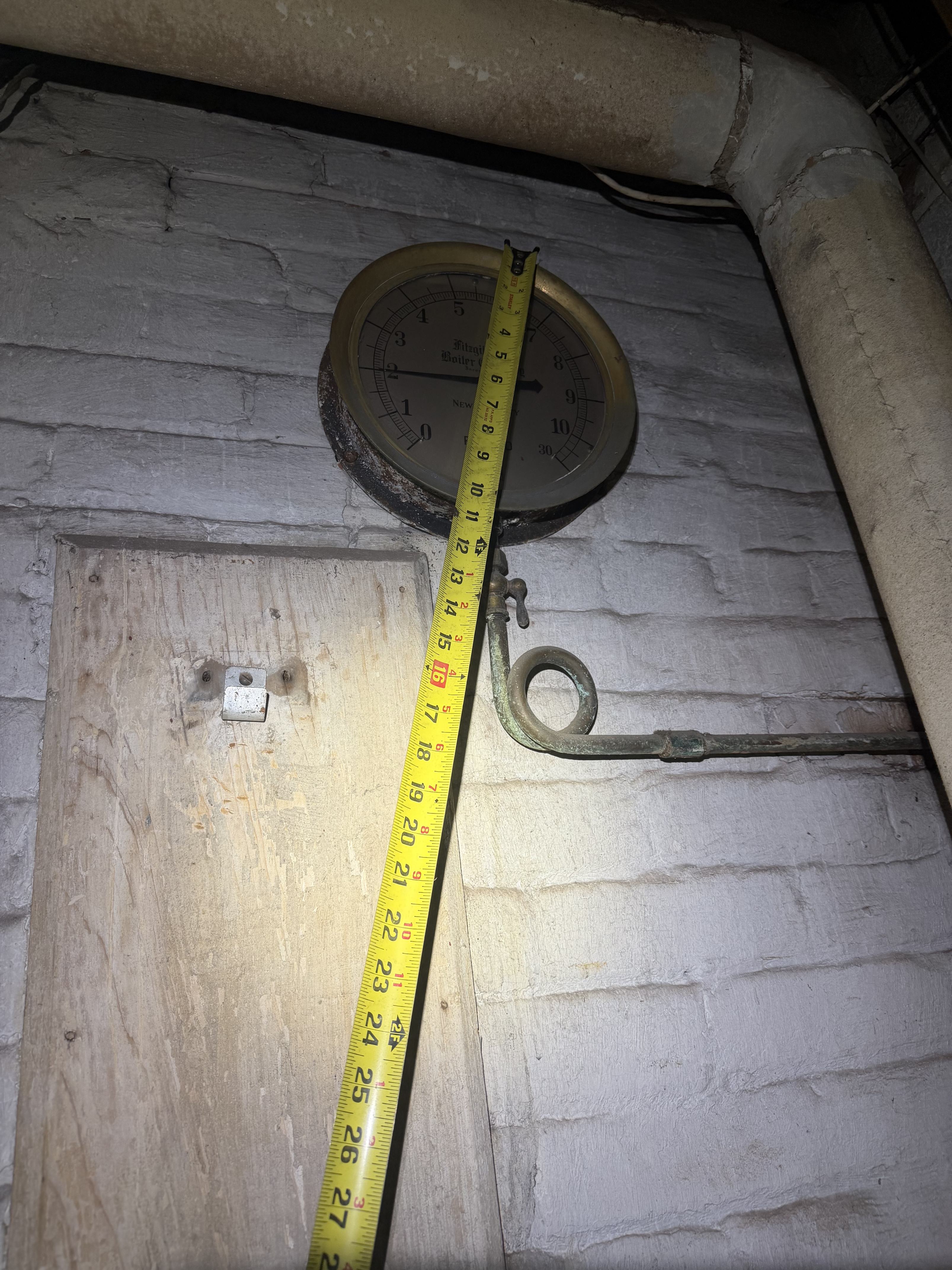

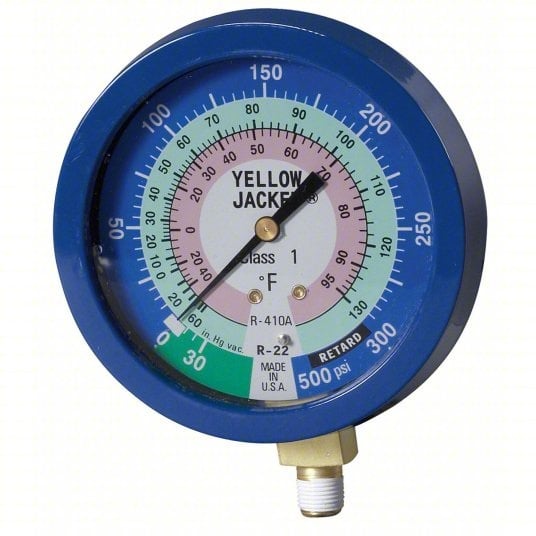

    That's an interesting gauge.
    It doesn't list it's units, but is obviously PSI, and it goes from 1-10 nice and linear and then that last 1 PSI amount of travel, ends up 30 PSI?
    EdTheHeaterMan Posts: 12,947
    That is what RETARD means on that gauge. Once the pressure rises above 10 PSI the gear ratio changes to move the needle at a reduced rate. When you want an accurate gauge in the lower PSI increments, but code says you need a 30 PSI gauge, this is the best of both worlds.

    I thought retard meant if the needle exceeds 30 you need to reduce pressure.
    delcrossv

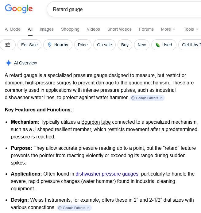

    “RETARD” means the gauge movement is damped (slowed down) so the needle responds more slowly to pressure changes. A “retard” gauge has built-in damping or other modification to:
    • Reduce needle flutter
    • Smooth out rapid pressure fluctuations
    • Modify the arc at one end or the other end of the scale.
    • Make readings easier to see and interpret
    • Protect the internal mechanism from vibration and pulsation

    Holycow I never noticed that before…. I knew they always say it, but never noticed how fast the pressure goes up.
    Are those wet returns? If they go to the condensate tank and the tank is lower than the return, won't they be dry returns, unless the pipe goes up then back down.
    Radiators that drop down individually to a wet return are usually 2 pipe air vent systems but those are early 20th century systems normally.
  • AndythePlumber
    I am considering them wet as they are just being ran across the floor and back pitched in many areas. By all means tell me if that’s flawed thinking. You can hear them just sloshing water around and hammering often
    THINK
    Steamhead Posts: 19,007
    The back-pitch is the problem- those returns should slope down to the condensate tank. When that's done they will vent air as well. Then rebuild the traps and that zone should work.

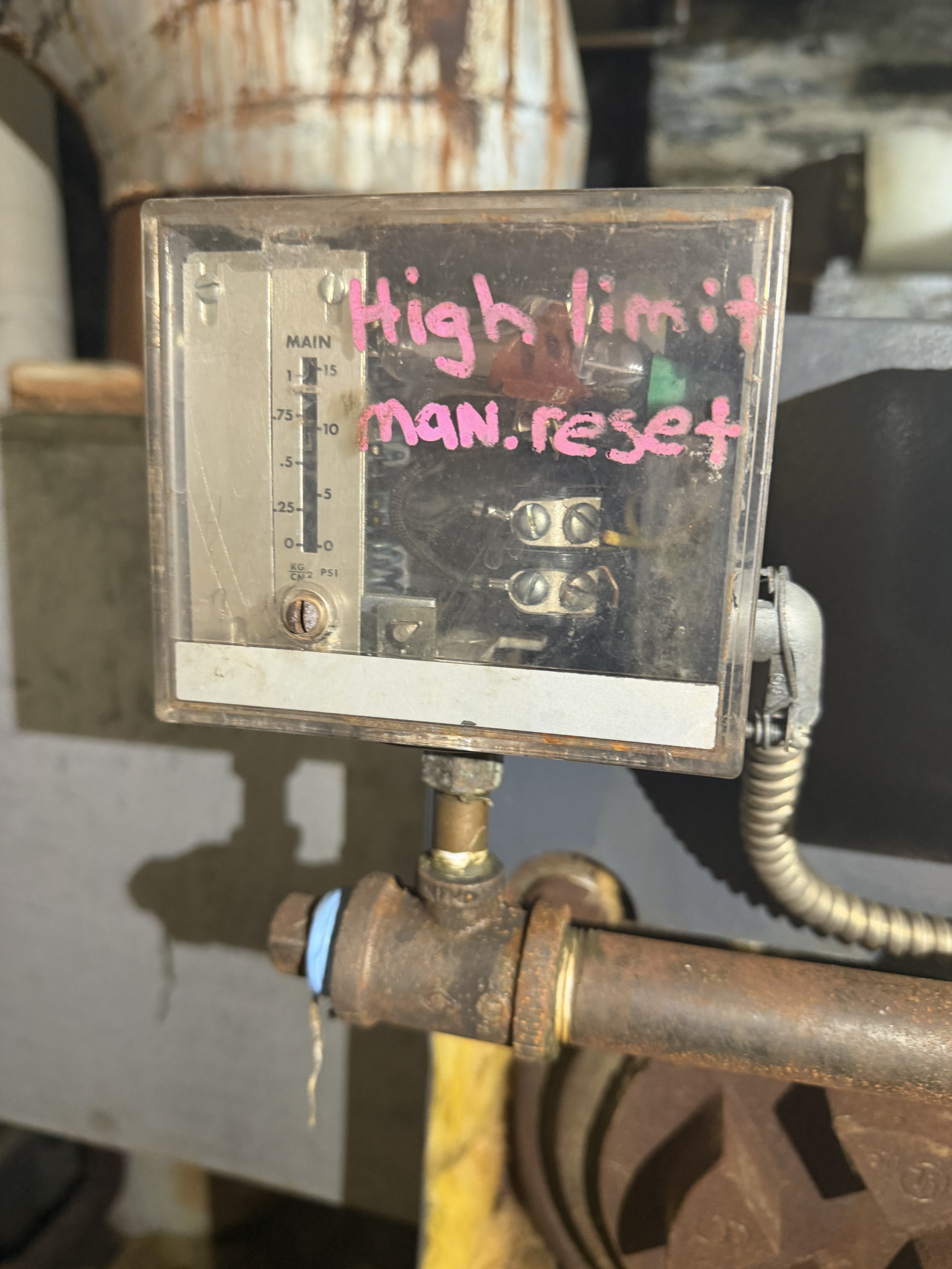

    I have seen a lot of boiler installations that are similar to yours and most of them work pretty well. First, let me ask, what is controlling the operation of the condensate pumps? It has to be a water level control on the boiler itself. Next; looking at the picture of the 3 zone valves, they look OK but I would replace those thermostatic traps with an F&T trap, a ball valve and Y strainer before each of the traps. While you are at it I would replace all the thermostatic traps that are used on any line except those that are installed on the radiation. Now to the condensate return tank. The make-up line to the tank is controlled by a float which is part of that bushing fitting. The float level should be adjusted to it's lowest level to give the tank it's greatest capacity to store condensate water. The PRV on the make-up line should be adjusted to below 30PSI so water pressure will not push past the float valve. If possible, I would add a water meter to that make-up line so someone can record how much make-up water is being added. All of the steam traps should be checked and replaced if necessary .Any return line that is nit visible should be inspected to make sure it is not leaking and wasting water. One more item, those zone valves should have the slowest opening time possible to eliminate the possibility of pulling water from the boiler due to high steam velocity. Last item, a lot of these older steam systems need to operated a higher than what is considered normal steam pressure since there have ben so many changes to the system. (radiation and piping changes). In most cases air vents are not necessary if everything is operating properly.
    6 PSI steam pressure is considered higher than normal but in this system it may be what is needed. You could try reducing the pressure gradually to see if a lower setting will work. These older systems can be challenging especially to a new service company since most of these building owners are used to repairs that are the cheapest and they are afraid to spend the money to correct all the problems.

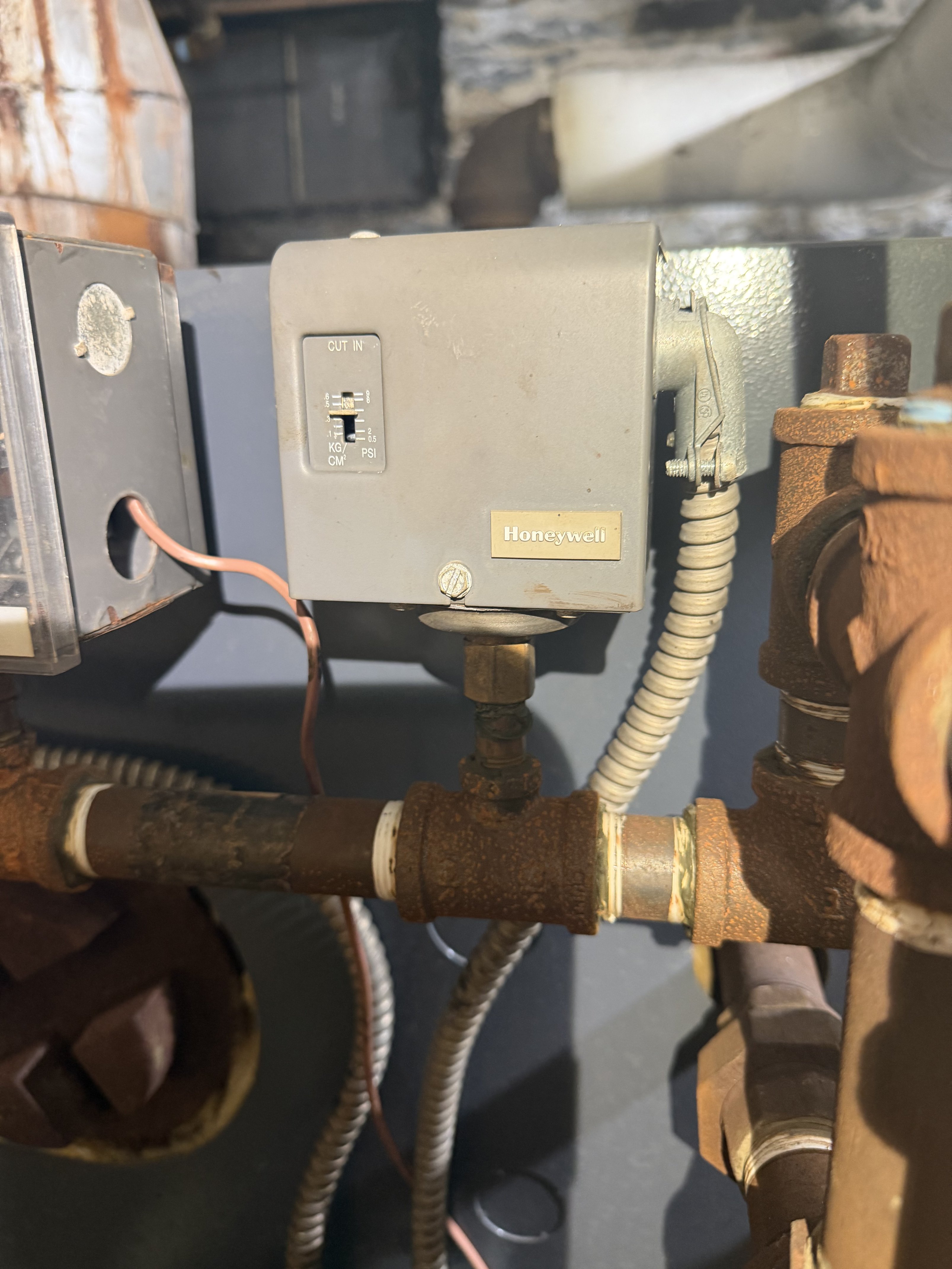

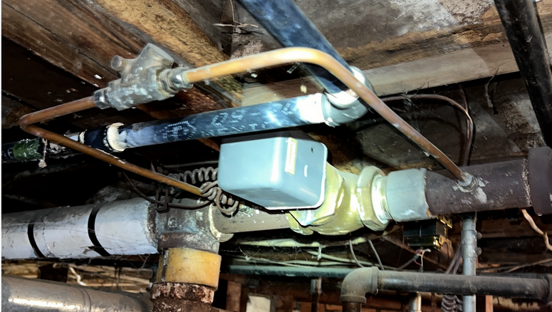

    I hadn’t seriously considered the feed pump controls. I just assumed they talk to the lwco or a float in the receiver tank. I did relocate an operable meter I found in the basement to the make up water line and we are monitoring,
    Yesterday…. I added a Hoffman 62 vacuum breaker in the return near the basement ceiling. I did so because, each time during an off cycle when I cracked a union in the return it breathed in hard there.
    further I found a bad, bad dirt blockage in a drip connection on the smaller zone.
    Shut off the zone that feeds into the smaller zone…idk..I can’t understand a meaningful reason for that ever being done
    Turned the pressuretrol down to .5 and then tuned it up to 1.5-2 to get all of the radiation hot.

    the vacuum in the return is the water that is filling the pipe because of the bad pitch trying to get out but air can't get behind it because it is filling the full cross section.
    109A_5 Posts: 4,759
    I think vacuum can be an asset to a steam system, but it has to be part of the big picture.
