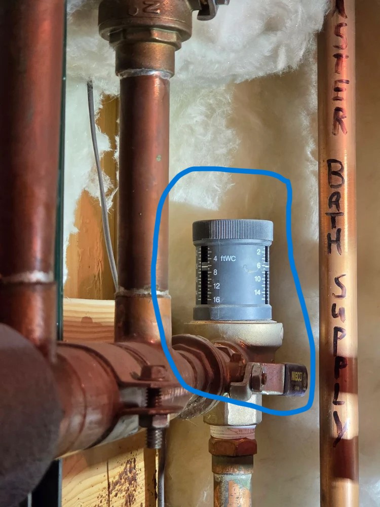

Can somebody tell me what the part is (circled in blue) on my heating loop? Thanks.
Thank you ScottSecor & hot_rod. Much appreciated.

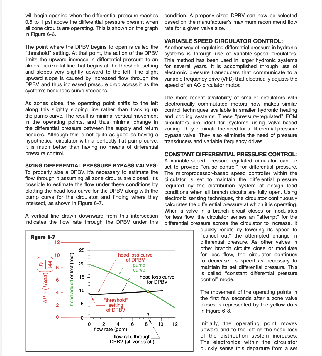

No problem. We used to use them often with single speed pumps (on off) with many zones.
This is on a 5 zone heating system and an indirect. Three Taco 0010 pumps (DHW, Boiler & Heating). Just always wondered what the device was and now I know.
What size boiler, or heat load do you have?
That circ is a flat curve, ideal for zoned systems. In its sweet spot it would like to be flowing 12-20 gpm, mid curve
