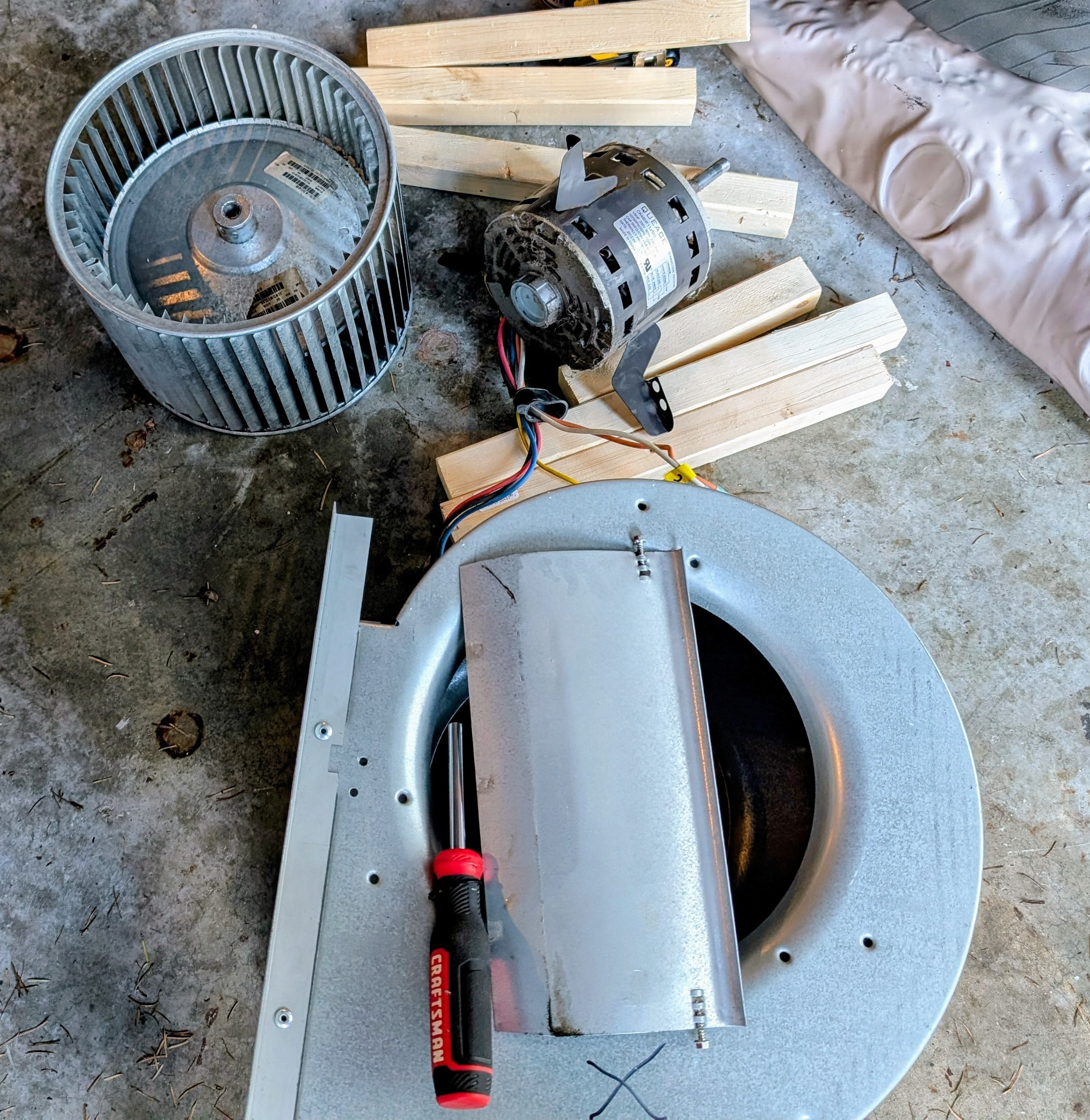

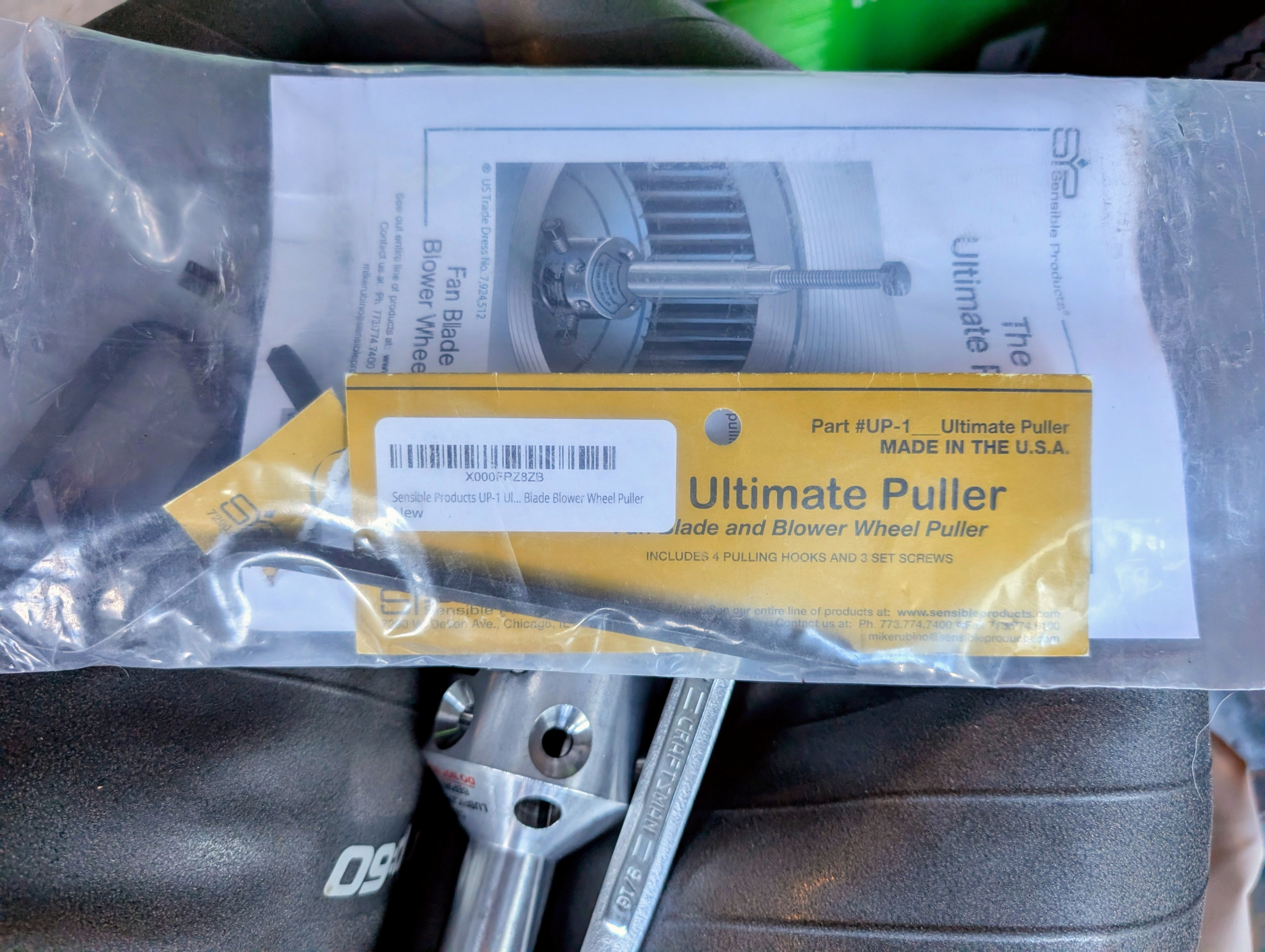

After trying a new capacitor and the motor still not starting I removed the blower motor and fan housing. I was unable to get the fan off the motor shaft so I ordered this tool off Amazon (cheapest option due to free shipping).
The puller got the fan off in less than 5 minutes.

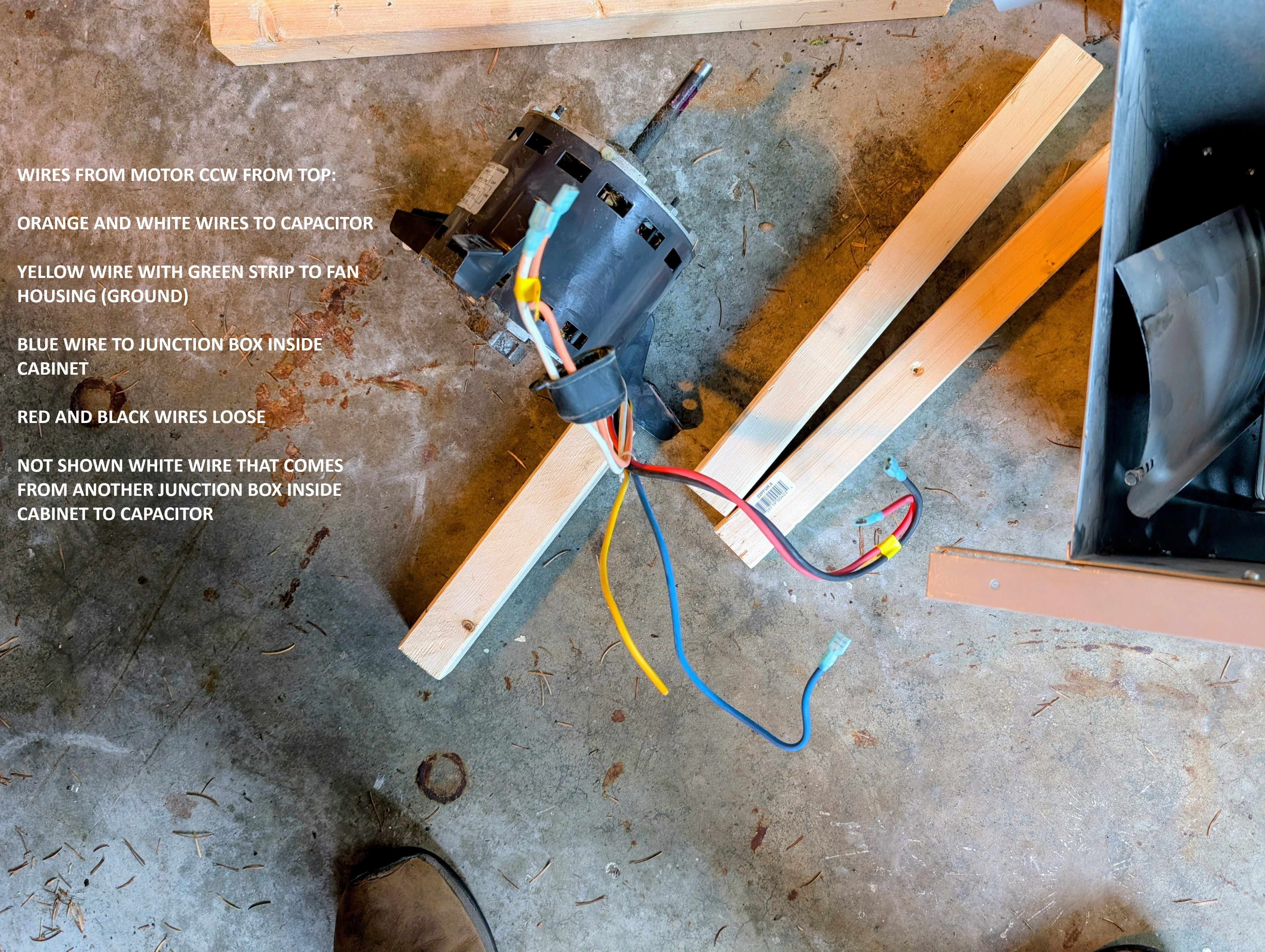

So here is the loose motor wiring.

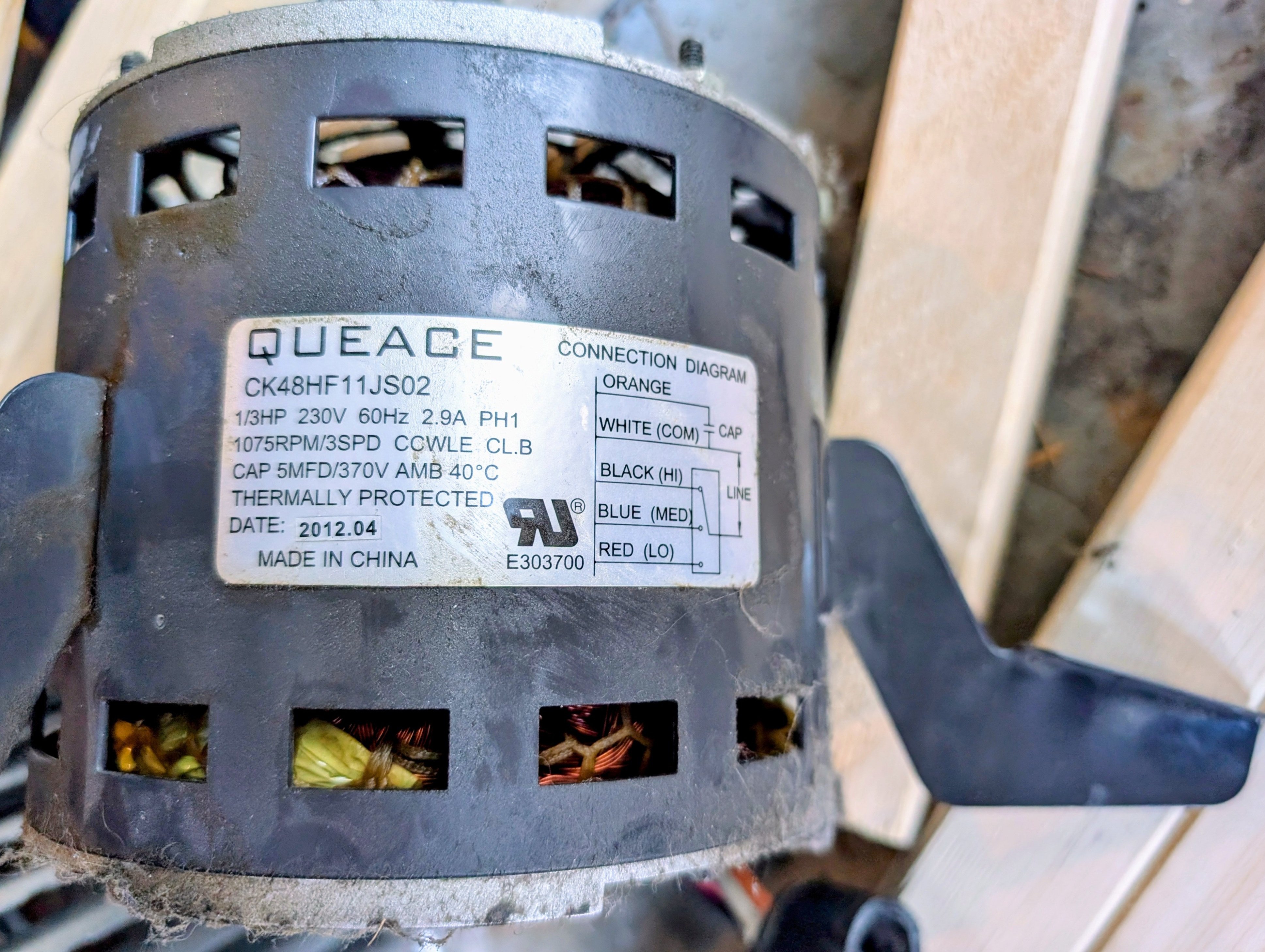

And here is the tag for the motor which has a 1/2" diameter shaft.
So I need a suitable replacement motor and capacitor. If more info is needed please let me know.
Not going to replace the fan. Worst case it makes a bunch of noise and I have to do an R&R. Less than a couple of hours max with my newly found skills and tools.

So if I order EM3586 motor and FM55 bracket will my new capacitor work? Or do I need a different one?
the cap size is listed on the motor. It MUST be the right size.

The century motor page list it as 5 mfd 370v so that 5mfd 440 v cap will work.
as long as it’s the proper MF for the motor.
