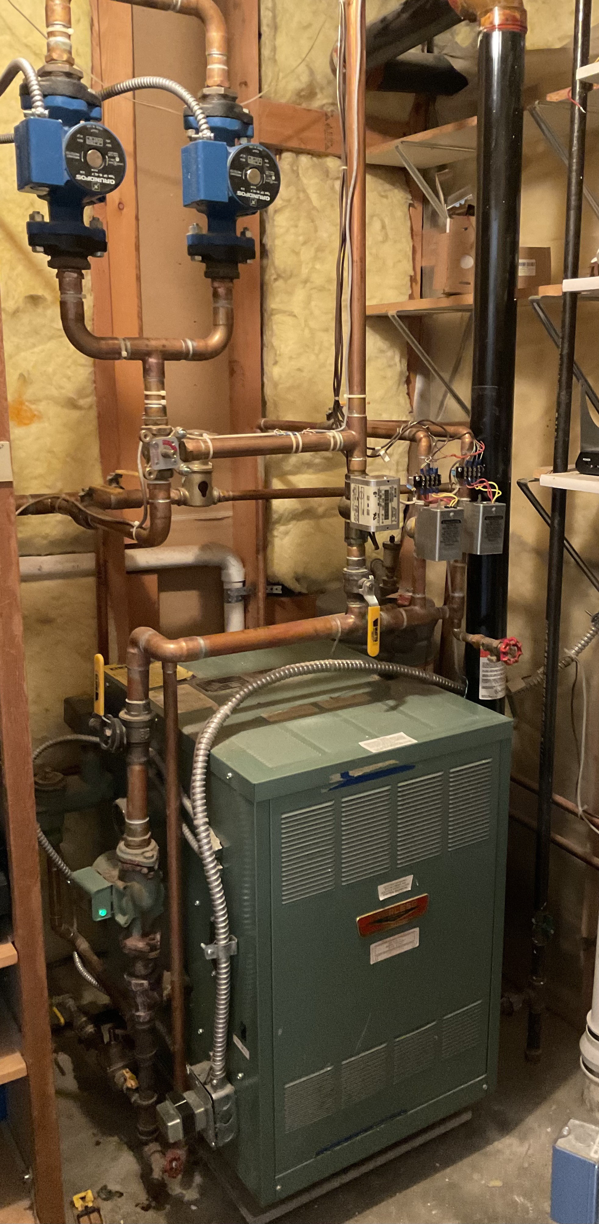

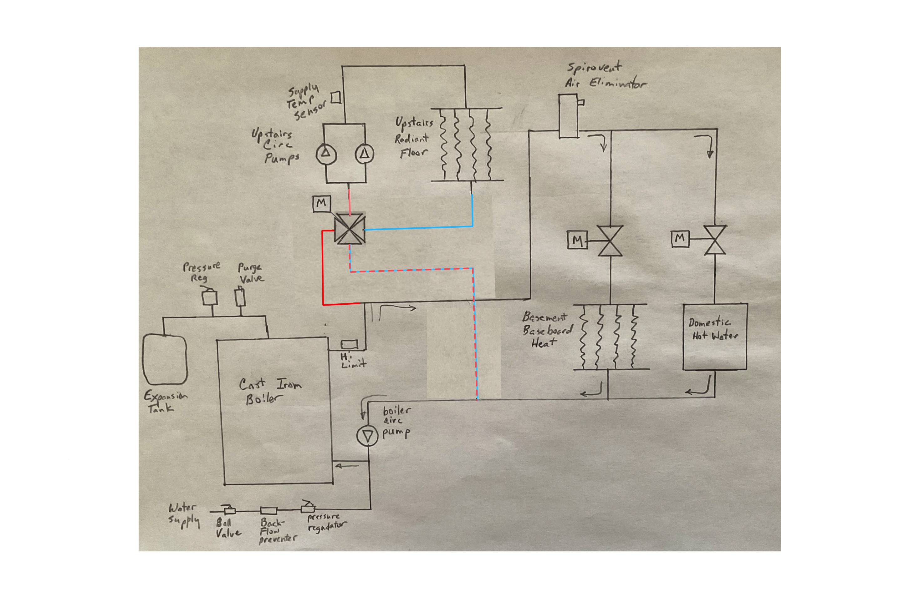

My house was built in 1993, we purchased it in 1996 (30 years ago). We have 3 heating loops: radiant floor heat upstairs, baseboard heat downstairs and a domestic hot water tank. Heated water is supplied by a cast iron boiler. We have been very happy with our system and it has been operating fine. My understanding of this system has slowly increased over the years.
We need to supply fully heated water (~160F) for our basement baseboard heaters and the domestic water heater, but we’d like the water temperature of our upstairs loop to be lower (~140F or lower) since we have hardwood floors upstairs. Our upstairs radiant floor heating is controlled by a Danfoss ECL9304.
My question: is the 3-way valve the proper valve to be used in this system? When the upstairs radiant floor is in steady state and doesn’t have much need for makeup heat from the boiler (and there is no call for heat from the basement baseboard loop or the domestic hot water loop), the 3 way valve is adjusted to the point where the water from the boiler is nearly shut off—most of the circulating water comes from the upstairs return branch. My belief is that this causes undue pressure inside the boiler because the boiler circulation pump is on the return side, pushing water through the boiler.
It seems that a 4-way valve would be much preferred here—it would allow two loops to operate independently—the upstairs circulation pumps would supply heat to the upstairs radiant floor and the boiler circulation pump would run water through the boiler. The amount of mixing would be adjustable and no high pressure would be present.
I really don’t want to tear into this system to make any unnecessary modifications. It’s been working just fine the way it is, but I worry about decreasing the life of the system or increasing the probability of a leak in the boiler operating it this way. But maybe this is a normal design. I’d appreciate the advice from the experts on this forum.
Photo and schematic supplied below. I’ve removed the Danfoss motor from the 3-way valve in the photo.

    Assuming that your diagram is correct — and why shouldn't it be?! — the only thing amiss at all is that the expansion tank should really be on the inlet line to the boiler circulation pump as should the connection with the backflow preventer and all that. But — the way it is is OK. As to the pressure in the boiler — that's controlled in your setup by the expansion tank, and what happens when the boiler circulating pump runs is that the pump REDUCES the pressure on its inlet side which PULLS the water through the rest of the system and eventually out of the boiler!

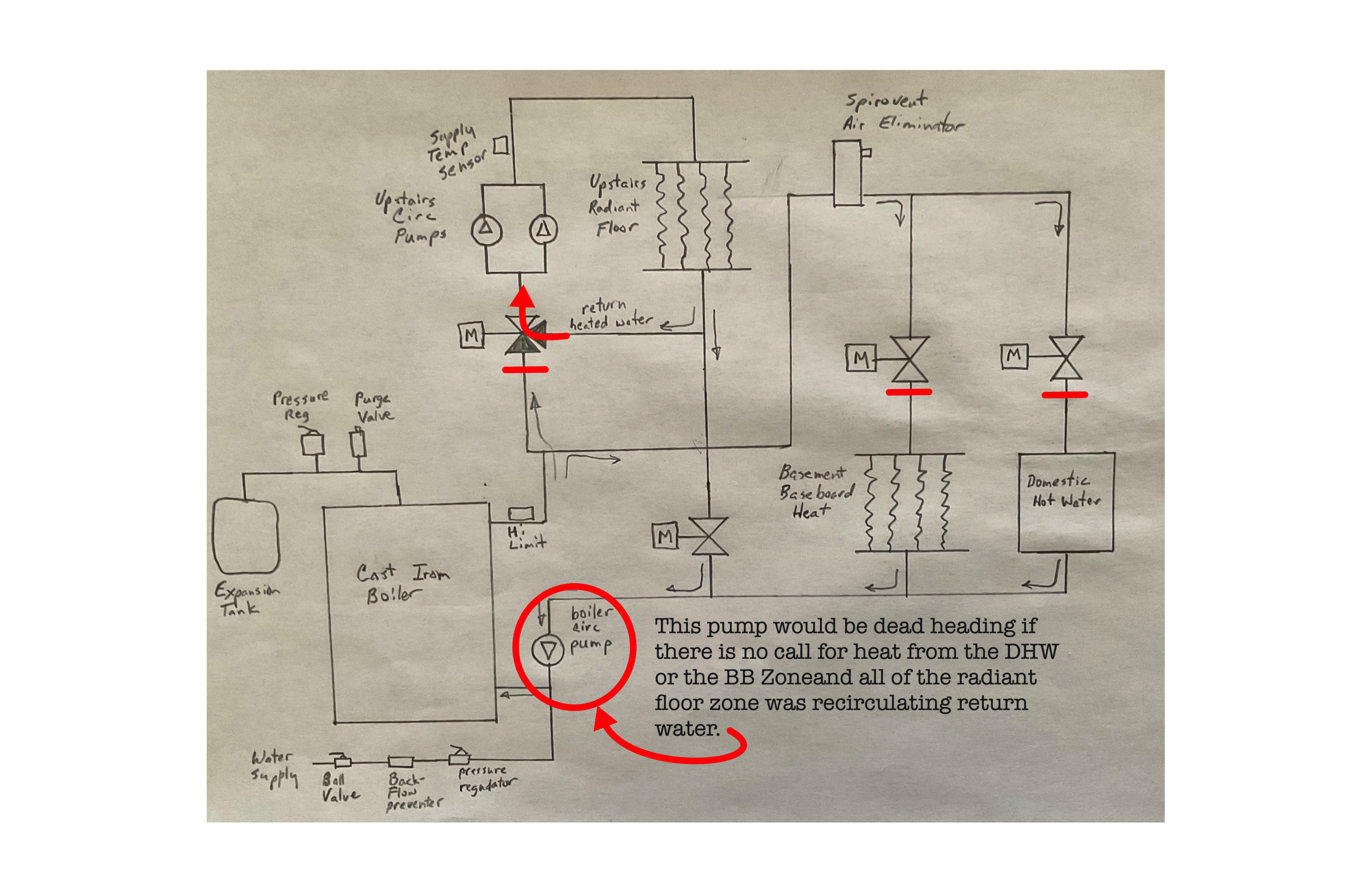

    I see your point on this if all the red lines were closed valves.
    The thing is… that does not happen very often if at all. the return water from the radiant loop will always be lower that the water coming out of the mixed port of the three way valve. That means that there will always be some hot boiler water being added. So the 3 way will always have some small flow thru the boiler in order to keep the boiler circulator from dead heading. If you were experiencing this problem, you would have been replacing that boiler circulator on a regular basis over the last 30 years.

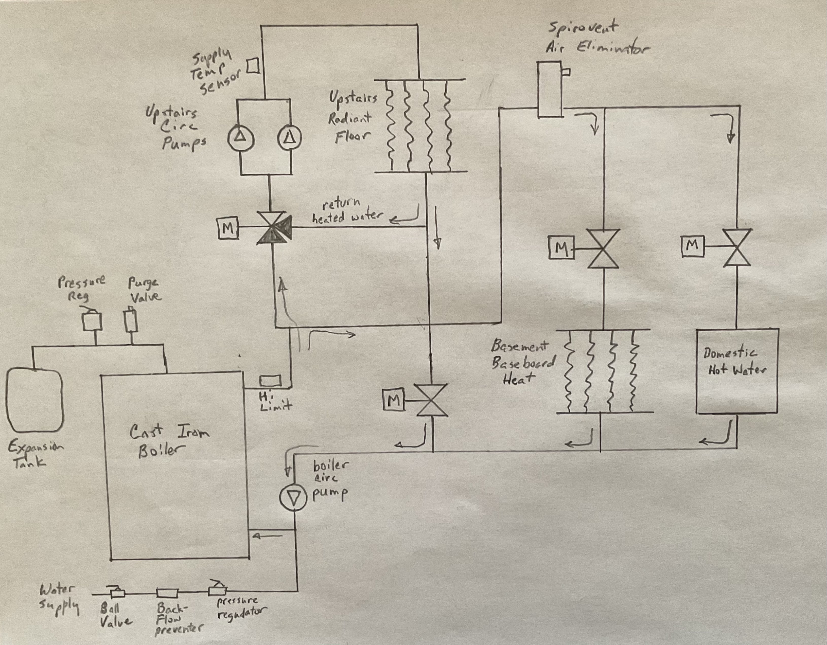

    It's not quite a primary secondary piping which would be the best way to pipe a two temperature system.

    I wonder if this arrangement would be acceptable Bob @hot_rod?
    The zone valve for the radiant floor zone is not necessary. Save if for a future repair on the other two zones. A 4 way valve will allow the boiler pump to keep pumping a non restricted amount of water when the radiant zone is mostly recirculating return water from the floor loops. The same motor can be used for the 4 way valve if you can find the 4 way valve that uses that motor. This might be the lowest cost, easiest repipe available for you, if you feel the need to make that change after 30 years of operation.

    If anything, I would rather see you pipe it P/S. Then you could keep using that mix valve.
    Just converting to a 4 way give you a path back to the boiler, but puts the boiler pump in series with the radiant pumps when the high temp loads are off.
    As Ed mentioned if it has worked well for 30 years, is it worth the $$ Repipe and upgrade when that boiler gives up. Unless is has other issues? I suspect the boiler short cycles when 1 or two zones are on, so efficiency may be in the 70% range?

    Bob, the Primary/Secondary Piping looks interesting. From your sketch it looks like I’d need a new pump on the high temp circuit.
