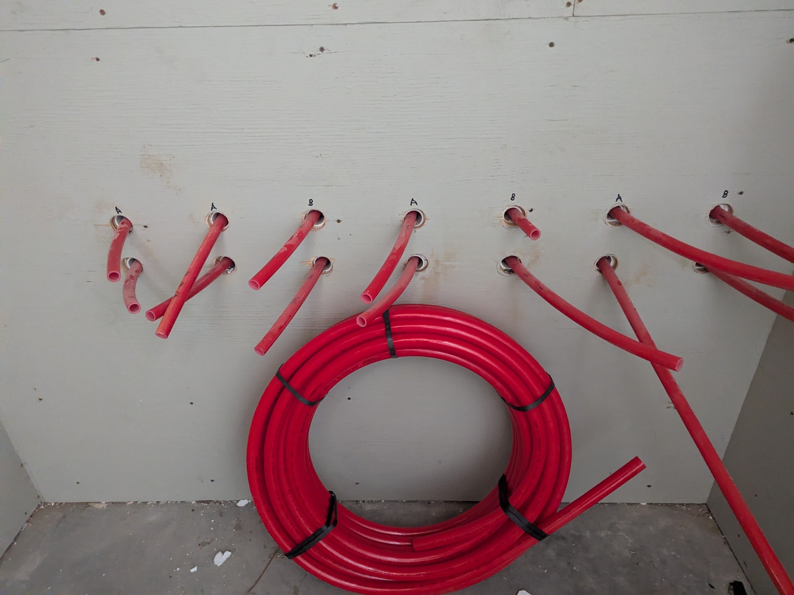

    I have two sets of loops that can be operated together or alternately, 3/4" PEX
    3x500' ~2.5 Tons
    4x500' ~3.3 Tons
    These are home runs to the equipment room, connecting to 1" manifolds with individual valving.
    I can give it any multiple of 500' of loop.
    The loops are -3' to +3' as referenced to the equipment room floor. Pretty flat situation.
    With the individual valves we should be able to burp it loop by loop easily.

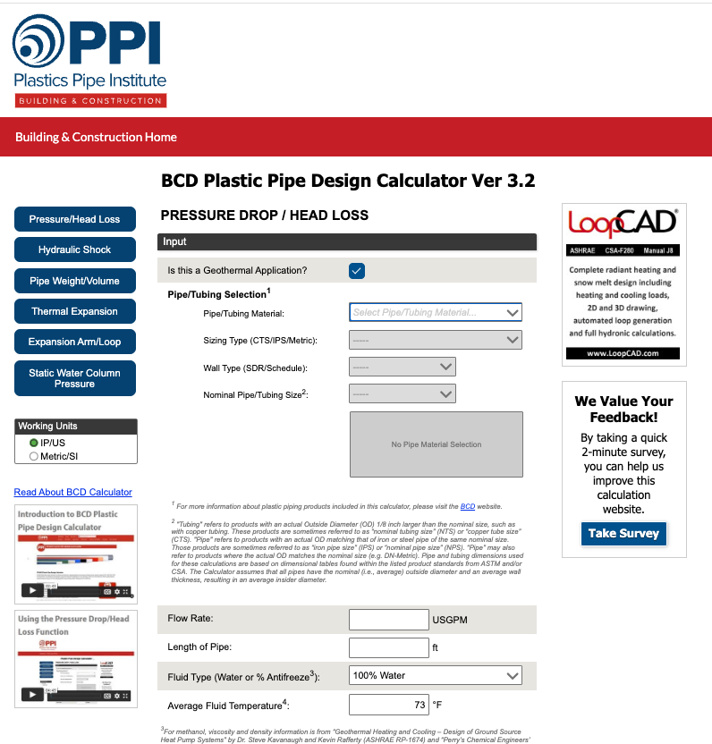

    Here is a pressure drop calculator for plastic tube of all sorts. Enter all the info. Type of tube, size, length, fluid, temperature and gpm. This give you the pump head for the loop field. Generally you need 2-3 gpm per loop. Just guessing 500' per ton of horizontal loop.
    A GEO system should be calculated to the location, soil type, equipment requirement, load size, etc. There are software programs to do this.
    Somewhere you need the info for the HP flow requirement, and related pressure drop. That needs to come from the manufacturer.
    It sounds like you are just spitballing the design? :)

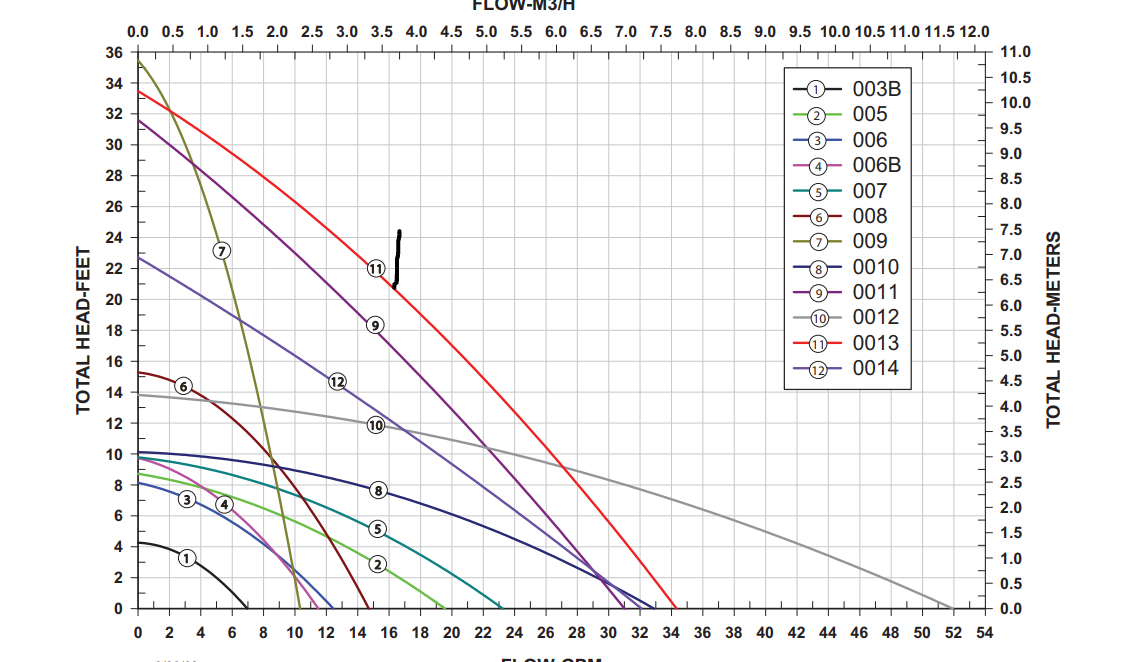

    So you need the flow info and then calculate the pressure drop in the loop field, the piping from the manifold to the HP and the pressure drop of the HX in the unit. That pump is generally a 240V, operated from the HP control, as you suggested.
    I doubt an 007 will be even close to the pump you need.
    Look at typical GEO pump modules here, they start at Grundfos , generally 240V pumps to wire to the HP 26-99

    I registered at Geo-flo and used a single unit calculator, and got 21.3 Ft of total head at a nominal 10 GPM on
    all 7 loops.
    The Taco 013 charts at ~16GPM at that head.
    The Taco 012 looks like it could do the trick too.
    I was WAAY out in the weeds with the Taco 007, thank you!

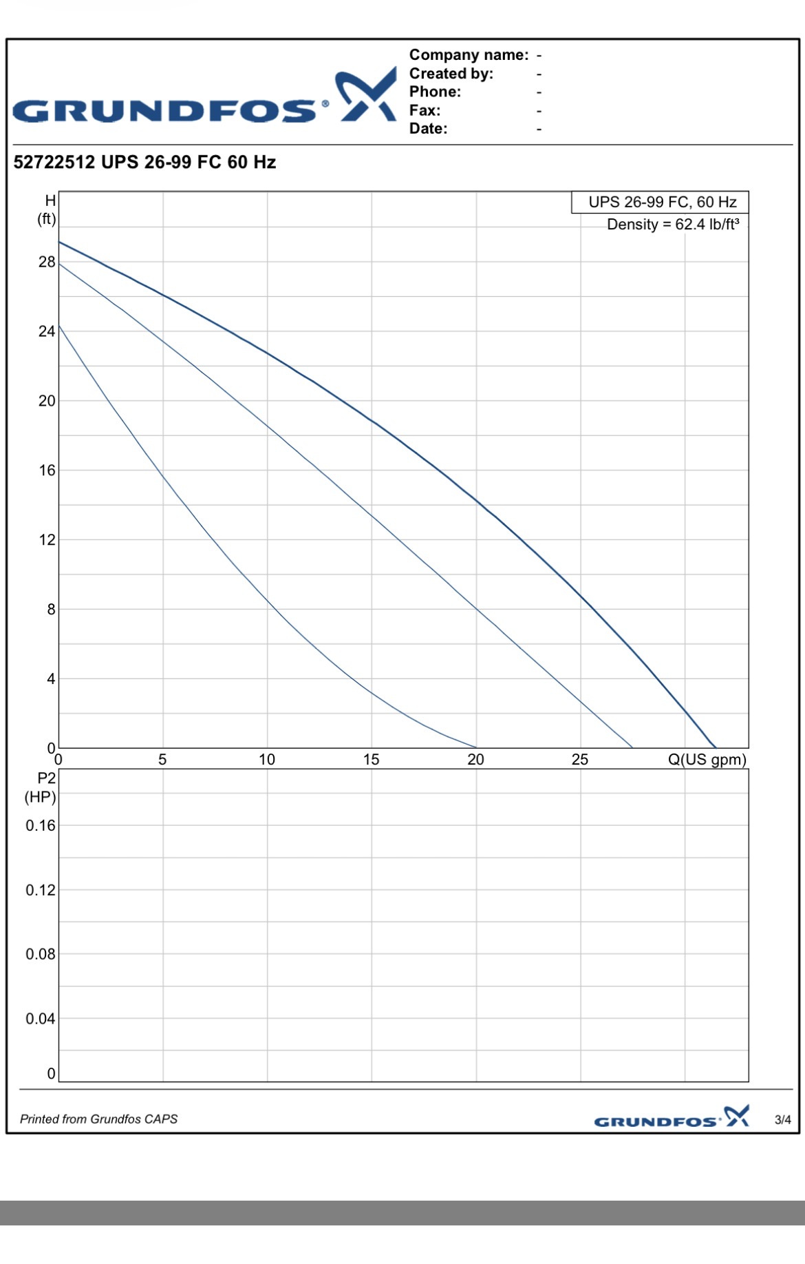

    hot_rod Posts: 28,769
    again, just a WAG, 4 loops for 4 ton@ 2.25 gpm per ton= 9 gpm.
    I would go with a Grundfos 26-99
    With 3 speeds you have some adjustability
    Speed 2 at 9 gpm you have 18’ head

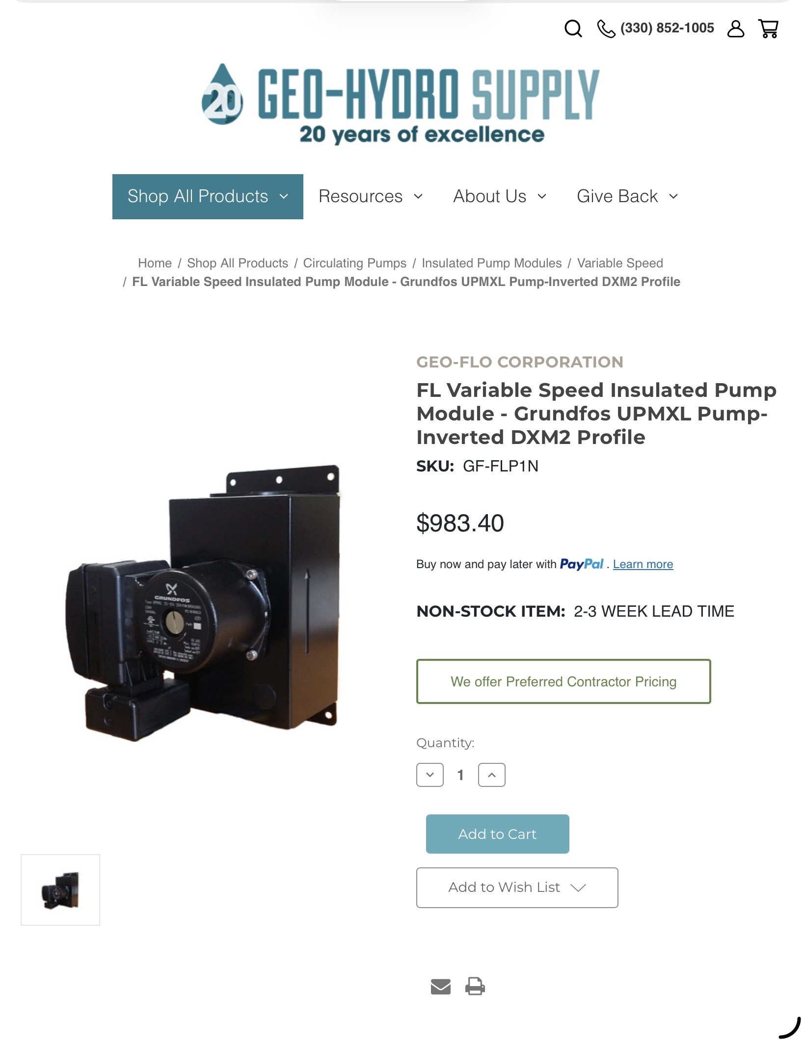

    Is it a two stage HP? That would be another reason to use a Flow Center that modulates with the compressor as that video explains.
    This kit is for GEO hp systems that do not include the control, a plug and play unit.
    I think if you price these components separately this price my not be out of line.

    I am ordering a version of the 26-99 that Bob posted above. We did some head scratching on my loop headers too.

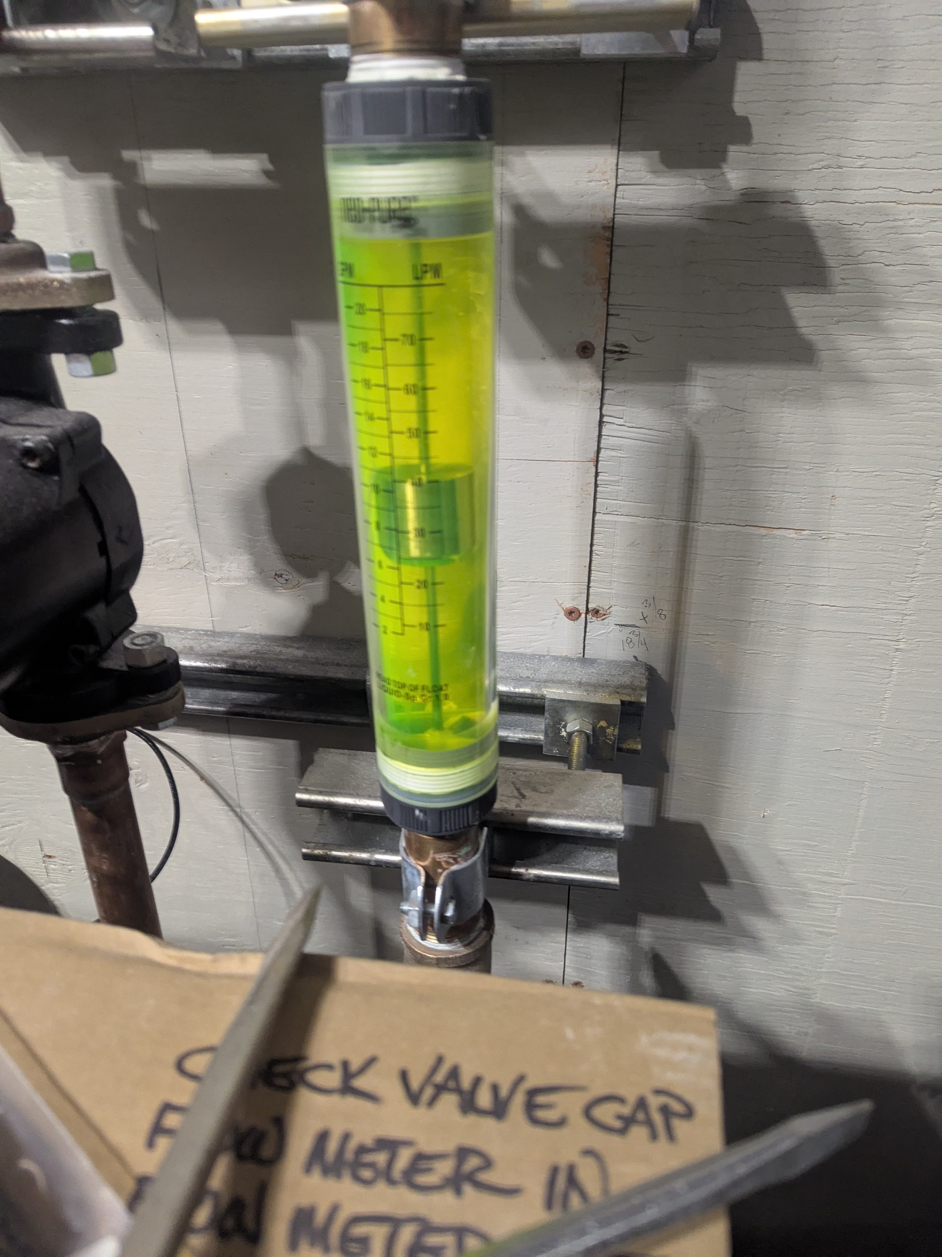

    Real world performance:
    All 7 loops with pump on high = 10+ GPM
    4 loops = 8 + GPM
    3 loops = 7+ GPM

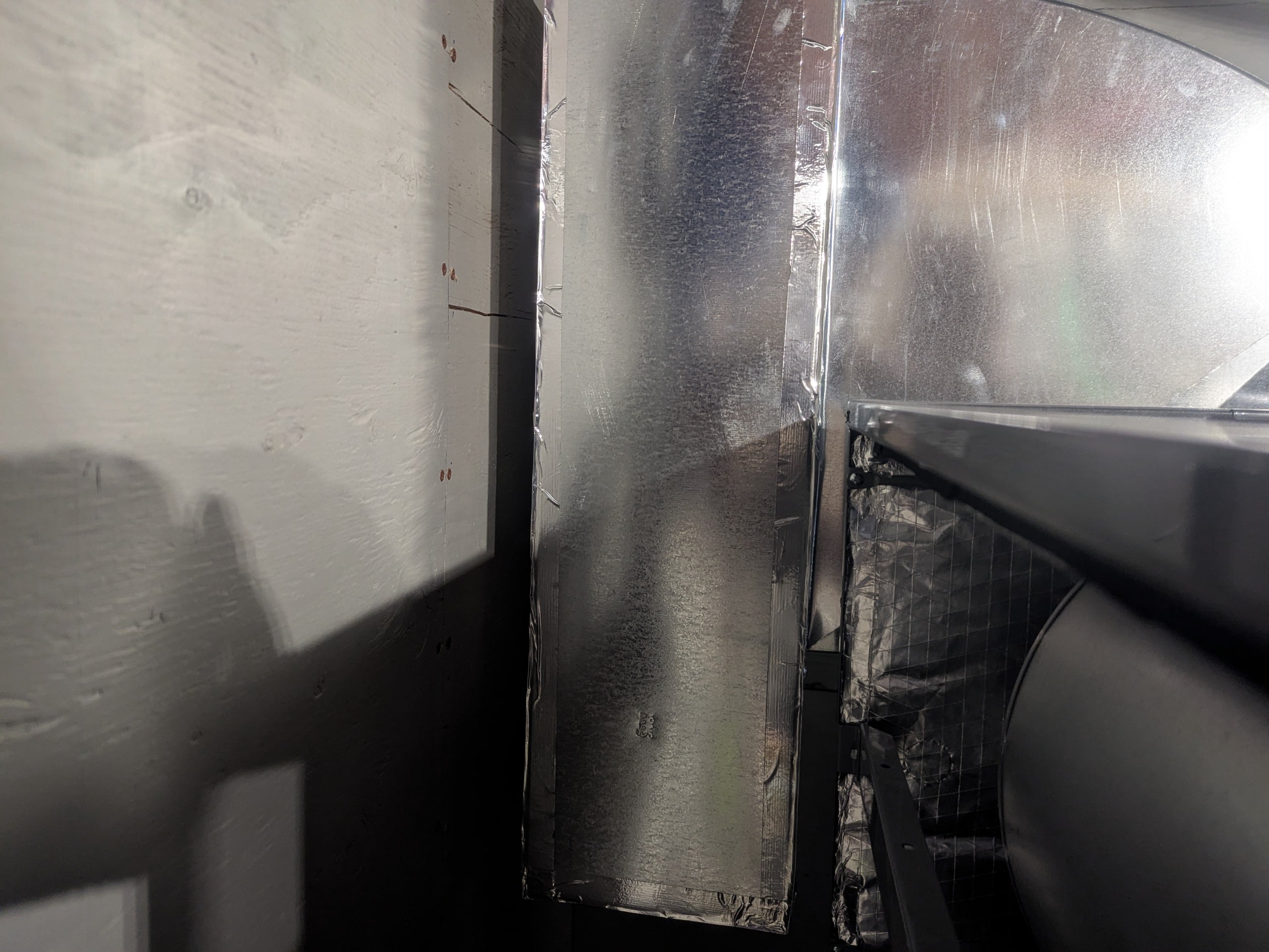

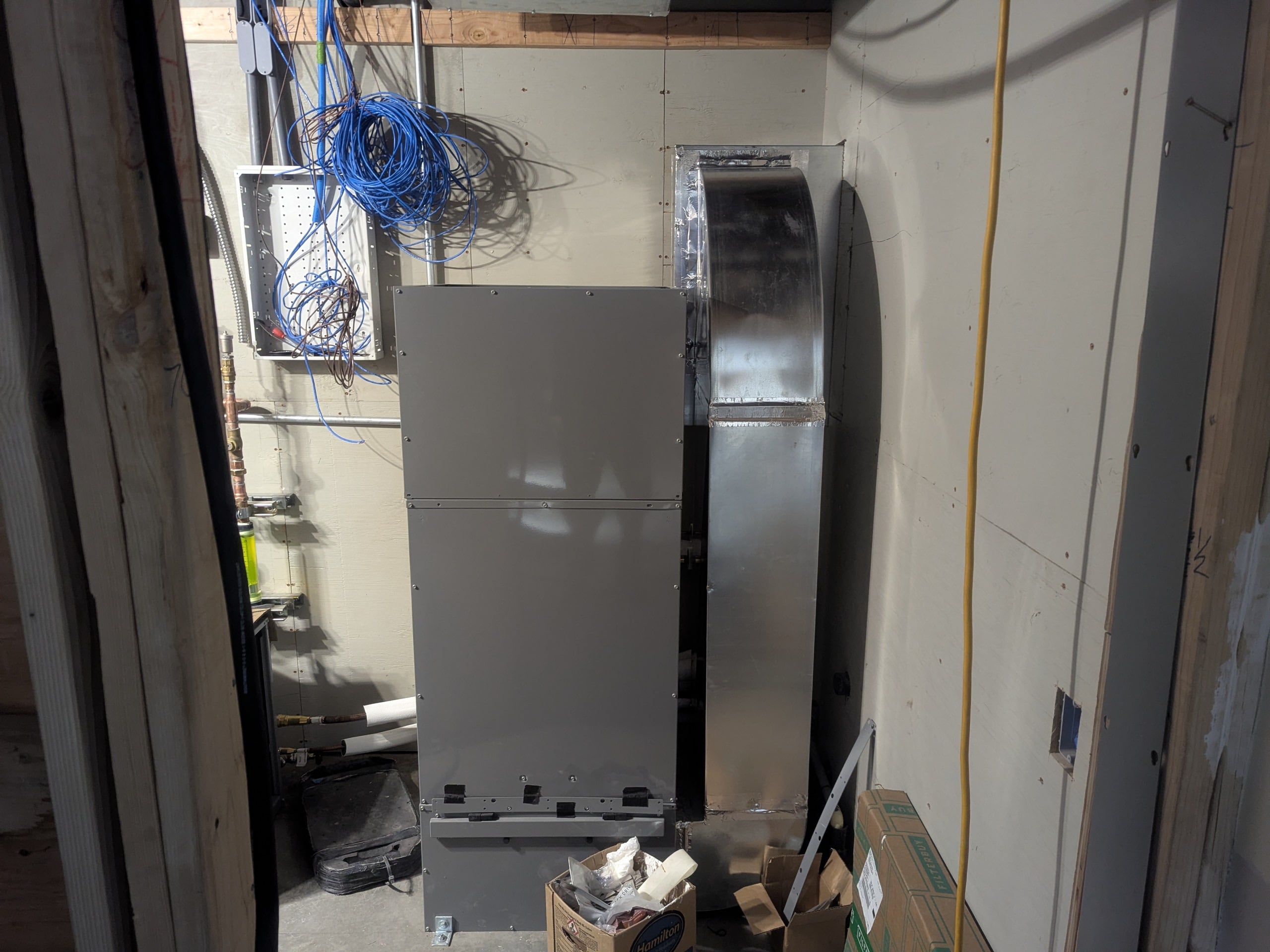

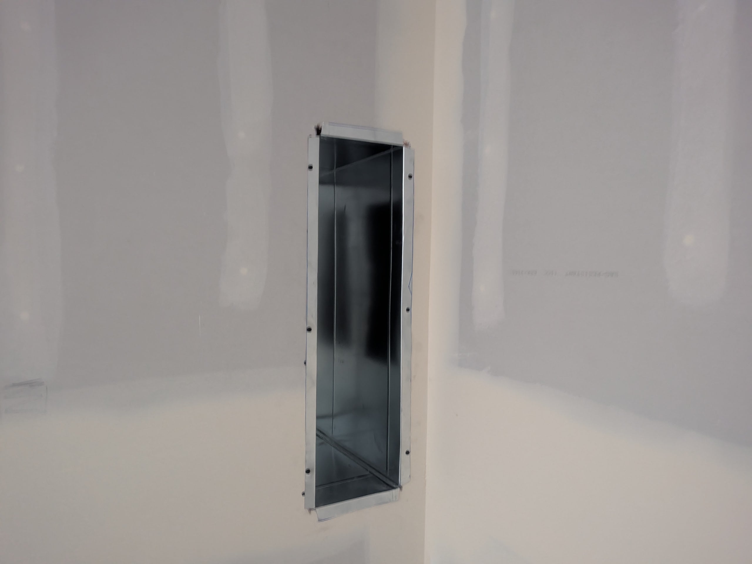

    We stacked the air handler up, installed the return air and I started working the wiring.
    Return air outlet was 10x20. I got a short way bend, a long way, and chunk of duct, and an 8x30 to penetrate the bearing wall.
    We brought the condensate out to the right edge it is hiding there in the shadows but easy enough to pour a glass of water in.
    Not a lot of working room, once I observed the 36" electrical code on the panelboards.
    Flanged the 8x30 to the outside wall and I may put a pair of 16x20 cheap filters out there in a site build adapter. The inline one is an oddball 22x22x1 and if I can I may use that pair of MERV 5 to catch the bulk of the stuff.
    My limited understanding is you want a couple of bends on a return air like that for noise. The short and long way and that short section is what I will start with.

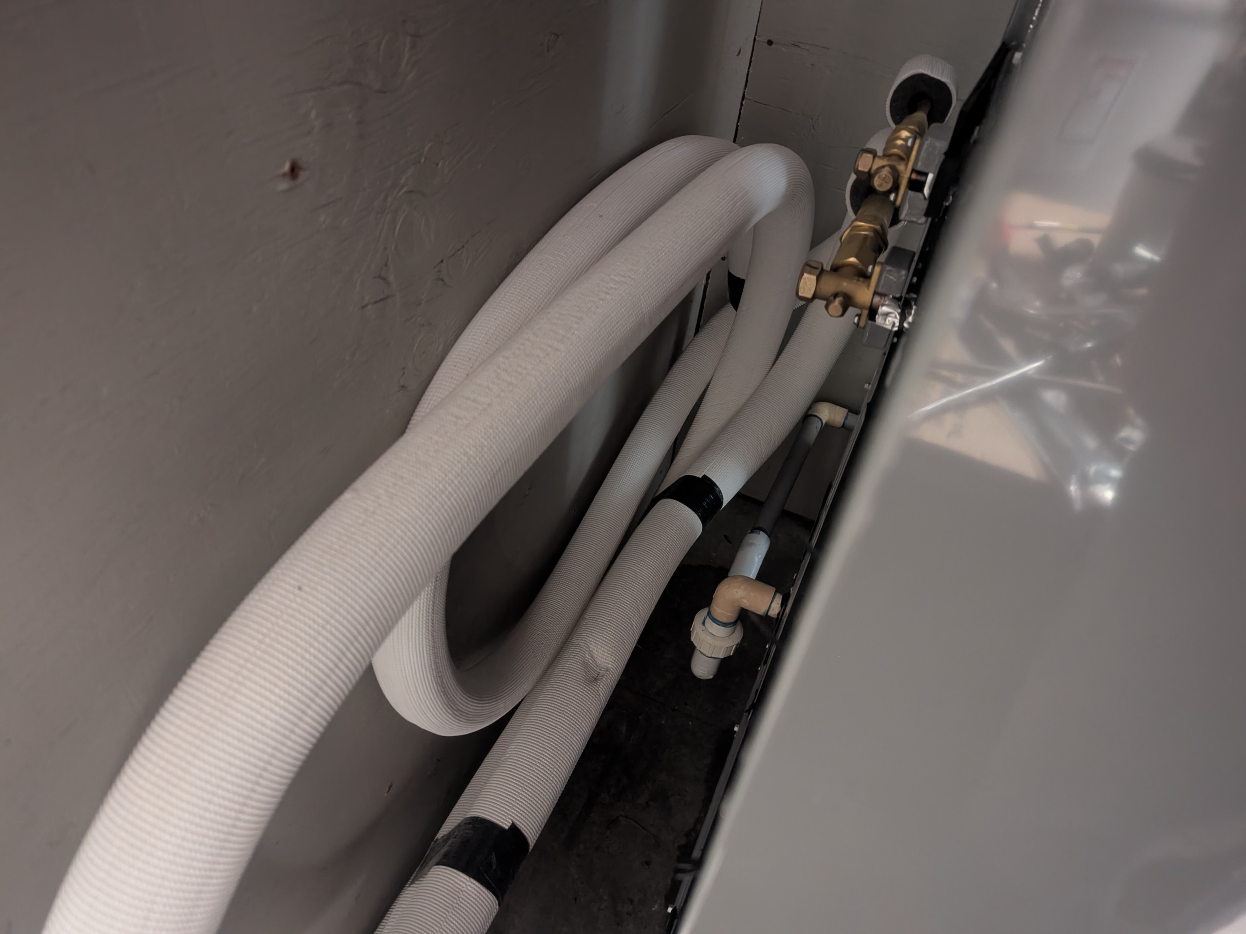

    Plumber formed the lineset better than I could.
  • GGross
    GGross Posts: 2,105
    is the lineset photo sideways or did they really coil the lineset vertically?
  • skyking1
    skyking1 Posts: 164
    edited April 1
    That is the space available, about 9" between wall and units.
    If you have some 4th dimension available feel free to use it. :)

    It is a ups26-99f

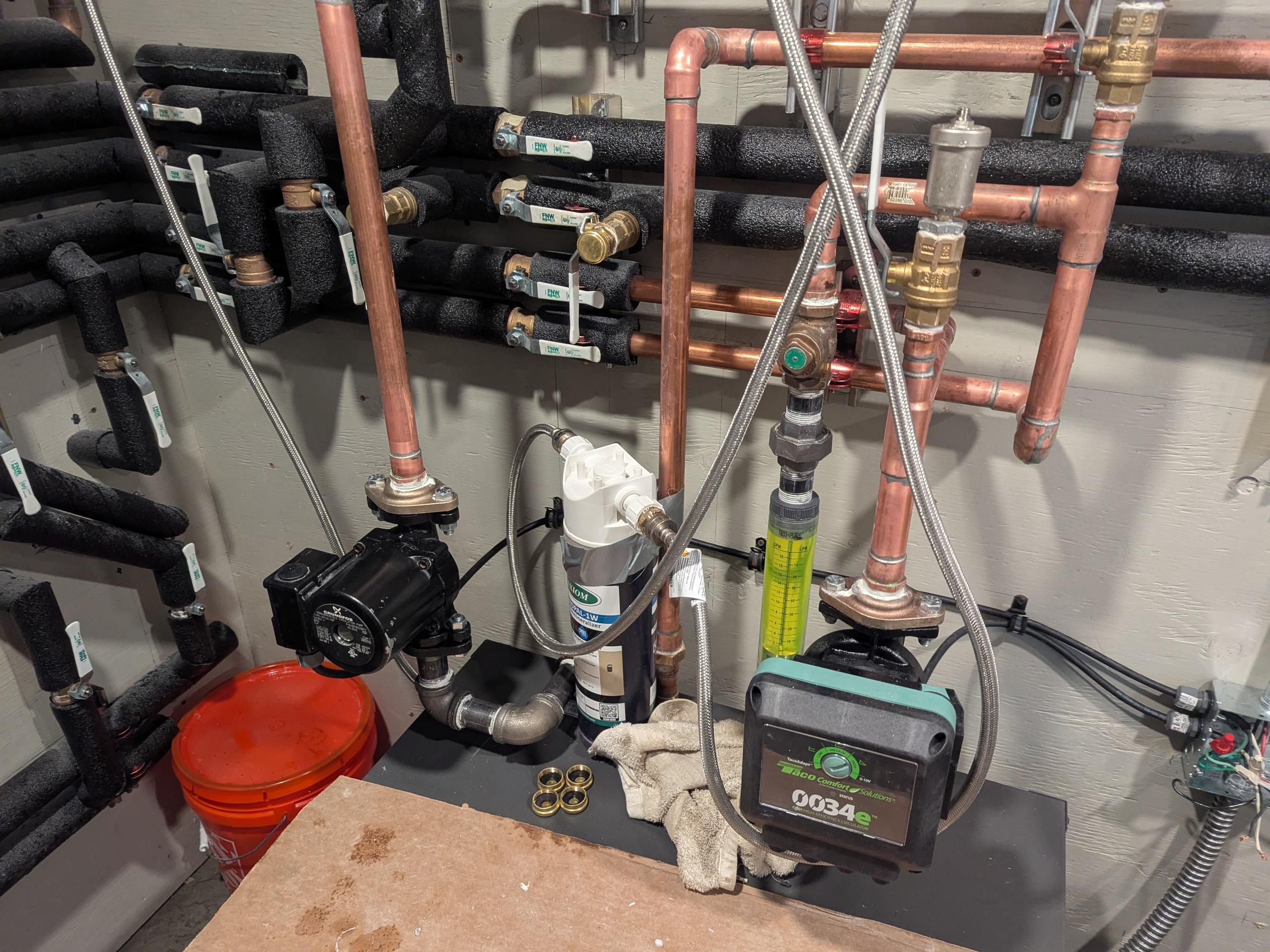

    skyking1 Posts: 164
    I am buying two more pumps today, and working from the observed performance of the Grundfos 26-99, we are going with the Taco 0034E -f2. The 0026E is a little light on maximum head by our estimation.
    We figured out the 15-58 Alpha was a little light for the hydronics, but that 26-99 may be just right.
    So the 26-99 moves to hydronics, both heat pumps get the Taco 0034e for loop pumps, and that 15-58 Alpha would do the pump-to-buffer nicely if we add a buffer tank. We are going to give no-buffer and ODR a really good try though.
    If not I will find it a home.
    The hydronic heat pump has a PWM out on both inside and outside pumps that is an option. Of course the 26-99 is just the 3 speeds but that Taco could either use the PWM or I could build a 10VDC control for it.
    Fun stuff and thanks for all the help along the way.

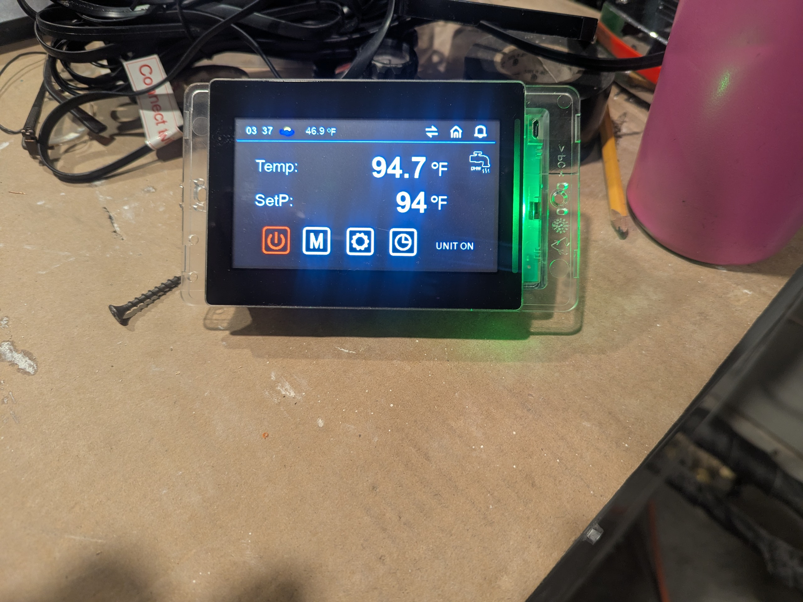

    The unit has arrived and has the outdoor sensor included for ODR. Can't wait to get it going.
    It has a carel controller with a PGDX touchscreen that I can extend to the main floor near the HVAC thermostat.
    The ODR is rudimentary (IMO) with only 4 data points to set on the curve. I plan on a summer and a winter curve to get some better control.
    I have a HPWH and the plan is to try and run this buffer-less. if that does not work, I may spring for a triangle tube tank for the buffer with a domestic preheat loop in it. This will run in some form for maybe 9 months of the year.

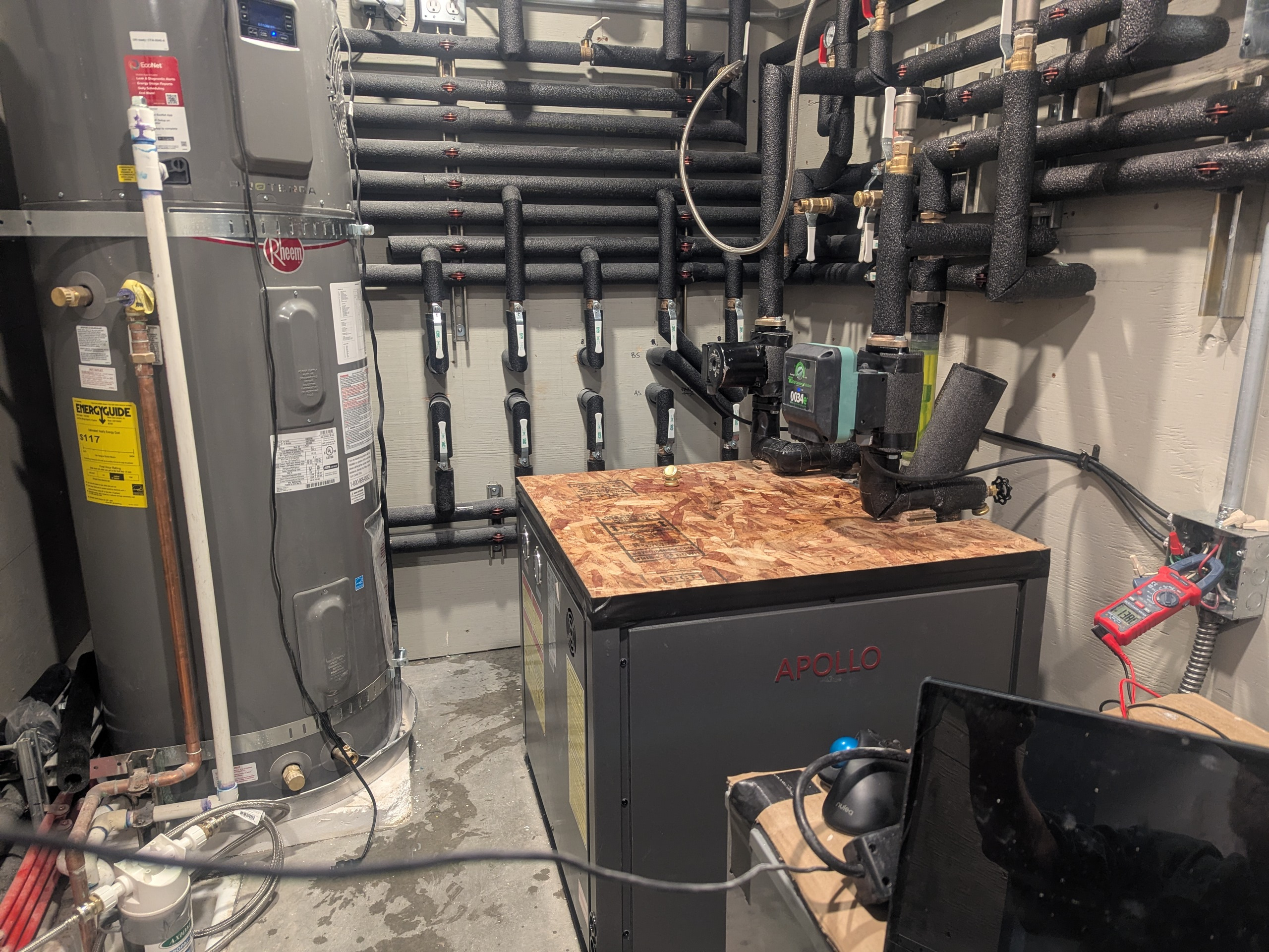

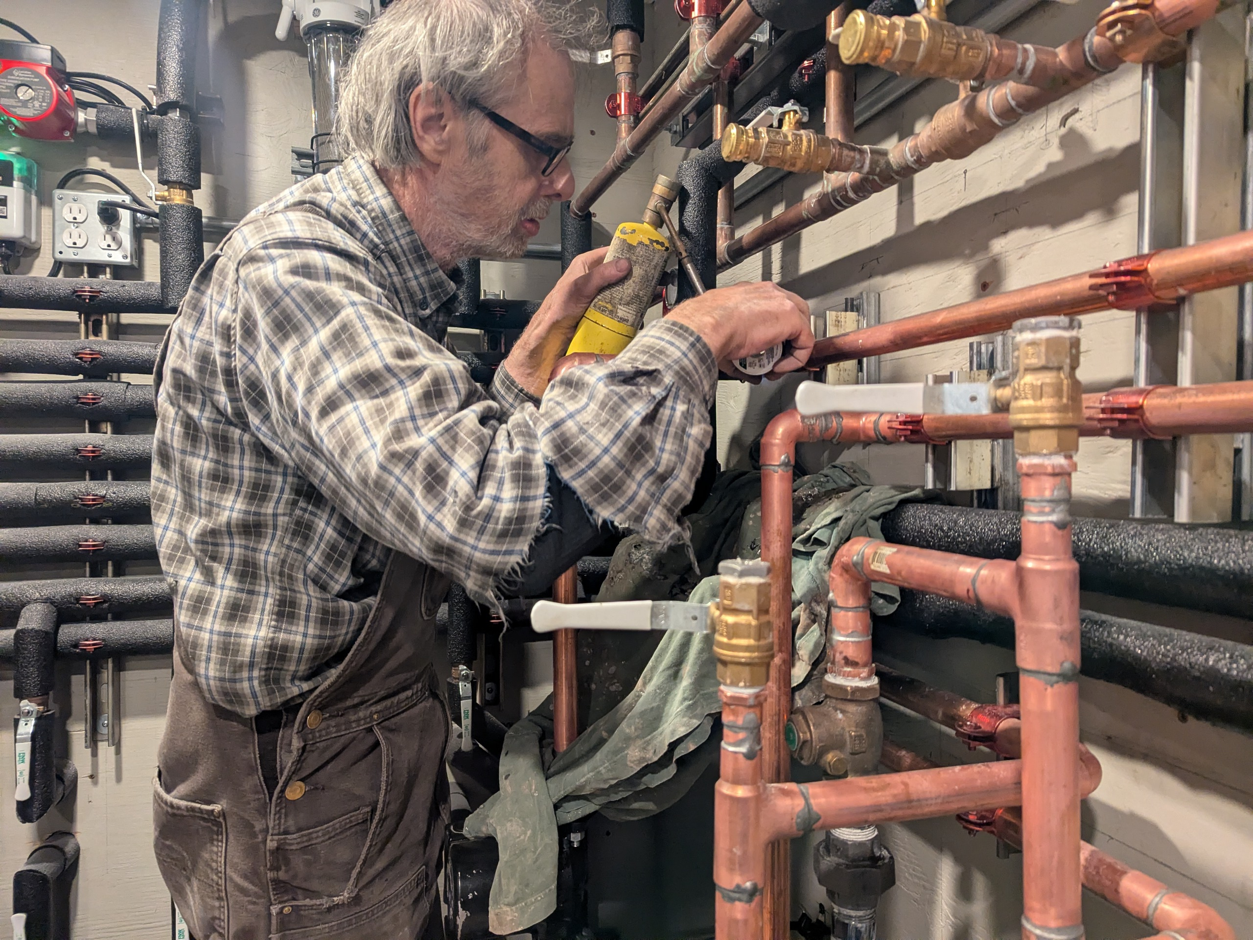

    Mark was soldering and I was wiring, and we got it done. I have been flushing the loops through the puropal all afternoon and I just got the system going for the first time.
    I have the inside grundfos on medium, and gave it the whole house.
    The Taco 0034e was a good choice. Where the 26-99 topped out at 10.5GPM, the Taco is at 12.5 GPM with all 7 ground loops.
    The two pumps are 1.3A total as run. They run off the heat pump bus directly, and the gross amps has ramped up to 13 in the first 15 minutes.
    I started with an SWT of 105 to see how that goes.
    PC7060
  • skyking1
    skyking1 Posts: 164
    Thanks to all of you helping this newbie.
    It was not going well. It would lean into the load and after a few minutes it would just spool down to 2/3rds power, while no where near the commanded SWT.
    Not gaining worth a crap and I was questioning my life decisions. Did I make a huge error?
    Then my brain turned on. I had opened the loops for that one by one flushing.
    I turned off the slab loops and then went to dial the other 20 3/8" down to the command range of the adjusters.
    The HP was quite sensitive to the load side flows.

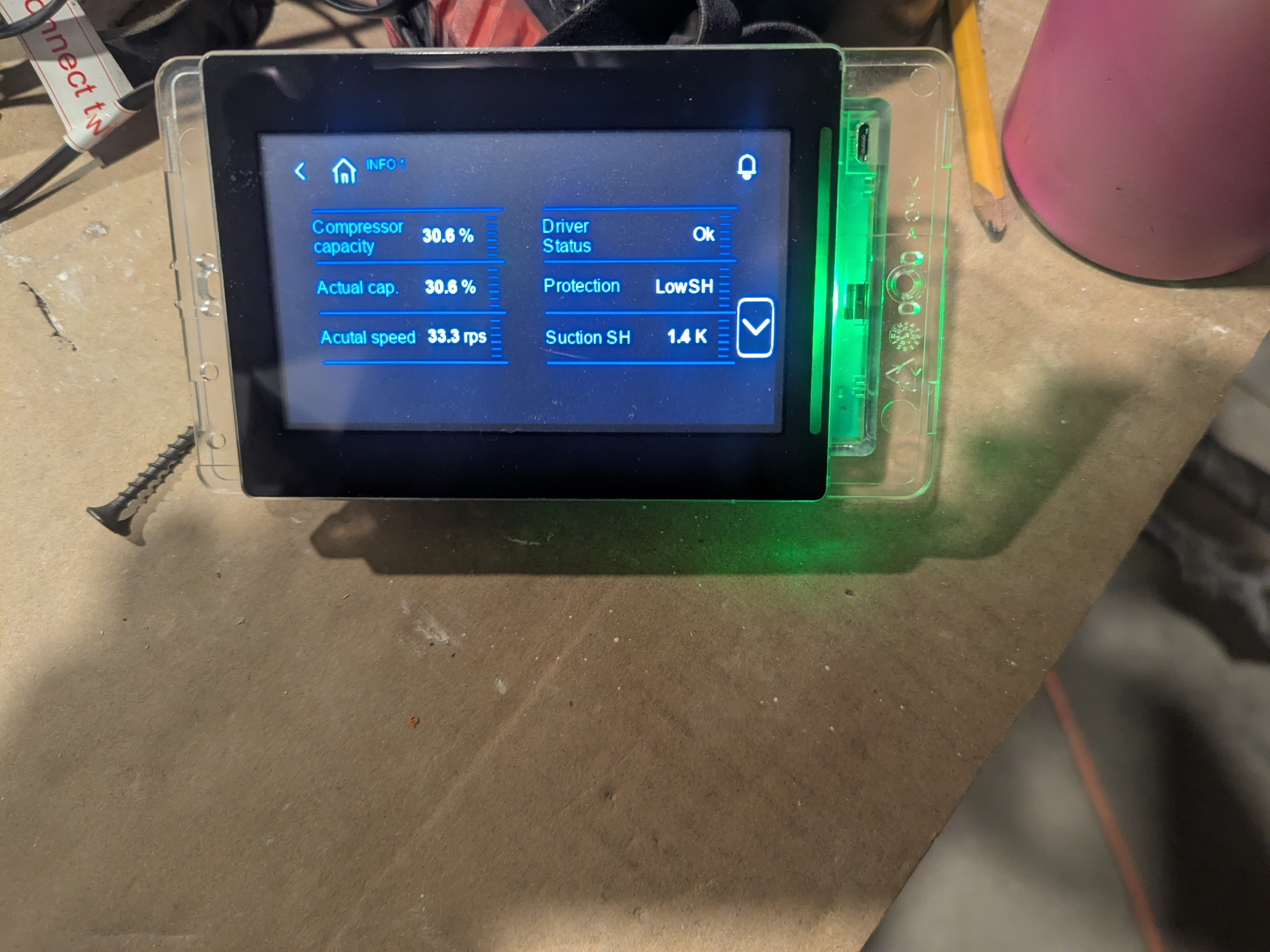

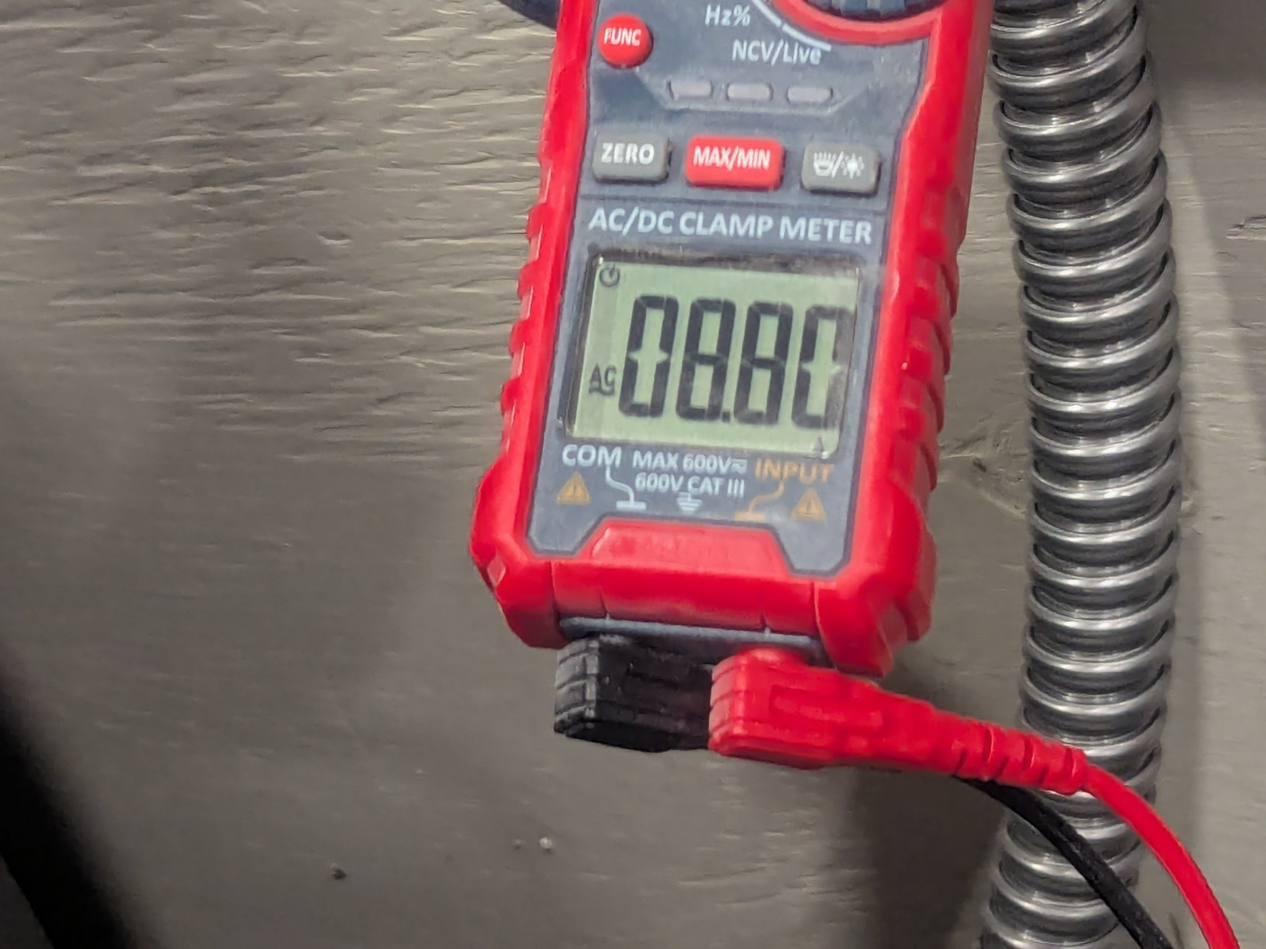

    When it got into the flow sweet spot, it really leaned into the load, ramping up to 16 amps and the SWT was heading up nicely.
    Then it got there and cycled off. Not what I was looking for.
    I dug into the settings and it had a hard zero at the upper limit. i changed it to 2 degrees and the magic happened.
    This time it cruised up to 94.9, only 0.9 above the new setpoint. Then it did the inverter thing and dialed back smoothly. It took 10 minutes to get back to 94, and the amps got down below 8. It was smooth and quiet.
    At only 0.3 below it smoothly came up to about 8 amps and no drama. I was beat by then and did not hang around to see how it hunted because it seemed pretty good.
    I extended the outside sensor on a spare pair in my RS485 run for the outside meter provided with my hybrid inverter. Waste not want not.
    It is on the bottom of the house outside disconnect in good shade, works fine.
    I went up and gunned the floor. it was consistent at 70 almost everywhere with one cool loop at 68 and a warm spot at 74.
    The Taco was laboring and getting hot, and I realized it was good on medium speed. I have the 10v controls coming.
    This unit calls for 11 GPM. We will play with that.
    chunk of subfloor over the top.
    I can work with something that tracks from 40% to 100% smoothly. Those load numbers are deceptive. At full honk it was around 70% so you do some math.
