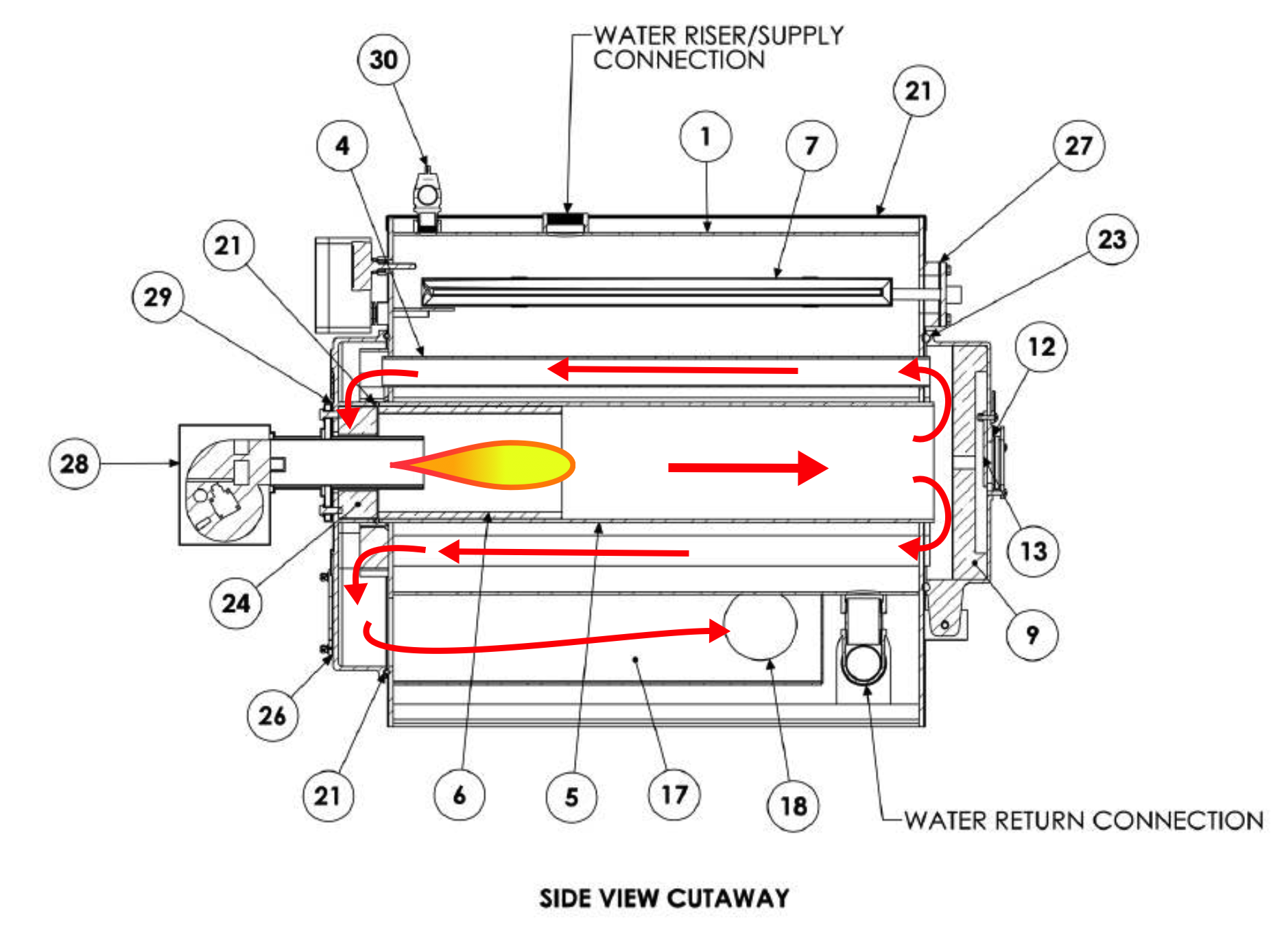

    EdTheHeaterMan Posts: 12,952
    Dynatherm Boiler is a positive pressure boiler that has fire tubes from the back of the boiler that run back to the front pan shape cover that the burner is welded on, the the flue gasses are directed under the boiler to the flue outlet near the opposite end of the boiler from the burner.
    That particular vibration is a combustion noise and is resonating that vibration thru the vent connector pipe.   A minor air adjustment will stop the noise.  A Professional needs to make that adjustment.   As long as you don't have soot from the seams of the vent pipe or lots of black smoke leaving the chimney top outside, you may be just fine waiting.
    Eventually that will turn to soot and will grow exponentially within just a few hours and you will need to shut the boiler down until those fire tubes are cleaned and the burner is serviced.  Lets just hope that does not happen until the owner returns home.

    @EdTheHeaterMan thank you for the info on the Dynatherm boiler. The diagram of all the points of connection look just like what I see on that boiler. I've been keeping an eye on things and I have not observed any black smoke out the chimney just "steam", condensing combustion gasses. It's an external block chimney and the boiler doesn't cycle long enough to get it warm the whole way up. It also had a domestic hot water coil in it but it failed (relief valve was leaking constantly, system pressure about 35psi) about five years ago and I capped it off and put an electric water heater in for him, he thought he was going to have the boiler replaced shortly back then but it's still here.
