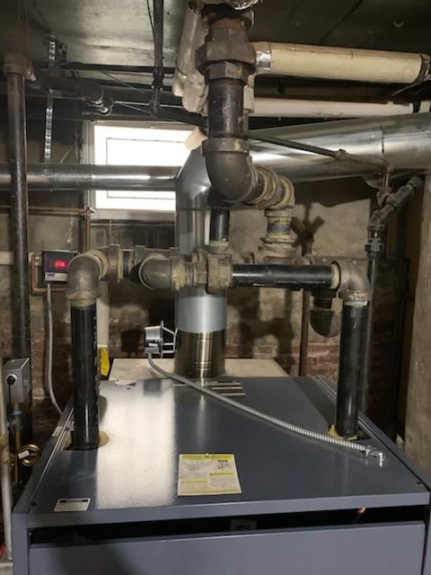

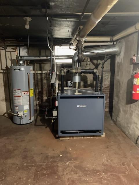

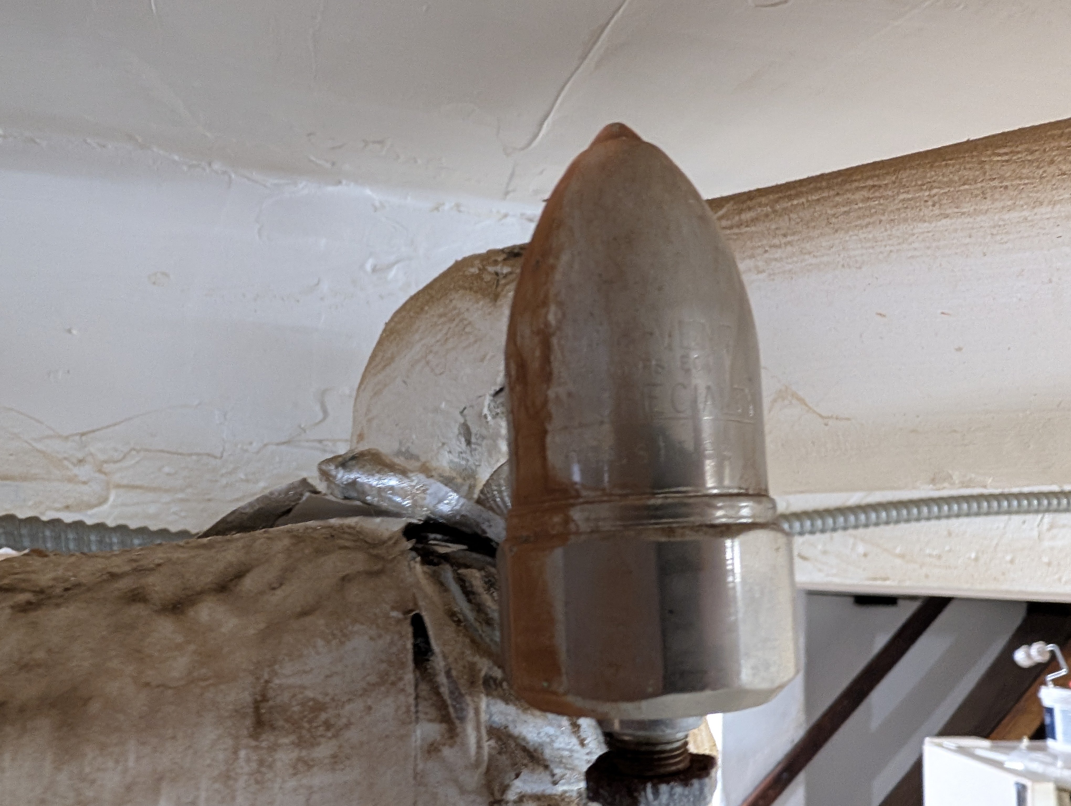

On the advice of forum members in response to my previous post regarding trying to balance the temperature between floors in my mother's 3 story circa 1900 Victorian house, I located the main vent that is hidden in a corner along the ceiling in the basement. The 4 year old system is single pipe, one zone steam.
From what have I researched, the installed valve is without a doubt, incorrect. After reading through many threads, I am amazed that the system has worked as well as it has for the 30+ years I believe that it has been installed for. Obviously, it now shows signs of failure.
I am going to replace it and the two most recommended options seem to be the Gorton # 2 and Jones "Big Mouth". Should I look for anything specific? Are either acceptable? It looks like I should just be able to unscrew the white elbow from the main and install the vertical vent.
Any idea what the current valve is rated for? What differences should I notice once the new one is installed - except for more even temperatures (hopefully)?
Thanks again!

    Don’t worry about the existing vent—it’s not enough.
    I don’t know the volume of your main but I greatly prefer the Gorton #2 to the Big Mouth.
    You may have top clearance issues regardless and that tapping location isn’t optimal on the side of the main

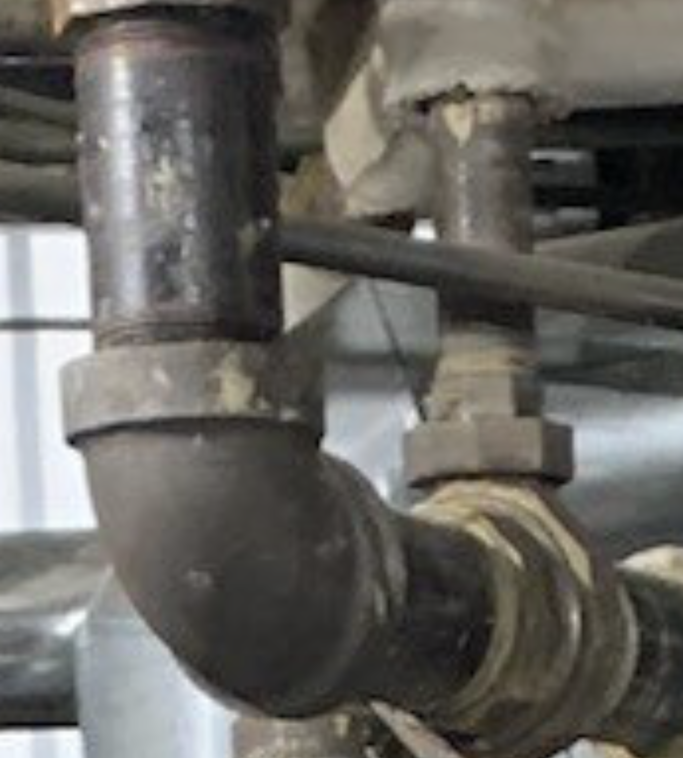

    Not in my opinion. I can't tell the sizes of your fittings there…it looks like it may be a 1/4" to a 1/8"…the Gorton #2 has a 1/2" male fitting on it so you might need some adaptation there.
    It's kind of difficult to tell the layout of your main there from the photos…is this area near an end-of-main drip to a wet return? Is that

    The vent is about 15 feet from the boiler where the main bends towards the front of the house. I attached a photo notating the main - that is not the location of the vent.

    So that vent currently is at the end of the main after the last radiator runout? The pipe continuing on in the photo after the drop is condensate return only going back to the boiler? Is this the only main or do you have two (looks like you have two…). IF there are two is there another vent somewhere? Would like to know what the total length and pipe size of the main/s being vented are. My apologies if you already posted more detail or other pictures in a previous post.
    I'd have your new vent right up nearly to the ceiling but I just wanted to verify from the sizing of the pipes whether a single vent is enough.

    The vent looks like something that someone installed as an afterthought rather than the original vent. It should have been on a 45 higher up on that elbow at the very least. I am still confused as to whether this vent is at the end of the main after all the radiator takeoffs or not. It doesn't look that way in the photo.
    It has writing on it, if you're interested. Maybe Hoffman Specialties? Probably has a model #. I know it is probably irrelevant because it may be undersized but it might be interesting to know.
    You say the boiler installation was done four years ago. It worked fine after that? It looks like they did a bullhead Tee new header that goes into an older header. That isn't proper, which is why I'm wondering.

    Steamhead Member Posts: 18,690
    Correct. It was installed by drilling and tapping the elbow. Someone will need to drill and re-tap it for 1/2" for the #2.
    @MikeC_3 , can you step back and take a pic of the piping around the vent?
    All Steamed Up, Inc.
    Oil & Gas Burner Service
    Consulting
  • MikeC_3
    MikeC_3 Member Posts: 77

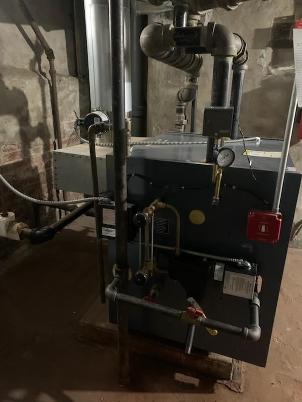

    @Steamhead A few more pictures:
  • Captain Who
    Captain Who Member Posts: 883
    Near boiler piping is not a bullhead tee, now that I see it better.

    I cleaned up the current vent on the main and it is a Hoffman #41. All the others on the radiators are Hoffman # 40's. I assume if I replace it with any larger straight vent, I should see an immediate improvement.
    Captain Who
  • KC_Jones
    KC_Jones Member Posts: 5,938
    That's not a main vent its a radiator, actually convector vent. If you change that to a Gorton #1 it will be almost 6x more venting.
