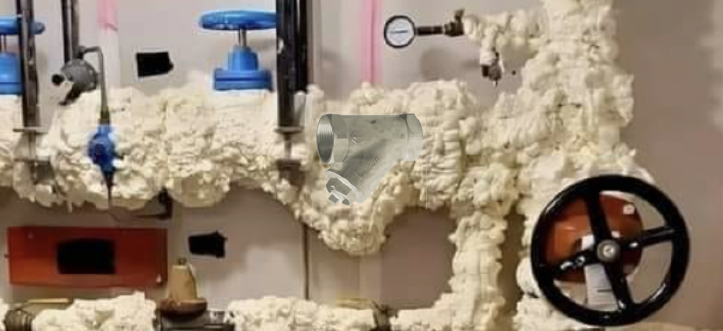

    look closely at this section… Could there be a Wye Strainer that will never get cleaned?

  • Those are testable backflow preventers! I would love to be called out to test those. That wye strainer is a check valve that is (no longer) repairable.

    All that piping and fittings must be the most expensive equipment for water in the whole building.
    And they cover it with foam?!?
    It hopefully passes only cold water and may sweat.
    Pre-slit foam or 1/2" FG could not cost that much considering what the BFP set up cost.

    Perhaps it's AI and not real.

    Could be, but that picture was here on the wall maybe 2 years ago.
