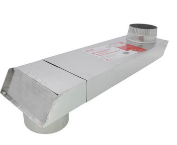

My washer and dryer are in a laundry closet in the kitchen. I am replacing both and have a challenge with fitting the new dryer. To put it simple, the duct comes into the closet vertically through the floor. A 4" adjustable elbow was used to go from the vertical outlet of the duct to the horizontal connection on the dryer. That takes up 4+ inches of the floor space. Between the wall and the back of the dryer.
The existing dryer is about 24 inches deep and the new one is 28 inches deep. I have only about 4 inches from the front of the dryer to the bifold doors. I may be able to trim the dryer end of the elbow to gain some space. In looking on the web, I found a "periscope" dryer vent on the Supply House web site.
https://www.supplyhouse.com/Lambro-Industries-3005-R-4-90-Degree-Aluminum-Dryer-Duct-Extends-18-to-30
I wonder if using it would give me more room instead of the existing elbow. It doesn't seem to help much if at all.
Another option is to use flex duct instead of the elbows to make the transition from the dryer to the horizontal duct in the basement directly below the dryer to the back of the house
I don't want to cut into the wall to run the elbows/duct, if it isn't absolutely required.
Suggestions, other than get the "boss" to buy a smaller dryer…

    Hi, Does the new dryer vent only out the back? Some are designed to be able to vent out the sides. That could give you some options. 😇

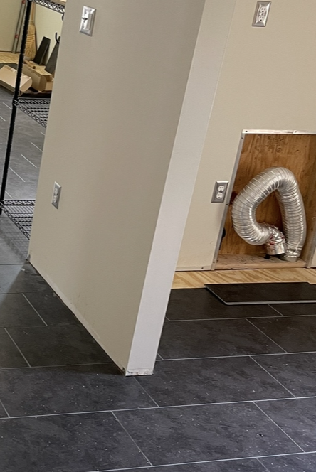

    Cut the wall and install a Dryerbox. The dryer will be able to go almost flush to the wall.

    you could build a platform to put the dryer on, elbow it back in to the periscope below the platform then connect the periscope in to the back of the dryer on top of the platfoprm.
    you could shop for dryers by dimensions, i think bosch makes a particularly compact one.
    you could possible extend the doors out one way or another.

    Although it sounds like you got it figured, I’ll post for other reader. Building a dry box is simple and allows for the dryer to be just a couple inches off wall. Be sure to plan for access to remove dryer at later date
    From inside the box you can go up/down/left or right.

    that type of vent is not a great idea, although it is slightly harder to melt than plastic that aluminum will still evaporate if there is a fire in the dryer

    Like the plastic duct used for bathroom fans, the film is "flimsy" and easily cut.
  • PC7060
    PC7060 Member Posts: 1,900
    OEM Datasheet: Heavy-duty Semi-Rigid Aluminum Duct is UL2158A listed and marked for safe dryer venting. It is ideal when UL all aluminum duct is required by code in some gas and electric dryer applications. This duct is totally noncombustible and has a maximum operating temperature of 435 degree F.

    Correction, I didn't look close enough at the pic. Your duct is not the spiral wire type I referred to. It is the semi rigid type.
