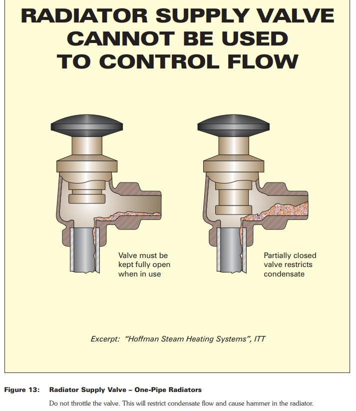

Being new to owning a steam heating system with radiators, I made the mistake of closing the service valve halfway thinking I can control the heat. Now I hear water hammering on these radiators that I did this on. Since hearing the water hammering, I completely opened the service valve and I pitched the radiators to try to get the condensate to flow back to the service valve. But no improvement.

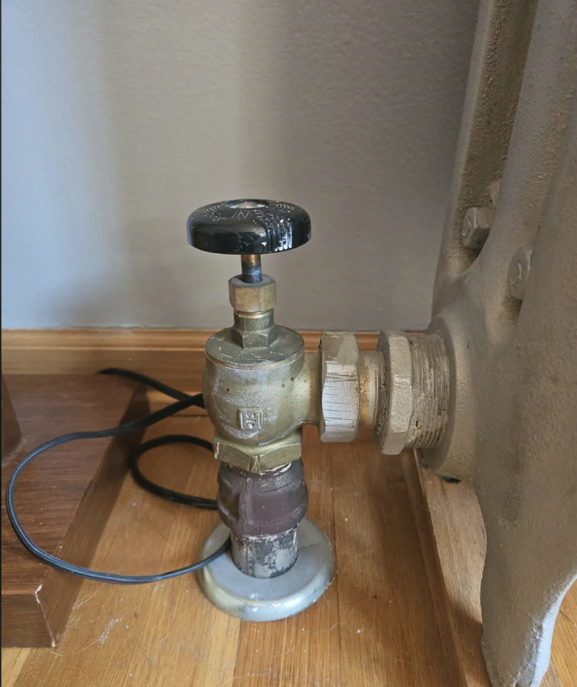

    here is an image i found online, where the service valve is slightly pitched away from the radiator (not perfectly vertical), would pitching the service valve away from the radiator help with this issue? how do I do pitch the service valve away from radiator?

    Never use the service valve to control the heat , you control through the venting .. Plug the vent if you don't want heat ..
    Just open up the service valve to drain the radiator .. They don't hold back steam all that good .

    Old supply valves could be on the verge of falling apart and then when you combine that with water hammer, that could seal the deal. There's a metal disc attached with a screw, with a rubber gasket attached that makes the seal when the valve is closed.

    To check the valve for damage you have to either remove the bonnet at the top of the valve, which has a hex on it (might not be easy!), or disconnect the radiator and either slide the radiator back on the floor a ways or turn the valve a bit on the pipe. Then look at it to see if the disc has come unattached. There may be water so have lots of towels in case the valve wasn't allowing the water to drain out of the radiator.

    No. Disconnecting the radiator to drain it won’t help. But it will let you see inside the valve to see what’s going on.
    And don’t worry about the pitch. Unless your floors are 45 degrees, flat on the floor is fine.
