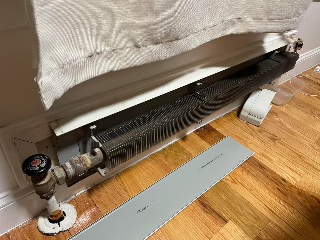

Hello all,
I have a steam boiler system and I have this convector radiator at the end of my steam pipe line on the first floor. I am having this issue where, when the steam boiler turns on, and a couple of minutes later, this convector radiator starts spitting water through the air valve at the right end. I hear water being pushed to the air valve and then water starts spitting.
2 plumbers have told me that they will have to cut the basement ceiling underneath this radiator and see if there is a blockage in the return pipe to the boiler.

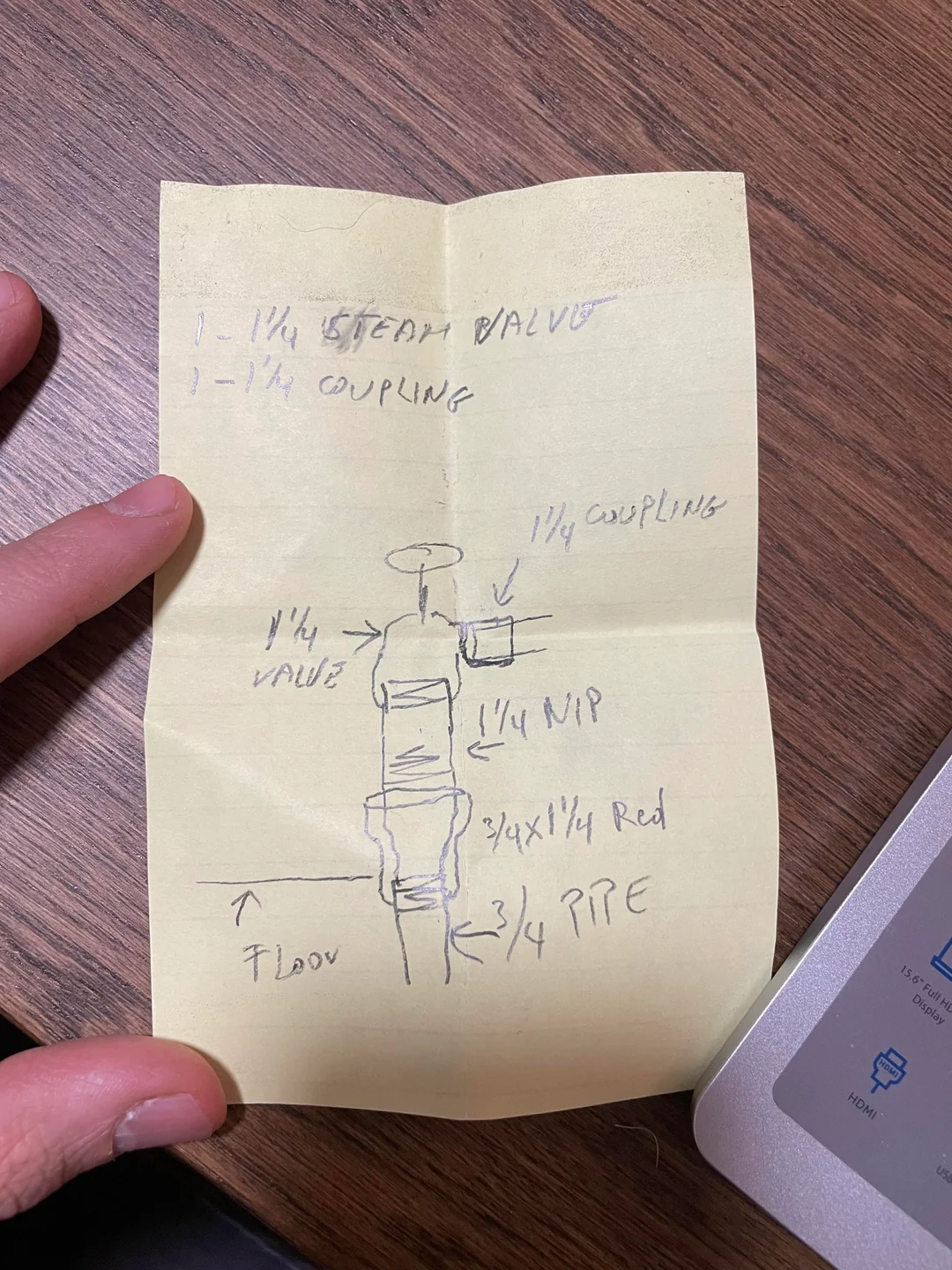

A 3rd plumber suggested making the following modifications to the service valve (see post it note image). According to this plumber, the issue is with the brown coupling between the service valve and convector pipe that is holding water and preventing water from draining back to the service pipe. As a result when the steam comes in, it forces the water to spit out of the air valve.
My question is, would making the modifications from the third plumber fix my issue? Thank you all.

    Normal problem with baseboard on steam system. It should be installed two pipe , but for now you want a slow vent and insulated mains …

    I don't think it will, and also, turning off the service valve may result in problems because those valves will often allow steam to enter, but not allow condensate to leave.
    make sure the baseboard is pitched toward the pipe and use a low capacity vent like a #4. But be aware the vent can only do so much—once the convector is full of steam, you can't control the velocity of steam entering it—it will enter as fast as the convector condenses the steam. But that's OK. In my experiments, steam doesn't stop condensate from returning even in a 1" pipe.
    I don't subscribe to the idea that there is a blockage.

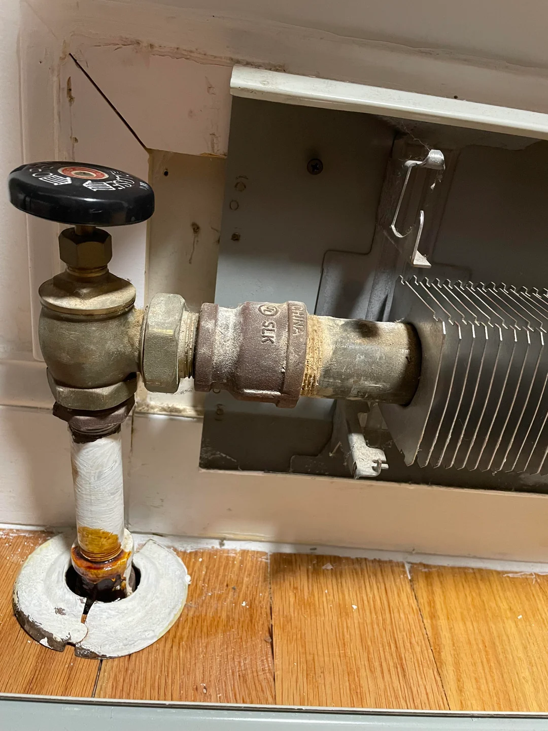

    these baseboard are problematic with water regardless but that concentric reducer is 100% preventing some condensate water from going back.
    Increasing it to 1-1/4 like the drawing would definitely help. But those air valves would probably end up spitting water eventually

  • 3rd plumber idea is the first step. Actually the second. First ensure proper pitch back to the valve and pressure on the system. Then take away the puddle being produced by the coupling. If it still spits, run a return from the vent side down to the wet return. Good luck.
