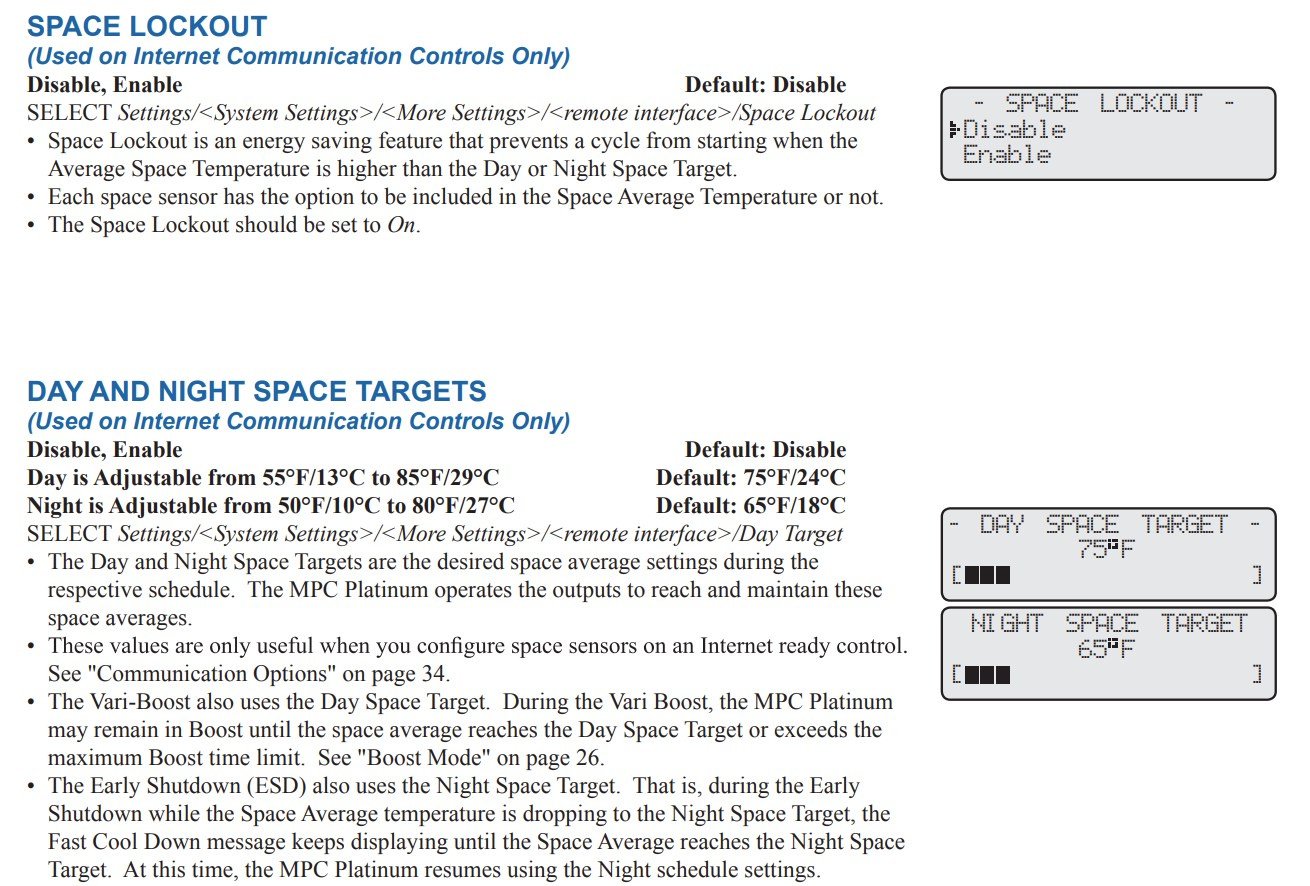

    Have you made all the appropriate adjustments to tell the system what the heat loss characteristics are of your building?
    "During the Cycle-ON period, the MPC Platinum will keep the steam source activated. The length of the ON part of the cycle is dependent on the outdoor temperature, the Day/Night setting, and several user selectable adjustments that can be tuned to the specific heat loss characteristics of the building."
    Also, there is this in the manual:
    Space Sensor Feedback (Available with Internet Control Only)
    • For better control and much more energy saving capabilities you can add wireless or wired space sensors to the MPC Platinum to fine tune its operation and increase the system's overall efficiency. When you add space sensors to the space average, the MPC Platinum checks the space average before the beginning of each cycle to determine if the building is sufficiently heated. See "Space Lockout" on page 28.
    Another good option that I missed. Right now we run with an outdoor sensor and a system sensor on the dry return. Will need to do some research to see what it would take to enable this.
